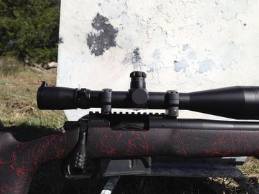

For my gun:
41.3 gr RL17
Factory Hornady cases
105 Berger Hybrid
Fed. Match primers
2.815" OAL
3011 FPS
This is the Gun
Crescent Customs Rem. 700
Bartlein 7.8 Twist finished @ 25"
Bushnell ERS
Rock Solid Stock
Shilen Trigger
Here is load work up:
-J
Reactions: Chevoke
Hey Brother, did you bed that RS stock, or just throw it in there and run with it?
