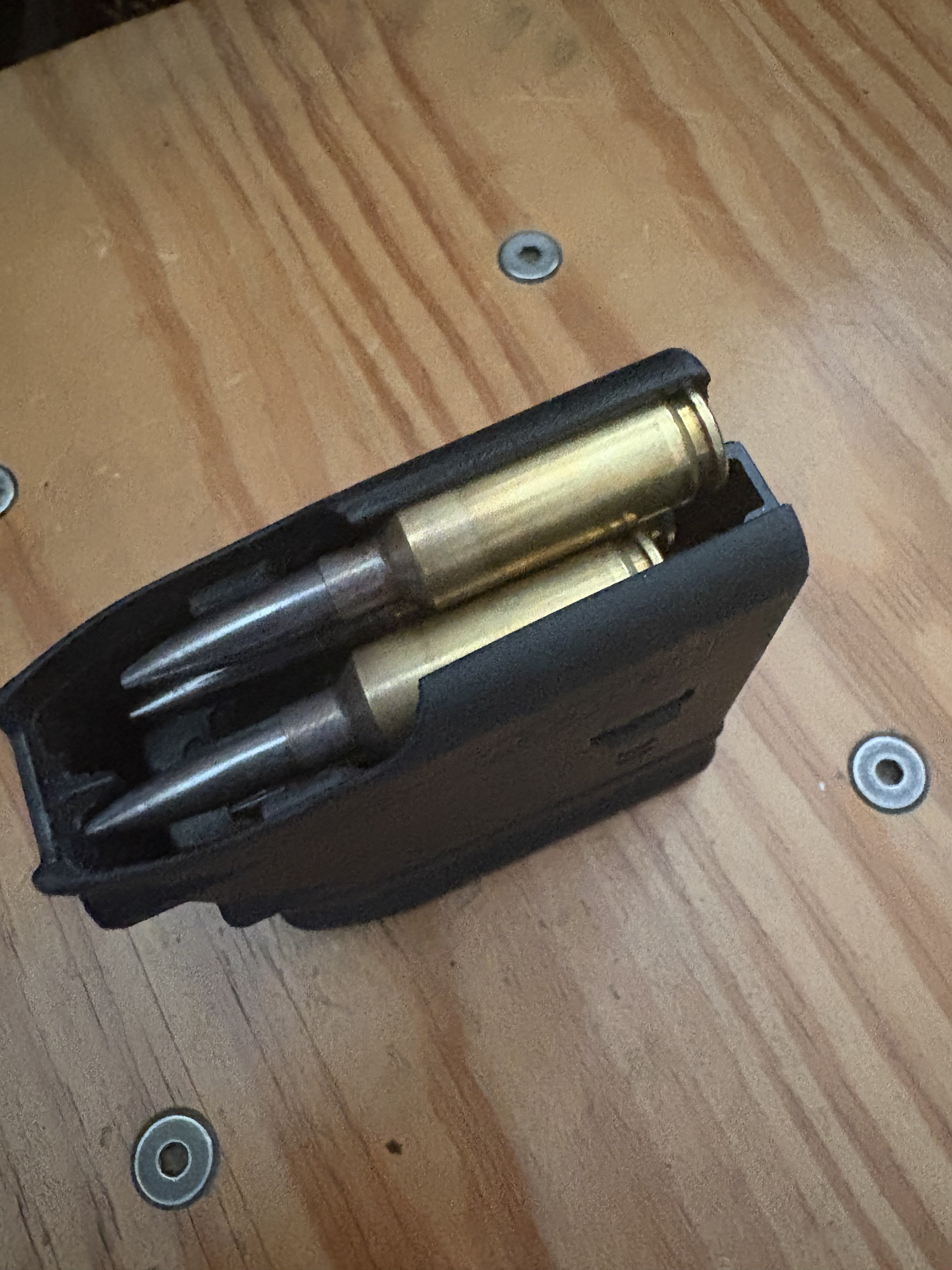

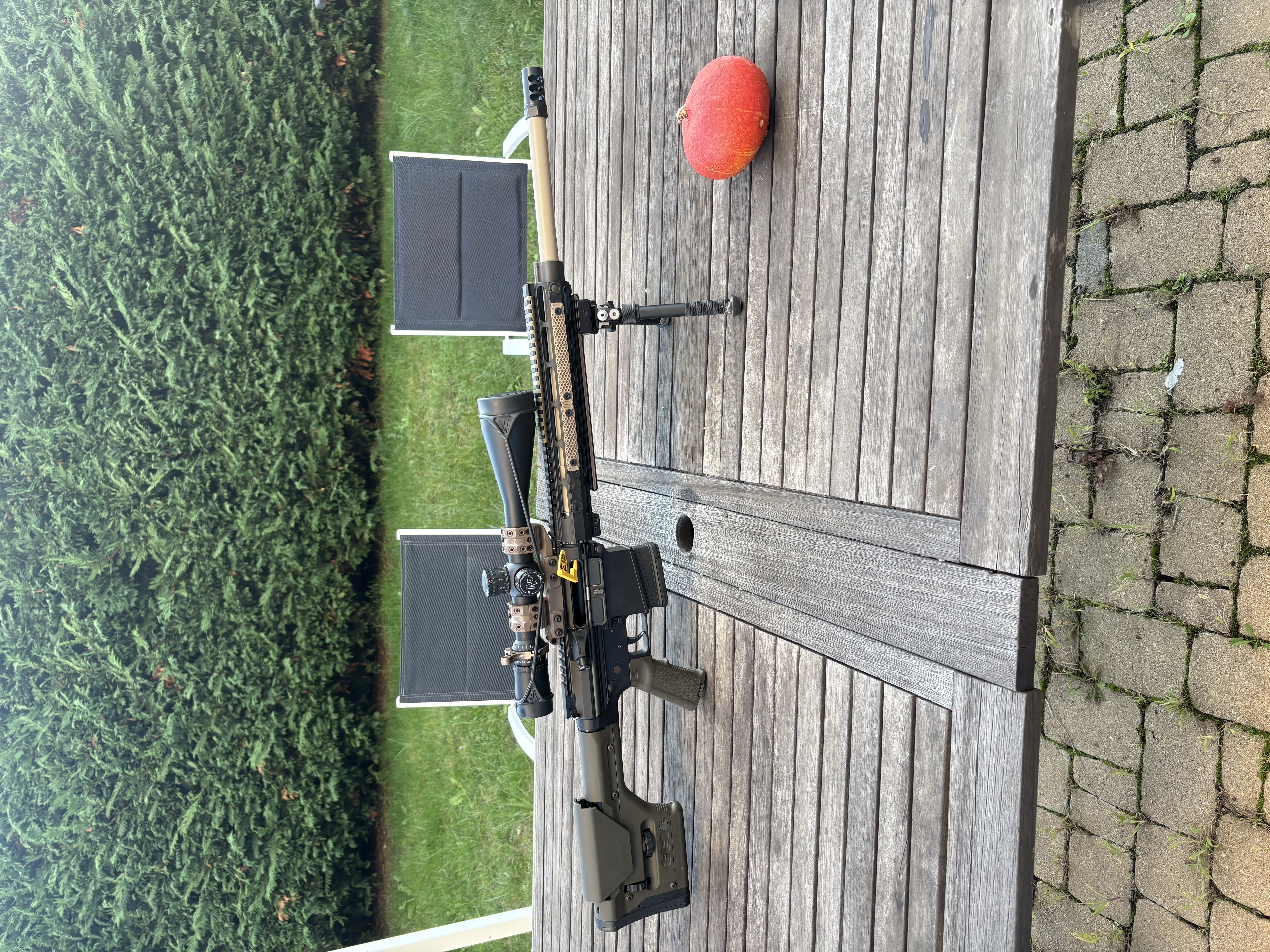

I released some time ago in the marvelous 6 dasher an AR 10 . And yes that works very well in semi auto .
Rifle gas length system ,JP low mass bolt carrier and JP high pressure bolt to avoid pierced primer .
To make it work with this little round I use pmag magazine ,and with the anti tilt follower no problem .
The gas port is drilled at 1,9 mm (0,075inch). For a 22 inch long barrel .
