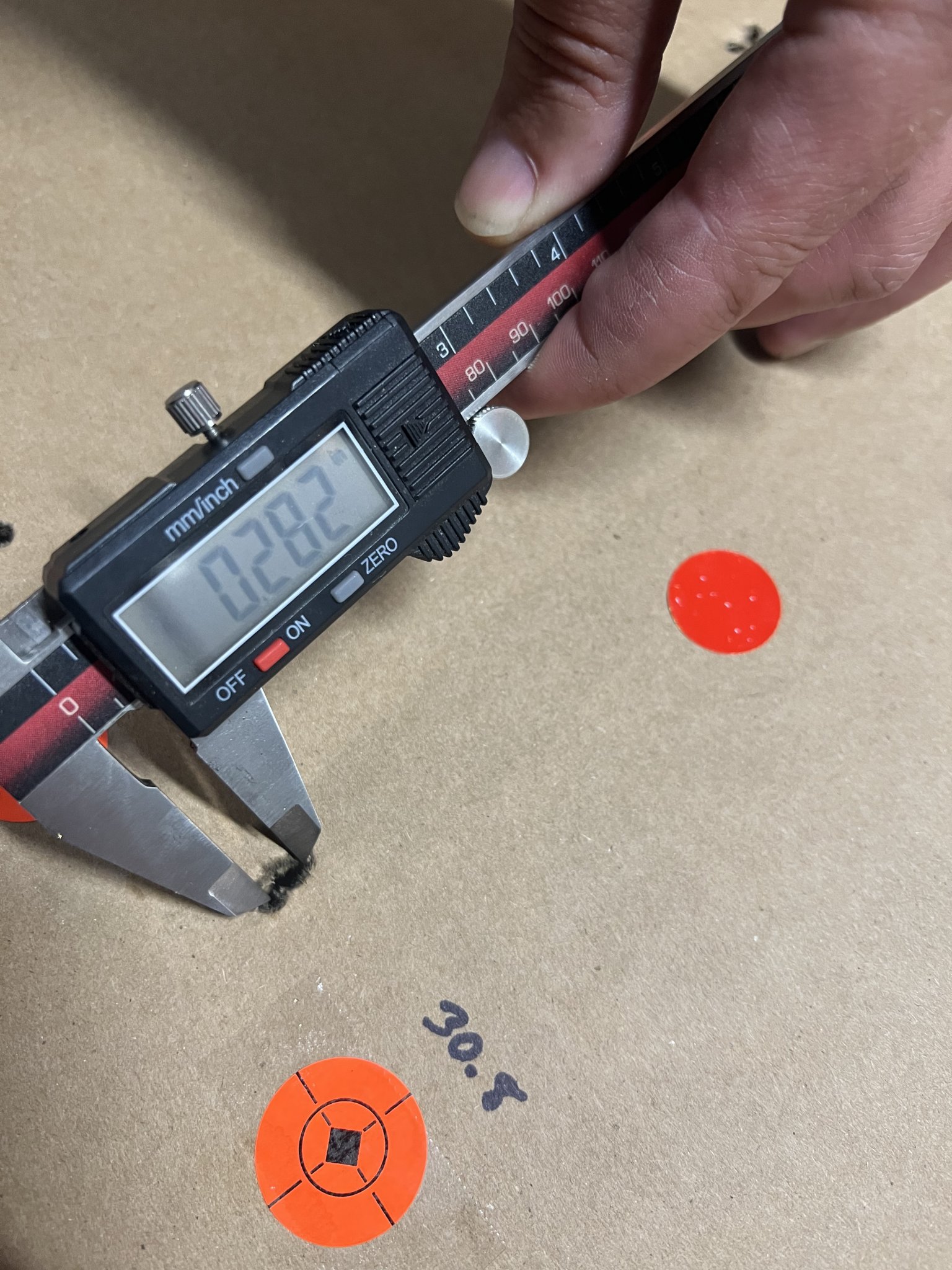

    I’m new into so take my words with a grain of salt but I'm running a 1-7.5 with a 107 Sierra MK. And it shoots like a dream. Easy 30.8 gr varget. But I’m shooting prs. I don’t know if your looking for something different with f class
