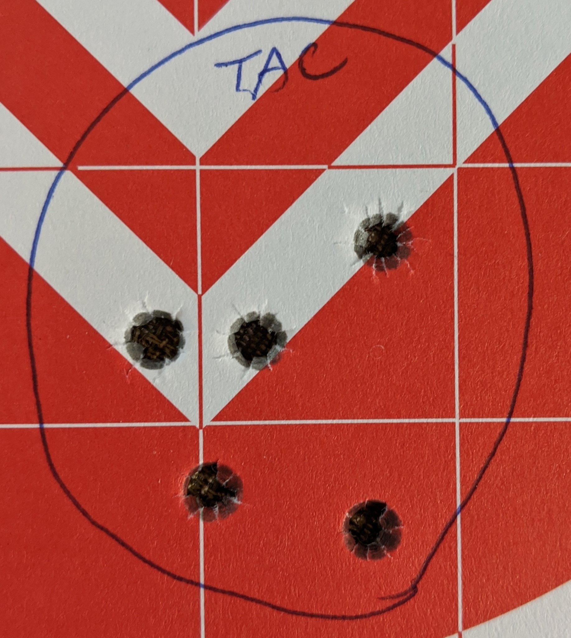

First I did a load "ladder" test with TAC - Grains - FPS
29.0 - 2764
29.2 - 2796
29.4 - 2826
29.6 - 2859
29.8 - 2892

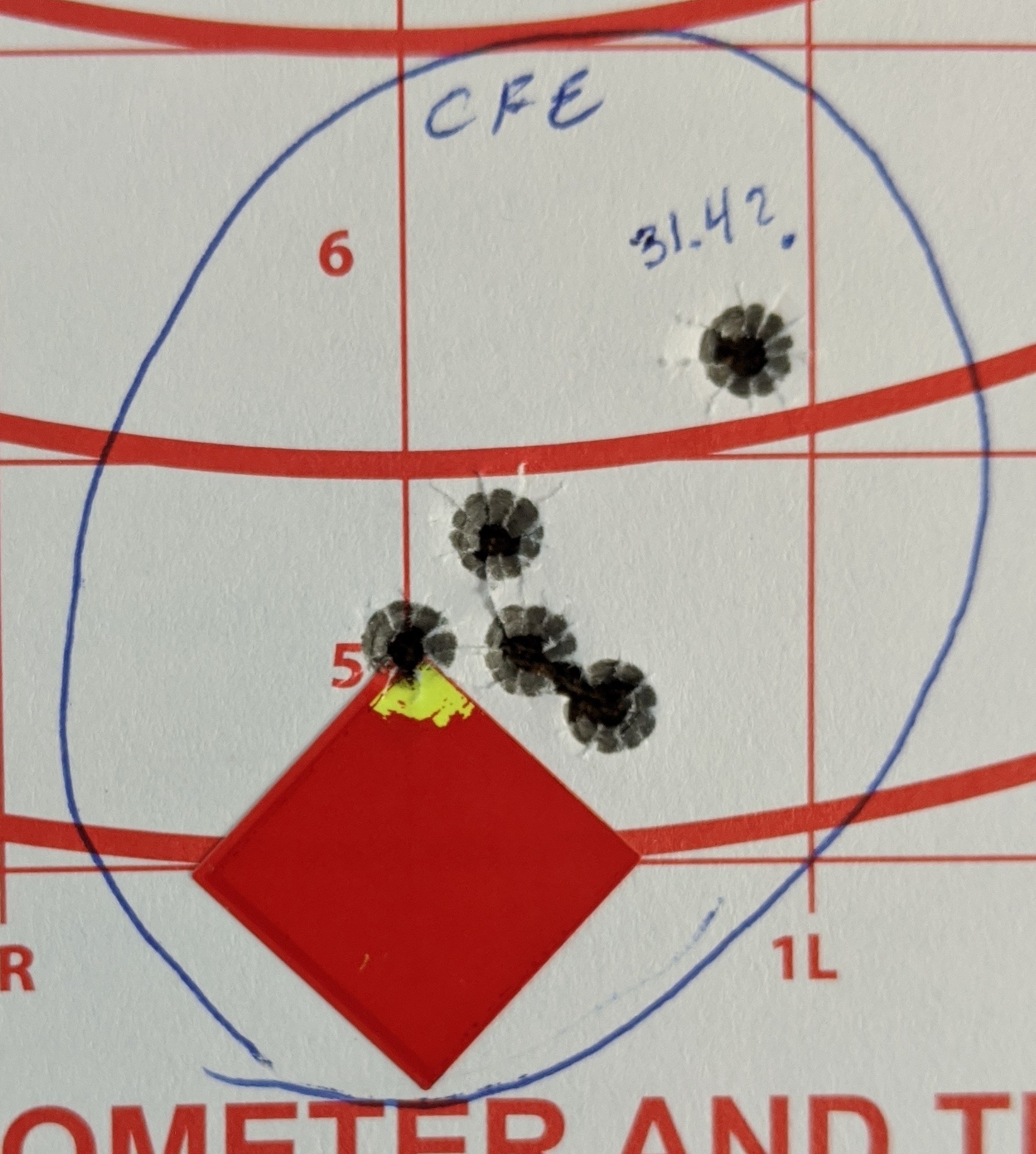

Then a "ladder" with CFE 223
31.0 - 2789
31.2 - 2837
31.4 - 2834 Pulled it?
31.6 - 2864
31.8 - 2898

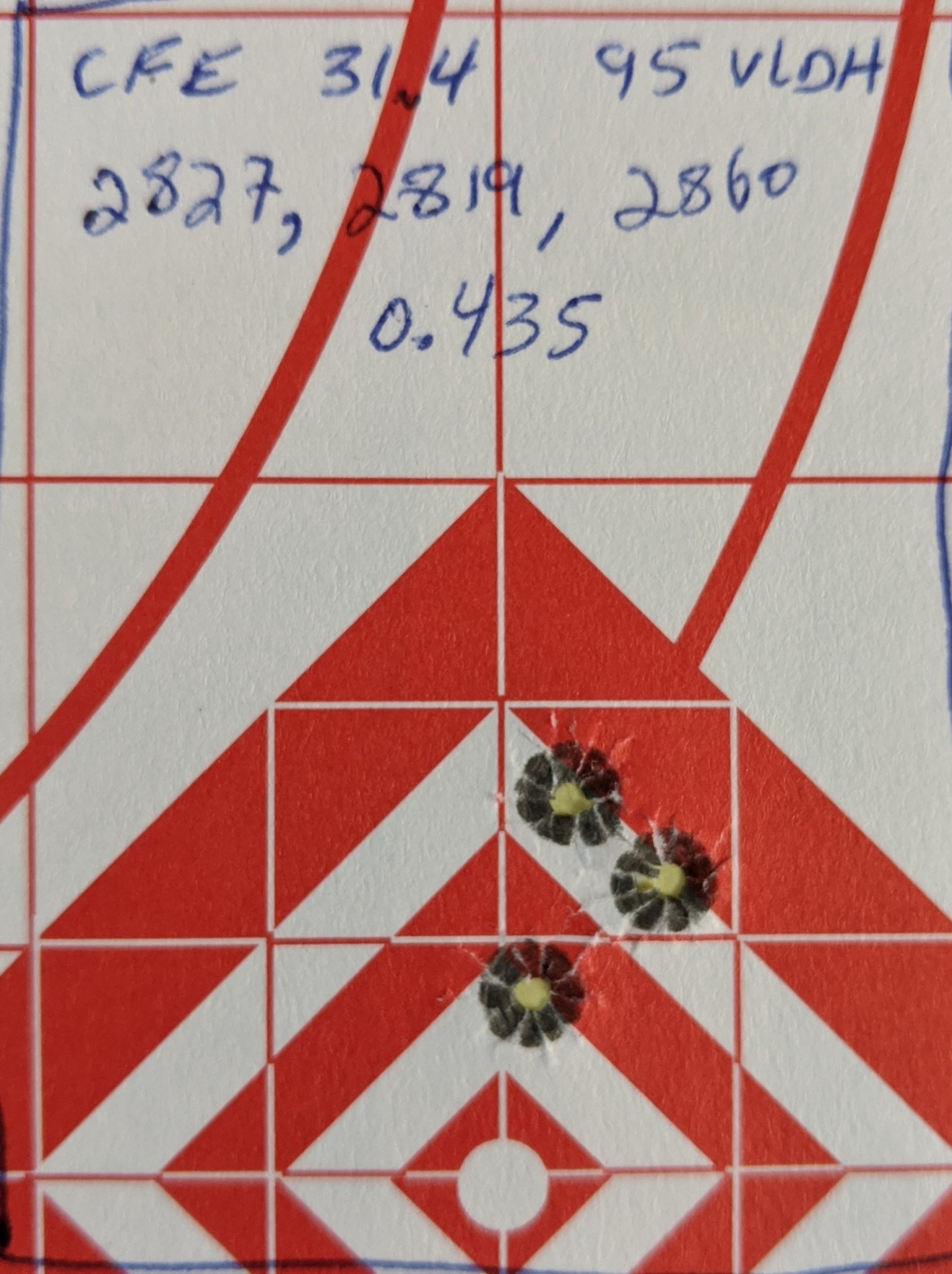

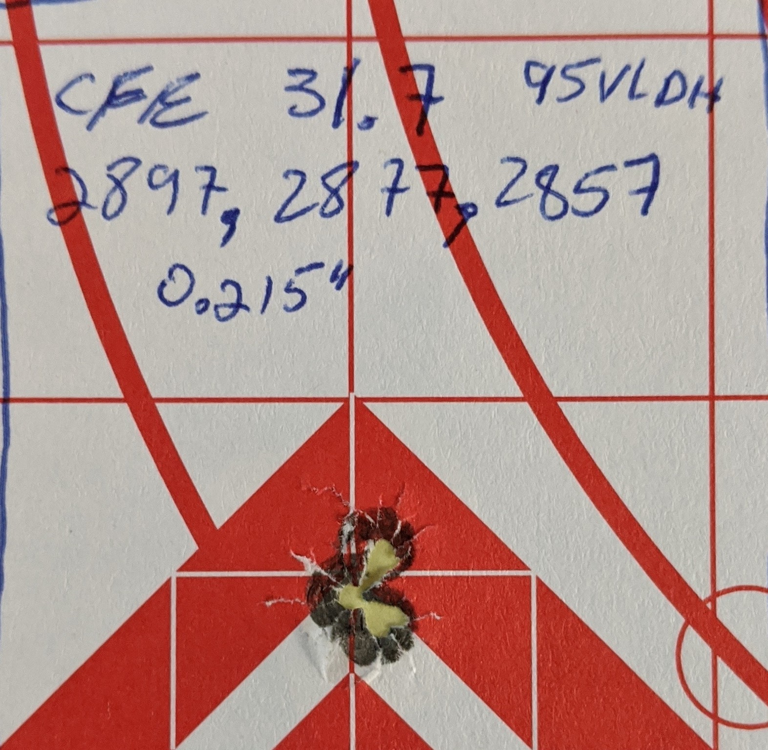

Then a 3-shot group with CFE at 31.7: 0.215" group
2897, 2877, 2857
Then a 3-shot group with CFE at 31.4: .435" group
2827, 2819, 2860

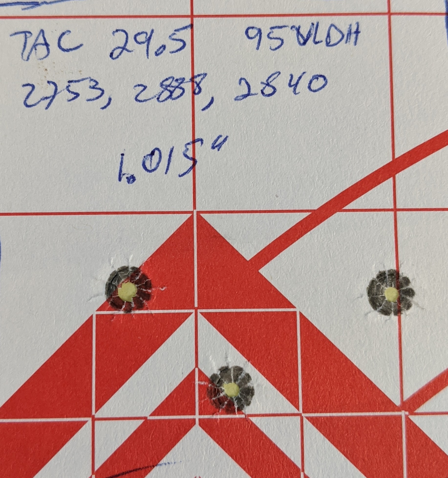

Then a 3-shot group with TAC at 29.5: 1.015" group - ouch.
2753 (what?), 2888, 2840

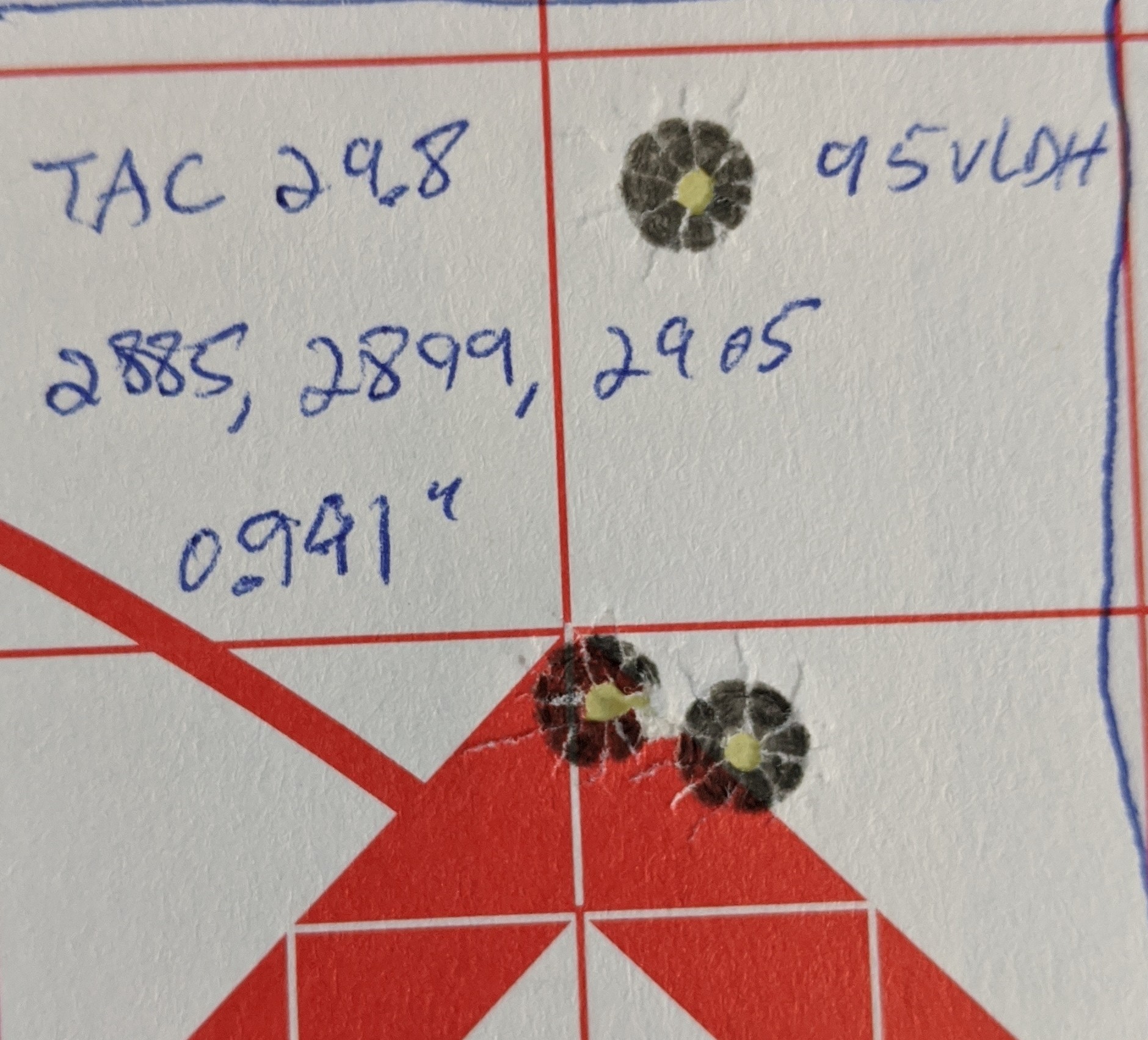

Finally another 3-shot group with TAC at 29.8: 0.991" - did I pull the first one?
2885, 2899, 2905

Next time, before switching powders, I will clean with boresnake (dry) and send two shots with the 87 VLD with the next powder before testing. Hoping this will clean the prior powder residue somewhat and lay down new powder residue with the same make of bullet.
