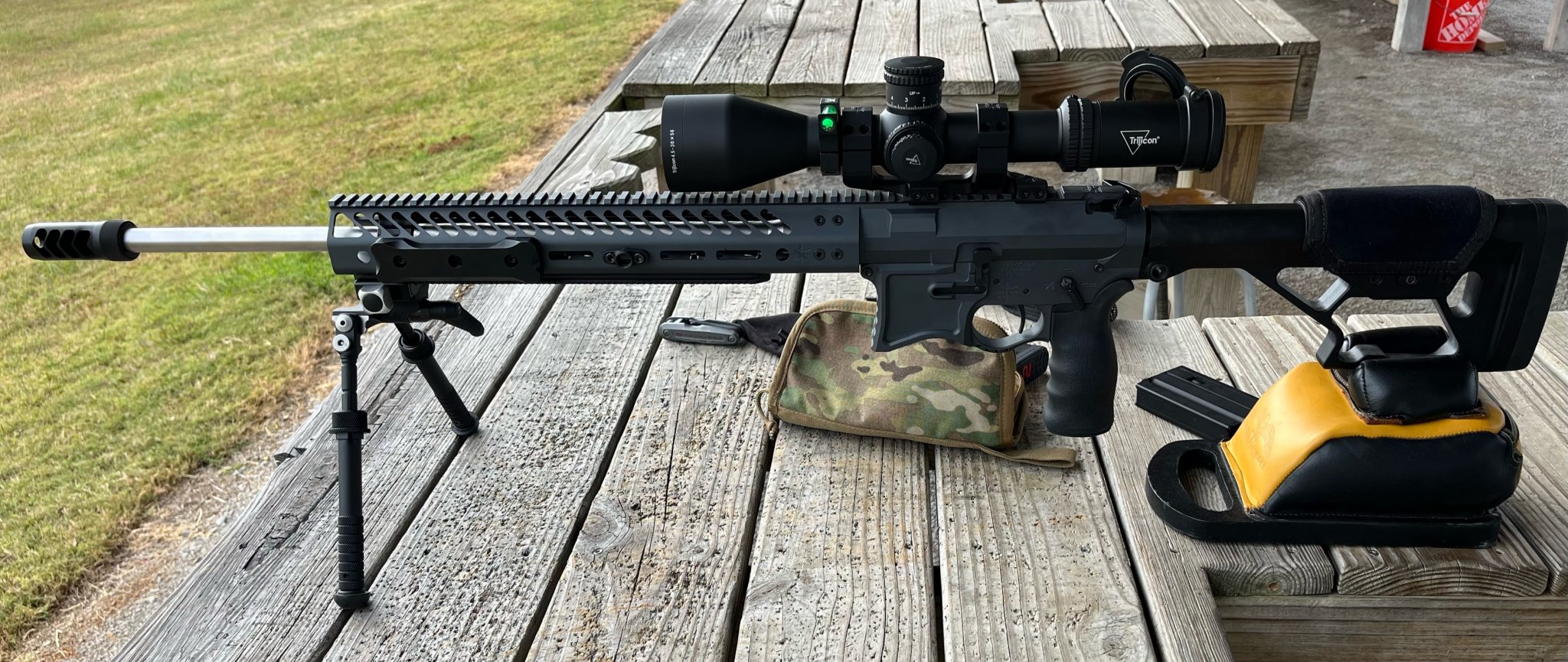

For what it's worth shooting a 22" Ballistic Advantage barrel with 105 VLD's and 29.7gr of Lever or near equal CFE 223 I'm getting consistent 2765fps+/- depending on outside temp. I shoot @ basically sea level in Ellerbe NC,1400 rounds into this barrel so far.
Awesome!
1. What level of precision are you getting from the Ballistic Advantage barrel?

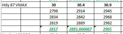

2. Have you tried lighter bullets in the 7 twist? I'm specifically interested in the 87gr VMax and if there are any issues shooting them on a 7 twist. I've done it with my GT in a 7.5 twist without issue.
Reactions: river22
Awesome!

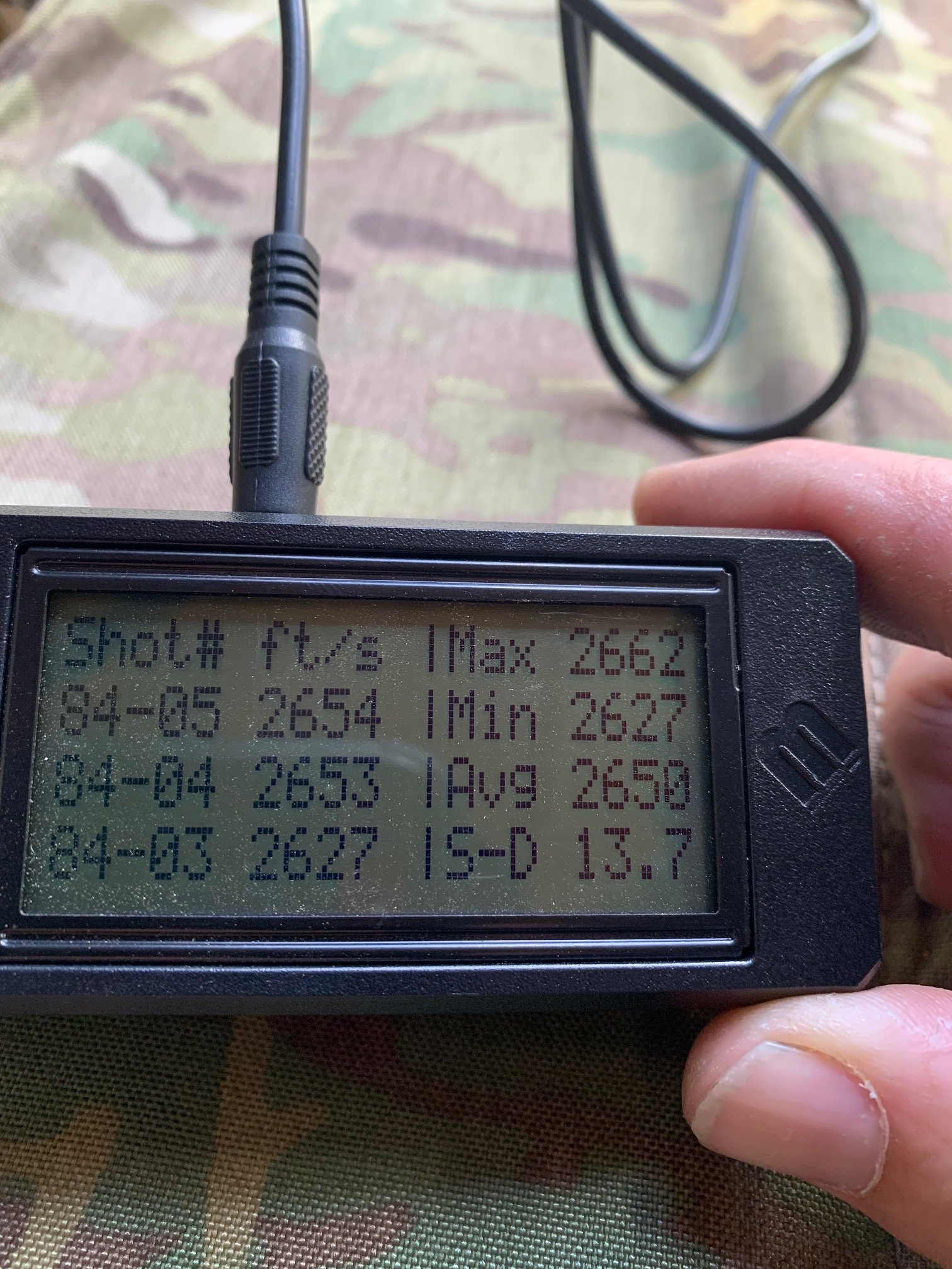

22" Bartlain, +2" gas, brake, & factory 108. Rounds 3-7 out of new barrel.
22" Rainier UM, +2 gas, brake, & factory 108 same lot as above.
110 rounds on barrel = 2615
255 rounds = 2640
340ish rounds = 2673
Do you think it has leveled off yet?
I pulled the Rainier @ about 400 & switched to the Bartlain. I think it was leveled out.

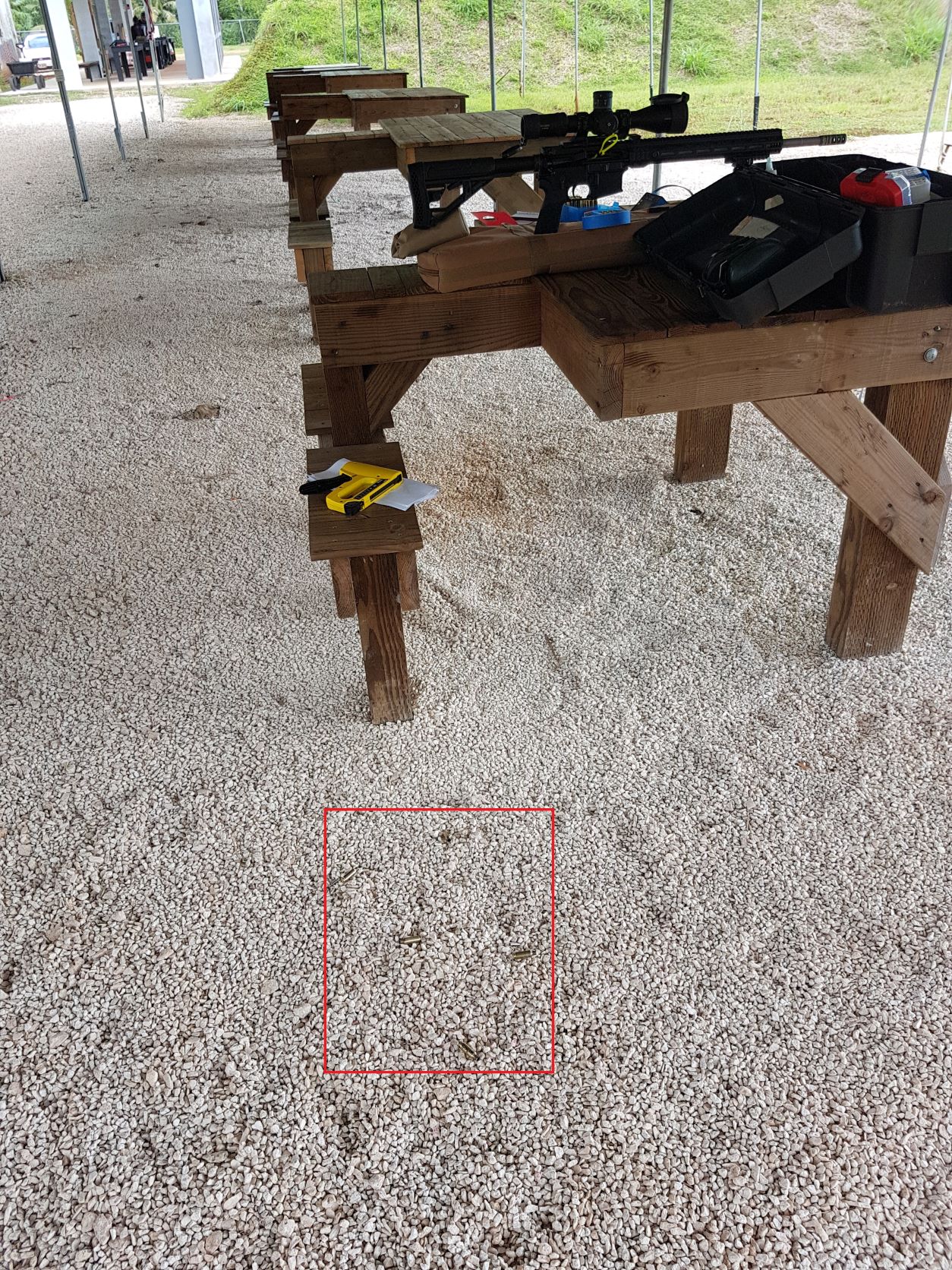

...FWIW, out of my early run 18" RLGS BalAdv tube from Brownell's during my build validation, brass fire forming & powder testing. Conditions: 85F/80% Humidity, ~400F elevation, powder=LeverEvoution, primer=CCI 400, brass=virgin Starline 6.5G converted to 6ARC, projectile= Hdy 87 VMAX, CBTO/COAL = 1.661 / 2.130.
No pressure signs on brass, 4-430 ejection pattern. I use a SLR Adjustable Gas block with standard carbine buffer & spring.

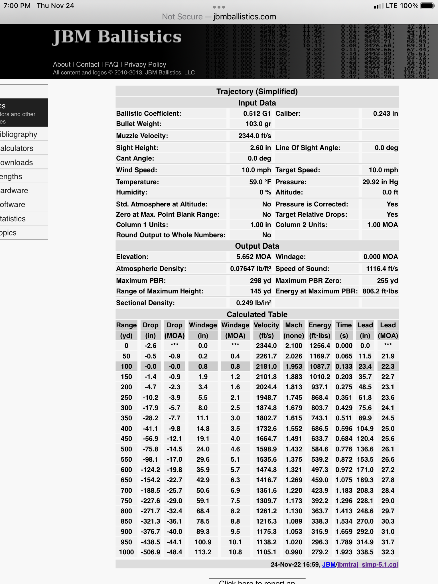

Does anyone have experience with the 6ARC out of a 12.5” barrel? Wondering if it will still make it out to 800yds.
I get 2344fps out of my 12” with the 103 ELD-X. The ELD-M and Black each gave 2395fps. The TAP gives 2335, but group size is twice that of the others.
Here’s what JBM says about the -X.
Hope this helps!
