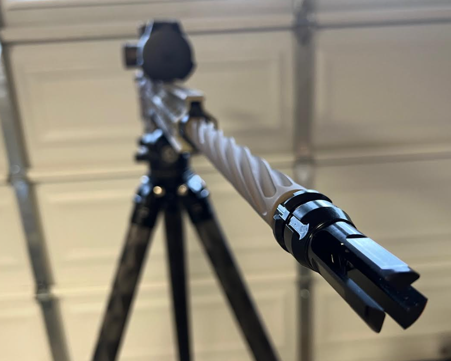

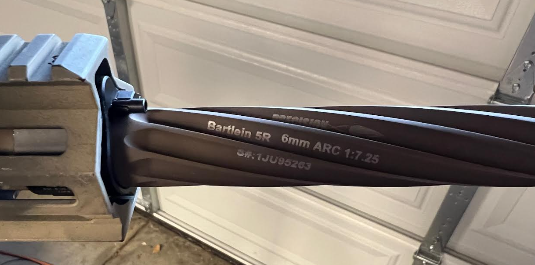

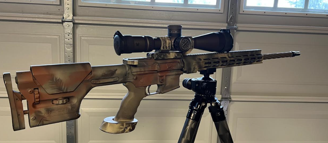

The 26" barrel showed up this morning so I'll be able to get you guys some long barrel data as soon as the flooding stops.
