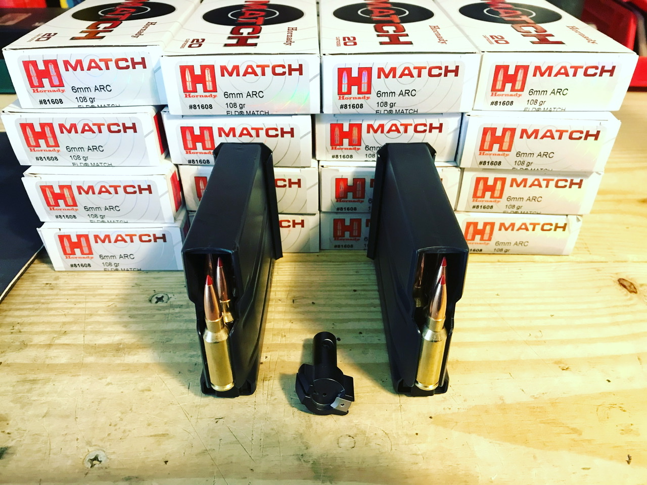

We will see how the mags work when I get to the range but I put one round in and ran the bolt and it fed perfectly so lets hope they both do. If not then a little tuning might be needed.
Reactions: Pat M. and CK1.0

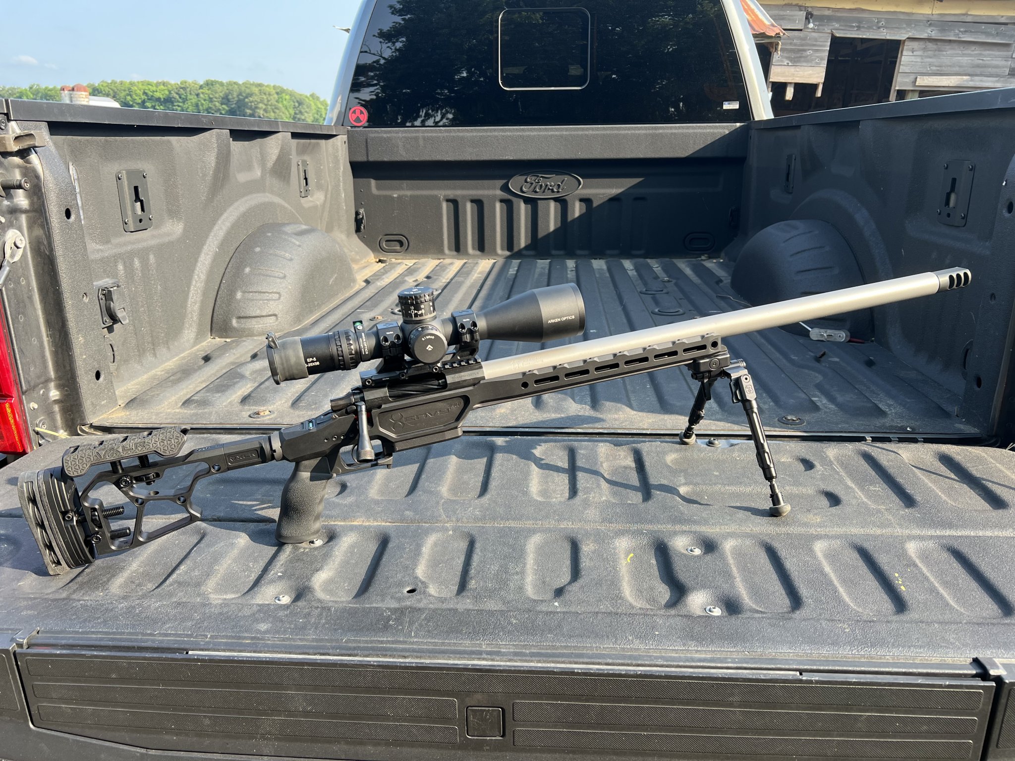

Got out with it today. Both mags fed fine. Only put 20 rounds through it to get zeroed and test mags but shot out to 540 yards and it dropped where I aimed them. The factory 108 ammo was a little slow at 2670fps but as barrel works in it should get up over 2700fps and that was only one lot I had so I will test the other one next time out. Recoil was very light which was nice.
Reactions: CK1.0 and Pat M.
