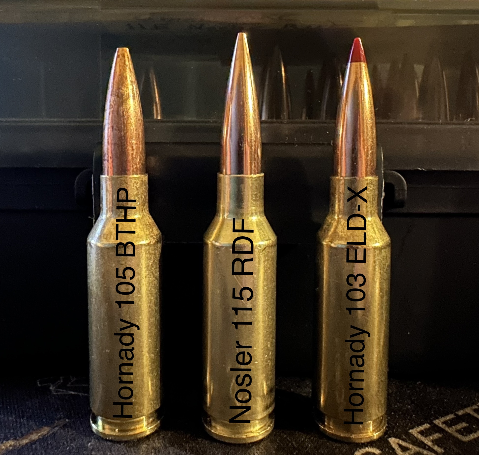

Yeah, I’ve never owned or loaded for any 6mm’s, so this was all new to me. I own just about everything else from .30 cal down to .17, but never owned any 6mm’s, and think .277 is pointless (I’m a 7mm guy)…But everything else, I got it covered.
After measuring the loaded factory Hornady Black 105 BTHP ammo that I NOW have on-hand (to get the brass), I just ordered a new SAC .266 bushing, which should give me about .0025-.0030 neck tension. Midway is pretty fast shipping, so hopefully it’ll make it by the weekend, so I don’t have to postpone load development for yet another week. 👍🏼

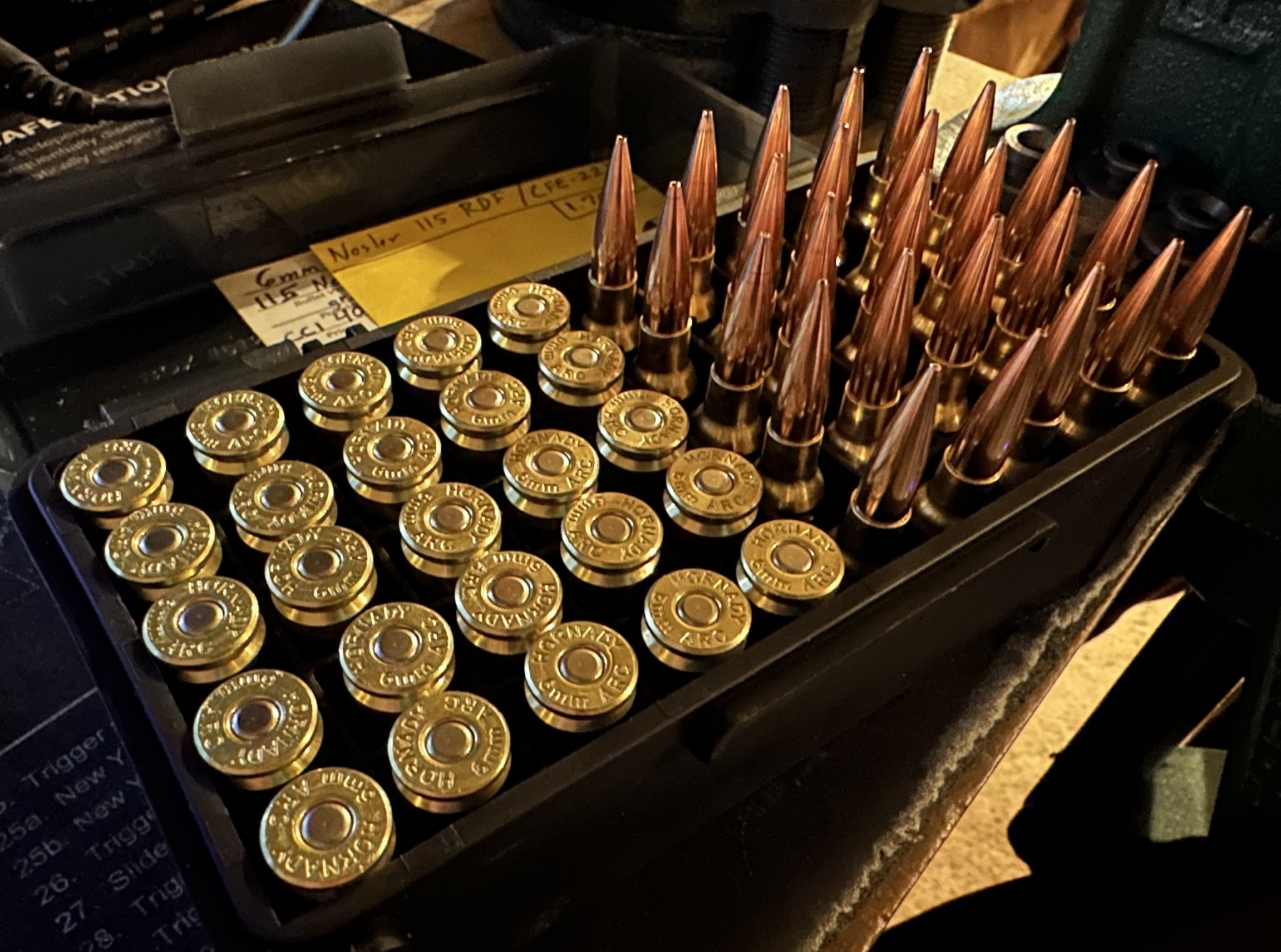

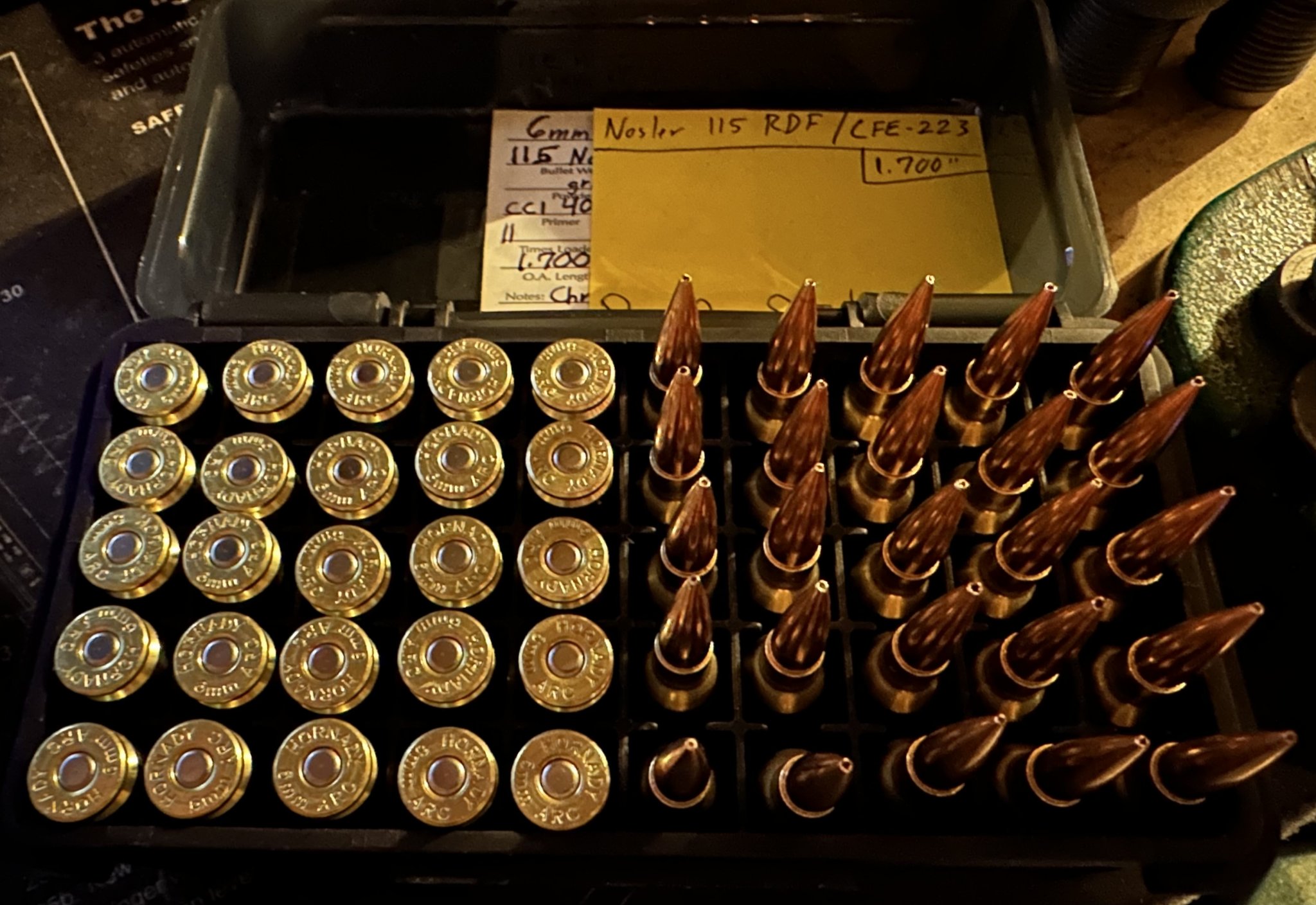

Midway came through for me, and the new bushing showed up today. Got them all resized (again), and loaded up my first round of load development for my 16" Christensen Arms MPR. I'm running 1x fired and FL sized Hornady brass, CFE-223, CCI 400's, and Nosler 115 RDF's. I'm running all the way up to 29.0gr in 0.5 grain increments (first round of data is pressure baseline and finding a rough node pattern). I'll report back my findings.
In case someone else reads this in the future, DO NOT use bolt-gun load data in a gas gun. Bolt guns can handle a lot more pressure.
