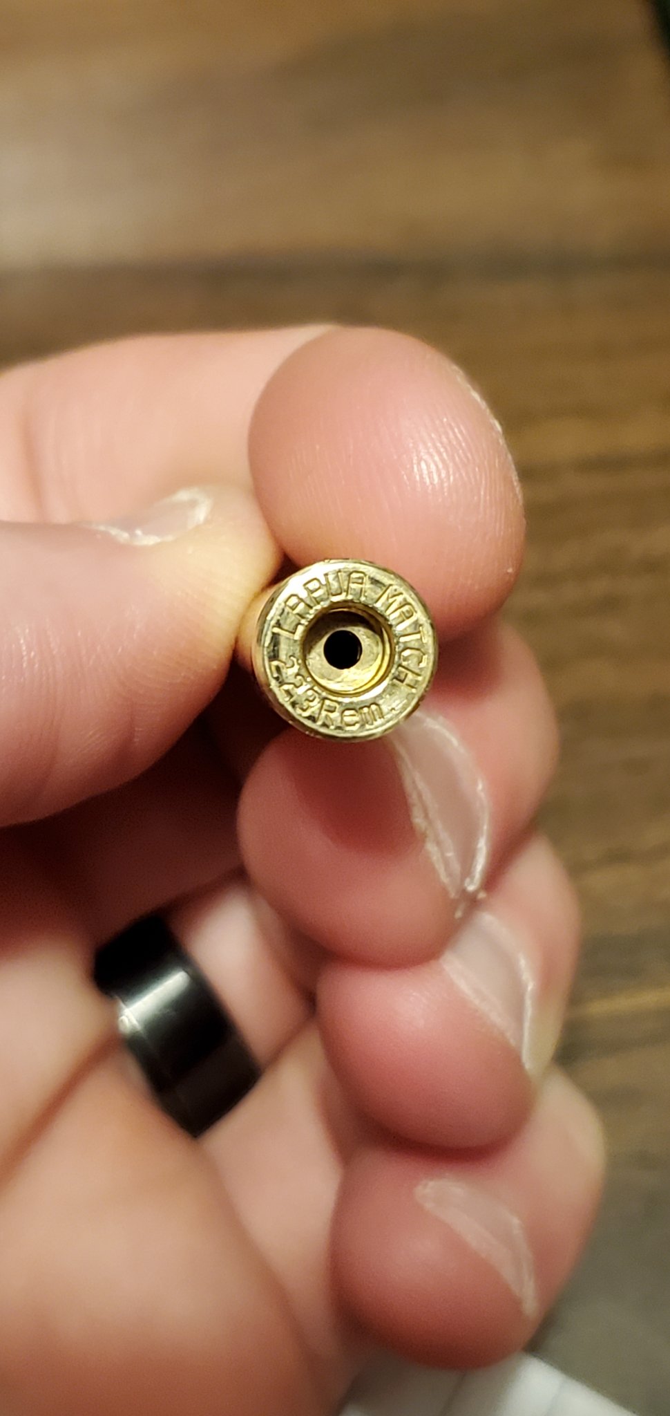

Why is my lapua 223 brass not chambering and sizing?
If you provided him with the starline brass then he probably chambered it to close on starline with no resistance. Many people use brass casings instead of gages to chamber rifles.
Just so happen he chambered it pretty snug. Not that big of a deal except taking the rifle down.
Reactions: kyotekiller25
So min spec chamber is what 1.460" essentially correct?
Mine is coming out to 1.455"
Lapua brass is coming out to 1.456"-1.458"
Starline is coming out to 1.455"-1.456"
He needs to cut it to at least 1.458" or 1.460" then correct?
He's a match director so I won't be able to talk to him and run it up this evening, but I want to make sure all these measurements are right and make sense when I tell, and show him all this.

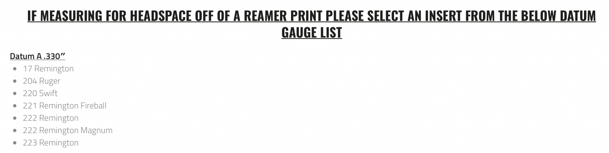

The only way you can use that measurement is if you're using a .330 datum gauge.
The question was originally about brass sizing, and the spec for cartridge (ie, brass) is max (published) ± tolerance. so the data as shown is relevant. The tolerance is shown in the highlighted area as -.007 ("minus up to 7 thou" vs Max)
Didn't say it wasn't relevant, just that didn't answer the question:

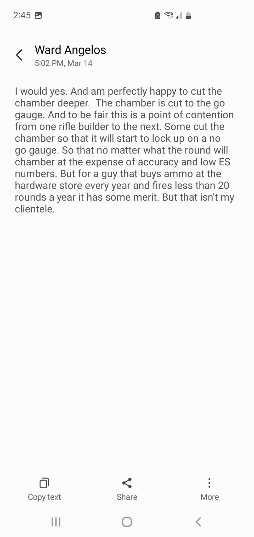

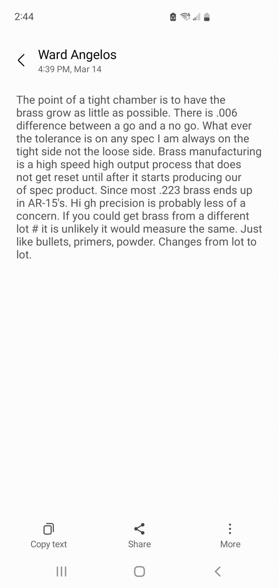

The chamber technically needs to chamber 1.460 brass, but the chamber itself would be slighlty above brass size... i believe was the point raised by post #47. If I'm readin the print correctly, the min-spec on the chamber calls for ±1.463 to 1.464 (more accurately, 1.4636 as published).
(@TheOfficeT-Rex please double check my logic).
The SAAMI chamber drawing headspace is 1.4636 min to 1.4736 max, so that would be correct for a min spec chamber. ETA: and yes, a max length cartridge is longer than the min spec chamber.
A set of go/nogo gauges should answer this pretty quick. Should drop freely closed on a go, and stiff on a no-go. From OP, sounds like this guy knew it was tight on a go gauge...
The SAAMI chamber drawing headspace is 1.4636 min to 1.4736 max, so that would be correct for a min spec chamber. ETA: and yes, a max length cartridge is shorter than the min spec chamber.
From what I understand, he told me he chambered it to just barely close on his go gauge, so he definitely knew it was a very tight chamber. I just didn't know it was going to be that tight...Not sure he did either, but he's a gunsmith and I'm not. I just figured tight meant it would still chamber all brass amd be snug, not be so tight that it wouldn't chamber.

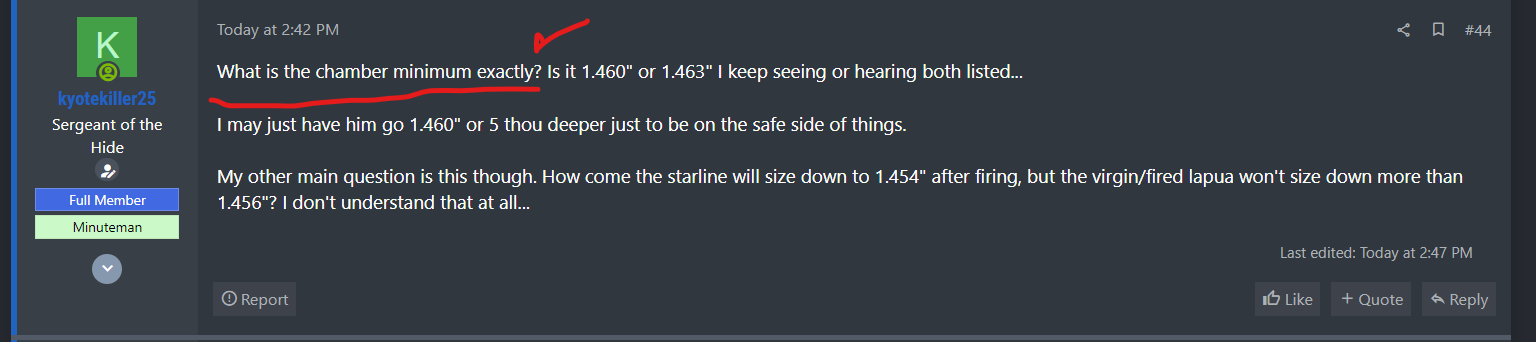

So if it was you guys, would you have him go 1.460" or 1.463" then? I'm taking your guys advice over his at this point. I appreciate all your guys help and expertise on this.

This is what he had to say when I messaged him about it at the range when I fired the 4 shots with lapua brass and noticed something wasn't right. He did say to bring a piece of Lapua brass and he would happily cut the chamber deeper.
He claims he doesn't chamber off the brass, or the starline dummy round I gave him. He plainly stated above he chambers to barely close on a go gauge, on the tighter side.
I can't really make out his thought process on being that tight, but maybe some of you can?

It's leaving a ring around the base of the case, it's gritty feeling when you chamber a round. I don't know how else to explain it. Other than it ain't right. That's all I know...
I don't necessarily agree with his reasoning for a few things. But, he's at least articulating his personal reasons and has no problem running the reamer back in the chamber.
Sounds like in all reality I should just have him cut it to 1.463" just to be on the safe side, and even then it's still .003" on the tight side for the maximum Saami brass specs, correct?

Numbers getting tossed around are likely going back and forth between comparator numbers and absolute measurements.
The specs you see on a saami or other reamer print will specify the gauge to be used for headspace measurement. In this case, it's a .330 gauge for .223.
The minimum chamber size for .223 saami using a .330 gauge is 1.4636. Which is likely the size go gauge he is using. So your chamber is likely already at 1.4636.
The only way to use the numbers you are providing is if you take your comparator and measure the go gauge he used to chamber with as well as your lapua brass. Then we'd be able to see the difference using your numbers. Since you don't have the gauge to put your comparator on, we can't give you a specific number.
The best we can tell you is you'll want somewhere around .002-.004 longer than your virgin lapua brass. Your gunsmith will either measure your brass and his gauge with his tools and then add the amount needed to chamber the brass.....or he will strip the bolt and run reamer in until the bolt barely stops on the case, then add another thou or three so the bolt falls free and has room for the occasional longer piece of brass.
