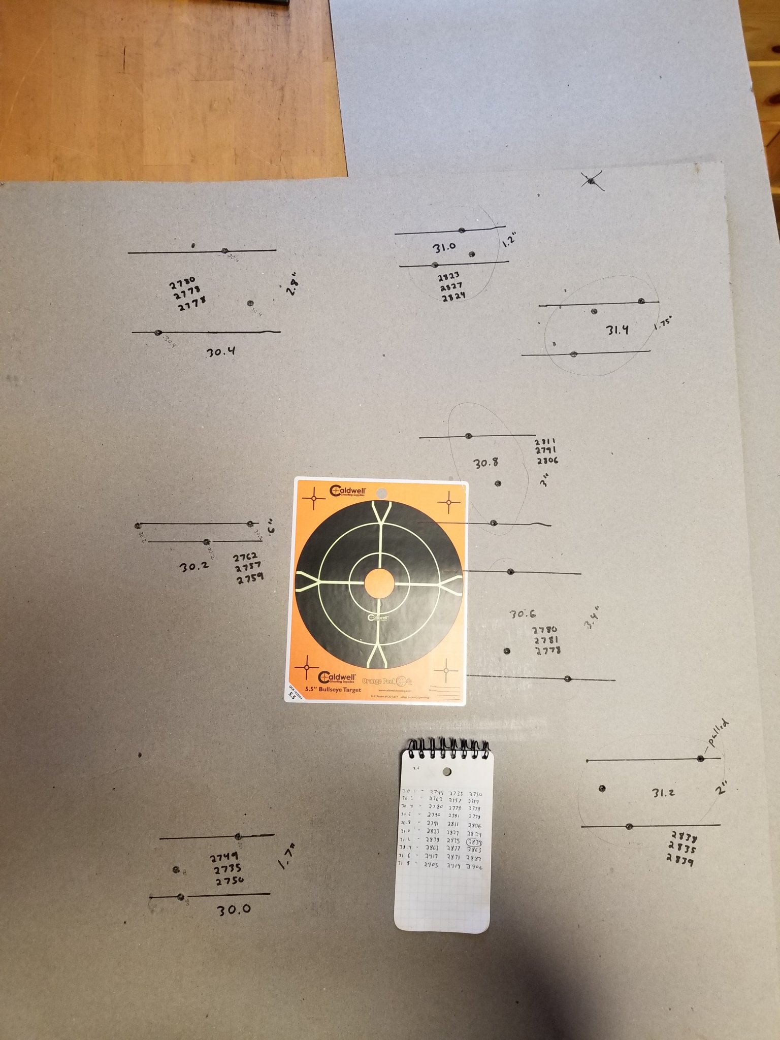

I saved the poster board from a 300 yard ladder test that I did and if memory serves the sweet spot was between 28.5 and 29.5 grains of Varget. I'll dig it up later on to see if I remembered it correctly. If not, I'll repost what the charge range was.

Ladder test completed using the hybrids.
There seems to be wide node from 30.2 to 30.6 of Varget, less than .2" vertical at 400Y which was the distance I shot the ladder test!
35 rounds loaded up at 30.4 to try today so this afternoon i'll report back.

I just did this yesterday. Conditions were 20 degrees, and had an 8 to 12 mph wind at my 5 o'clock. Rifle specs are 24" carbon fiber proof research barrel 8 twist. 105 hybrids, Varget, wolf primers. It looks like 31.0 to 31.4 grains is what it likes. Target was shot at 600 yards.

Success finally!!!!!!!!!!!!!! 30.4 grains gave a velocity of 2915 fps ave which is pretty fast for a standard 6mmBR in a 26"! 10 fps ES. I lucked out with seating depth and I don't think I'll mess with it - .005 off the lands.
100Y, .3" to check zero in 3 shots.
1" vertical at 500Y, one splat about 2" wide.
792Y, 3" vertical for 10 shots, most right around 2".
A black cinder hill at 1182Y, I had 6 rounds remaining, 5-6" vertical, maybe less because I was hitting .1 mil high and had to compensate after a few shots, and hit the 4" sized rock I was aiming at on the 3rd shot.
I'm still absolutely astounded how much those RDF's suck! So bad in fact I thought my scope might be broke or something had come loose. They didn't even feed well in my rifle.
The 90 TGK's don't do bad at all inside 800Y, actually they could be a great varmint bullet, I might do more testing at the 3196 fps velocity with seating depth.
It's surprising that the hybrids do feed decent, just a little tweaking and I think I'll be GTG.
Now to send some brass off to Harrels for the correct size die.
