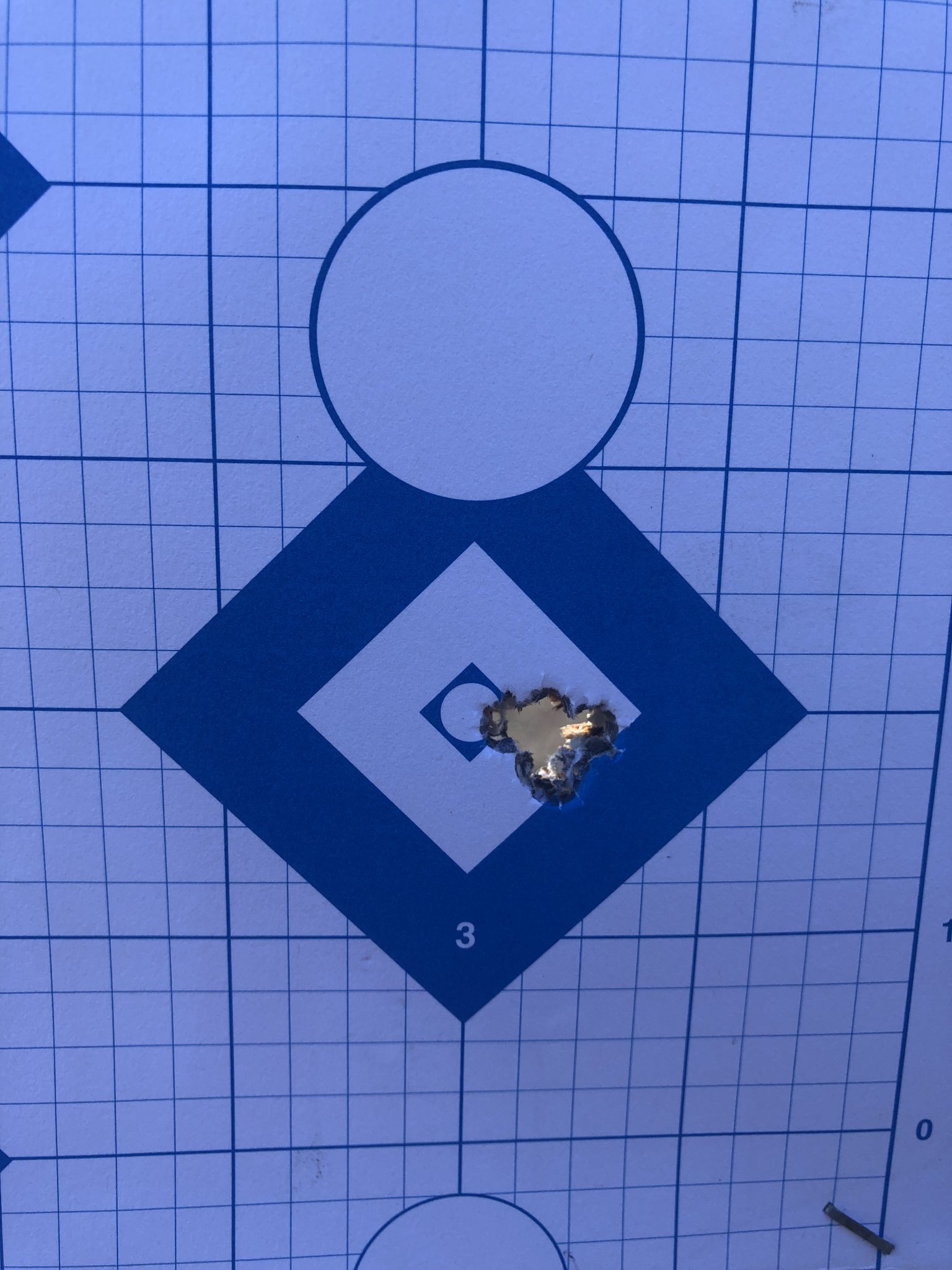

Got my x-caliber barrel on and loaded up a basic/mild load for break in.
26" 1:7 barrel
Berger 105g Hybrids
CCI 450/Lapua brass

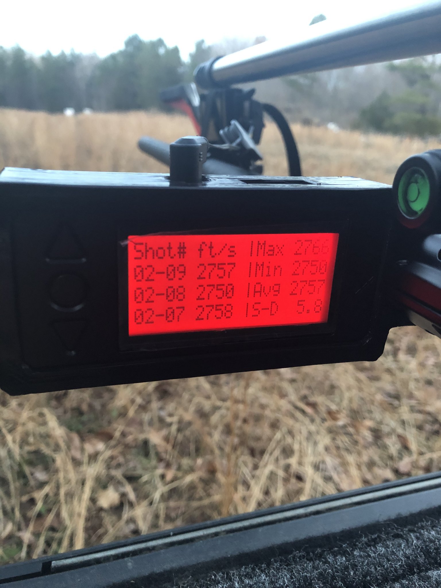

29.0g H4895
AVG FPS: 2757 (9 shots - deleted 1st shot - was clean bore and much slower) SD: 5.8 ES: 16
5 shot group = .45"
I'm looking forward to dialing in a load for it now. Very happy so far

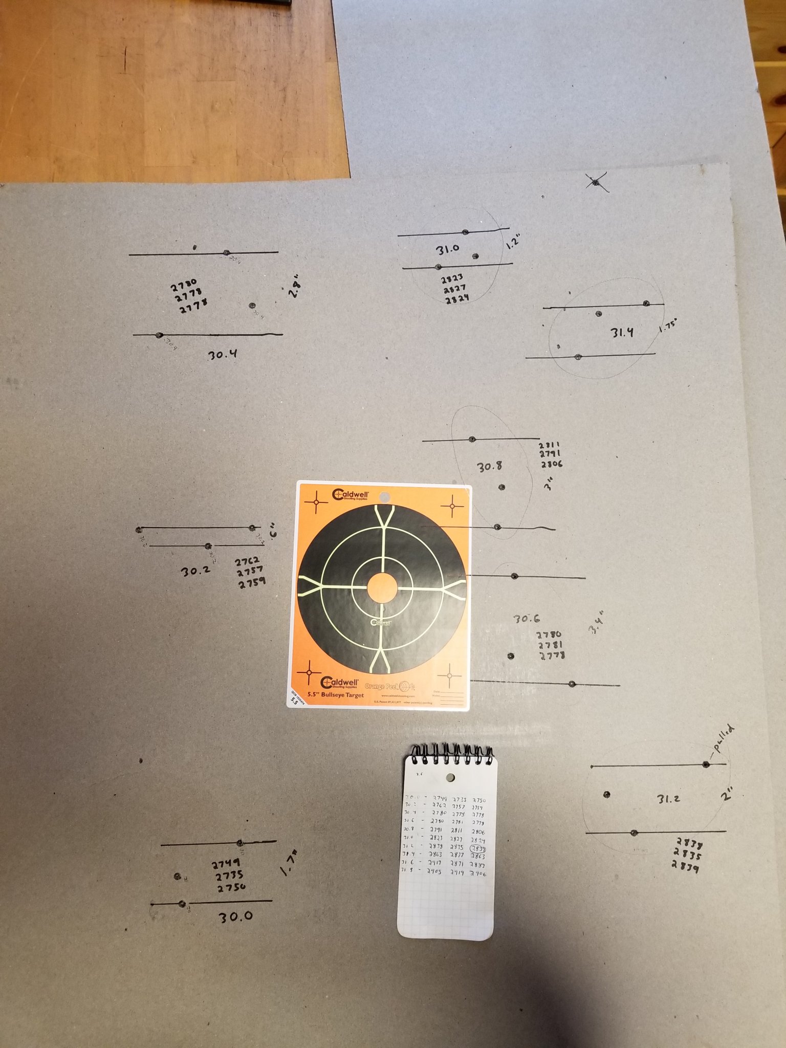

All the 6mmBR brass that I loaded previously as virgin brass I used reduced loads, which was a good idea, you'll see why in a few.
Since my 30.4 grains of Varget load/105 hybrid shot so well, and there weren't over pressure signs, I thought to myself, well I'll just use that charge in the 50 remaining virgin brass I had left. I had all of them charged with powder then I grabbed the first case and bullet, attempted seating the bullet with my Wilson arbor seating die, and could not seat the 105 hybrid bullet all the way in to the set depth of .005" off the lands??!! A super compressed load condition happened.
Turns out that with my "neck sizing" only die, which does not size the body of the case, a fired/fireformed case is expanded enough that the 30.4 gr of Varget fits fine but not in a virgin case, with respect to seating at the depth my freebore has! Always a first time, right??? I haven't run across this before, at least not to this extent. So bummer to me, I pored all the powder from the cases back into the powder hopper :confused:. I then reduced the load 3% and finished seating bullets with no problems.

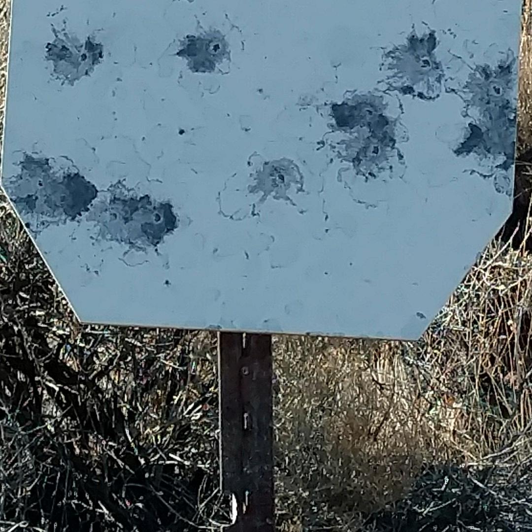

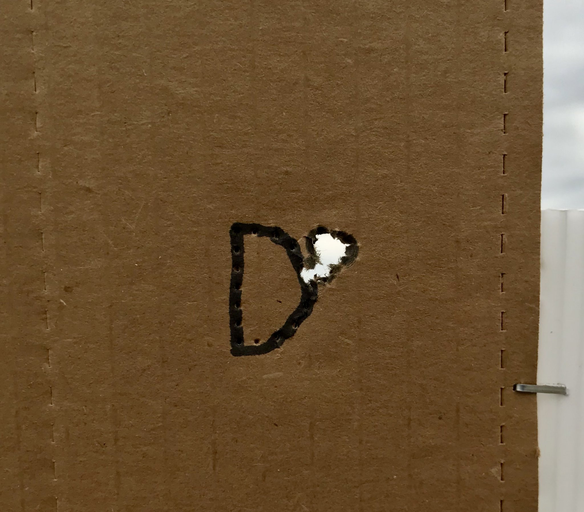

This morning was one of those very rare really awesome shooting days! That 29.4 grains of Varget reduced load, in the virgin brass, shot extremly well at 1025Y, like 4-5" vertical, and I hardly missed a 1' wide steel in 1-4 mph winds. In contrast, my friend found it very hard to stay on steel with his 260 and 6.5 Saum. I think the tight vertical and low ES the 6mmBR case gives made the difference, as well as how accurate it is!
I shot one group at 100Y for the heck of it, 5 shots touching into .282". My friends rifles weren't shooting the best, both just over an inch which would explain why it was hard for him to connect.
I'm pretty happy with 6mmBR now!
This is that steel I mentioned that was at 1025Y. I cropped out my friends 3 hits which were higher up on it, and so the darn file size would work.

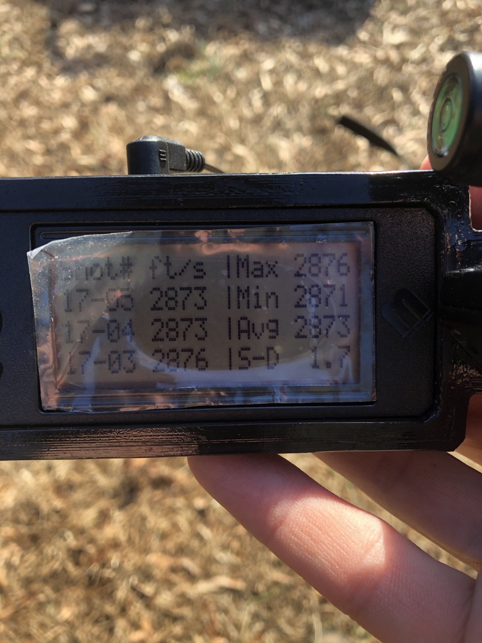

interesting day yesterday with the new xcaliber barrel...
I shot 65 more "break in" rounds of the baseline 29.0g load.
Right off the bat I was .4mil lower at 100yds than 2 weeks ago without even touching the rifle in between. but whatever, re zero'd and kept shooting.
After some positional practice with the 29.0g loads I had a mini charge test loaded up in virgin brass. 29.0g - 30.0g in .2 increments.
my original 29.0 load sped up about 20fps to about 2775. 5 shot group was wacky because my dumbass didn't check my magneto mounting and first round struck the chrono. doh. 2 shots were 4" from each other and two didn't even hit the paper. so idk wtf happened there. i got good MV data on the 4 rounds after the 1st strike. Why they didn't hit the paper is beyond me.
so i shoot the 29.2g load with acceptable chrono numbers - but shitty group. over 1.5"
29.4g - again, good chrono numbers. but shitty group. over 1" (all of these shots were grouping 2" low and 1.5" of my original zero i started the day with, also odd)
29.6g - everything starts coming back to normal. now i'm in the 0.75" group range. MV 2843 - SD 4.8
29.8g - MV 2859 SD 3.4. ~.75" group
30.0g - MV 2871 SD 1.0 ~.75" group
so my point to all this jibberish is i'm confident I got good chrono data and i'm liking that 29.8-30.0g range. but idk if something came loose on the gun or excessive copper fouling caused all that weird POI shift and less than impressive groups or what. so i need to explore a little more.

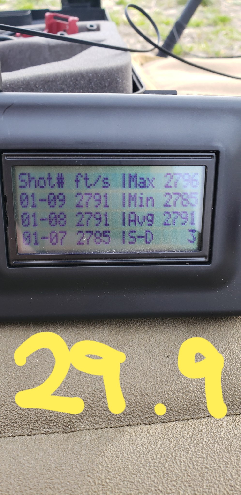

29.9g looks promising though if the groups tighten up. then as soon as i get the chance I'll test vertical spread at distance and mess with seating depth
I had sent 3 neck sized only cases that had been fired 3 times off to Harrell's for them to find me a FL size die and received it back on Saturday.
Harrell's has different die sizes to size at the .200" line/near the web of the case, in which to match the appropriate size die to the fired brass. The FL bushing die they sent seems to resize perfectly! Very little effort required to FL size.
See post #59 - That 30.4 grains of Varget fits in the FL sized cases perfectly, right to the bottom of the bullet. If it's compressed at all I can't feel it.
I tried the latest reloads made from the new die yesterday afternoon. Too easy hitting the 982Y 15" plate/.8 mil windage, and the 21" plate at 1122Y/ 1.1 mil windage!
No bolt click on the up stroke so the die is sizing minimally.
Got the feed lips bent on the AICS mag to the correct places so the feeding issue is solved.
Learned some things along the way but Very pleased at the final results, guess I'm GTG now!

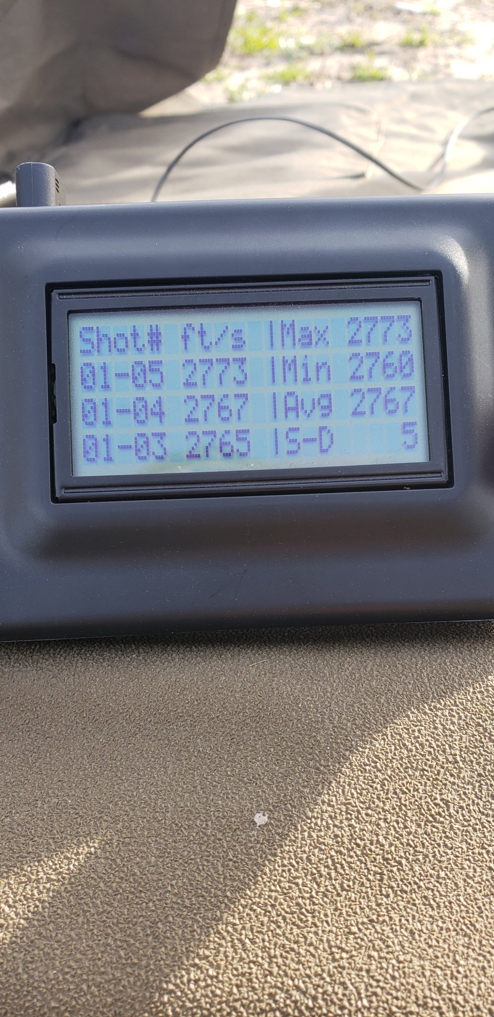

My load with a PVA 26”
105 Hybrids
29.6 H4895
CCI 450s
2884 avg
Single digit ES

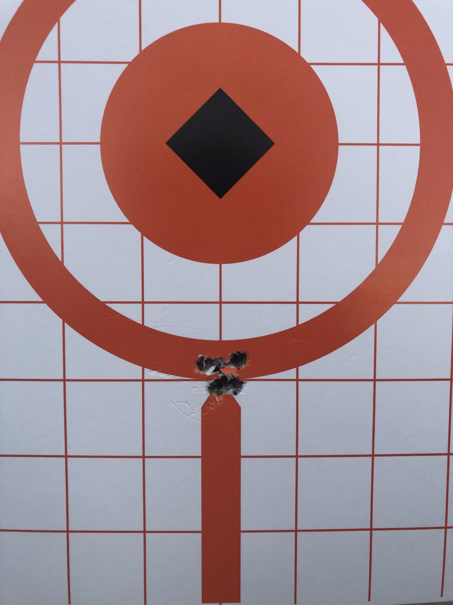

Shot more of the 29.5gr H4895 load with 105gr hybrids. Temp was 38 degrees F. Noticed I was impacting high at 700 yds. Took off .1 mil of elevation and was right back on. StrelokPro extrapolates the velocity at 2785fps. Looks like my 26” PVA Barrel is speeding up a little at a time.

I finally figured out how to post my 1025Y photo from my computer, before hand when I tried to post the full size photo it would fail. I had to crop it to reduce the file size which worked. Honestly there were 3 higher hits that my friend who was also shooting at the same steel claimed as his. He was using a Swaro X5 at 25x and said he saw his hits so who am I to disagree :p Me at 20x, I could only make out the horizontal line starting to appear as I kept shooting. Then I smiled when we went to pick up the steel.
It's in post 59 and there were a few splats that had two or three hits in them. I used from 0 holdoff to .4 mil holdoff, as you can see the pattern is all across the whole steel.
