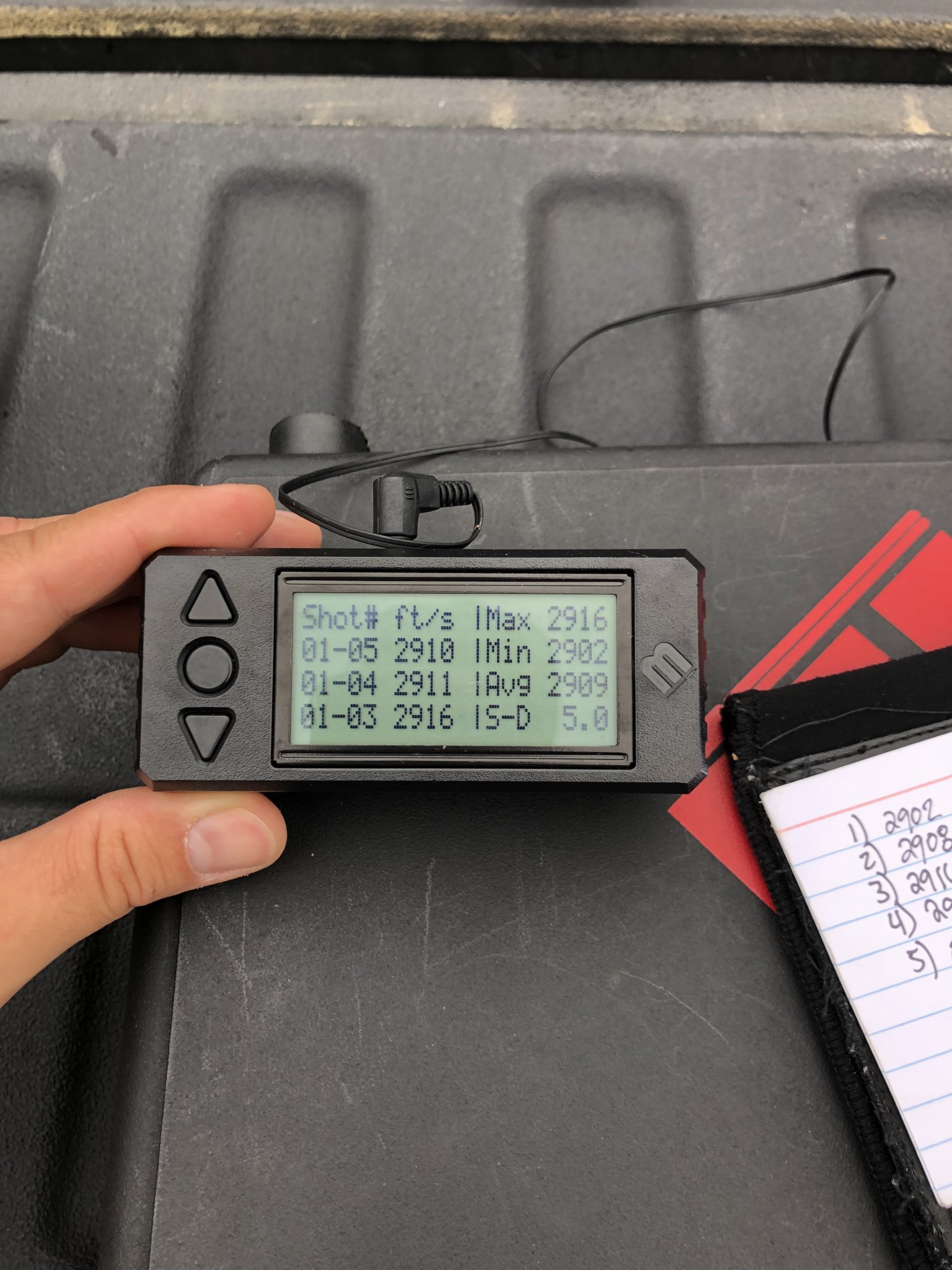

Out of my AI AX 26” Win Tac 6BR 30.4grs Varget, BR4’s, 105gr Berger HT, 1.645 CBTO moving at 2910fps have been absolutely moneyI luv Discord, I was able to get 5lbs of Varget from Natchez and 5lbs from MidSouth this week. I should be GTG for the 6BR, well, once the AI AT-X arrives. Seems 30 - 30.5grs of Varget in Lapua Brass over the Berger 105 is a hammer, but I'll work up a load for the AI.
^^^^^^^^^^^^^^^Out of my AI AX 26” Win Tac 6BR 30.4grs Varget, BR4’s, 105gr Berger HT, 1.645 CBTO moving at 2910fps have been absolutely money
29.8grs was 2850fps over 6rds with SD 4.2 ES 10^^^^^^^^^^^^^^^
