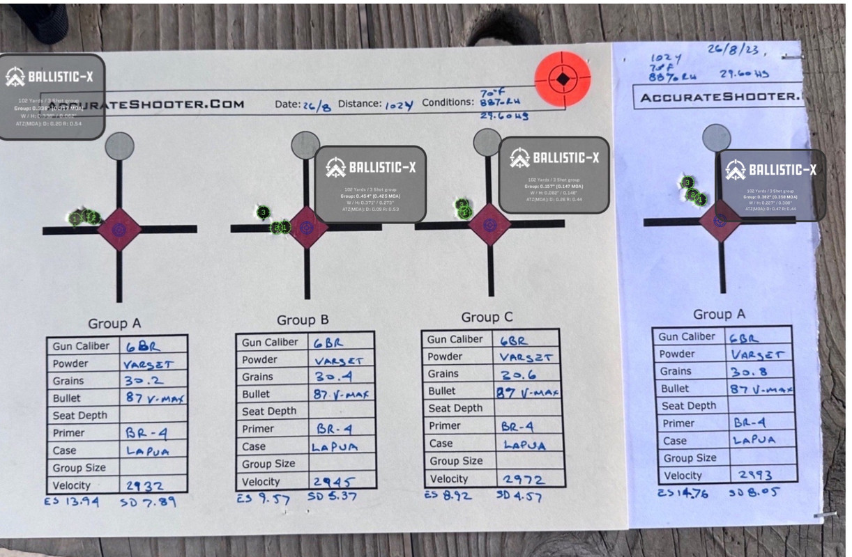

Dedicated varmint round with the 70s? Most guys with that plan go with zero to 0.050 freebore. The whole caliber diameter of seating depth minimum is old wives tale stuff. I ran my long freebore 6bra in a 140k freebore with 105s that we're maybe seated 170k into the neck jumping 40k and it shot amazing. As long you have 120-130k of bullet supported by the neck, you'll be good.
Reactions: lash
I really wasn’t planning to shoot this caliber but someone I knew bought a barreled action for the action itself and sold me the barrel for next to nothing. Other than the caliber and twist raté there are no markings as to who made the barrel.
It’s a 1-10 twist which is why I’m using light bullets.
I shot the 87gr V-Max yesterday with promising
results.
I’ll be shooting the 70gr this morning.
What surprises me the most is the lack of any heat in either the casings or the barrel compared to my 6.5 Creedmoor.
The barrel was virtually the same temperature the ambient air.
The casings were the same.
