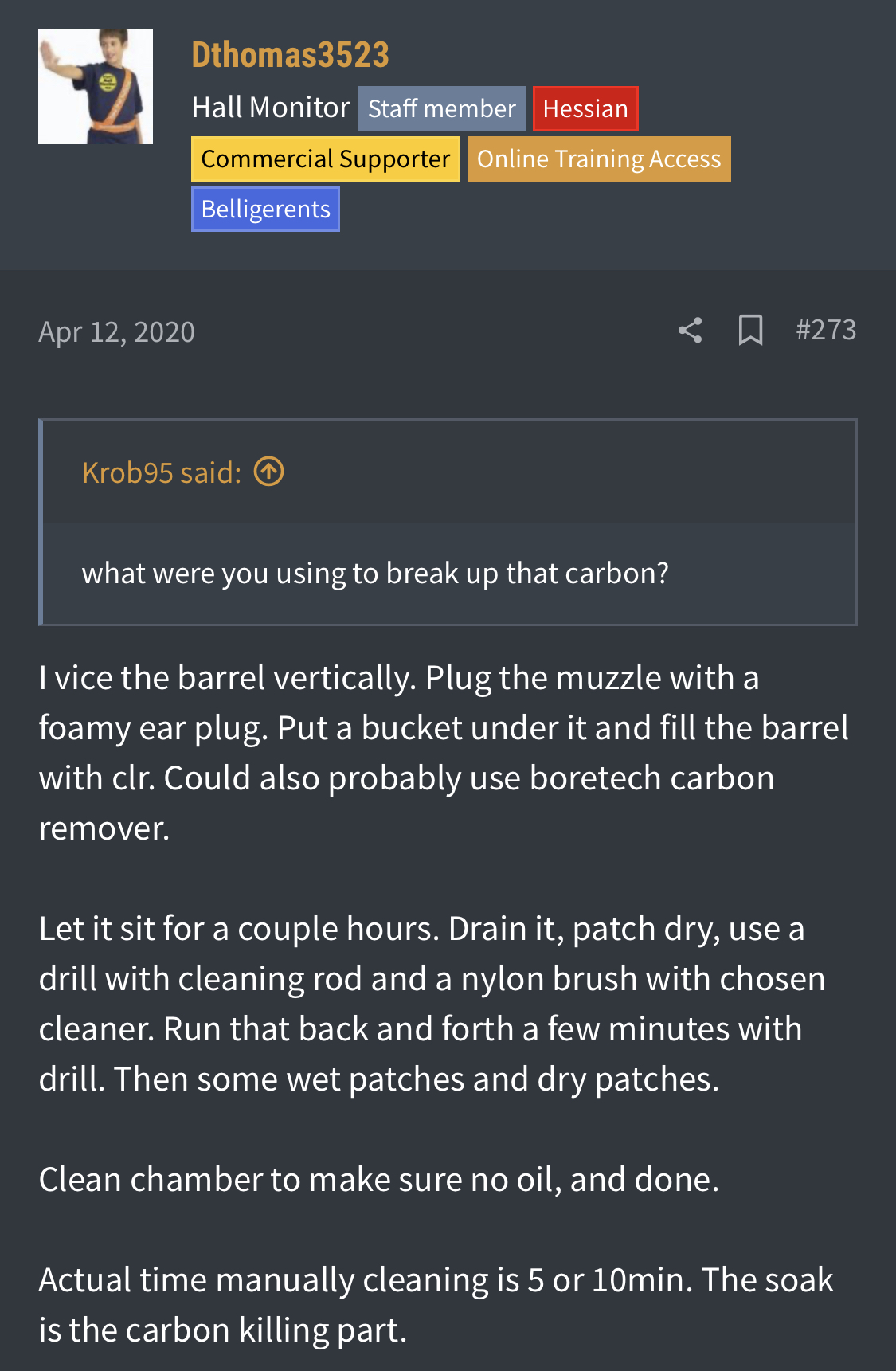

Did you clean the carbon ring the first time?? Either way, how did you clean it and with what chemical/chemicals? I had the same issue with a carbon ring and thanks to @Dthomas3523’s suggestion for cleaning, I got it taken care of. I’ll clean my barrel every 250 rounds or so and I’m shooting 30gr varget under a 105 as well.
Reactions: Dthomas3523
I will use bore tech Carbon and bigger brush to get in the throat and spin it. A bench rest guy told me to try a brass brush with lead core or something like that. It’s an ar 223 style that obliterates the carbon ring. I noticed carbon rings during break in as well. It really has sucked. I do have stubborn carbon in the first stretch of the barrel but I haven’t been quite as worried about that. I do plan on performing that cleaning dthomas recommended and may give n540 a try or whatever I can find.
What is the @dthomas cleaning method?

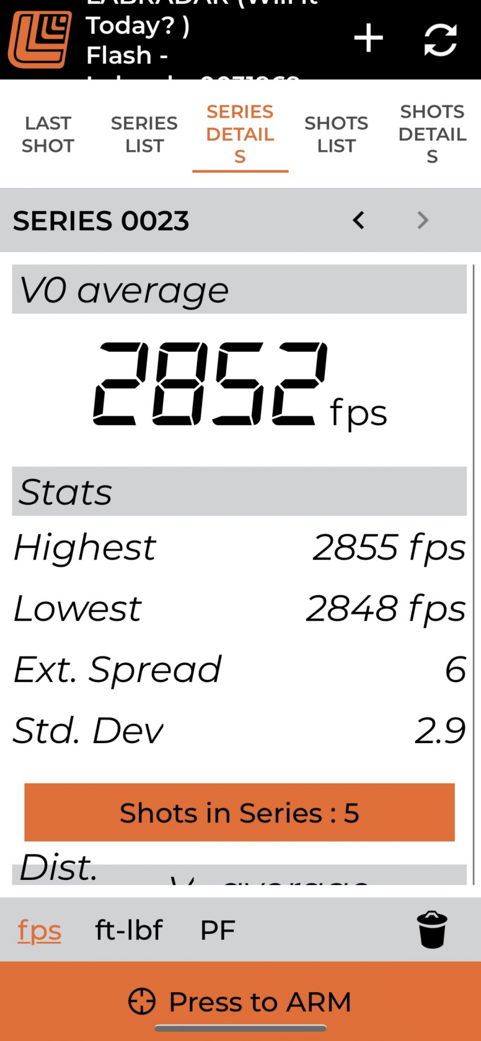

Had my first split neck yesterday.... switched primers from BR4’s to 205M and also lost about 40fps on the same load. But on a 5 rd string I had a sd of 2.9 and ES of 6. Curious if you guys have run into issues with loads slowing or speeding up with different primers?
40fps is a big drop when was the last time you checked velocity and whats the total round count on that barrel?
Last time I chrono’d my old load was about 100 rounds ago now after yesterday’s 80 I sent at the range. I was running an avg 2885fps with 105’s and 30gr varget with BR4’s. I chrono’d yesterday as these are my first loads with the 205m primers and had an avg of 2853. So I guess not quite 40fps but still a significant drop in speed. The barrel is a kreiger HV and has about 1400 rounds on it.
@Krob95 What barrel brand, twist configuration and length are you running?
I have 1-25" bartlein 5r with 30grs varget is 2780 w/105's
1-25" original spencer barrel 29.6 RL15 is 2820 w/105's

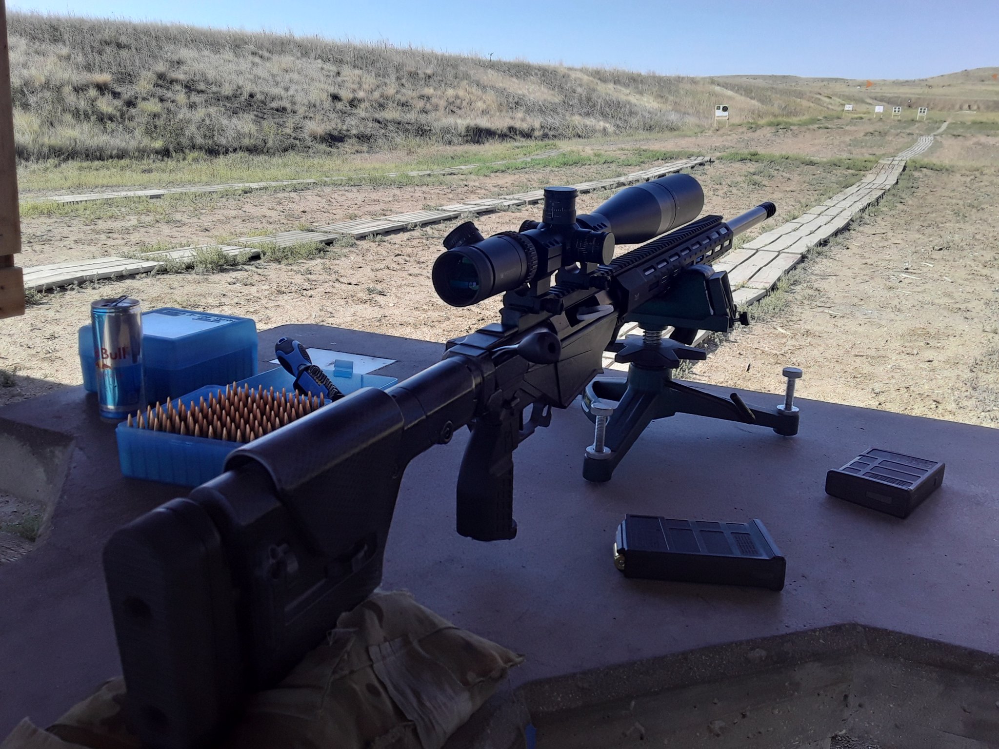

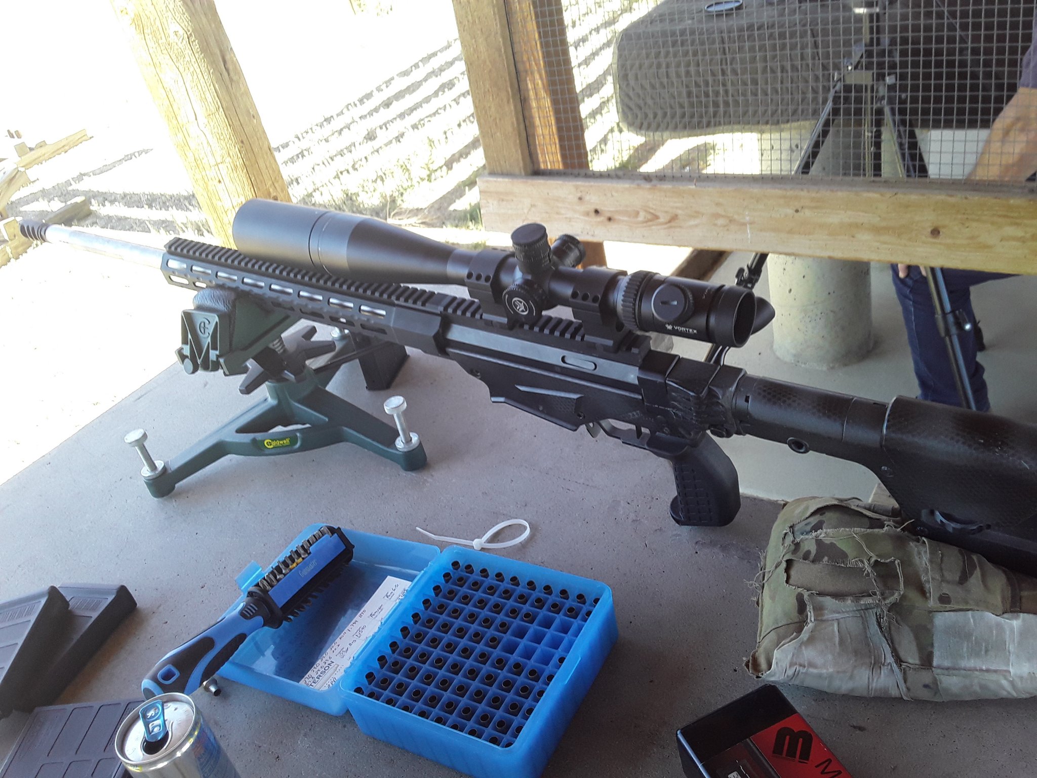

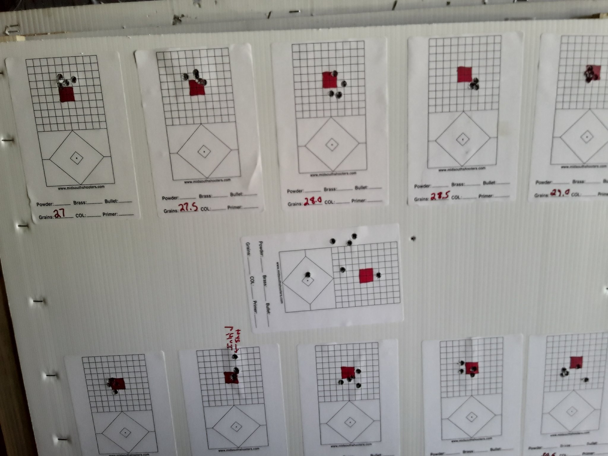

So my set up is:
RPR
PVA 26" 6BR barrel in stainless
Magpul PRS stock
M4-72 extreme duty brake
Vortex High scope rings
Vortex PST 6-24
Timney 2 stage trigger
MI 15" handguard MLOK
Magpul Bipod
Anarchy Penguin Grip

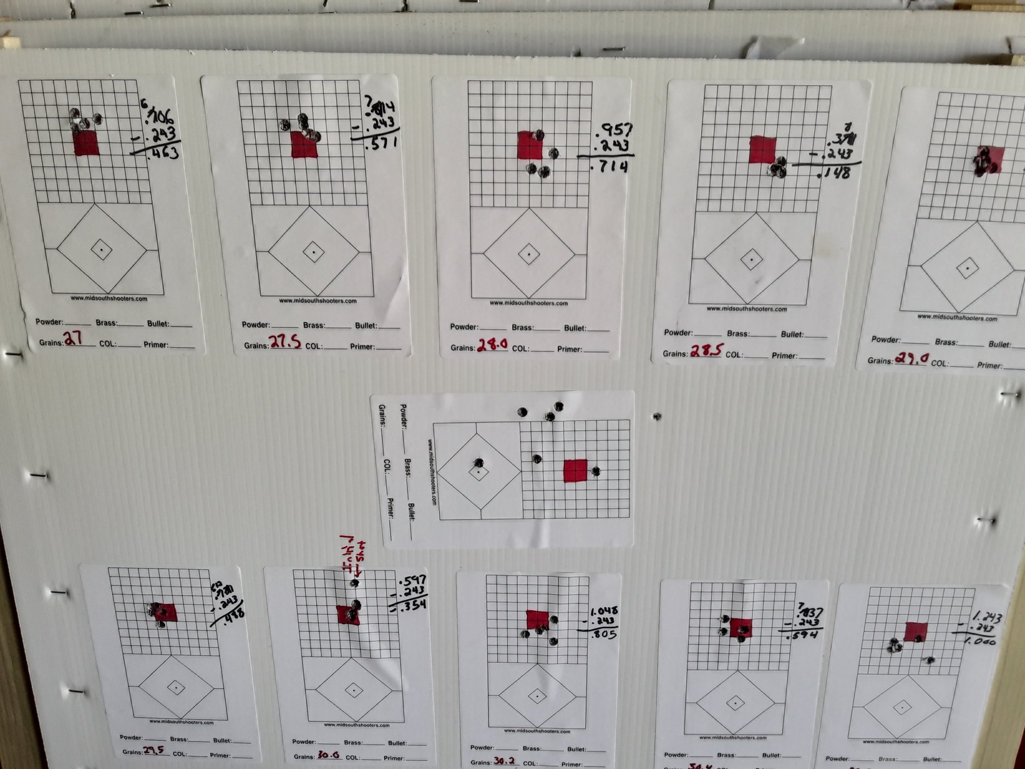

All loads are:
Berger hybrid 105gr
N540 powder
Federal match SRP
Peterson Virgin brass
All loads marked on target as to weights.
101yds
No velocity taken
28.5 gr definitely looks the best. Why did you go with Peterson brass over lapua?
Actually it doesn't and most people would fall into the smallest group load but thats not correct...you are to ignore smallest groups when doing load development and are looking for consistent point of impact. I would also work in that 29.0-29.5 range as POI is very consistent
