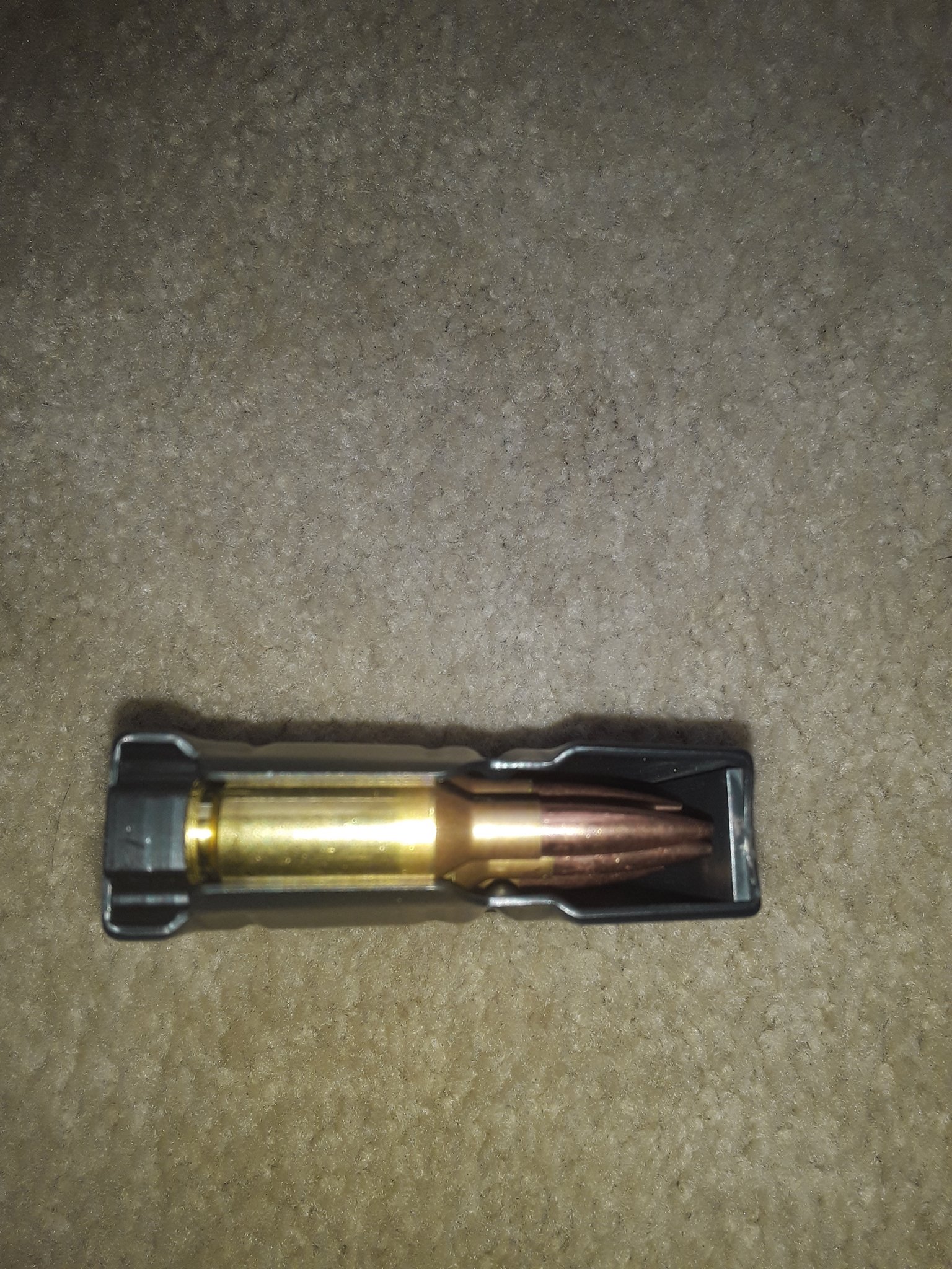

It feeds really well. Zero issues. I have the MDT 12rd mags and I haven't had any feeding issues. 1 out of maybe 30 will not eject properly. But it's only happened twice now.

MDT 12rd 6BR mags
