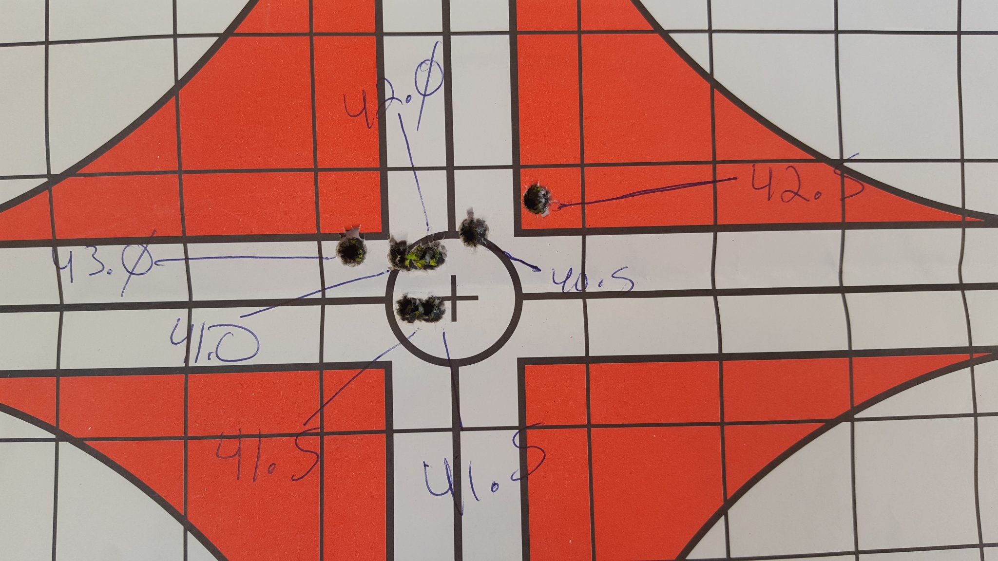

H4350 (40.5gr-43.0gr)
- loads were done in .5 grain incremends, beginning at 40.5 gr and running up to 43.0 gr
- velocities ranged from around 2950-3100 +
- the group in this test was significantly better, with a total group size of about 1.5'' and with relatively clear accuracy nodes betwen 41.0-42.0.
- Note that in this test I did shoot x2 of 41.5 gr (they are the two shots at 6 o'clock that are touching).
- no pressure signs at any point.
My next step is to continue working with H4350, especially around 41.5gr. Any thoughts? Again, I'm happy to receive any and all feedback.

My only thought is that 100 yards is too close to do a ladder test. Push it out to 500 and give gravity time to do its thing.
I appreciate the comment. Let me raise my concern and then get your response. When it comes to these kinds of reloading tests, it seems to me that it is best to remove as many variables as possible, so as to achieve the most accurate results from the test based on the most consistent factors. I am quite confident in my ability to hold a precise point of aim at 100 yards, in part because I can see clearly where the cross hairs lie in relationship to my target (esp these grid targets). My confidence goes down, however, the farther out I go, again in part because of how well I can see details of my target in relationship to my reticle. The father the distance, the less precise the aim and the more difference a small variation in POA can make. Does this make sense? I'm open to critique/feedback of course.
With all that said, I think I'm correct in concluding that--even at 100 yards--these little ladders test have provided some significant data about the usefulness of the two powders for my specific gun.

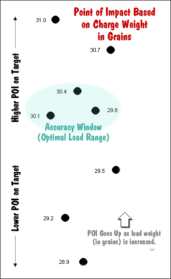

Well those could all be randomly dispersed in a larger group and you have no way of knowing, you want gravity to work on the bullets at distance.
With a ladder test at 100 you don’t know if you’re seeing this
Or if you’re seeing this
If you’re going to stay at 100 do an ocw.

So with a ladder you are looking for this confirmation of positive compensation.

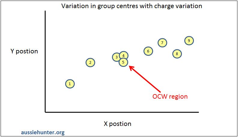

If you cant do that at distance then I would suggest you go for the OCW method
http://optimalchargeweight.embarqspace.com/ocw-overview/4529824091
If you were to lay all of your charge weight targets on top of one another, centered on the aim points, you want to find a point where consecutive charge weights impact in the same area.
This can be run at 100 yards to map the barrels behavior. Its not about group size, you can alter that with seating depth in a second step, but you want the group centers to be the same.
Lets consider charge weight 4: when it freezes in winter that same amount of powder burns slower so less velocity is the result (charger weight 3). Or if its scorching in summer you get more velocity (charge weight 5) but you still hit where you aim. However if you identified your node as 8 when it gets hot you would be hitting high to the right away and if it got cold you wold be hitting high to the left but neither would be your point of aim.
