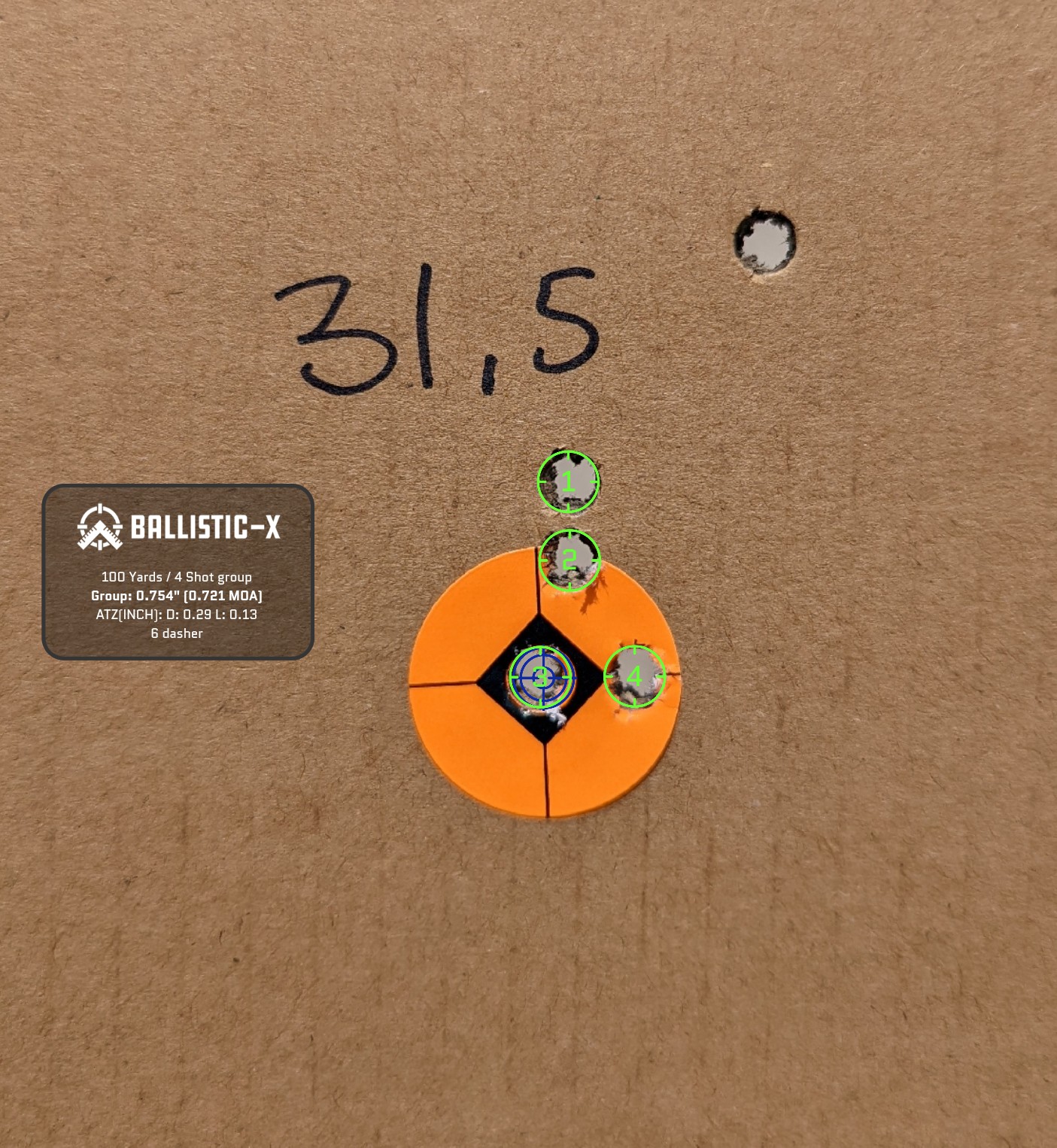

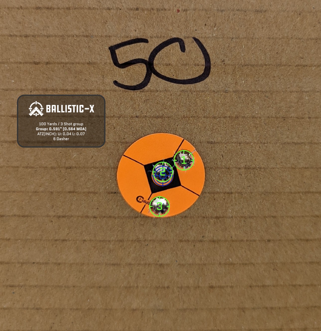

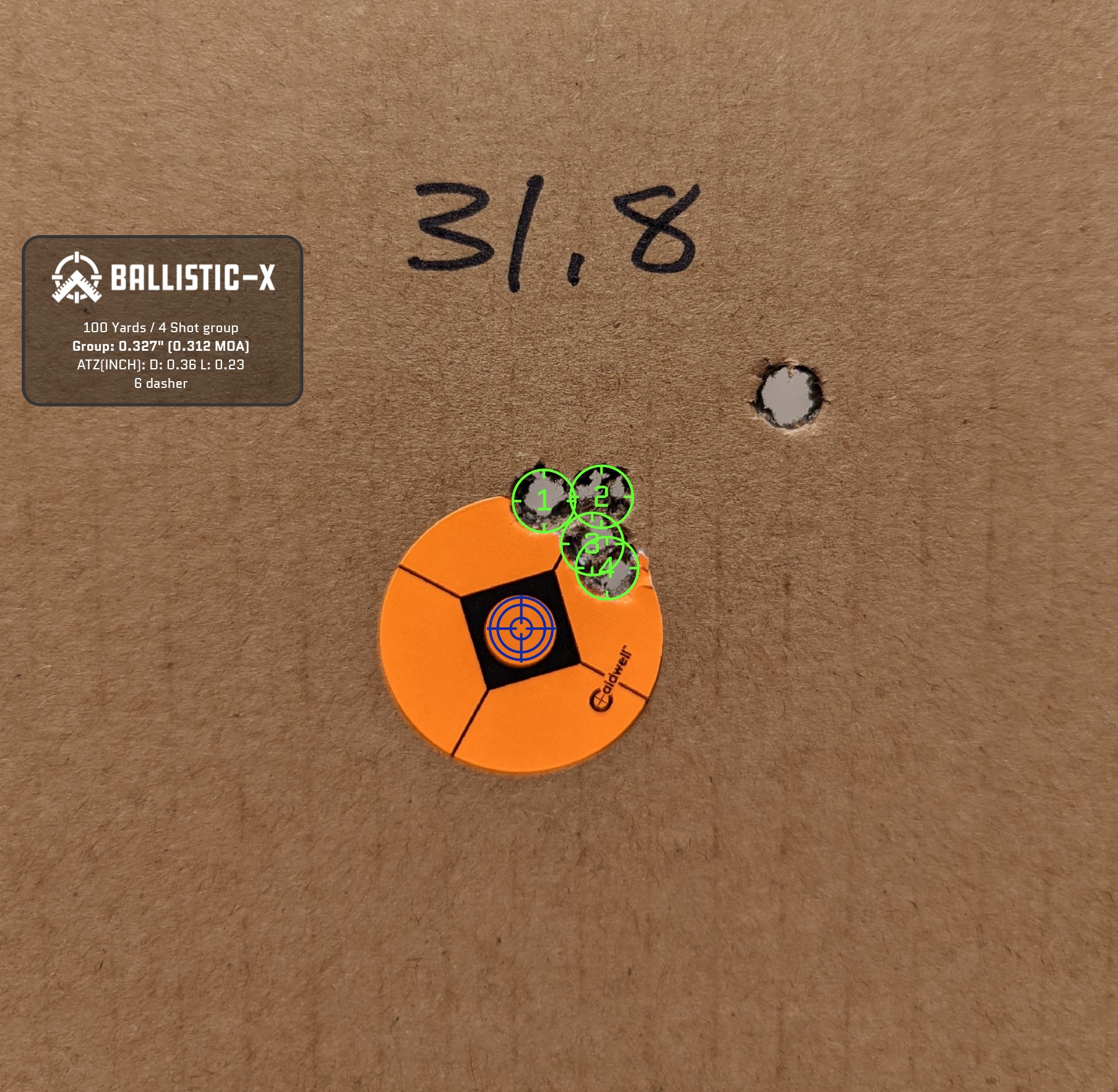

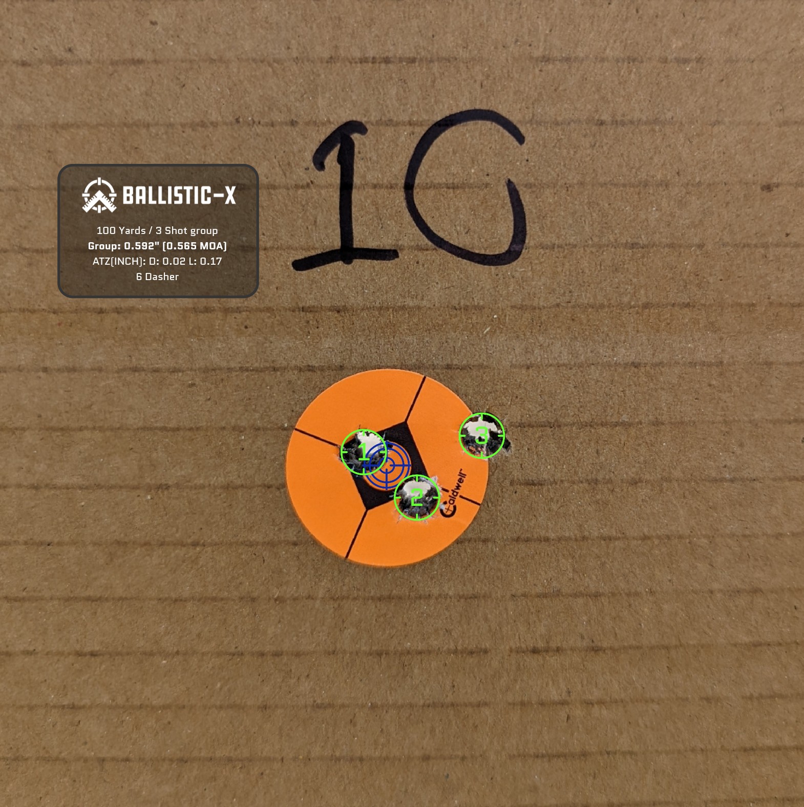

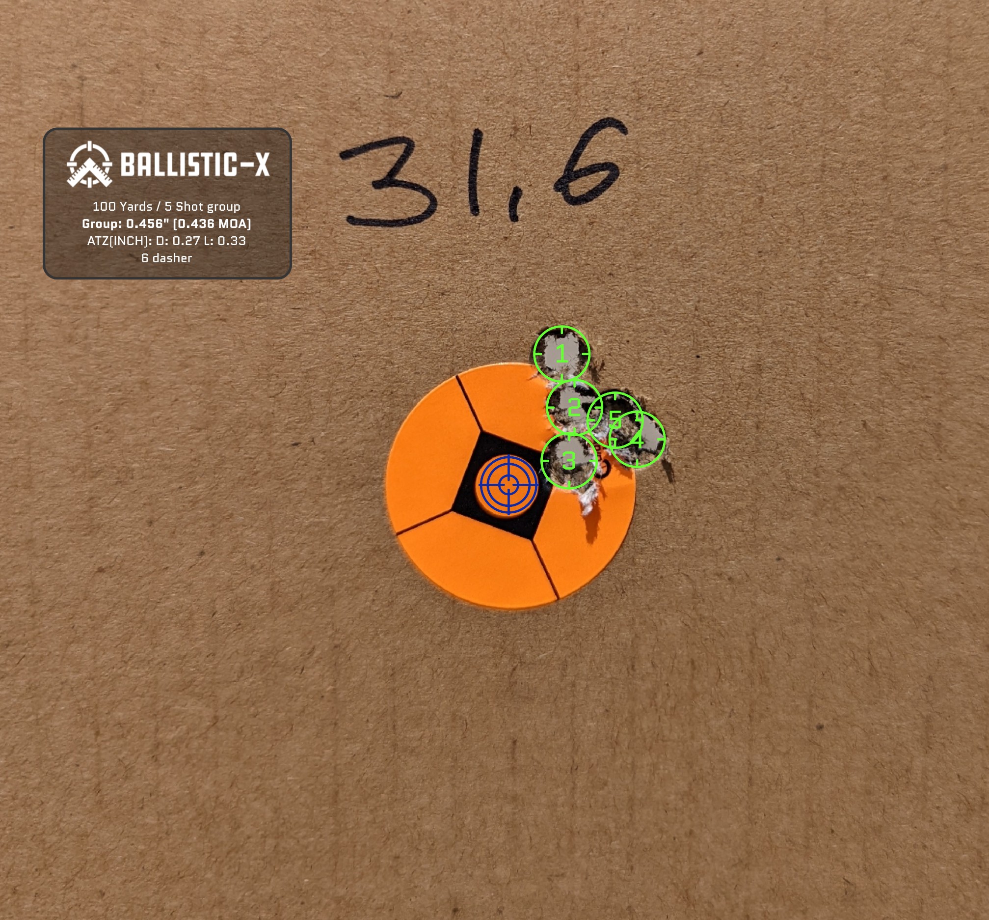

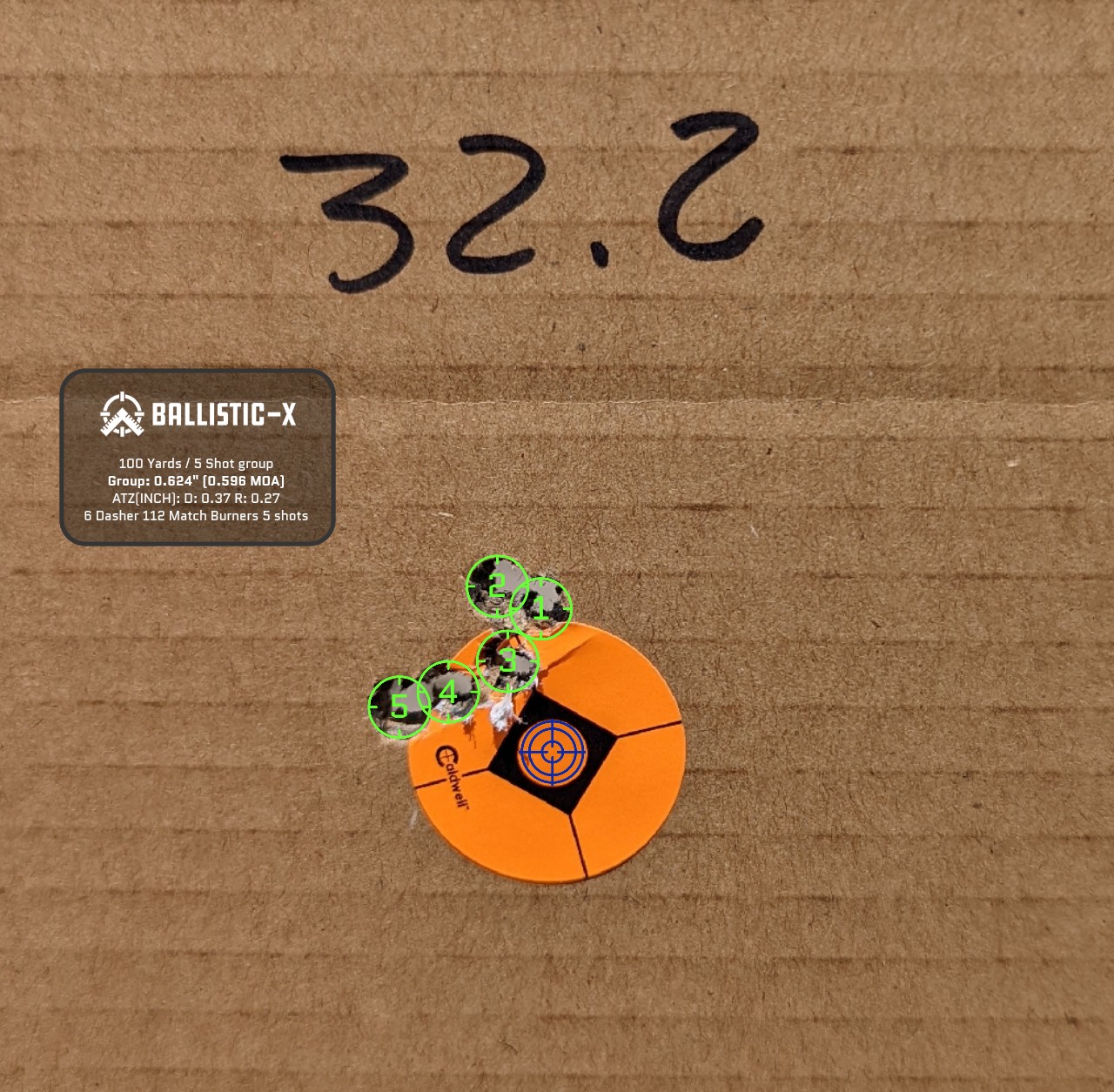

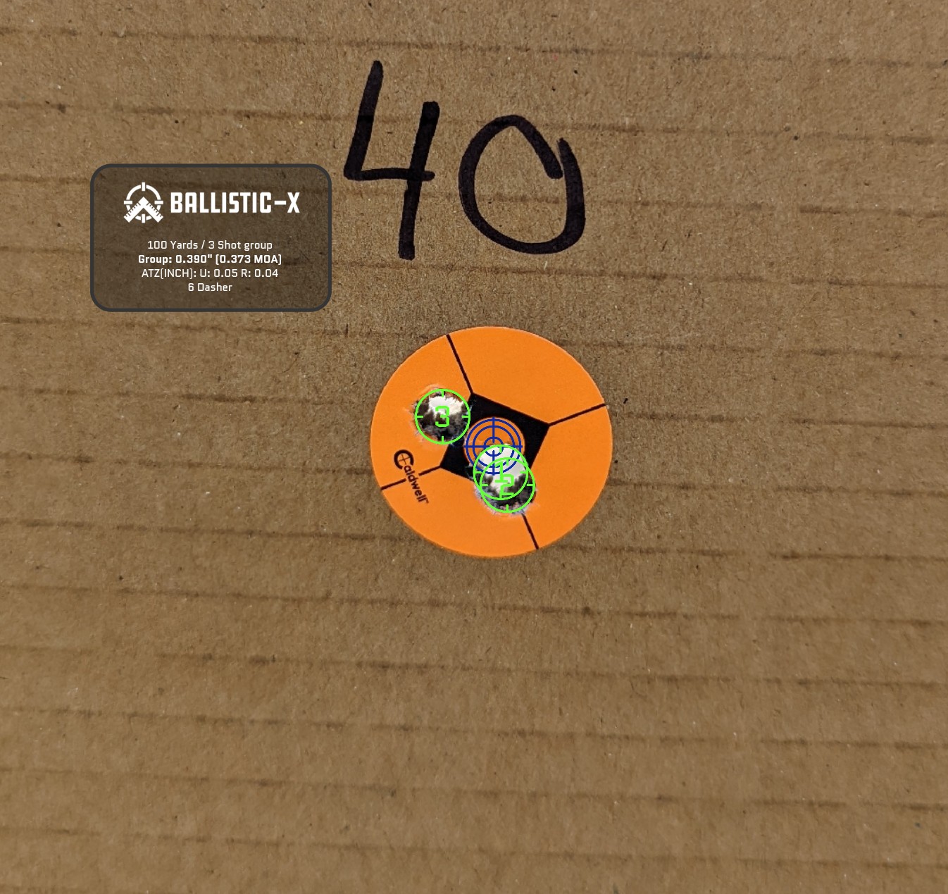

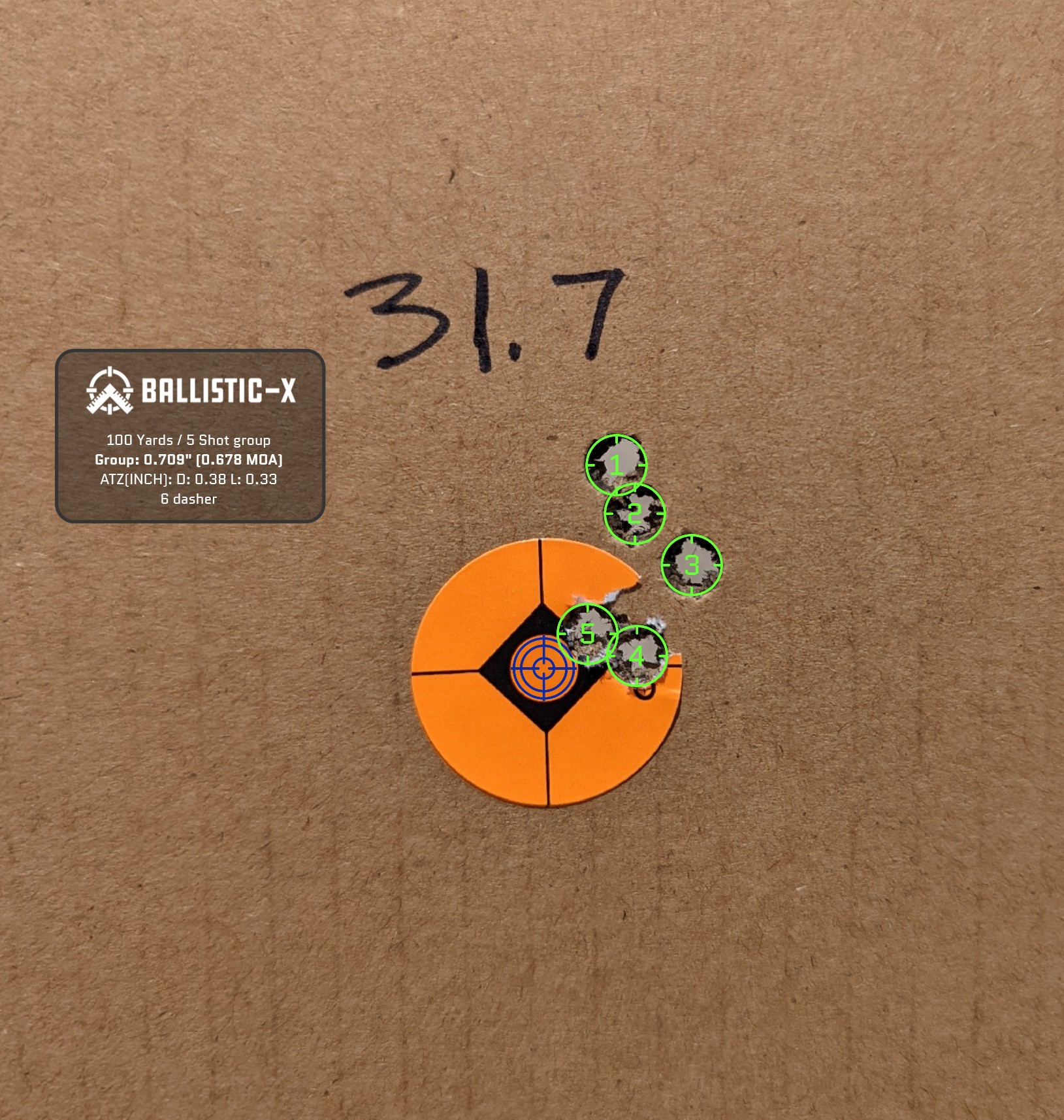

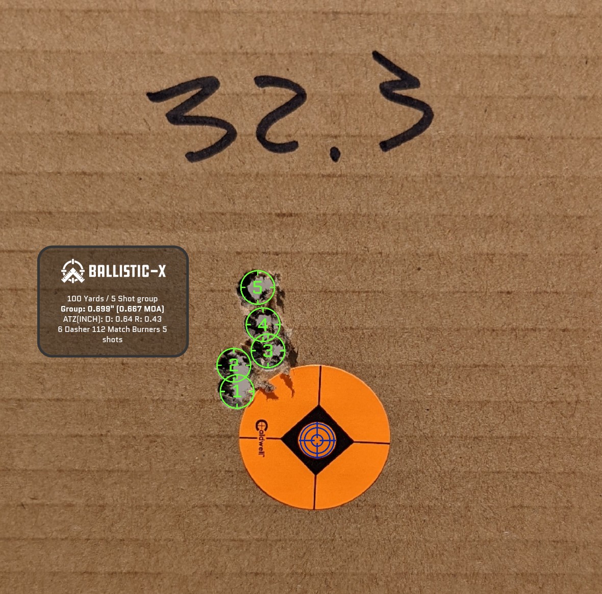

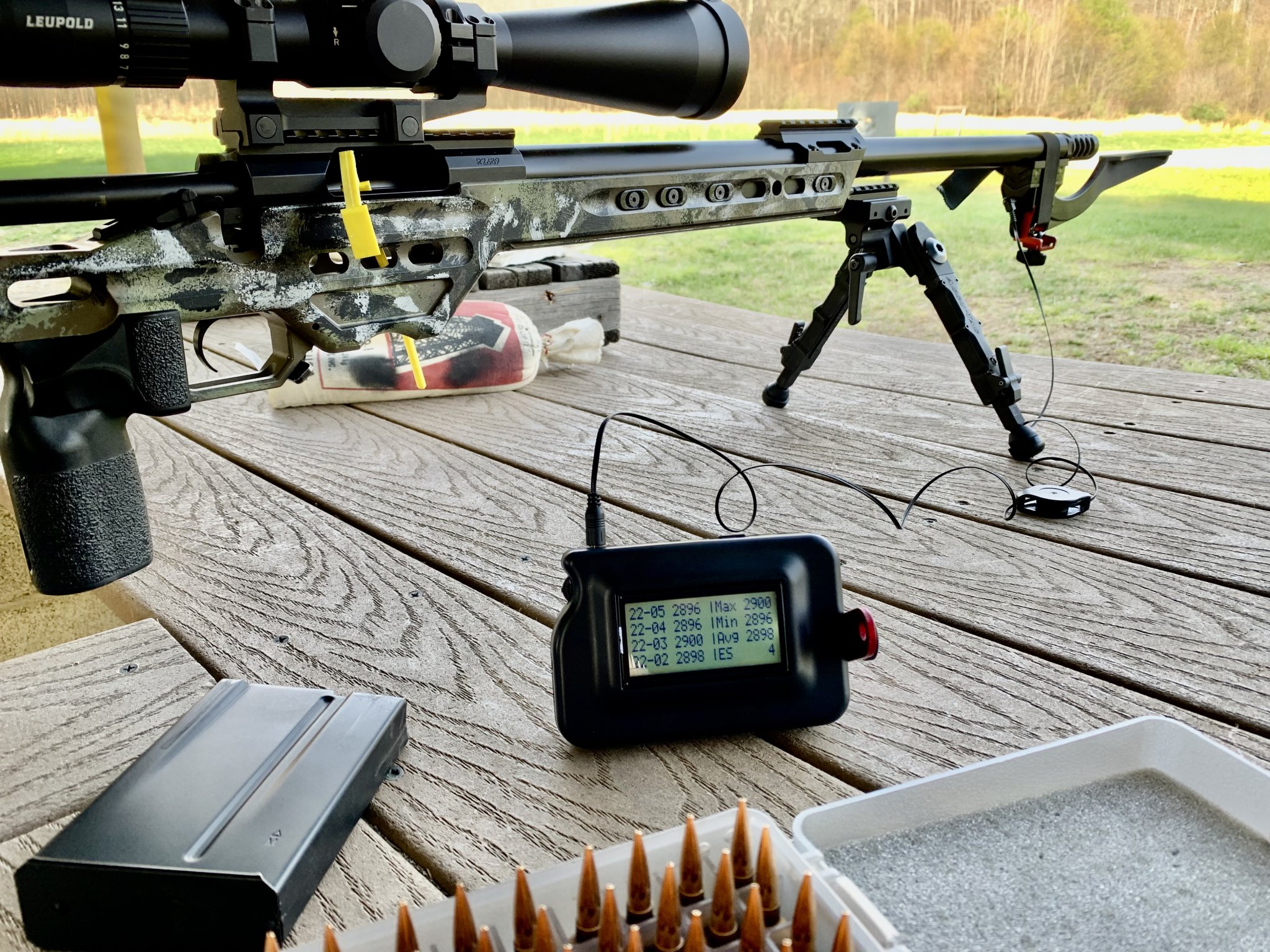

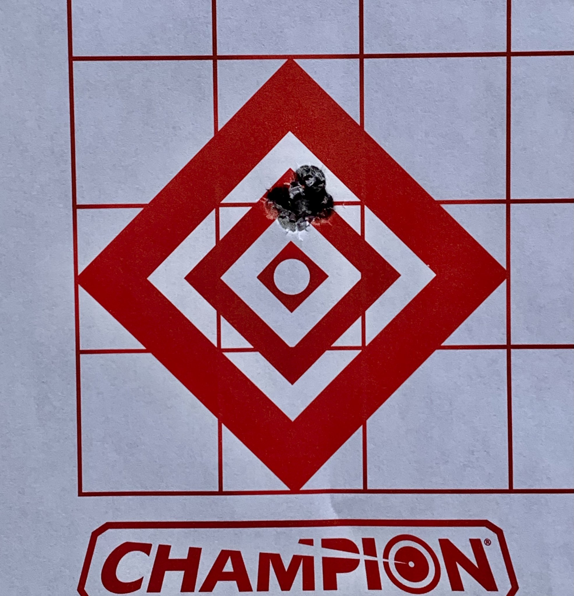

Did a charge weight test today with Varget, Alpha Brass, CCI 450, 107gr SMK.
Nothing to impressive because I sucked. Groups could be tighter but I shot poorly and allergies were kicking my butt.
I'm going with 31.7gr and testing seating depth next. These were all at .020" off jam.
ChargeAvgSDES
31.528758.623
31.62882613
31.728883.611
31.829016.316
31.929043.89
3229166.818
32.12923719
32.2292713.5273 shot
32.329445.412

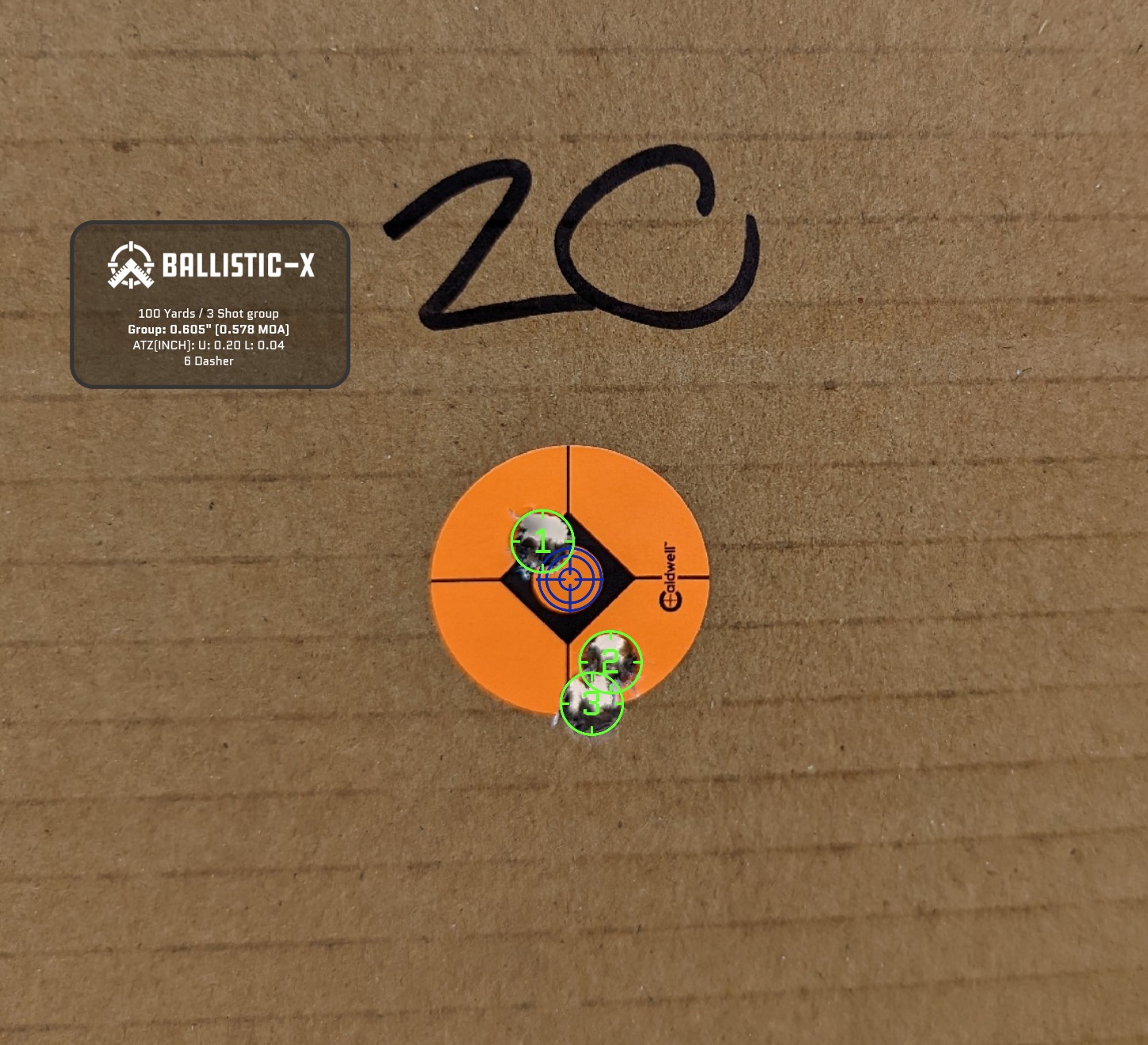

32.429443.79

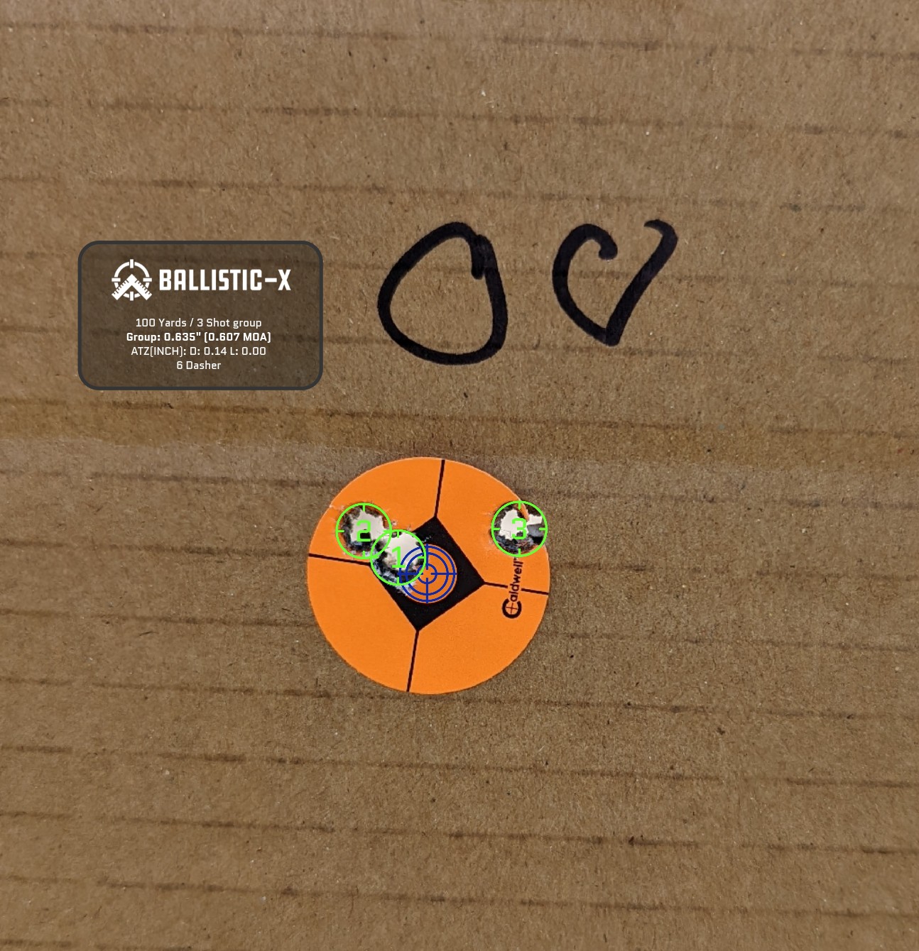

31.5 gr wasn't terrible; the first shot was my first shot after screwing on the barrel so I'm not sure if that is due to the AI barrel settling in after being torqued down so I'm ignorning that one. shot 2 was dead centered. Still .75" vertical stringing is on me since at 100 yard the 23 ES wouldn't do that.
31.6 gr was my best group. Although .45" isn't anything great.
31.7" more vertical stringing. With an SD of 3.6 and 2,888 FPS I'm going to try to work with this more. I know I can do better and should be able to tighten this up.
31.8gr, I'm cheating and ignoring a flyer. Maybe I'll revisit 31.8gr and 31.9gr later at some point to retest.
And then everything else above 31.9gr grouped poorly. It looks like I was getting to a high node around 32.4gr and I wasn't seeing pressure signs but that's higher than I'm looking to push it, I'm happy with medium velocities around 2,900 FPS.
Did more load development for the Dasher (and a little bit with a 6.5 Creedmoor) today. I still haven't dialed in a solid load for the 107gr SMK's, maybe .070 off jam is promising but would need more testing. I did find my barrel likes 112gr Match Burners so I'm going to work with those for now. Barrel is a PVA Osprey Barrel Works, 1:7, 26" M24.
112gr Match Burner data with virgin Alpha brass, CCI 450's and Varget. All loaded .010 off jam.
ChargeAvgSDES
32.12902613
32.229022.67
32.329159.827
32.4291711.430
32.529294.813
32.629424.513
32.7294211.732

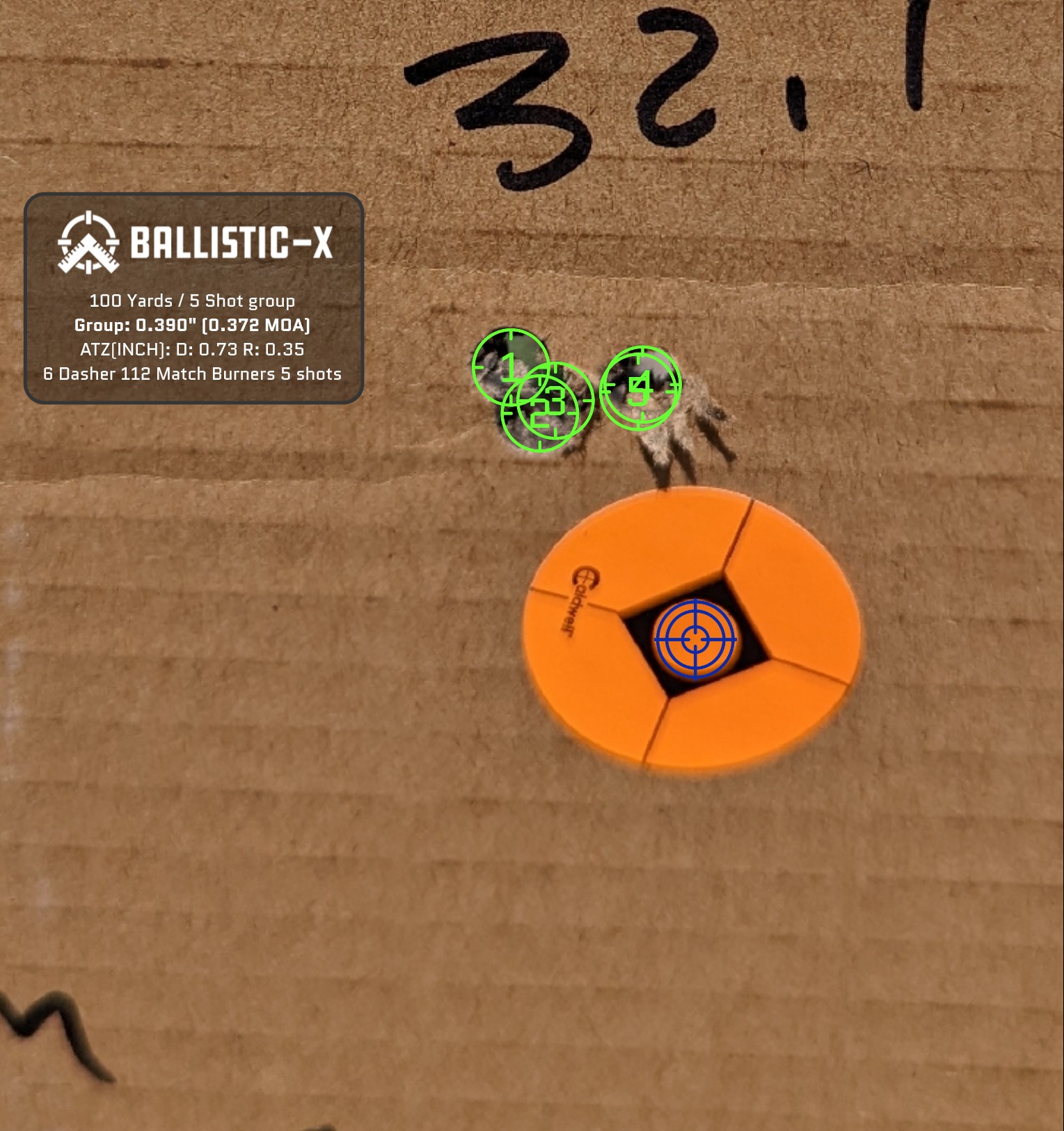

Any hotter loadings with either the 107's or 112's don't shoot well for me; 32.1gr looks like a winner until I shoot through my virgin brass and tweak the load. I felt like I could have done better and made this all a one hole group but I'm still happy with this:
32.2 was fair:
32.3 was starting to drop off and all the higher charges where mediocre.

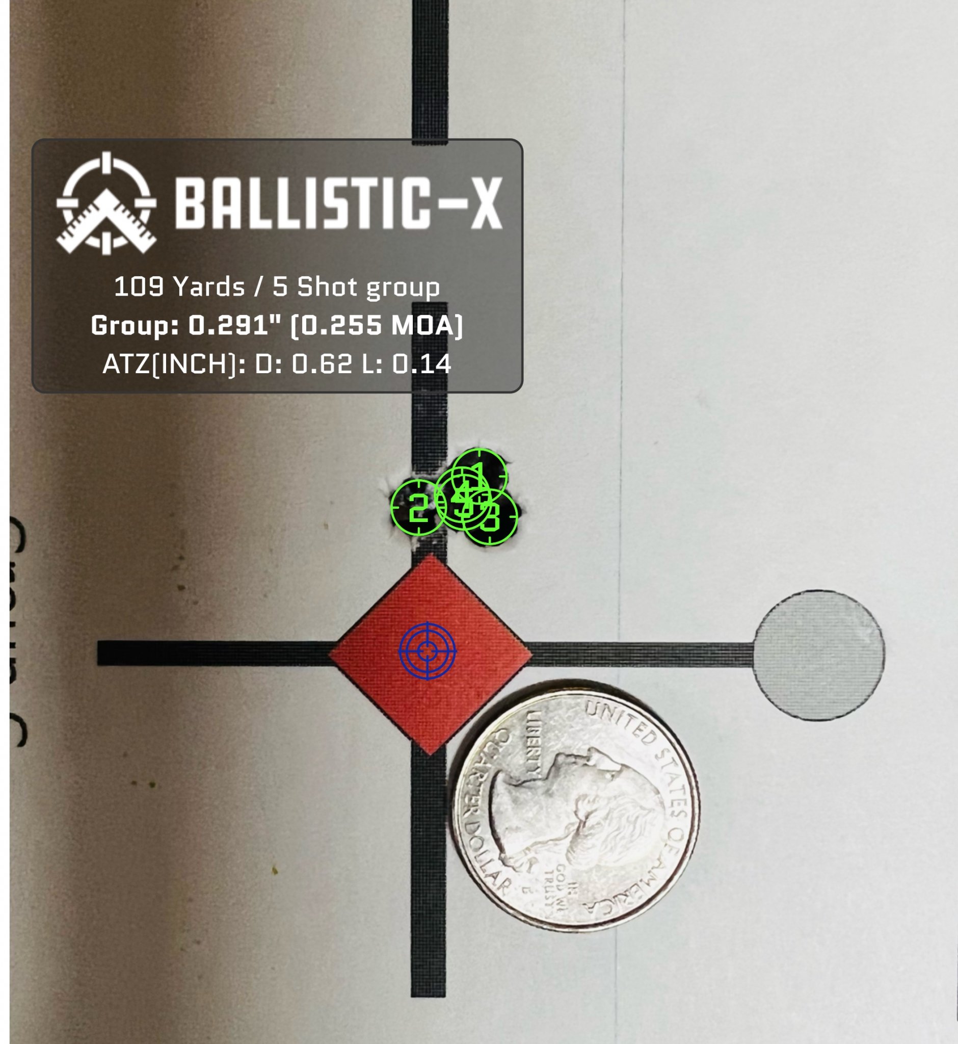

Did some load development with varget, imr4895 with new 109gr Berger 0.030 jump / alpha ocd / cci450. Will test seating depth next weekend. Bighorn Origin ss proof prefit.
Vaget
31.5 @ 2855 (5 shots ) ES 6
31.8 @ 2880 ES 16
32.2 @ 2922 ES 20
IMR4896
30.5 @ 2790 ES 10
31.0 @ 2810 ES 15
31.5 @ 2850 ES 23

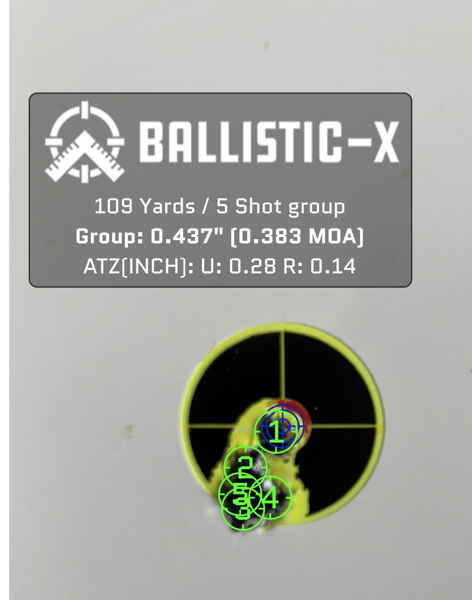

My initial testing with 112gr Barnes

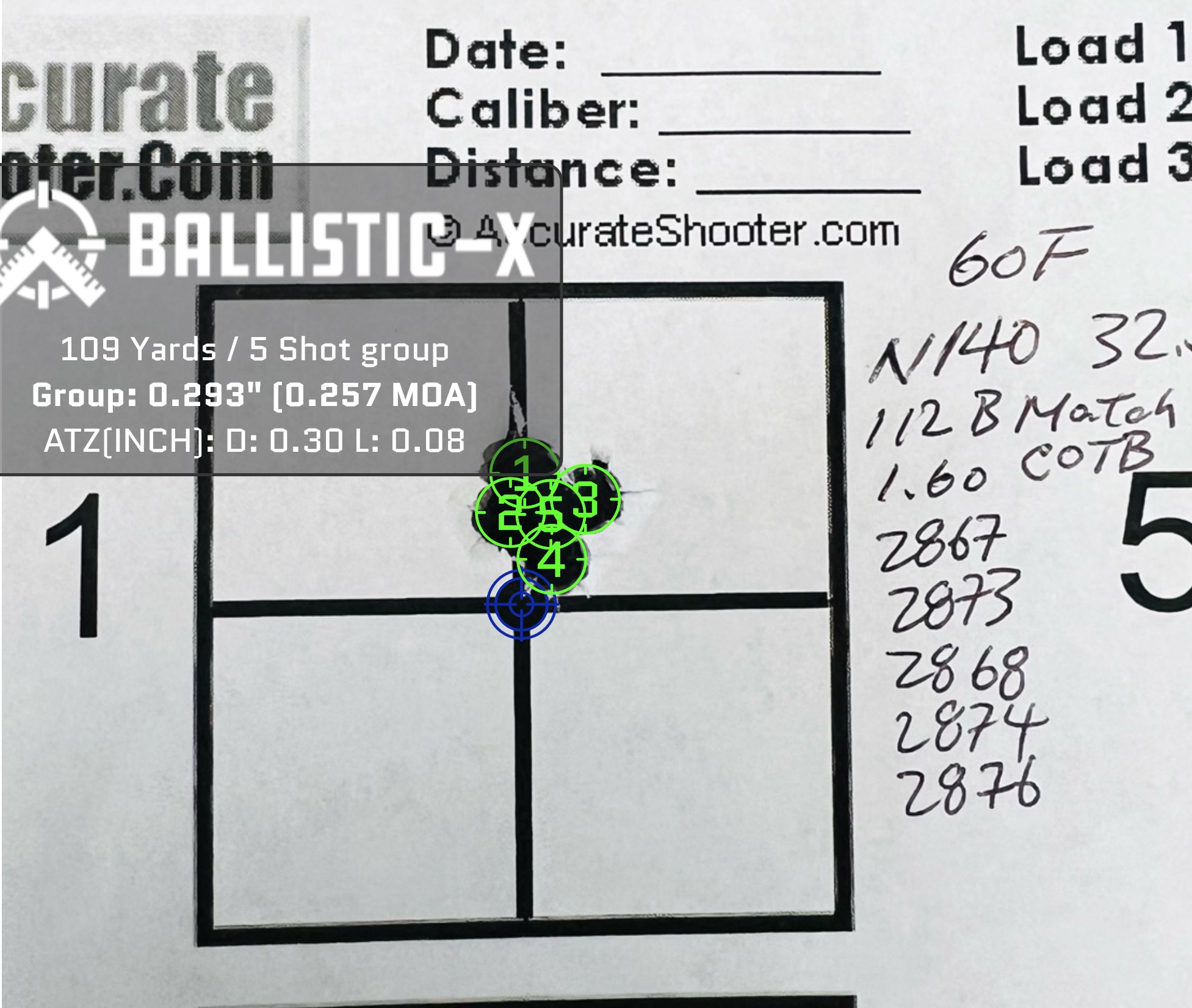

Imr 4895 31gr, seating depth just touch the land. ES 12 over 5 shot at 2835fps. We test again with 20 more rounds.

Finally got around to testing jump sensitivity with 112gn Match Burners. They are insensitive to jump and held the same POI from jam out to .050". I'm sure the jump measurements don't exactly equal the current jump since the jam measurement was with a new barrel and I'm at 650 rounds now. I'm going with 0.0" jump (which is probably really in the 0.005" - 0.015" range) and I should never have to mess with jump again with this barrel.
26" PVA Osprey Barrel Works
112 Match Burners
Alpha brass
31.6gn Varget
CCI 45
2885 FPS
Jam (measured when barrel was new)
0.010"
0.020"
0.030"
0.040"
0.050"
0.060" noticeable POI shift:

Just got a dasher yesterday and loaded up 10 rounds to play with. Loaded five with 31.5gr varget with a avg speed of 2850 SD of 10.5. And the other five with 32.4gr varget with an avg speed of 2920. In alpha OCD brass, alpha reamer. 108 Berger BT target through an ultra 9. Both groups were 1/2" off a shitty bench with people blasting away with muzzle brakes and hunting rifles. Going to explore the 32.4gr load some more tomorrow.
Going to run the same load but with 109 Hybrids
Reactions: Krob95
