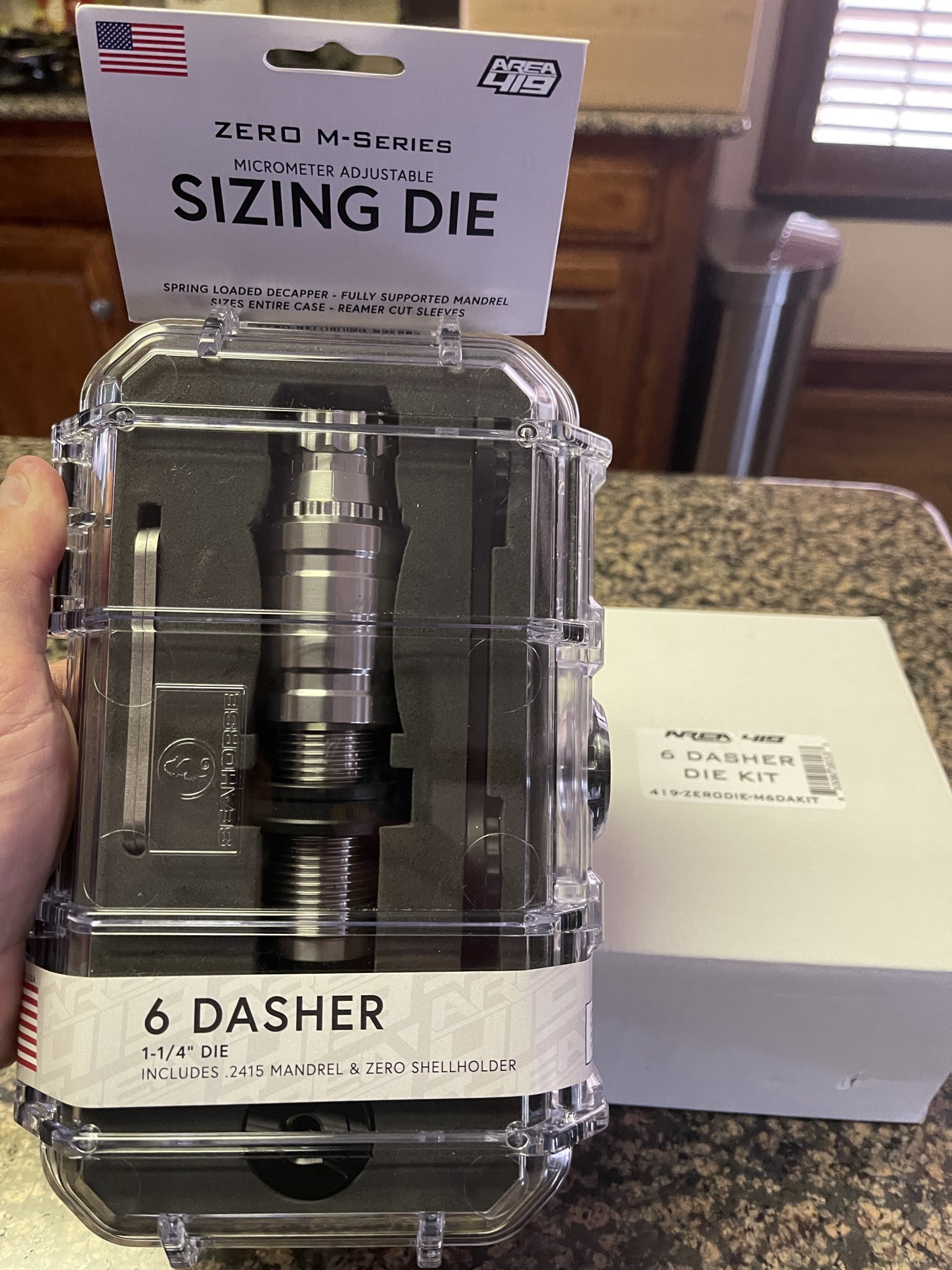

Finally making the swap to dasher after years of shooting 6.5 creed. What dies are everyone using? I previously have used and had good lucking with the Redding type S. I’ve seen some recommendations for the SAC die or the micron die (doesn’t seem to be a bushing die but I could be wrong). Anyone had any luck or expierence with the new AREA419 M series dies? Thanks everyone
I just went thru this. I ended up with the new Forster bushing die set. So far, I like it. Seems to be very consistent on both the sizing dies and the seating die.

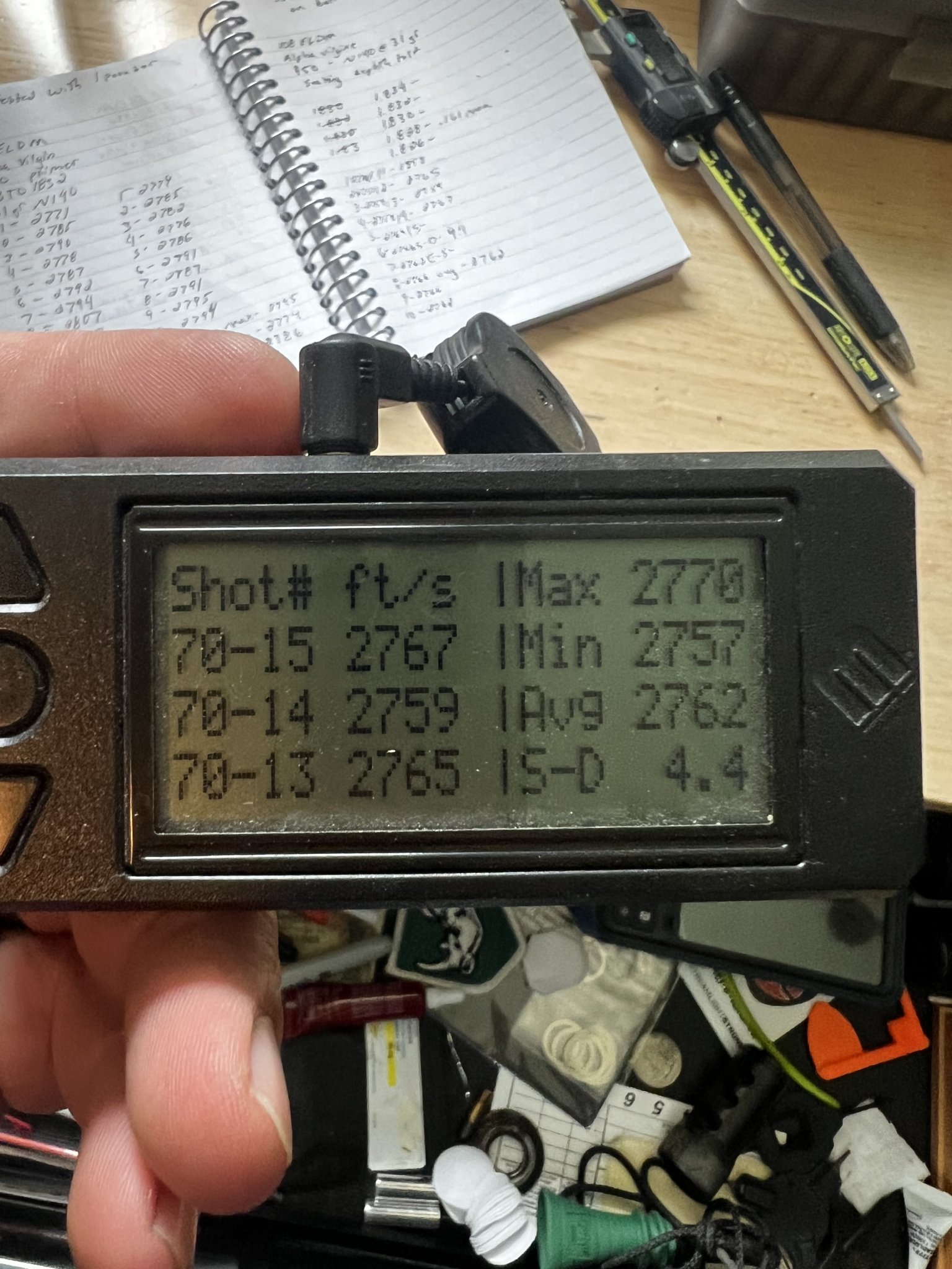

Hornady 105 @ 2.790" BTO
2743 fps, sd 6.6, es 17 - 5 shot group 87°F
Grouped just under .5 MOA.
This is a new barrel, only 40 rounds so far. I am hoping it speeds up to at least 2790.
