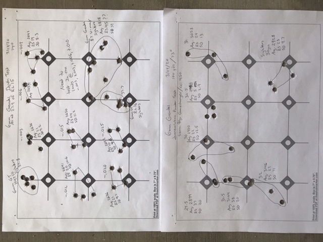

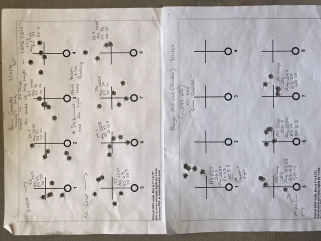

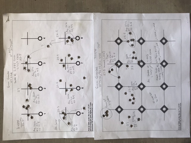

So I have an upper from Atheris and I am running a 22” Tbox barrel and an adjustable gas block. I’m experienced reloading and I use a Prometheus and AutoTrickler v3. I’m also experienced shooting. I have verified scope and everything else is tight.
I am using Hornady brass, Redding Grendel bushing dies (.267 bushing), h4895, varget, rl15, AR comp, leverevolution and CCI 450’s. For bullets I have tried the Sierra 107’s, Sierra 90gn gamechanger, Berger 105 hunting VLD and 87 vmax. Unfortunately I have not been able to locate some imr 8208 xbr to play with locally.
Are these typical results from a 6mm grendel gas gun or are my hopes set too high?
I would like for it to shoot consistently in the .75moa range at the bare minimum. I know many post some tight 3 shot “wallet groups” but I need it to shoot consistently.
Any advice or observations would be greatly appreciated.
*Not sure why the pics are sideways*
Feel free to PM me your number and I can txt some better pics.
How do you know you're on the accuracy node? It's pretty hit and miss to load this and that and shoot for groups and have it all come together.
Pick one bullet, one powder, and find the load for it. If you dont like it, try another. It looks like you are using different powder and bullets and shooting 4 groups in .5 increments. If this is 100 yards, it's too close for a shot string test. Your .5gr powder gap is too far apart for OCW testing.
So I'm not sure what your methodology is here.
It would be luck to have something show up like this.
Reactions: longrange454
I am trying to hit higher nodes for velocity and to take advantage of bullet BC.
Quick load gives me a parameter/max pressure and I will run a few charges in .5 grain increments to see if there’s something worth exploring. I’d hope to find a node that is at least .3-.5 tenths of a grain wide. This is coarse load development to see what powder/bullet combo do on paper and with the chrono.
It seems very loosy goosy to me. Kinda poking around. You've fired a lot of rounds there, and I can only speculate how long you spent at the reloading bench.
I usually fire about 12 rounds into a ditch bank, then about 5 four round groups, and I'm done.
I'm scratching my head with you here.. Good luck with it.

0.5 gr increments for Grendel size case is a bit too course, 0.3 gr would probably work better.
27.0 - 27.5 of H4895 with 107 deserves a little more investigation at 200 or 300 yards.
I'd probably try 27.0, 27.2, 27.4, maybe as high as 27.6 at longer distance to see what vertical looks like.
I wouldn't be changing powder and jacket material, creates more variables. Each time you change, need 3-5 rds for barrel to settle back in. Well known issue and reason HP shooters try to run a single powder / jacket material at all lines. If it shows up when shooting 1 MOA target, going to mess up your sub MOA hopes.
107 SMK, 22" barrel you'll be looking for 2700 ish fps or less.
H4895, RL-15, Viht N-540 or similar are what you'll want with 105-107 gr bullets.
8208 is going to be a bit too quick in burn rate.
AR-comp you'll probably pressure up before desired velocity.
Varget you'll probably run out of case capacity before getting desired velocity.
RL-15, Norma 203-B, Viht N-540 are probably your best bets for running heavier bullet at increased velocity.

Rifle length gas system, standard rifle buffer, magpul prs gen 2 stock, and when shooting I use a bipod and rear bag.
I will usually shoot sighters on another target before shooting groups or making any changes.
As for h4895 I started to get some case punishment around 26.8 and that’s why I switched to RL15 with the 107’s.

Also, I don't particularly enjoy load dev, so I find something acceptable and roll with it. Depending on how many other projects I accumulate by the spring I may try out some lever, var get, and 4895 again. I've got lots of varget laying around. With the ARC coming out, it'll be interesting to see what kind of stuff real factory testing might figure out as a ballpark for us 6 Grendel OG guys.
