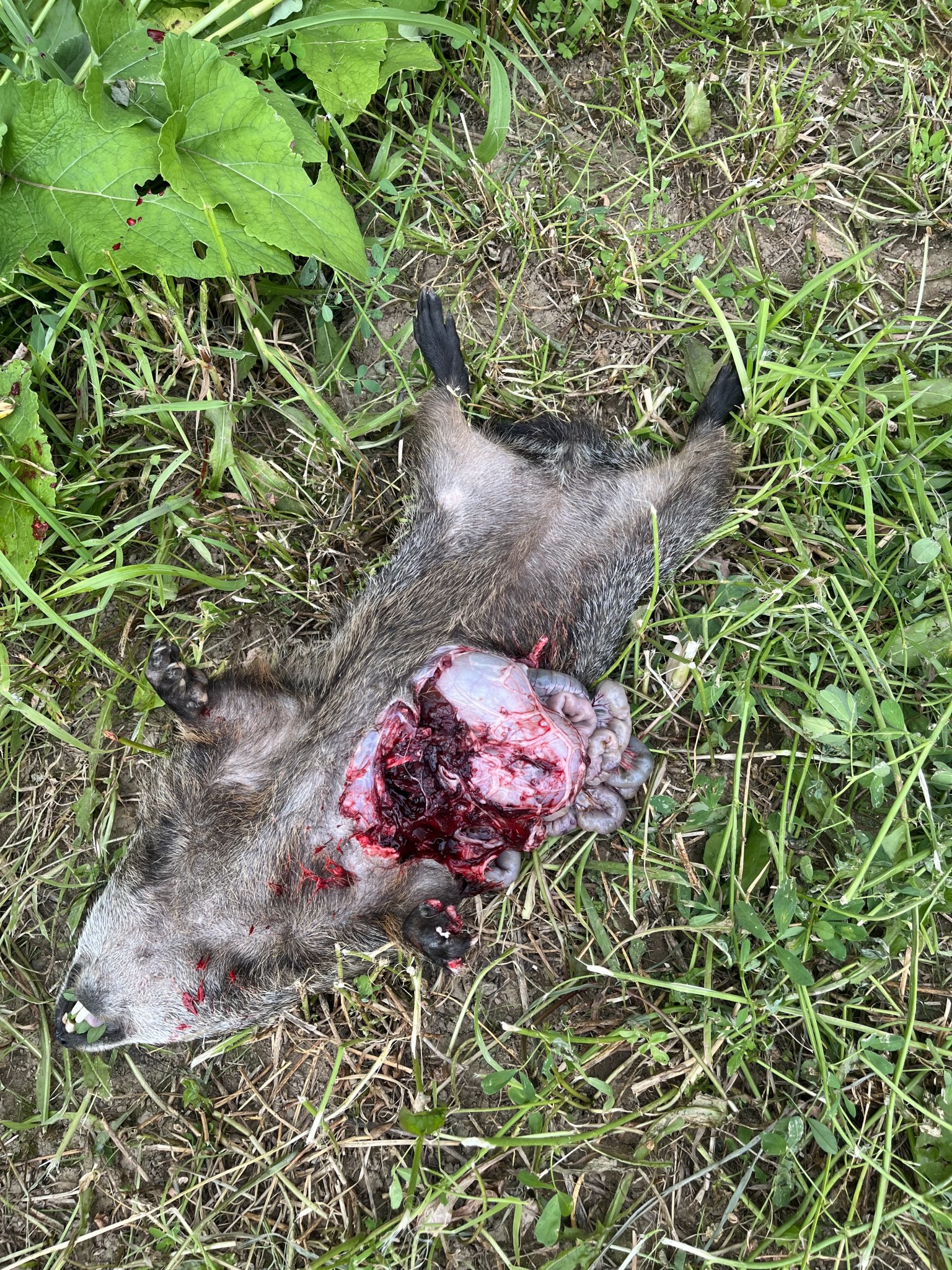

Here's some of the damage from mine, fox at about 125 yards, 3330 mv 110 atip. Also took a yote at 150 but forgot to get a picture, not as destructive results but I don't think I hit any bone on that one.
Reactions: Dogsniper

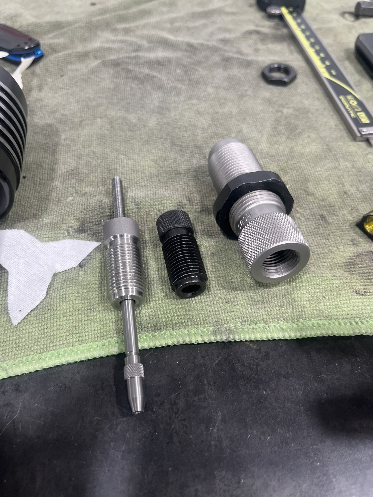

I ordered a Manson reamer with the slightly larger base to prevent the clicker issue .277 neck and .100 freebore. I believe i got this info from some guys on here. It worked out perfectly.
I’m using rcbs 6.5 PRC match master dies. I ordered a 6mm decapping stem and made a plug to hold the stem. It’s a different thread size than the 6.5 PRC stem. 6mm stem is 10-32.
Link to the stem.
Using lapua 6.5 PRC brass, i tried stepping down to .280, then .270. Checking concentricity, going straight to .270 all at once was actually giving me less runout.

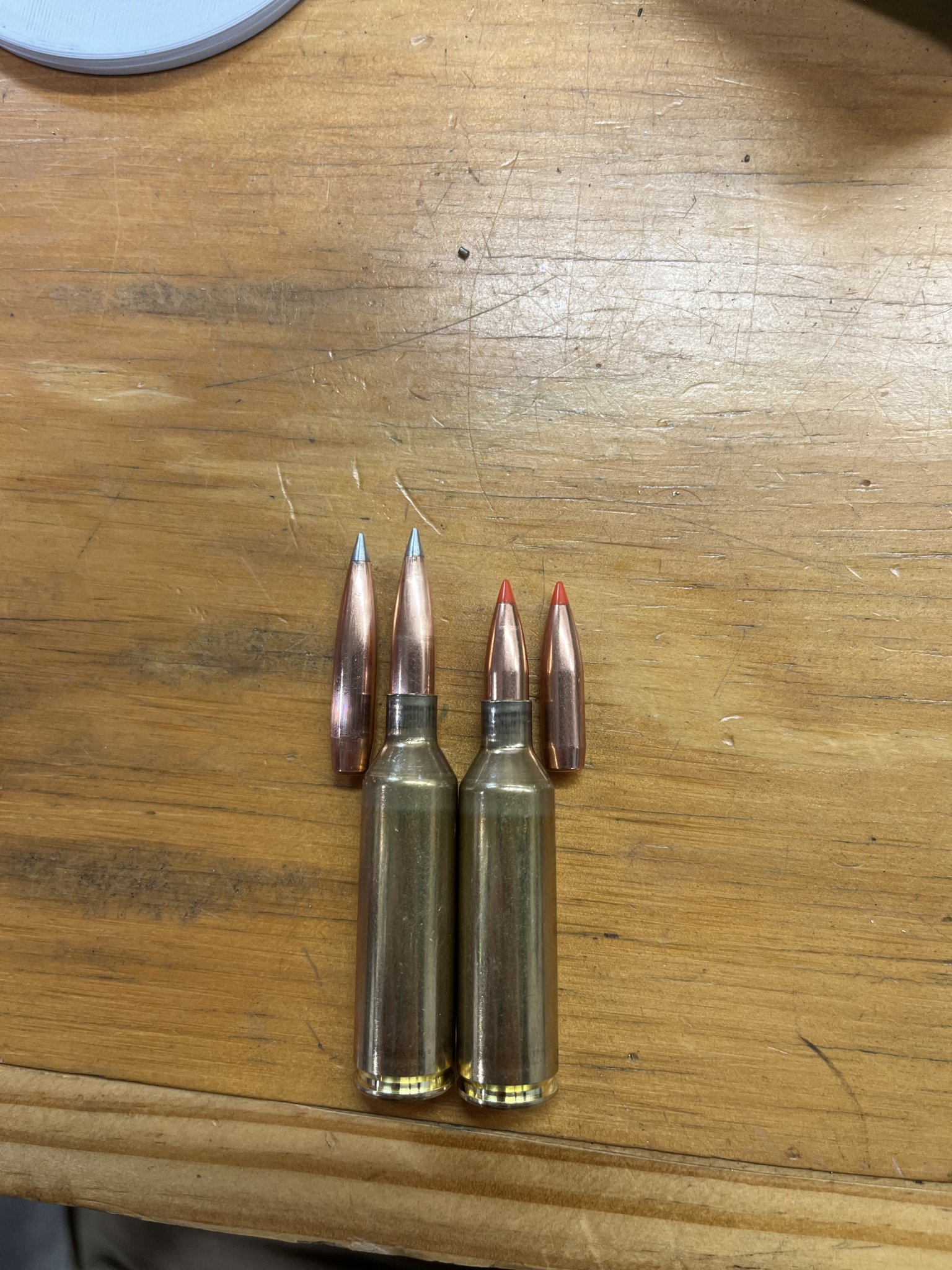

So far, I’ve tried 110 A-Tips and 87 VMAX. The .100 freebore is perfect. Both bullets are seated with the bottom of bearing surface right at the neck/shoulder junction when .015 off the lands. The A-tips are just short enough to fit in MDT 300 wsm mags at 2.920 COAL.
110 A-tip COAL touching lands = 2.936
87 VMAX COAL touching lands = 2.695
58.5 gr H1000 was about the pressure limit with the A-Tips and got me 3375 fps. I did not have any bullets blow up and they are shooting 1/2 moa out of a tired old barrel. Can’t complain there.
58.5 gr of RL26 was also max charge before i got pressure signs. Got me 3460 fps and 1/2 moa as well. Still no blown up bullets.
87 vmax maxed out at 60 gr RL26 and 3736 fps. They were blowing up at that speed so i backed them down and got them to stay together at 59 gr/3670 fps. Shooting about 1 moa. I need to play and see if i can get them to tighten up but the twist may be too much. I figure they can handle about 375,000 rpm. So, i will probably go to a 7.5 twist which will work for both bullets.
The groundhogs really seem to like the vmax bullets.

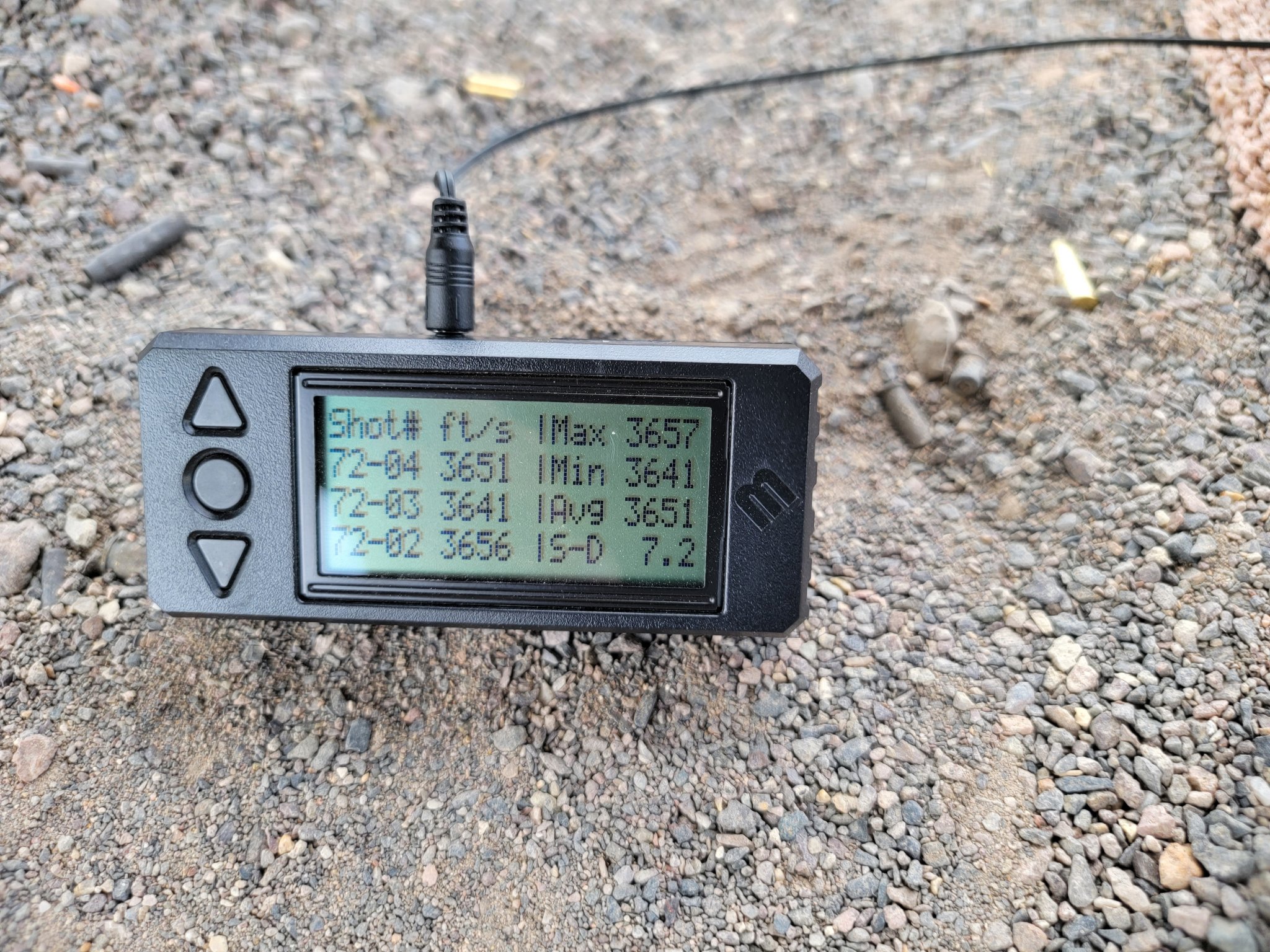

Update that's directly relevant to this. I decided to work up a load with the Cutting Edge MTH Gen 2 88 grain for a potential depredation elk hunt on national park land, which requires non-lead projectiles.
Worked up a load of 61.03 grains of n565, CCI BR2 primer, new Lapua brass, loaded to 2.693 COAL (so the case mouth just touches the Seal Tight band as per the recommendations from Cutting Edge), 3 thou neck tension.
Getting about 3651 fps with .5 moa groups with no pressure signs, very slight powder crunch on seating. Could probably get it going faster with a faster burning powder, but this is what I have available.
Here's a quick vid of me shooting it at 650 yards on steel, it gets there quick but man it sounds similar to a 77gr 223 on impact.

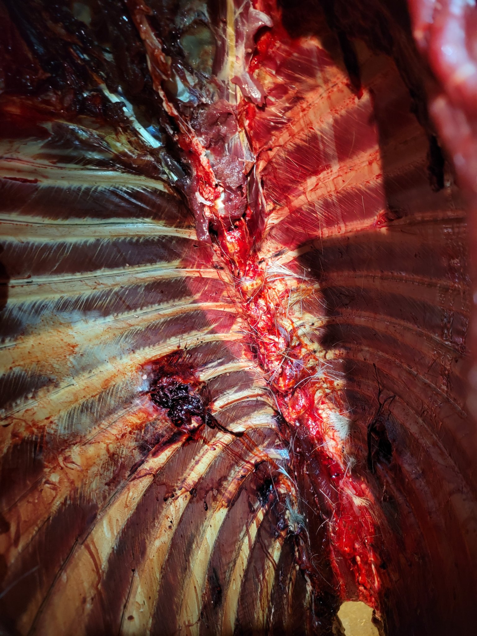

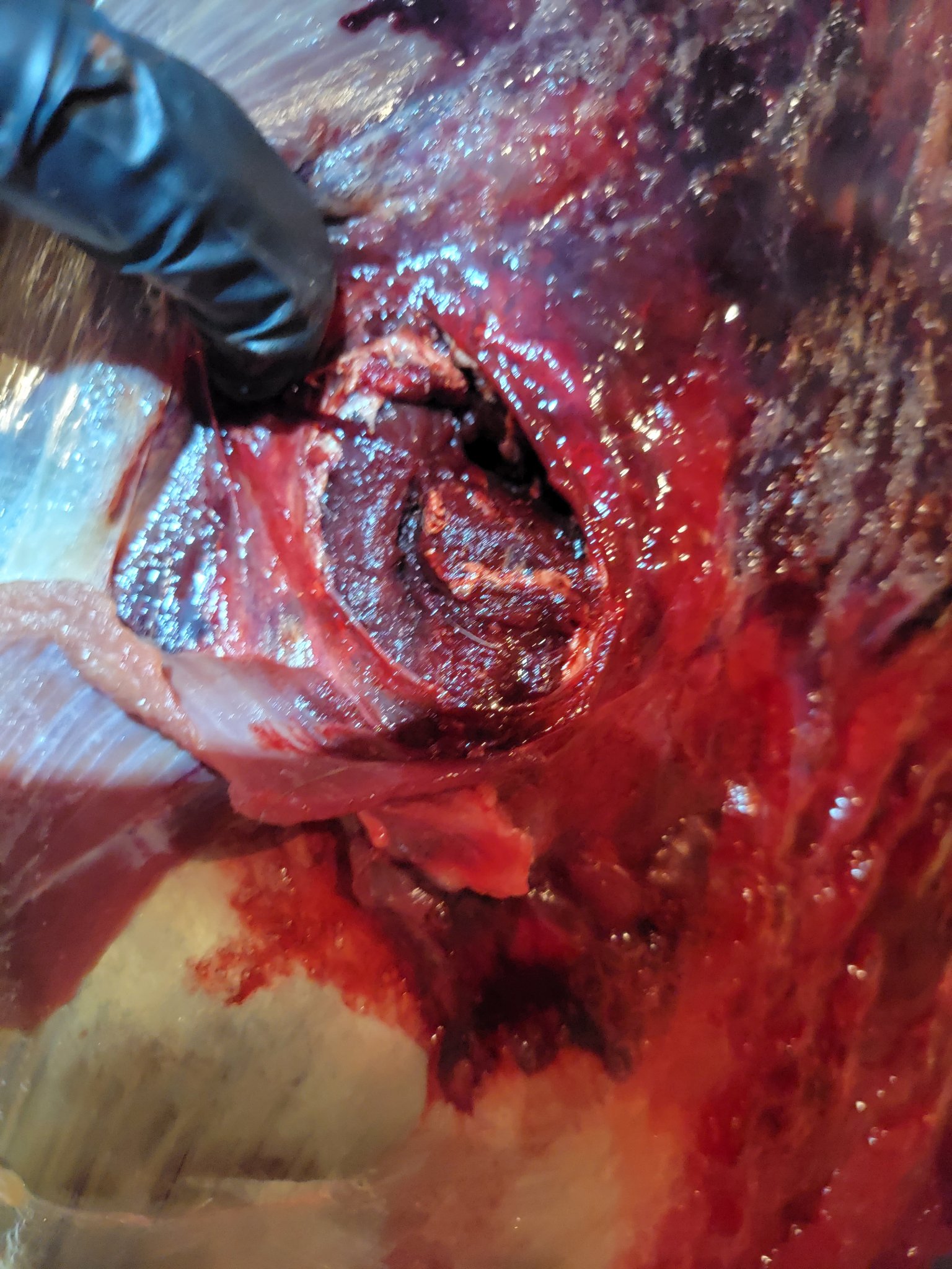

Got an update on the 6 PRC chronicles for anyone who is still watching this thread.
I was able to connect on a cow elk at about 250 yards with that 88gr Cutting Edge MTH Gen 2 with an impact velocity of about 3100 fps. Even though I placed the shot a little lower than I had wanted, the results were still devastating and I'm extremely impressed with the terminal performance of the bullet. I was going for a high shoulder shot but ended up slipping it in a bit low and it became a high lung shot.
She ran a little over 100 yards on pure adrenaline after the shot along with her herd and then laid down and expired.
In the chest cavity picture, the entrance hole is on the left and you can see that the bullet began expanding almost immediately after entry as the inside entrance and inside exit hole on the right side of the chest cavity are about the same size.
Gotta be honest, I was not expecting a baseball sized permanent wound channel from an 88gr 6mm copper bullet, but this thing made me a believer.

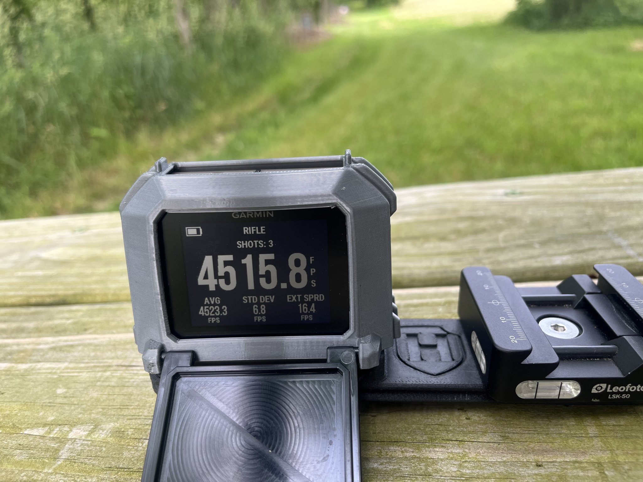

Here’s what i got.
55 gr hammer hunter, 2.120 cbto, 2.463 COAL, 210M, RL16
54.0 3800
55.0 3940
56.0 3979
57.0 4068
59.5 4257 no pressure, almost 100% case fill
55 gr hammer hunter, 2.120 cbto, 2.463 COAL, 210M, H4831SC
60.0 3867
61.5 3987 100% case fill, no more room for powder
55 gr hammer hunter, 2.120 cbto, 2.463 COAL, 210M, RL15.5
56.0 4332 slight pressure
57.0 4424 slight pressure
58.0 4515 slight pressure
*primers weren’t very flat but saw a very slight ejector swipe on the brass on all three of these. Interesting that it didn’t get any worse as the charge went higher
55 gr hammer hunter, 2.120 cbto, 2.463 COAL, 210M, H4350
61.6 4490 - moderate ejector swipe
Didn’t have much time to shoot multiple charges of every powder but i did shoot one group with the RL15.5 at 58.0 gr. See below. Keep in mind this barrel is a take-off 6 creed retired from PRS duty and set back. Decent results i think.
