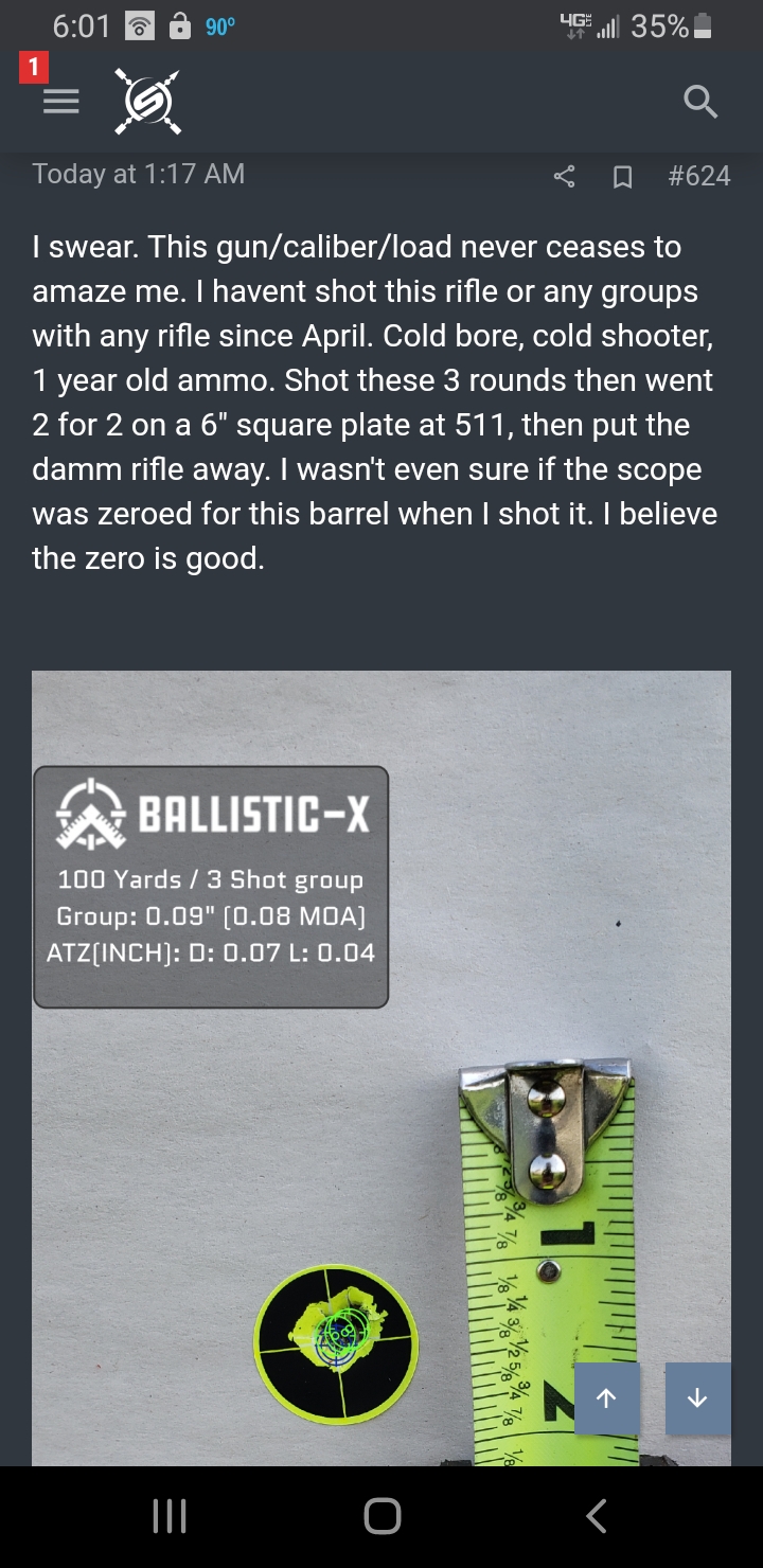

That is some nice shooting! Caliber aside that is a great groupI've had a BR and now a dasher. Posted this pic in a couple places. This was done on Friday with the dasher out of my AI. Hard to beat but can be done with all the BR variants.
Will have to see if I can get the PR kit in Canada. With the current landscape everything is more difficult to get and I am afraid it won't get easier either ...I run 3 accurate mags with the primal rights kits…been running them for 2-3 years with a 6BRX 6BR and 6BRA all 3 cartridges and mags have run flawlessly….you might have to tune the lips a little but 15mins in your house with a few dummy rounds and your GTG.
I creep one out every now and then. The group didn't really surprise me as much as the fact that it was cold bore and first time shooting a group in months.That is some nice shooting! Caliber aside that is a great group
