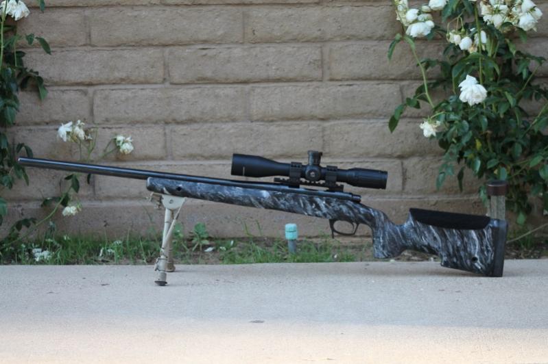

Olde Faithful
Stevens 200
Rifle Basix trigger
McGowen 26" bull barrel 7-08 with 1in8 twist
Harrel Muzzle brake
MCS-T with CDI DBM - Bedded by me
Alpha Mags
USO scope base
ADDLand low rings
Custom Bolt handle w/bolt lift kit added in bolt
162 BTHP
Winchestor Brass
CCI200 Primers
47.2g H4350
2.915 OAL
2780FPS
700 SA
Fluted Broughton 22" 1-9
Schuler brake
Mcm A4
Jewell trigger
PTG DBM
Badger rail
Seekins rings
Bushnell G2DMR
