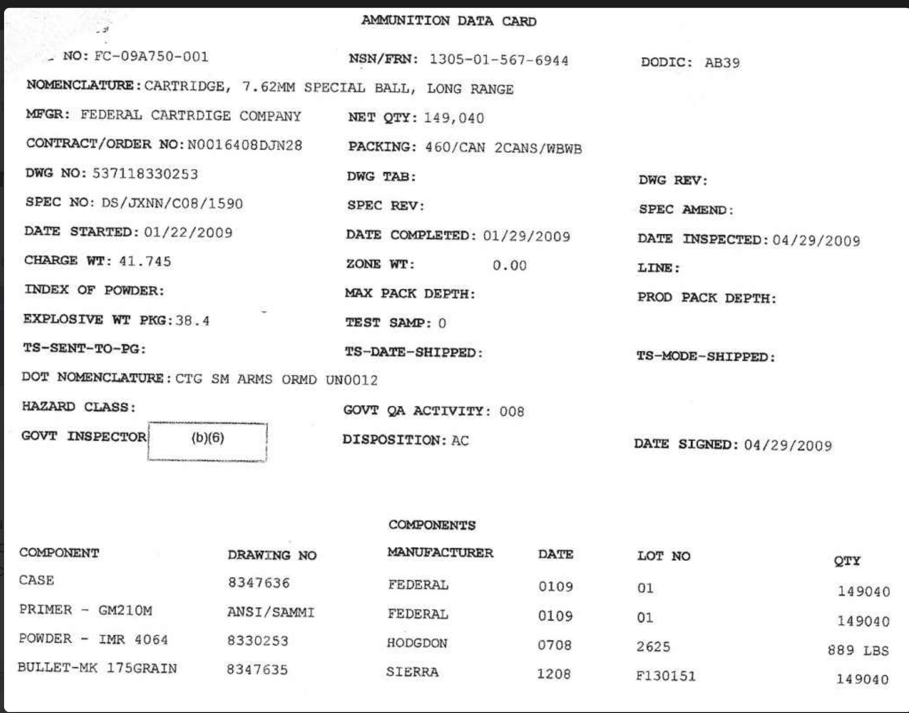

The Mod 0 was not loaded at Lake City as far as I know but it actually used Federal Brass and standard FGMM primers.

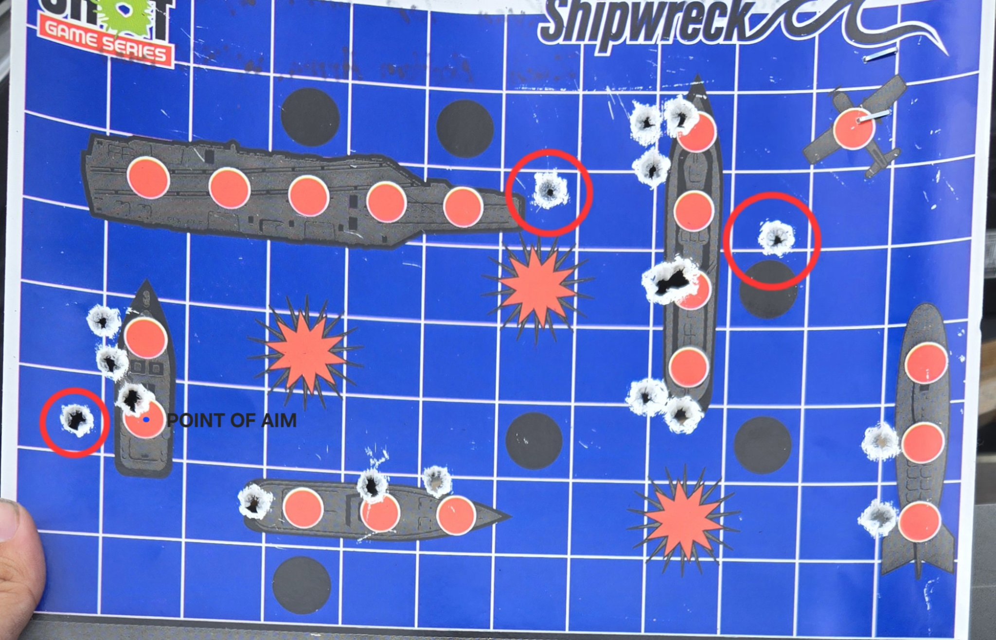

Could be normal shot distribution. You could easily be interpreting this "error" incorrectly.
How often are you actually observing this? Recorded sample sizes? Thought: If you printed (10x) 10-round groups, you're saying every single one has a "flier"?
If you're actually concerned with a single component then change out one component at a time and see if it makes a measurable difference. Use large enough sample sizes so you're not fooling yourself.

Most likely this is the load & shooters' capabilities. How does it do at distance, like 300-600yds?

I haven't been keeping as meticulous detail as i probably should with round counts of this load, but it's been a consent observation across the probably 80-100 rounds I've loaded of the stuff. The only good example i have with me at the moment is this battleship target my buddy and I shot at 100 yards
There's normal movement up and down left and right, but you can see 15/18 rounds landed within about half an inch with the majority trending to be nearly right on the left line of the box, but then the three circled ones flew nearly an inch wide. Those are the ones I'm wondering about. Maybe it's a matter of just taking those peices of brass and discarding them and seeing how that group of rounds do after loading again. Also, I know I could do for an adjustment to my zero lol.
It does well. We can hit a full size steel IPSC 100% of the time out to 600 but usually the steel at the range is shot up enough that you can't spot impacts super well. The 1/3rd IPSIC at the same yard line is about in line with what our 100 yard shows, the majority of rounds will connect but here and there you'll have a same wind observed all the way down range and the same hold and then it just won't connect how you'd expect. We haven't been able to strech it any further unfortunately.
As i was, then. I don't know where the distinction comes in exactly but the "Mk316" is more the fact were loading a 175gr smk with 41.7 grs of 4064 in a 7.62 case and getting similar velocity and all to what the military round has. I'd rather have the Federal brass and primers but you work with what you have lol

Did you do load development or just 41.7gr like in that spec sheet?
Lake city brass is decent, the machine gun fired can have wonky necks every now and then making weird tension or fliers, my loads with it and 175smk were 43gr IMR 4064, 43gr RL15, and 41.5 H4895. The mk316 load in that sheet never shot well for me I even had the fed brass, fed match primers too.
Honestly we just kind of sent it at 41.7, got 2600fps out of a 22 inch barrel and the groups you see in that battleship target which aren't bugholes, but its what we were hoping for. I'm reloading more to have 1 load that works well in 3 rifles more than 3 exact recipes to shoot perfect in 3 rifles. With that neck tension, I guess that wouldn't be fixed by fire forming would it, which would just lead back to discarding the flier brass?
