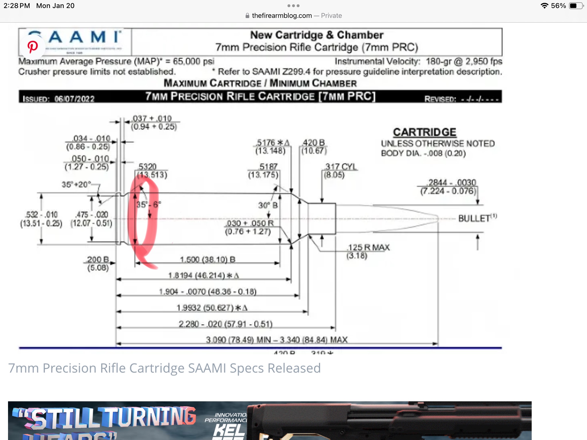

What reamer was used and what is the diameter at the base of cartridge for that reamer?
There's a known "issue" with PRC chambers. If you cut the chamber near the SAAMI minimum, it can be have a sticky bolt no matter what charge weight. Depending on the brass you're using and such.
Alex Wheeler is credited for figuring it out and having reamers spec'd on the high end of SAAMI and the problem goes away. It's usually labeled as an AW2 reamer or similar nomenclature.
If you do find out your chamber is near SAAMI minimum, all it takes is an AW2 reamer spun by hand in the chamber. Takes 5min or less and cleans up the base of the chamber.
Not saying this is your issue. Just something easy to check that will save you chasing your tail if that's the issue.

Refer to post 15. Your chamber is too tight in the web. Rent a AW2 reamer from 4D reamer rentals and clean up the rear of the chamber by hand. The biggest cause for clickers/ sticky bolt is a tight chamber in the web/body diameter. Second is a die that doesn't size the brass body/web diameter enough. Third is pressure. Your load is still below book max. PRC is known for tight chambers. Saami chamber is only .001 clearance at the web. Should have been .0025-.003 instead for that family of cartridges.

I did that (found clicking Utube) and watched a guy ream his chamber with an AW2 reamer. He removed his barrel from the action. And it cured the clicker issue and didn’t reduce accuracy. I don’t see removing a barrel with Seekins customer service. I sent an email to Seekins and hoping they already use the AW2 reamer. But the video made it seem like most PRC rifles could have an issue. Might depend on dies selected, brass used, etc. I have not had any clicking however, just sticky bolt lift.

I also measured all my fired cases to be 0.533” at the 0.200 line above the base. This is where the AW2 reamer starts increasing the chamber ID from 0.533” to 0.535”. I have not heard back from Seekins yet (email) asking if they already use the AW2 reamer. If the brass expands to the chamber wall and then relaxes back some amount, it seems like I can assume the chamber must be >0.533”. The Sammi case dimension at base is 0.532” so there is only 0.001” clearance with the AW2 reamer. I have no idea if the additional case trim shortening will help, but I’ll find out. My 2.263” trimmed cases lengthened to 2.271” after firing. So I’m getting 0.008” lengthening from 1 firing. That could have been an issue starting from 2.275” which is what my trimmer was producing. Some load data suggests trimming to 2.270”.
The base of the fired cartridge is 0.530” before and after firing, not really changing.
So the first measurement was incorrect and your brass is really expanding to .533”? And your FL sizer takes it down to .530”?
If so, then it’s not the chamber and the only problem was the excessive pressure which you fixed by dropping the charge weight.
Reactions: Holliday
No it appears to be 0.530” at the bottom of base and 0.533” up an amount of 0.200”. Makes sense it’s very stiff at the case head. I’ve never taken so many measurements but never had this issue. But the AW2 reamer description is specific about being 0.200 above the base. I’m not referring to the plane containing the primer bottom. When I say bottom of base I am measuring immediately above the extractor slot in the case rim.
That part of the base doesn’t really change. The important part is the expanded area above. What does that measure after sizing?
Reactions: lash
0.533”. So if it relaxed any, like from 0.535” down to 0.533, then my issue is likely powder charge. Assuming you are correct that trim length is not a contributor.
