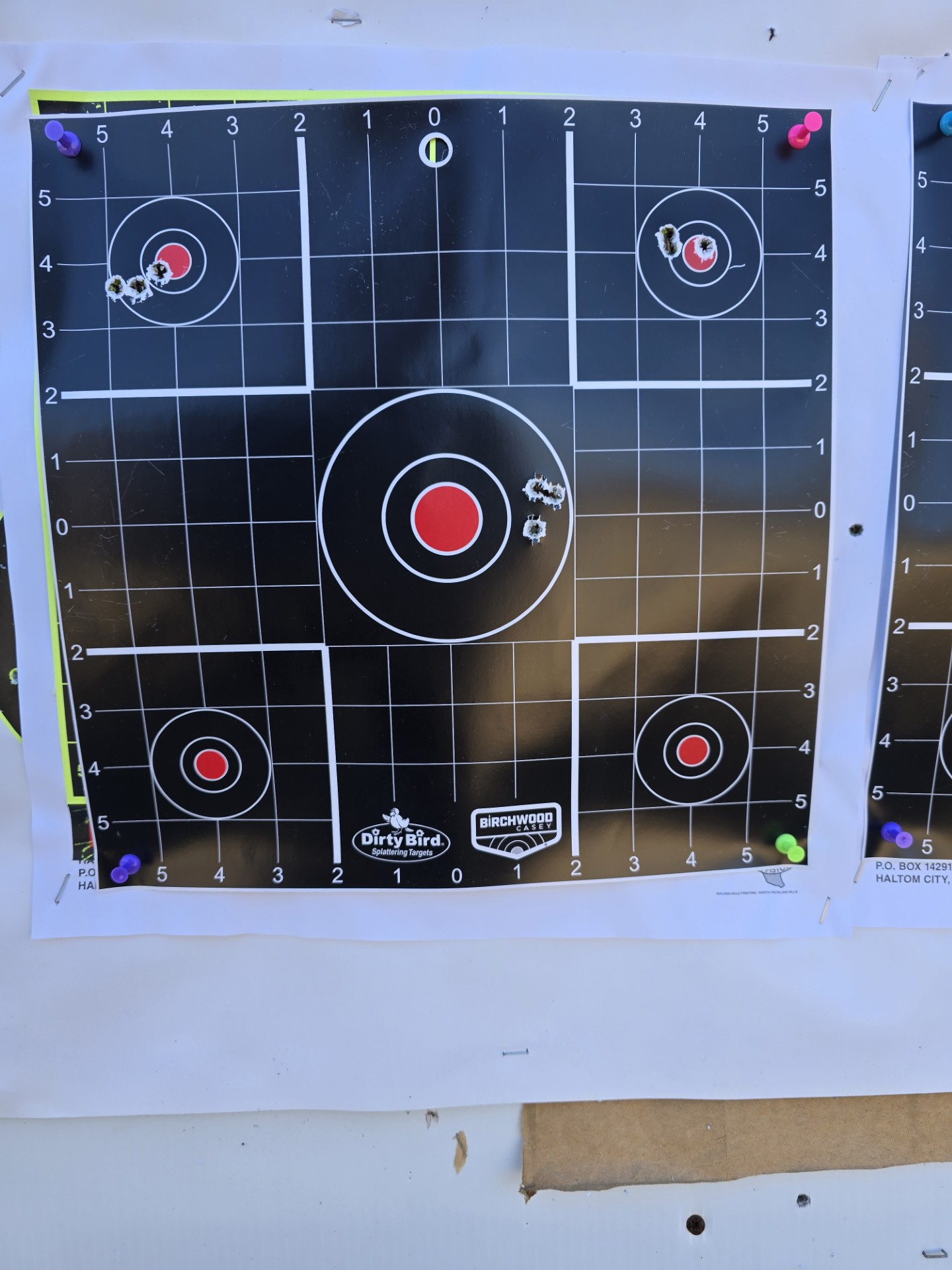

I finally got a decent supply of fireformed 7-08 Ackley brass using some 7-08 Starline brass as a starting point.
Rifle is a built Solus with a x-Caliber 24 inch CF barrel in a Grayboe stock and a Arken SH-4J optic.
I wanted to test 150 Gr projectiles first starting with 150 Gr. Gamechangers. powder is Power Pro
2000MR Federal 215 primers 3 rounds each
45.5 GR
2971
2973
2978
46 GR. These shot well but had loose primers- Possibly a Starline issue?
3001
3011
3013
All info same as above but with 150 Gr Hornady ELDX
44 Gr. CTR
2813
2805
2835
45 Gr. Lft
2916
2916
2902
45.5 RT
2944
2932
2933
100 Yd target of ELDX
Reactions: Top O' Texas
