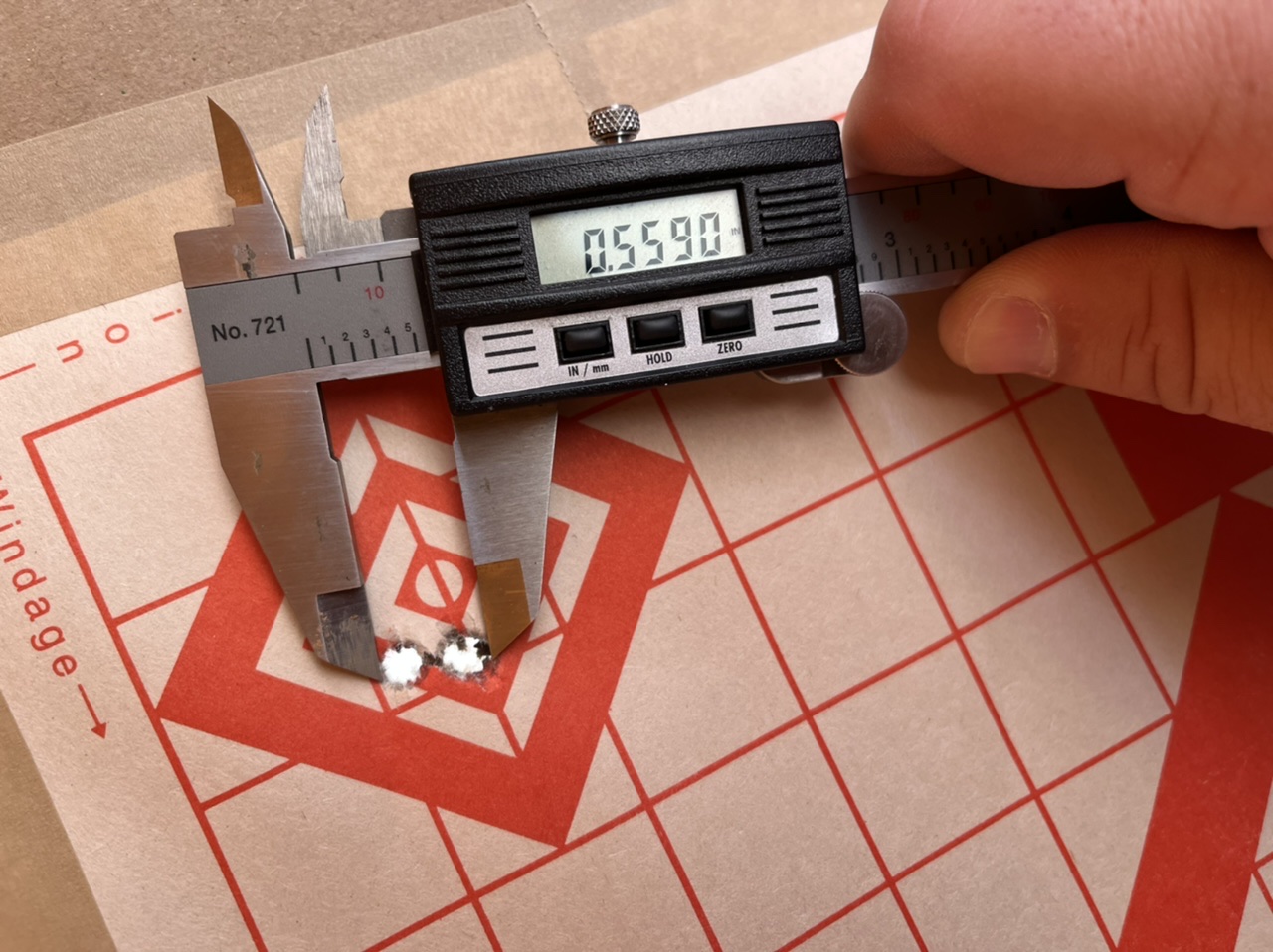

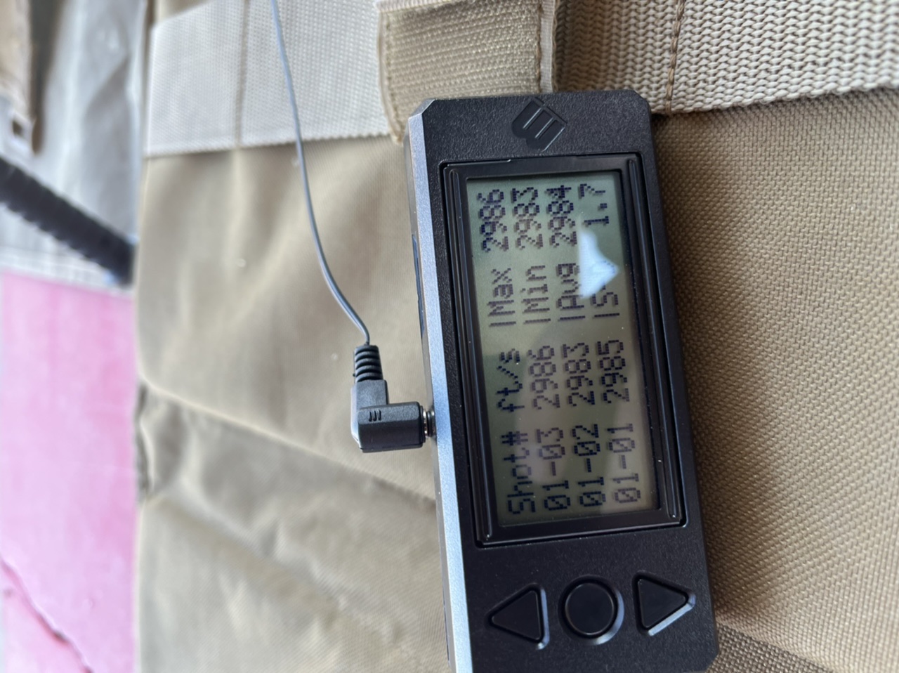

Shot a couple 3 rd loads yesterday with H4831SC x 166 gr A-Tip. Wind was very minimal but mirage coming off the snow was horrible and certainly didn't help accuracy. 61.5 grs shot very well considering how shitty the conditions were, I managed to drop a couple in the same hole. That was with mag primers so now to test mag vs std and run a short ladder at distance. Thanks for the recommendation.
Reactions: Steel head

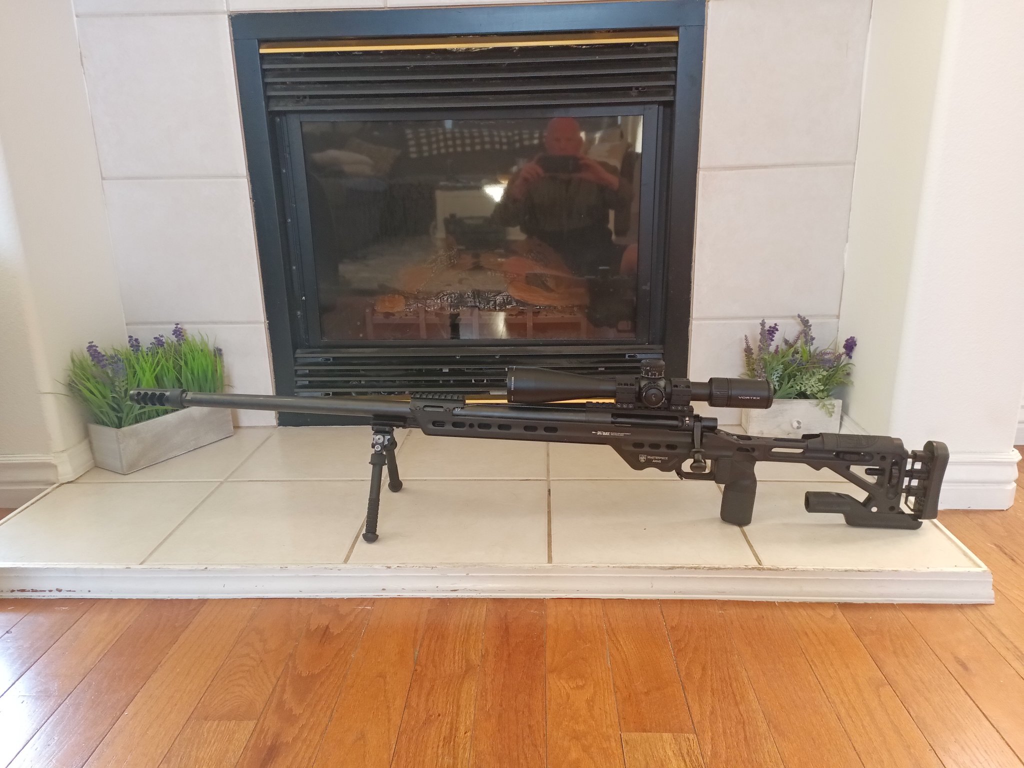

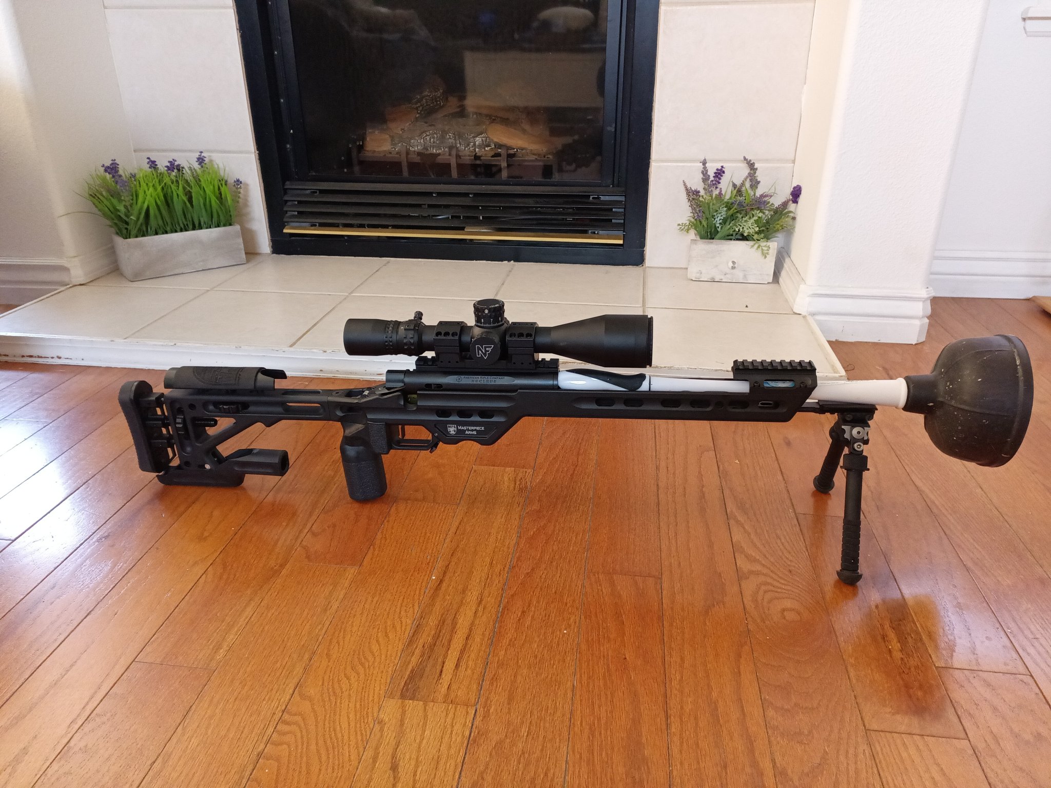

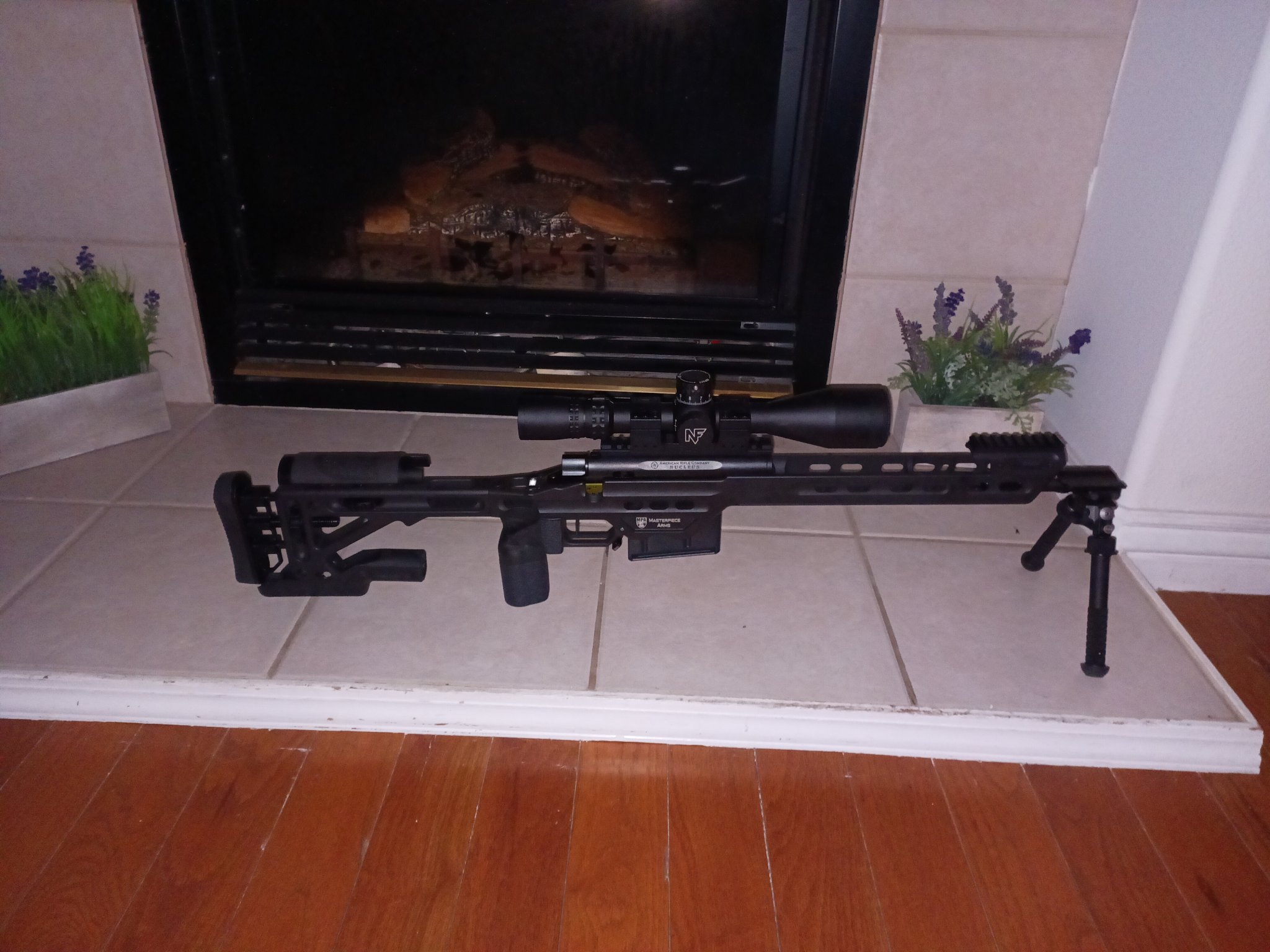

So here's the current pieces together. Just waiting on the barrel now.
And one in case some of you can't imagine what a barrel looks like🤣🤣🤣

New 7SAUM build......
MPA LH Competition chassis
ARC Nucleus Lefty LA 30MOA rail
27" Preferred barrel 1/8 twist .090 Freebore
Area 419 Sidewinder Brake
Timney 2 Stage trigger
Atlas Bipod
F3R Machine scope mount
Vortex PST Gen2 5-25

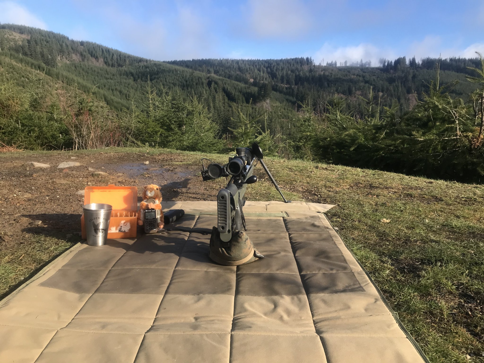

Been neglecting my 7 saum
Switched out the 338 barrel for the 7 mm barrel yesterday.
Such a fantastic cartridge
Shot it from 530 to 2020 yards today.
190 LRHT with R26 at 2850.
This barrel is starting to slow down after 1500ish rounds just like my last barrel.
I’ll make one or two powder adjustment’s then retire it.
Nice looking place to sling bullets!

Finally getting mine out on Sunday. Will have pics and such. Loaded up 100 rds of a middle weight charge of MagPro under 183, 180 and 197gr pro all 20ths off lands. Get all brass fire formed to my barrel. Then load dev time.
Doc
Doc
