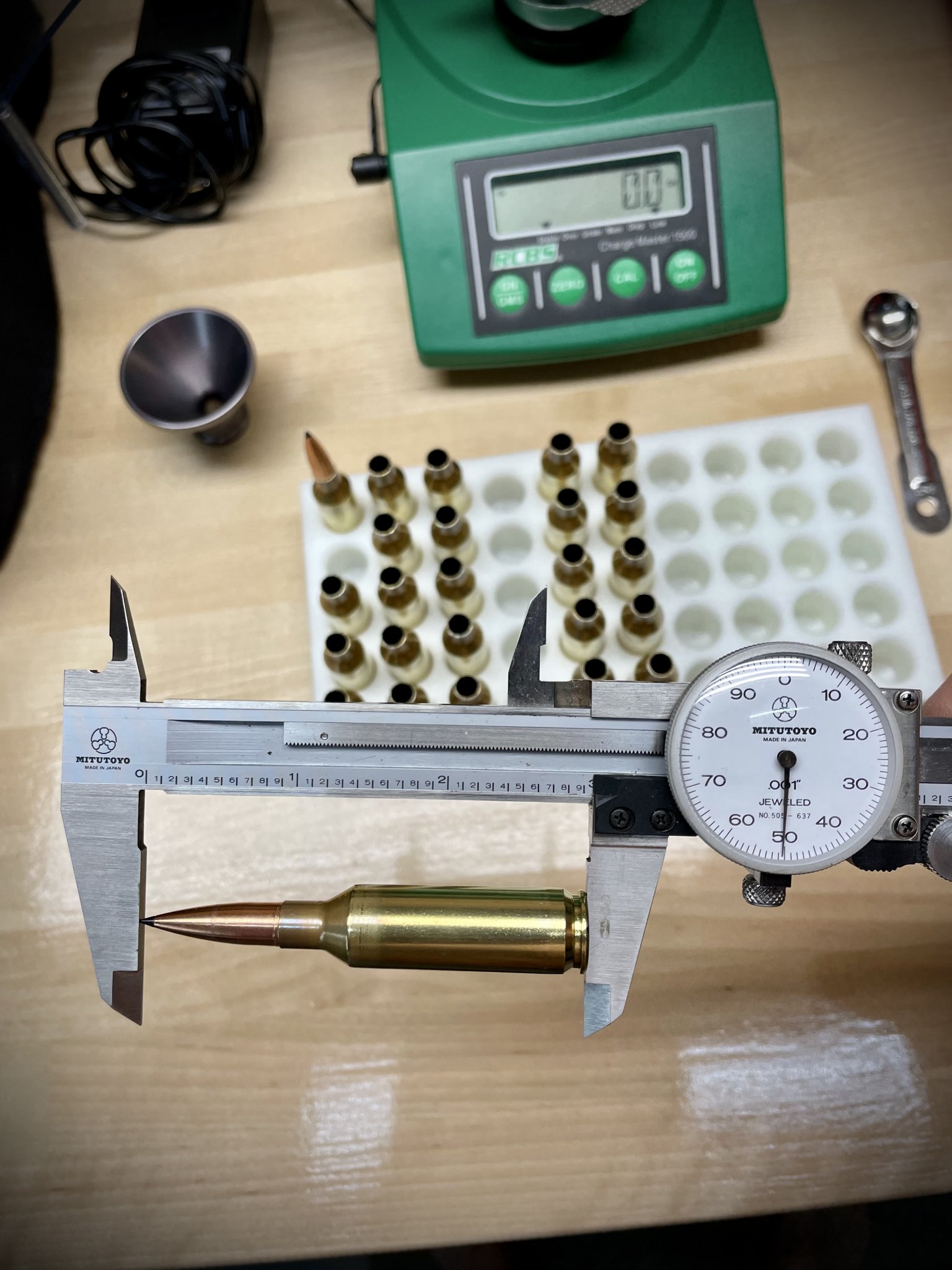

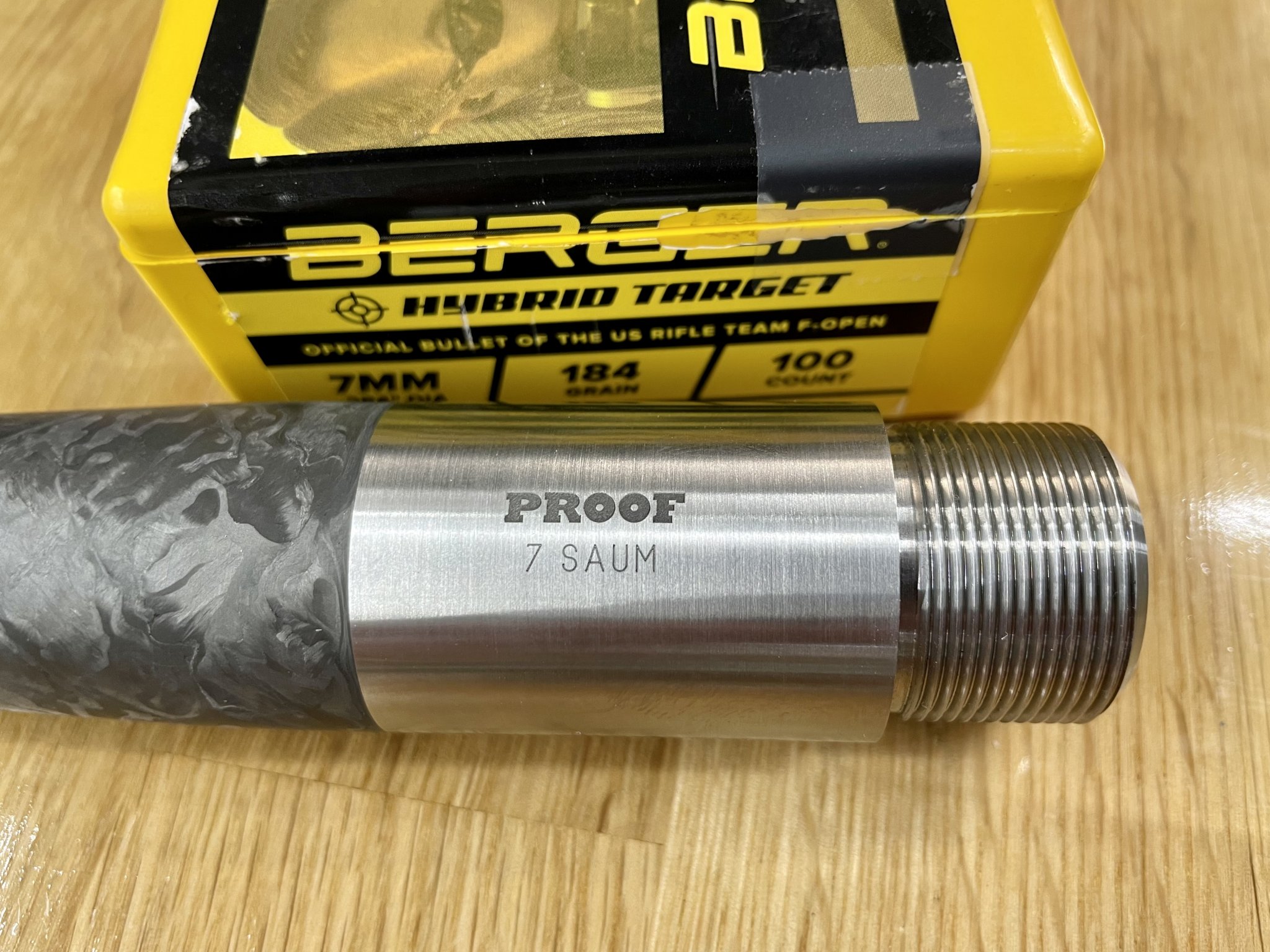

Here are some measurements with various bullets for the Proof pre fit. Thanks @Front Range Precision for a great deal on the barrel. Measurements are COAL/CBTO. Initial testing of this barrel will focus on 180 VLD and 168 ABLR.
184 Hybrid 3.070/2.200
180 VLD 2.965/2.150
175 ABLR 2.945/2.165
168 ABLR 2.980/2.185
168 VLD 2.975/2.160
162 ELD M 2.940/2.135
162 ELD X 2.930/2.145
145 LZR 2.980*
*Loading the seal tite band at the case mouth measures 2.950 which is the ideal placement and jump (.020-.030) according to CEB.

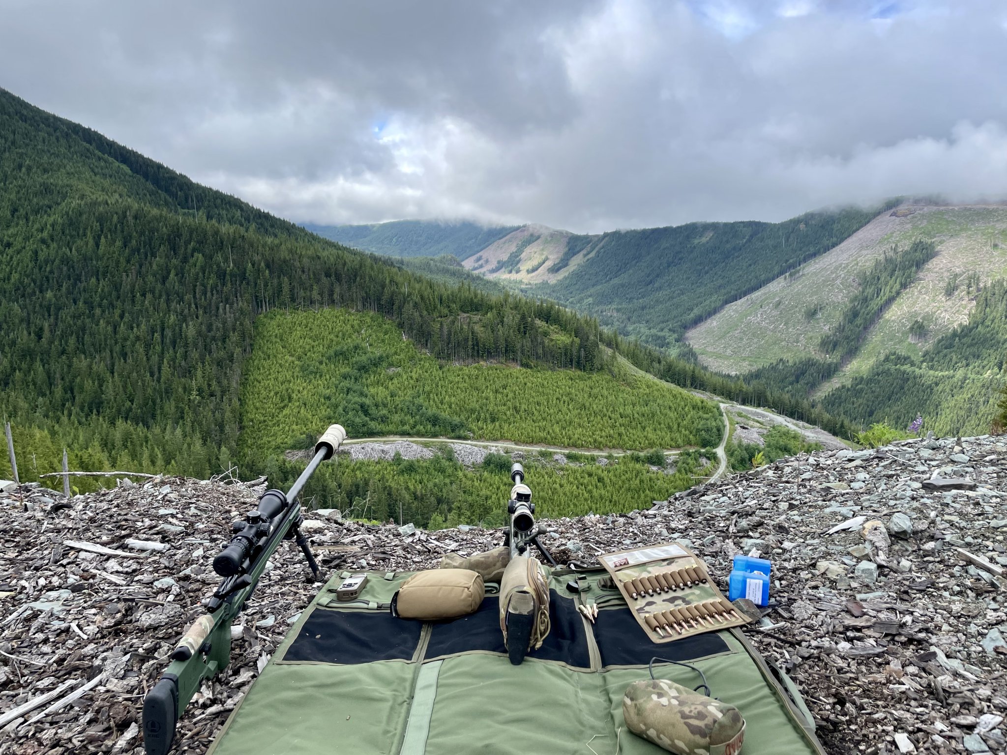

Finally, fucking finally, found a great mid range shooting spot with 480y-655y plus a long shot to 1 mile. Has everything: angled terrain, variable winds, a ball busting 2mi hike in, and some damn nice views. Good training for hunting season with a 50 lb ruck and with the hike in I dont foresee much use.
Tested my 180 VLD and 168 ABLR loads at 510 on some steel. Nothing challenging but still fun to get outside and get some real world data after being stuck on the square range. Ballistics gave me 2.5U. First few shots at a rock to spot my impacts went .5 mil high before I realized I was at probably a 30* target angle. Held 2U and .5L and was right on.
Doing some math later I came up with a 27* target angle which lined up almost perfectly with the the 2U. These 2 loads are within .1 mil of eachother at the speeds I’m running them which is convenient.
Also had time to shoot a few of the CEB 145 Lazer bullets at 100 to check speeds. Loaded a short series of 54-56 of H4350. 55.8 got me 2945 with SD of 3.0, I need to get these to over 3100 so I pulled the rest and loaded 56-58. Bug hole groups no matter the charge though and damn consistent bullets each round oal was spot on. They’re listed as single feed but my M70 and Accurate WSM mags feed just fine at 2.950.

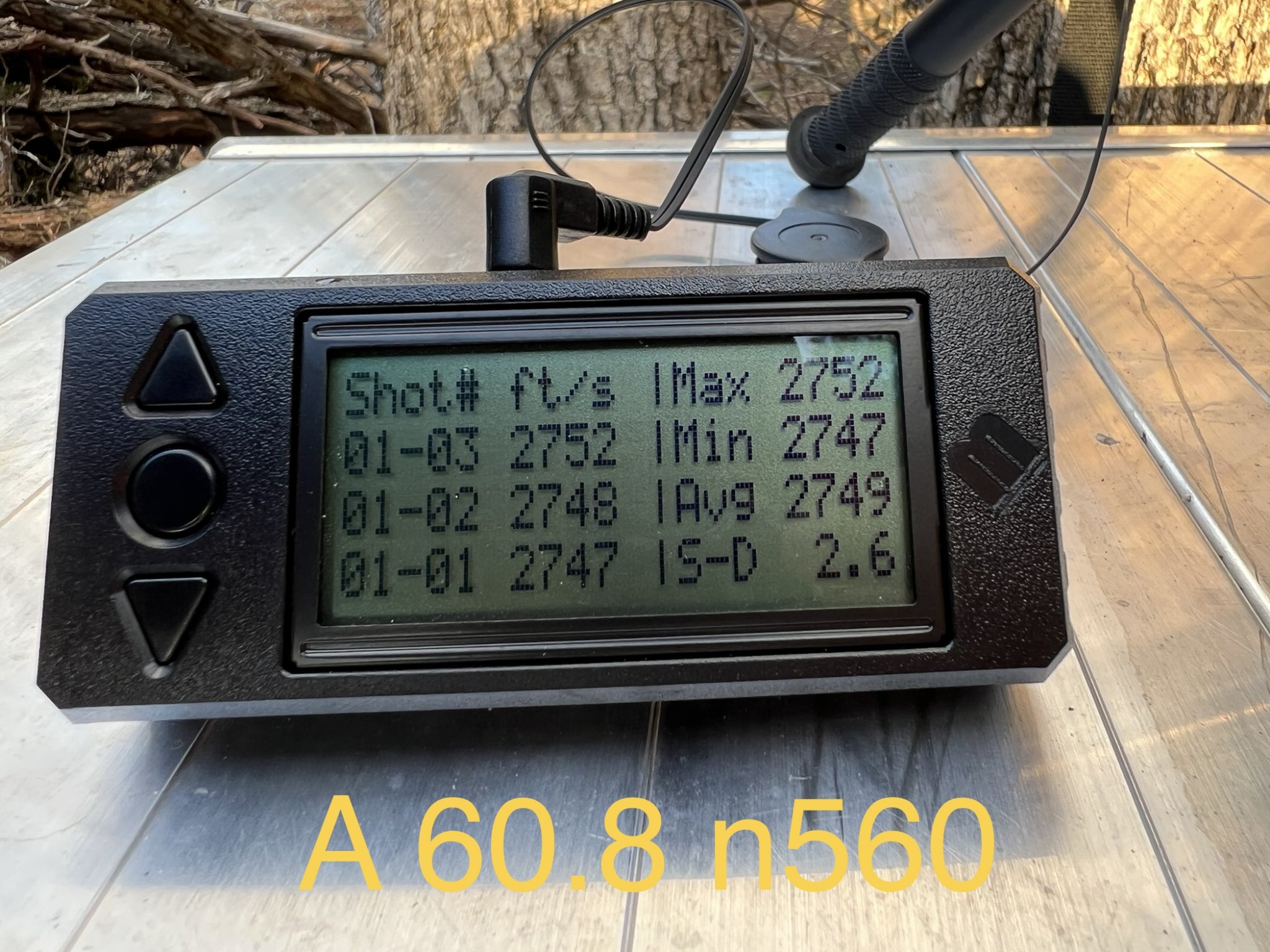

I've been shooting 7 SAUM with VihtaVouri N560 for about a year now and getting good results from both a short and long action with 180gr Berger Hunting VLDs (ADG brass, 58.4-58.6 grs N560, BR-2 primers). I have the same sort of problem coming up where I have what I believe is a SAMMI spec chambered 7 SAUM (X-Caliber 28" carbon fiber barrel) on a short action that I want to shoot the lighter 160ish grain bullets out of. The 180 gr Berger VLDs using N560 are on a 24" barrel and that's where I think the faster (N560) powder works better. N165 is a little slower than N560, but almost the same. For the 28" barrel, I plan on using RL-26 or H1000 (if I can find more than the pound I have) to boost speed. I've definitely seen much better powder availability with VihtaVouri in the last year or two. Zero RL-26 or H1000.
For a data point, I was seeing an average velocity of 2780 fps with 58.6 grs of N560 on the 180 gr Berger VLD/ADG/BR-2 load. That was from a 24" barrel at 88 degrees F, density altitude up at 9650. Groups were excellent at around 3/8". Hot summer time New Mexico.

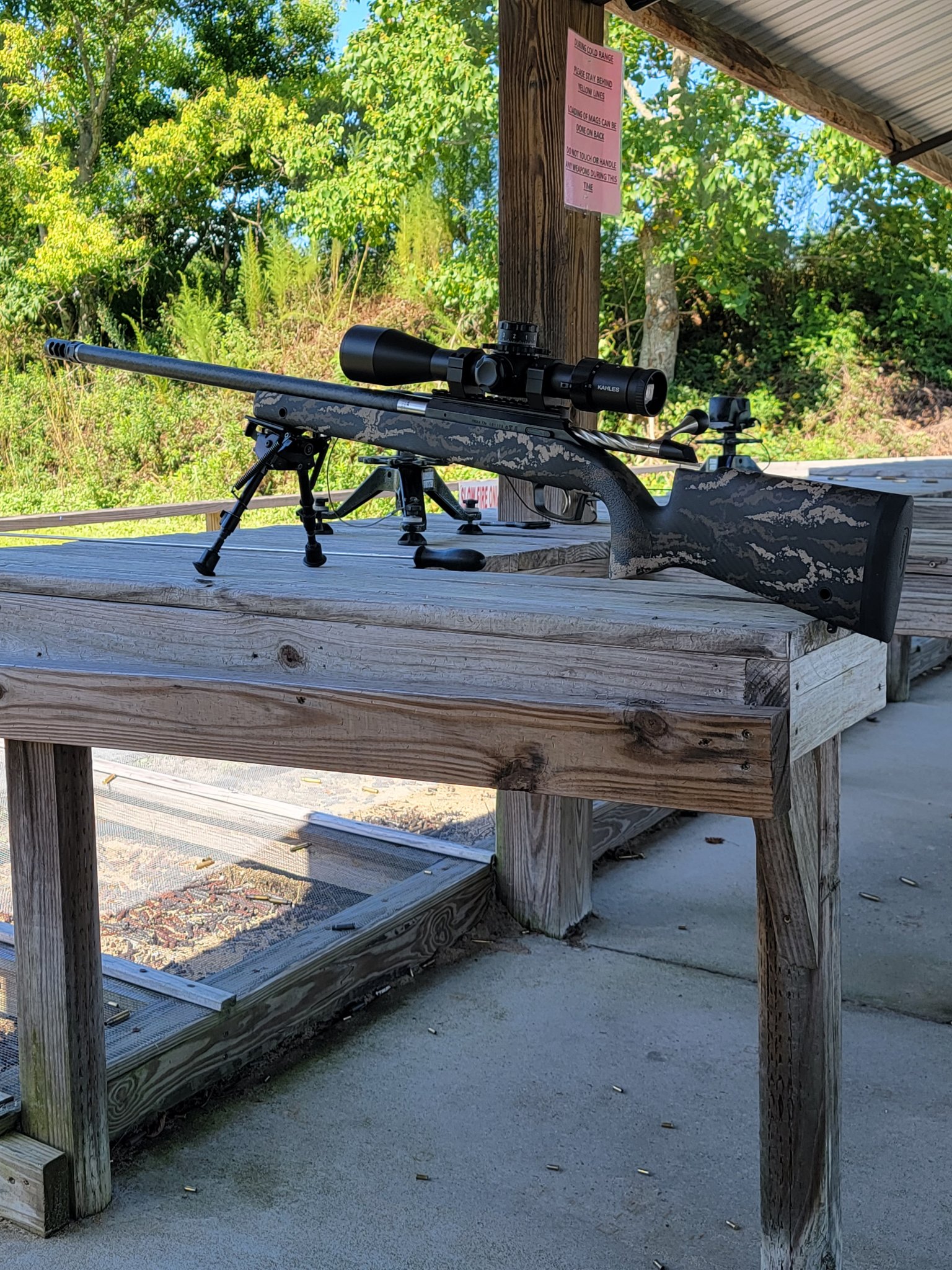

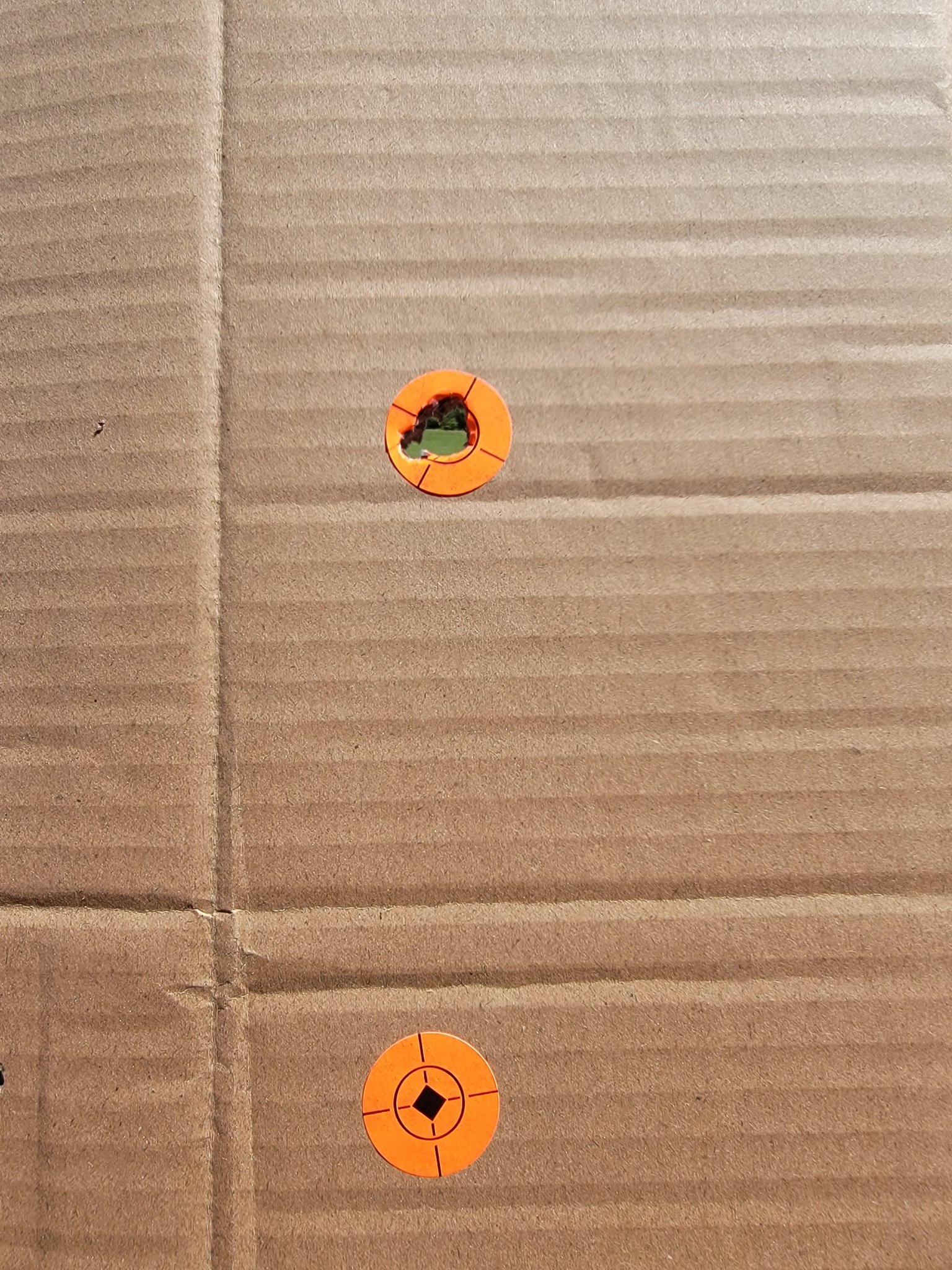

Got enough roundson the barrel to start doing load dev.
24 inch proof with .190 freebore on a Tikka running as long action
162 ELDs looked good with 63.8 of RL26@3025 fps.
Group pictured is 62.5 of RL26 on 180 hybrids @ 2925fps.
I might ease on up to see if I find another node, but it's hard to argue that.

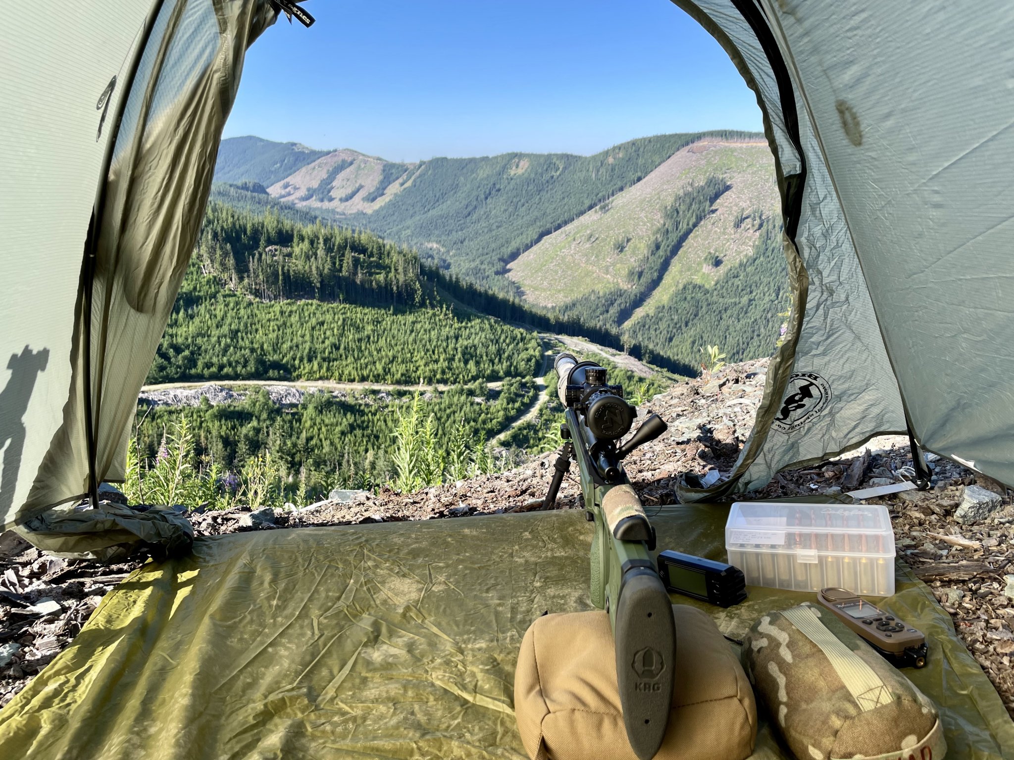

Sun came over the trees about 0830 and temps shot up to upper 80’s so I set up my tent to give some shade. Bugs were relentless. Probably should have woken up an hour earlier to get more time with optimal conditions.

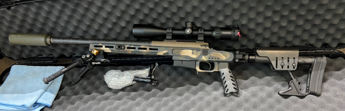

This is my rig. Pork sword chasis, vx5hd scope. Carbon six barrel. Salmon river solutions titanium brake and bolt knob.
Weighs 7.9 lbs with scope, and all accessories, weight does not include the mag and ammo.

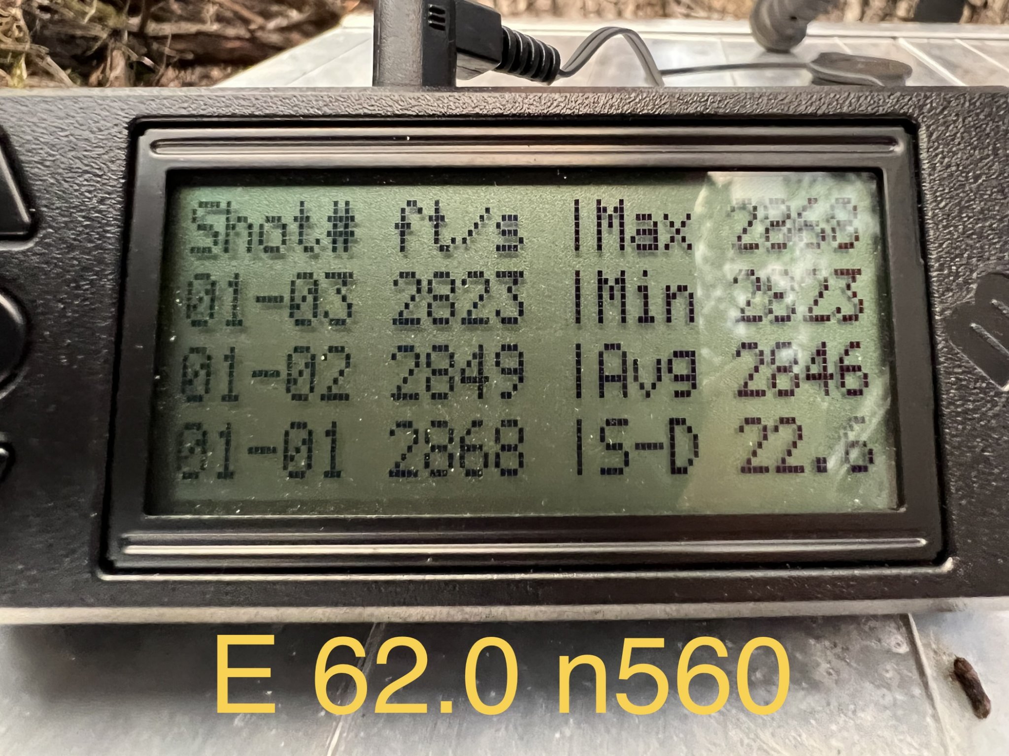

So far N560 is giving more.
Here is the fastest and bestest from today.
I haven’t run into pressure yet. So I am going to work just above 62 and see if I can find a node.
