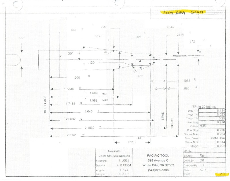

I contacted Criterion about ordering a 7 SAUM barrel, and they sent me a copy of the reamer print. If I'm reading it correctly, it looks like the freebore is .090. Am I correct that this wouldn't be long enough to run 180 and 190gr hybrids?
ETA: I'm running a SA, and I'm fine single feeding
I used to run 180 vlds in a short action with .090 freebore. Works but not ideal.

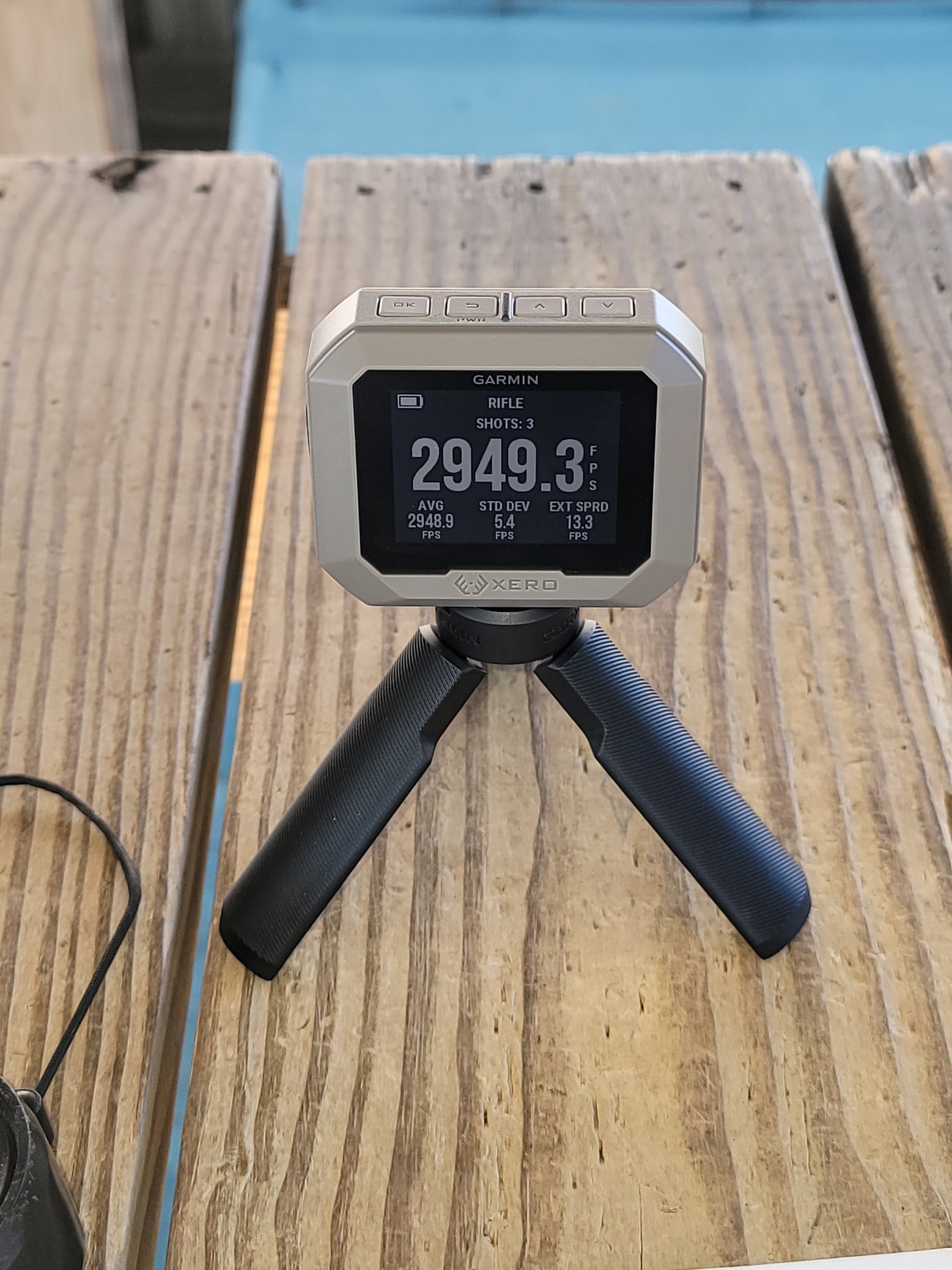

I’m running a 26 inch, 1:9 twist barrel with those 162gr ELD-Xs, N560, and getting around 2950 fps at 70 deg F.

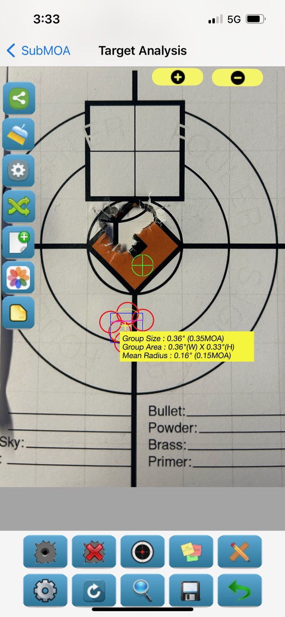

Most accurate was 3/8 moa for both 5 groups at 60.5. I probably won’t bother with anymore load dev with the 162. The other loads were hovering about 1/2 - 3/4 moa but that could have been me.
