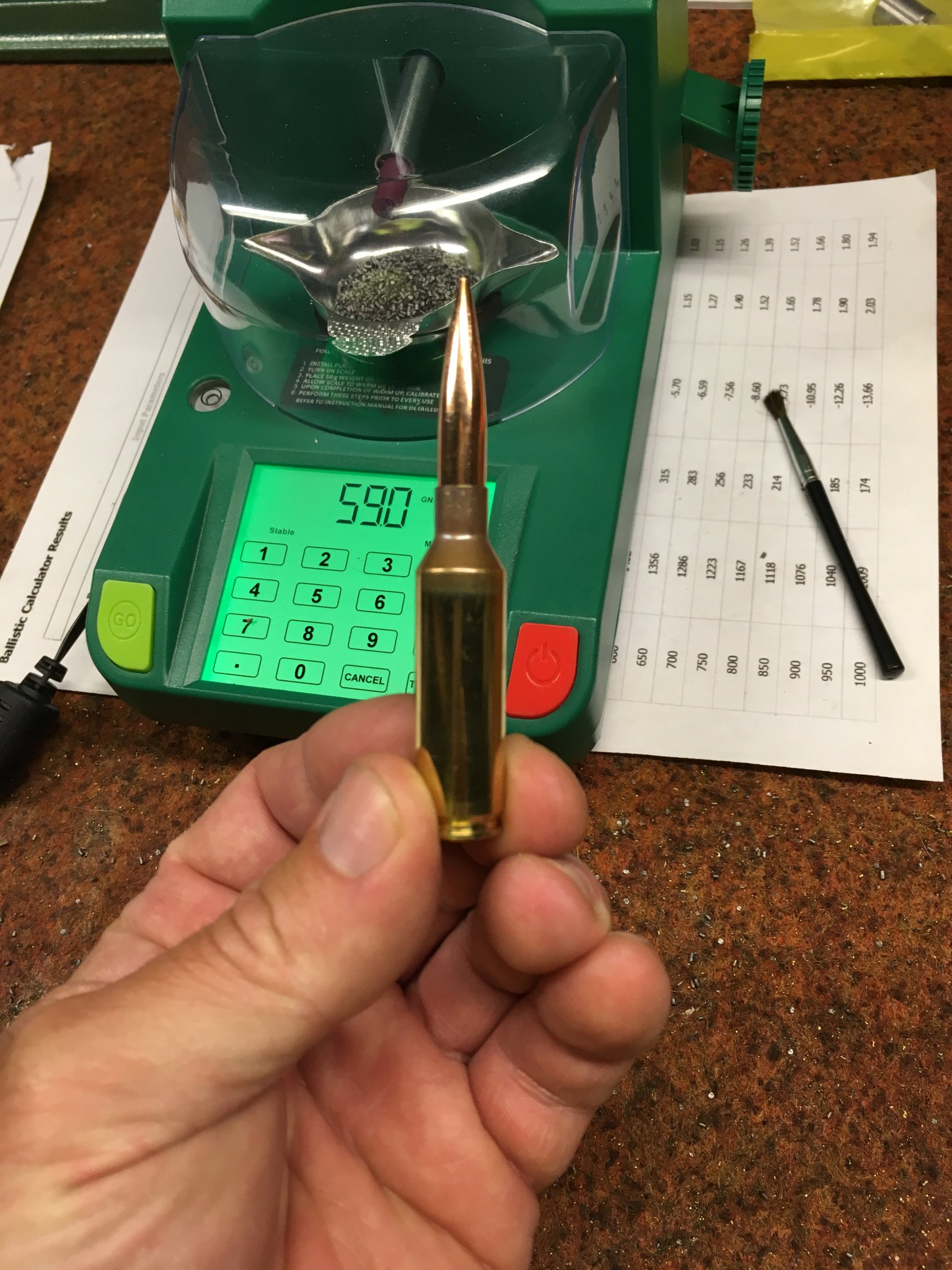

7 SAUM 195 Berger loaded long.
I see some guys are running magnum primers (215M, etc) but many running regular LR primers (210M, BR2, etc). Any ignition issues with non-magnum primers when it gets cold? I'll be starting off with H1000 and 180 ELDMs (prob go to Bergers after but have 300 of the Hornady on hand) and have tons of 210ms and BR2s, 1000 250s and maybe a few hundred 200s on hand as well as some 215Ms coming (for my 300 Norma). Is there a clear winner or really just any of them work fine?
