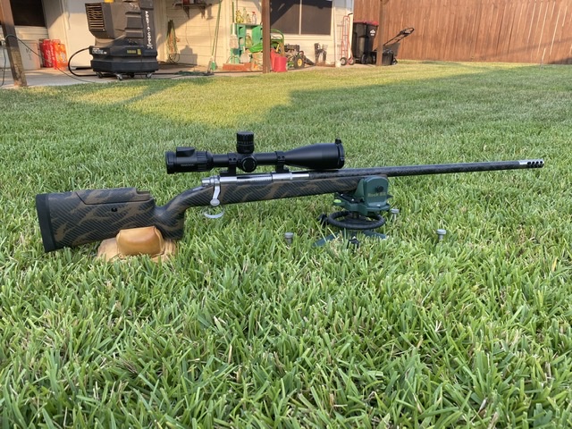

It’s done it’s finally complete! Thanks to Garret Maine Preece he knocked it out of the park and fast. 7mm Max Sherman can’t wait to get this brass fire formed so I can get on to my hot loads.
-AG Adjustable Hunter
-Remington 700 LA magnum
-Triggertech Special Trigger
-Hawkins BDL Bottom Metal
-Proof Reasearch sendero .284, 26”, 1:8
-Hardy Titanium Brake
-Talley Lightweight Rings
-Swarovski X5i 5-25-56
-ADG 7max brass
-58.5gr. of RL-23
-Berger 175 elite hunter
-2790-2800fps
-90rds dow the pipe still fire forming brass
-Stuff bolt lift hopefully that goes away after forming the brass.
-1 hole groups at 100yd and clover leaf 200yd Groups so far.
