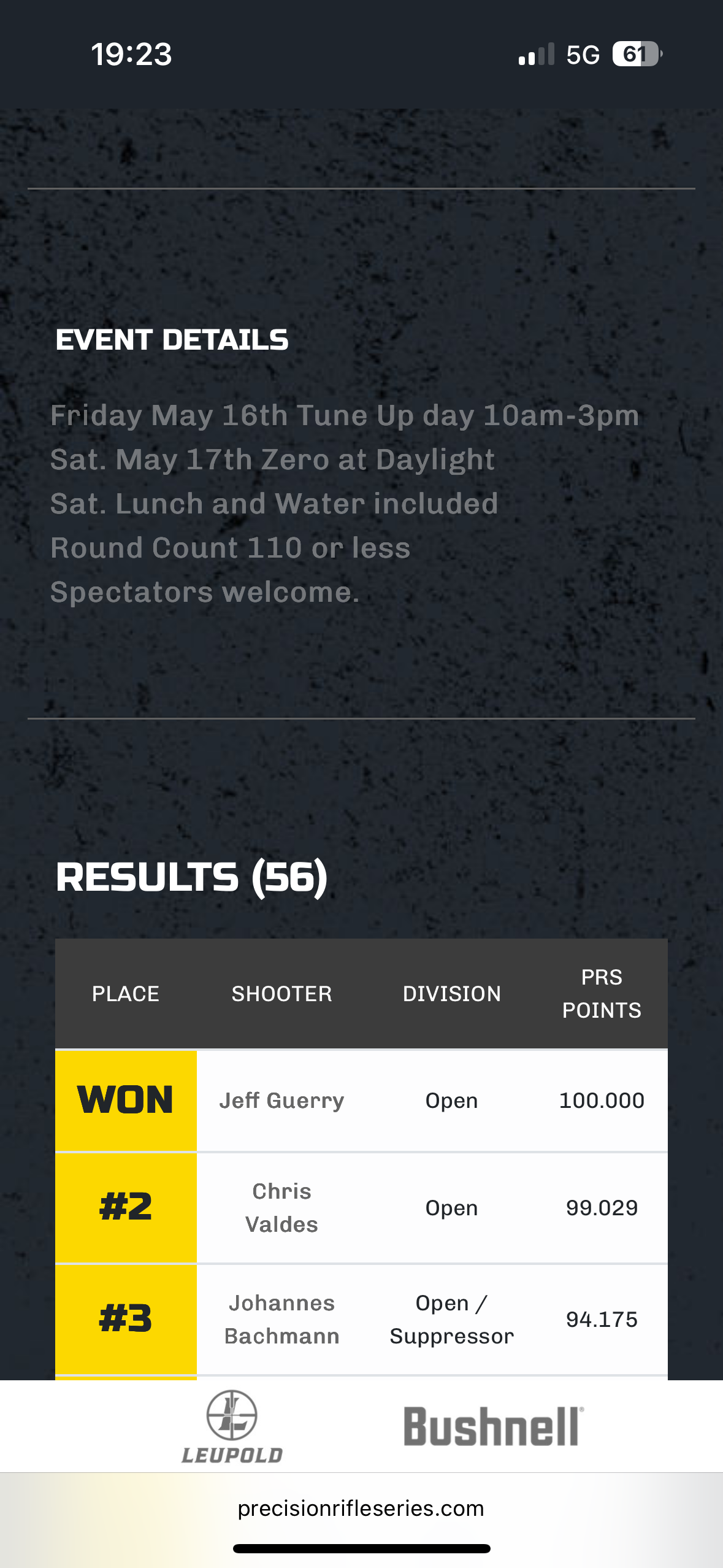

Watched one of the top PRS pros run a 7mm SWC recently at a SE PRS event (he can win with anything). He was in my squad so I got to watch 10 stages. He did win the one day with the 7 SWC. He was obviously eating a lot more recoil than a Dasher etc. Those 190s hammered targets so no doubt on impacts - but, the 190s hit targets so hard tough to see "where" on target to truly "see" impacts. Not like Dasher where one can say "I was 1/10 left of center so will correct". Also, on TYL type targets - we had a "engage big to small" then engage "small to big" - problem is the small targets were swing so much that he had to wait an extended time to engage.
I do not think you will see much 7SWC east of Mississippi again. I suspect he will save the 7 SWC for a very windy event west of Mississippi.
I wonder how much powder folks are able to cram in that case with a 190? My 7 saw doesn’t seem to be able to mag feed much beyond 43.5gr of anything really but particularly h4350 which I would imagine would be in the speed required for the 190.
Guerry won Clinton House running a triggercam

Jeff is a solid dude to shoot with. Pretty sure he shot the 7SWC at that 1 day match just to test it as the dude is constantly trying new things; at least more than most.
He also won that match.

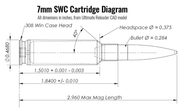

I can't tell if you're being fecetious but you usually aren't in your posts. Isn't the parent case of the 7SWC a 6.5x47L? Is there any sizable gain left these days in-between 6.5x47, 6.5CM, 6.5SLR, 260?
65cm speeds, shorter case allowing the 150+ gr bullets to be seated out of the powder space and not constrained by mag length. My 65cm with 153.5 Bergers touching lands is 2.985 coal. Jumping them a ways makes them mag feed friendly. As throat moves you have to start chasing the lands and I'm now at 2.965 jumping em 60k with 1800 rounds of match use.
The 65x47 fixes the coal mag fitment issue. But you lose about 4gr powder capacity, and about 75fps velocity ceiling. I'd be interested in what the actual water capacity is on the 7swc.
