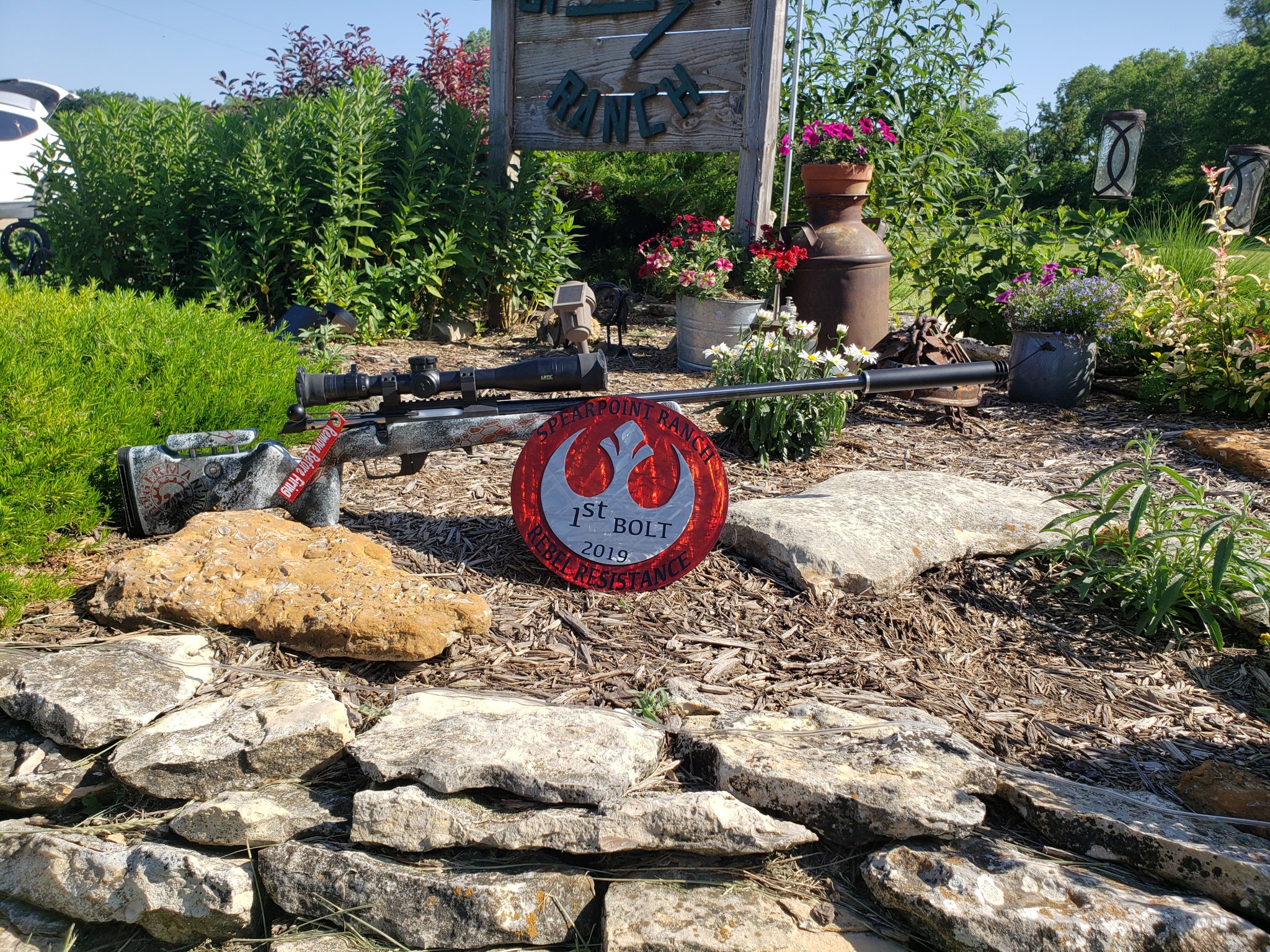

I am getting the same results as @padom with my Tikka Varmint, 75gr ELDM, H4895, CCI450, and Nammo brass out of my Tikka Varmint. I have mine in a GGS and am using the MDT AICS mags loading to 2.49". I can go longer and they can be modified for more COAL. It is a hammer, my son took it to 1000 in a match and made a first round hit at 1400 with it.
