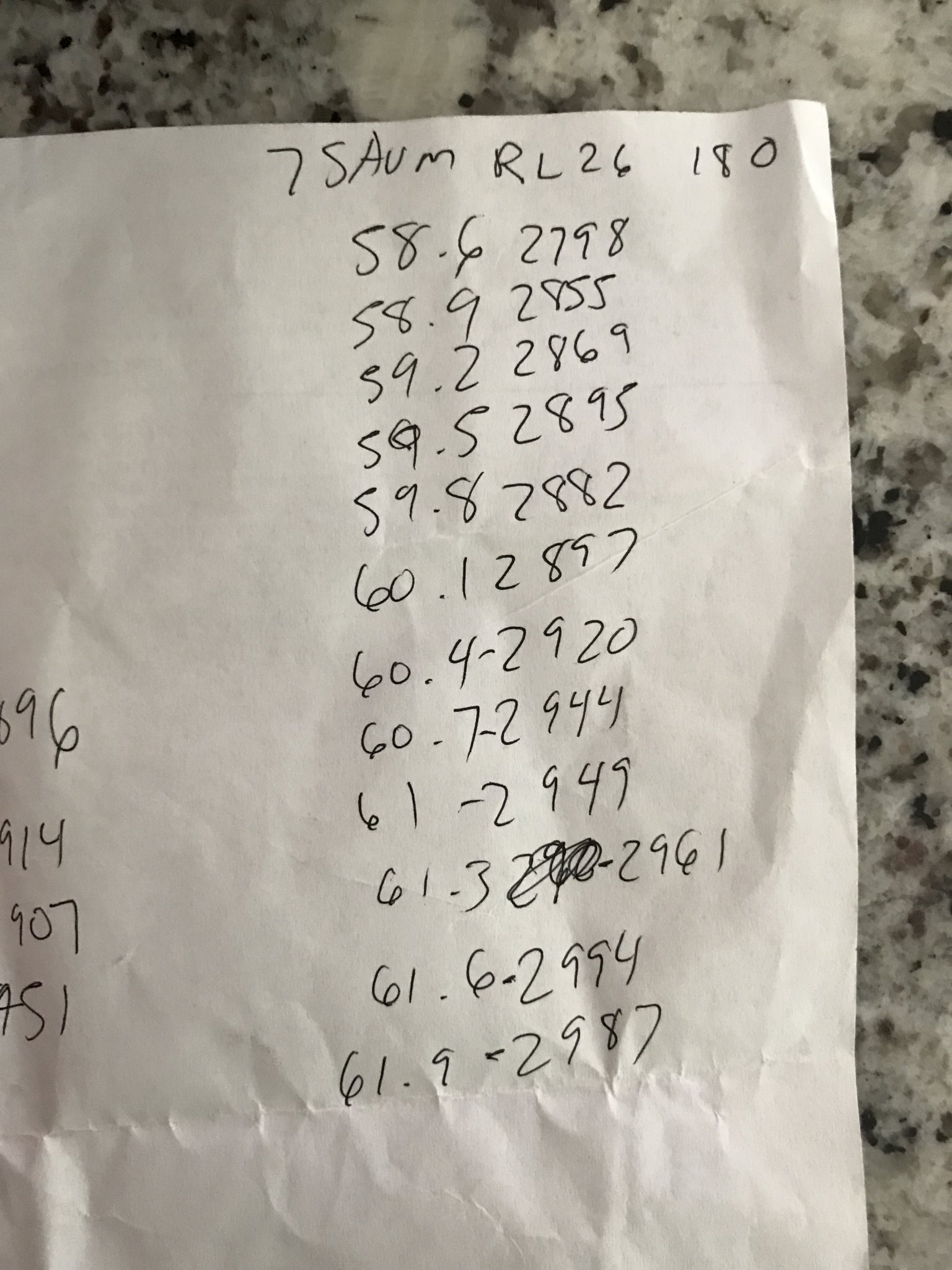

    Not trying to hijack thread but I took my saum out today first time shooting 175 elite hunter with rl -26 done a latter test and got up to 61.2 grains with a velocity of 2826 24" barrel. Ant thoughts on how much more I can go up on powder I had no pressure signs on brass or bolt.i no u can't give an exact number .never used rl - 26 before
    This is my ladder with 7 saum, Stiller action, 26” bartlein barrel, loaded to 2.9” OAL. RL26, 180. My sweet spot was 61, but I think my barrel length got me a little more velocity. You can see I had a higher node starting at 61.6 but at that point I was crunching and didn’t trust that pressure would be ok I’m warmer weather.
    I think high 60.8-low 61 could be good. Your dope should be excellent at 2850 fps range. You might be able to inch up another half grain, but I would be super cautious.
    I’d think you can get to 2850-2875 easily
    If this is new brass and barrel you’ll probably get there anyways on second firing of brass and the barrel speeds up
    I got to 60.5 with 180’s and 61 with 168’s.
    168 definitely had some more room to go but load at 60 grains just shot so awesome.
    Im gonna do a mild work up with the 180 eldm and see if I can get them shooting decent at 2850 so I can shoot the test and actually have them hit something.

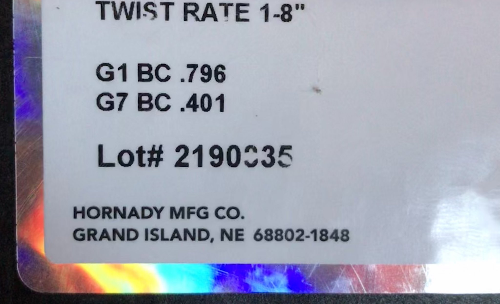

    Got some 180 eldm for free. 7mm rem mag 1-8 twist 28inch barrel had 90% blow ups at 100 yards!!!!
    I shot 10 of them yesterday,,,4-5 of them popped.
    I even dropped the speed to 2875.
