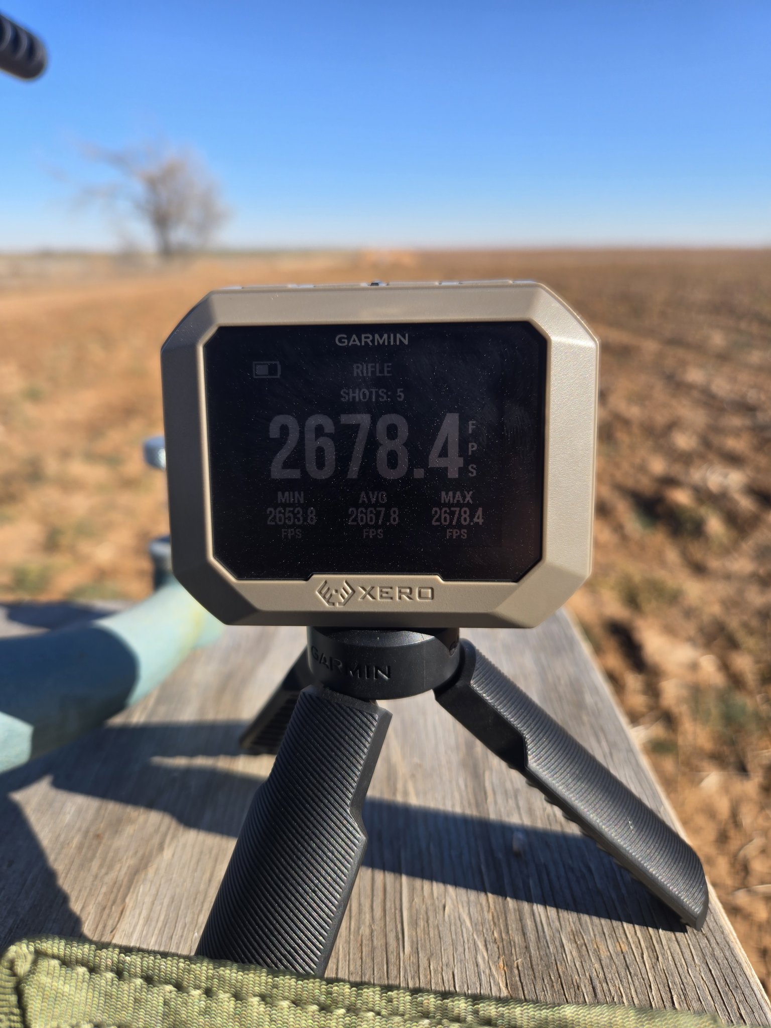

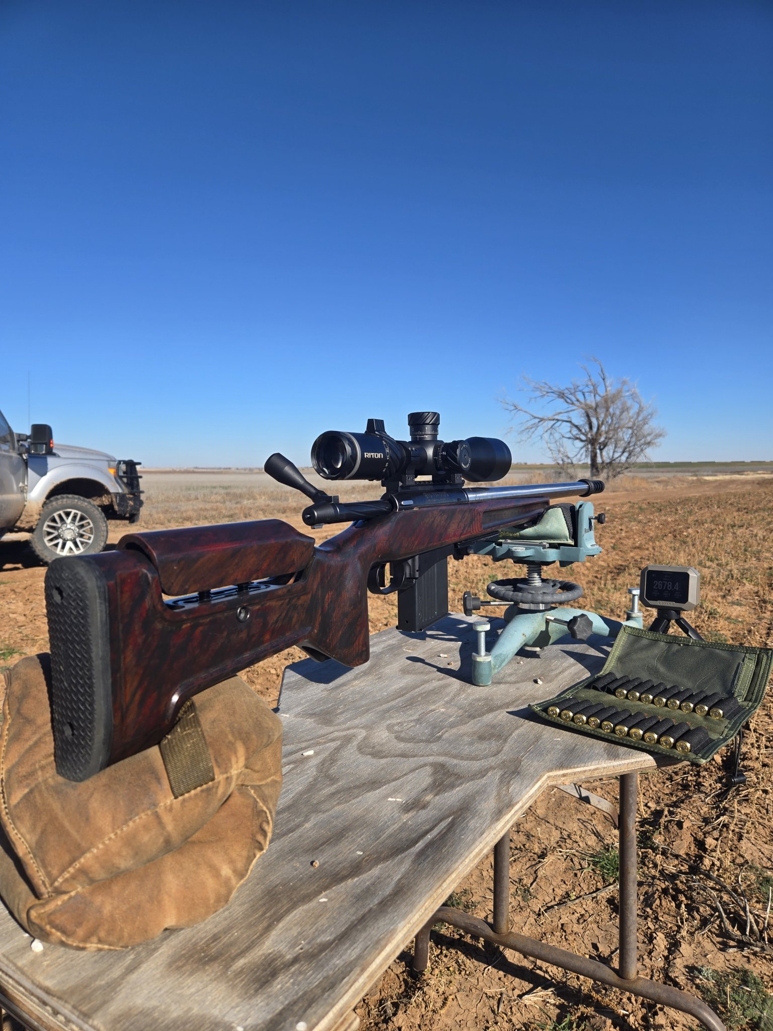

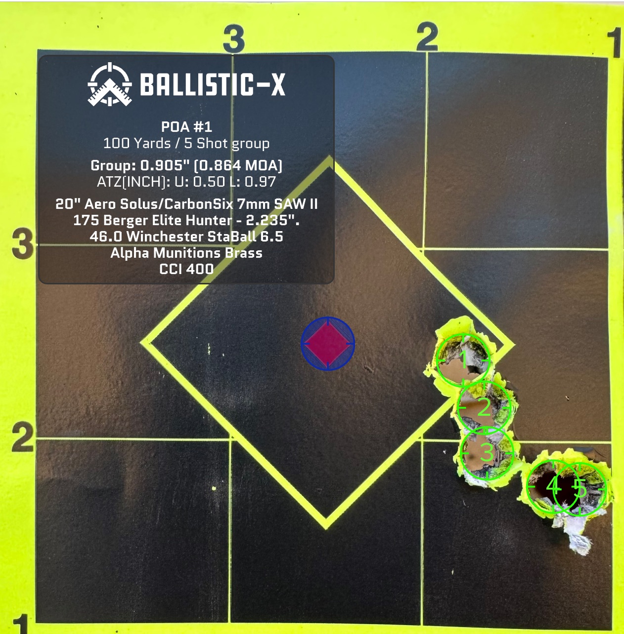

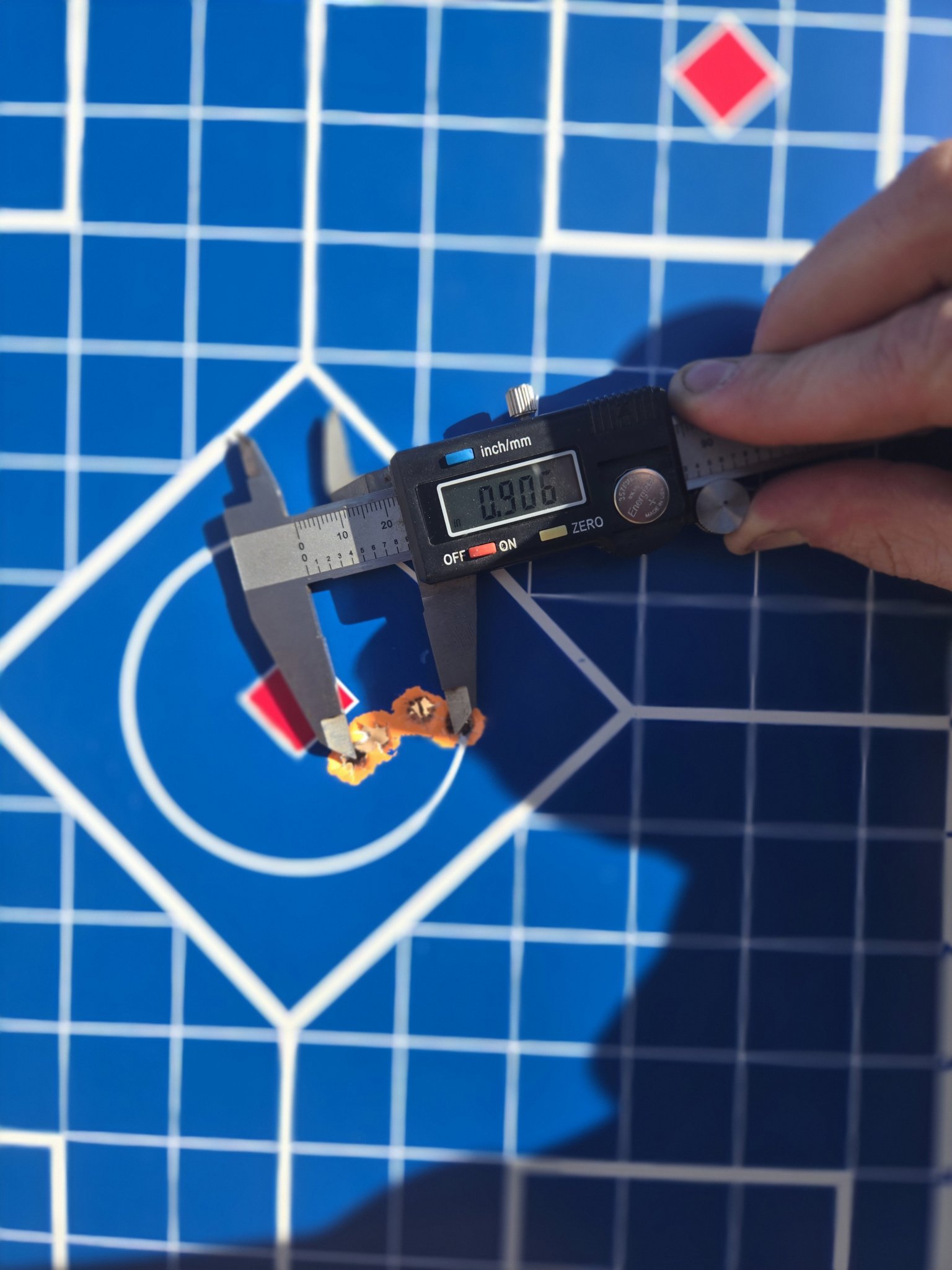

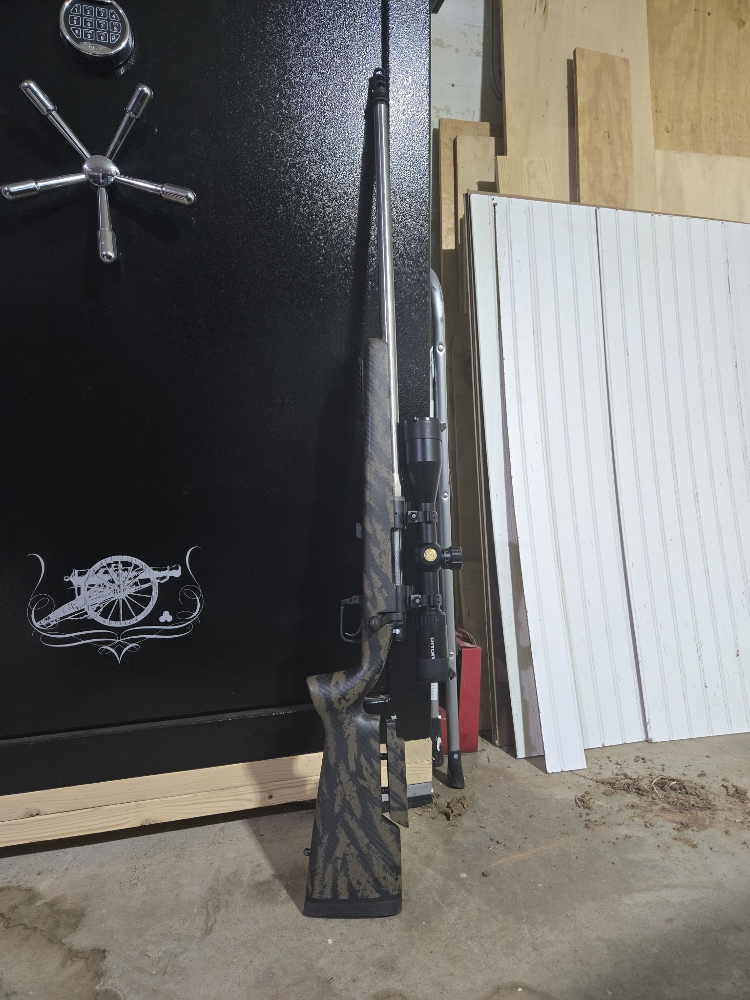

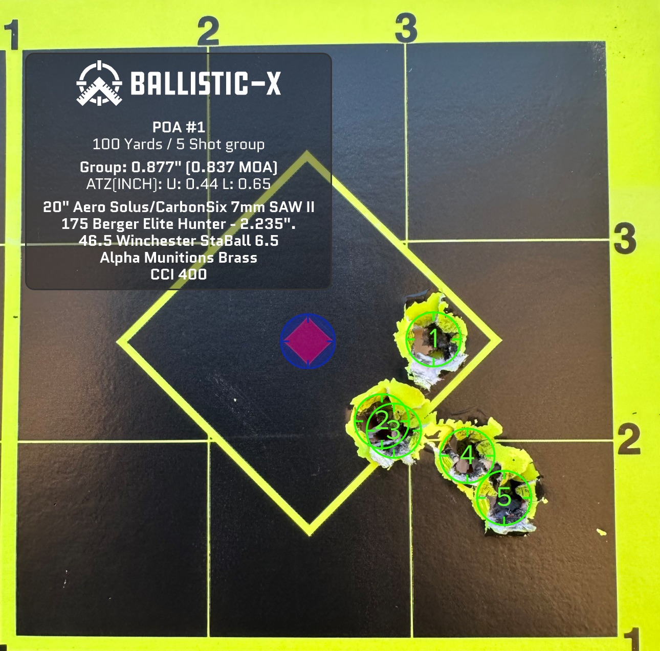

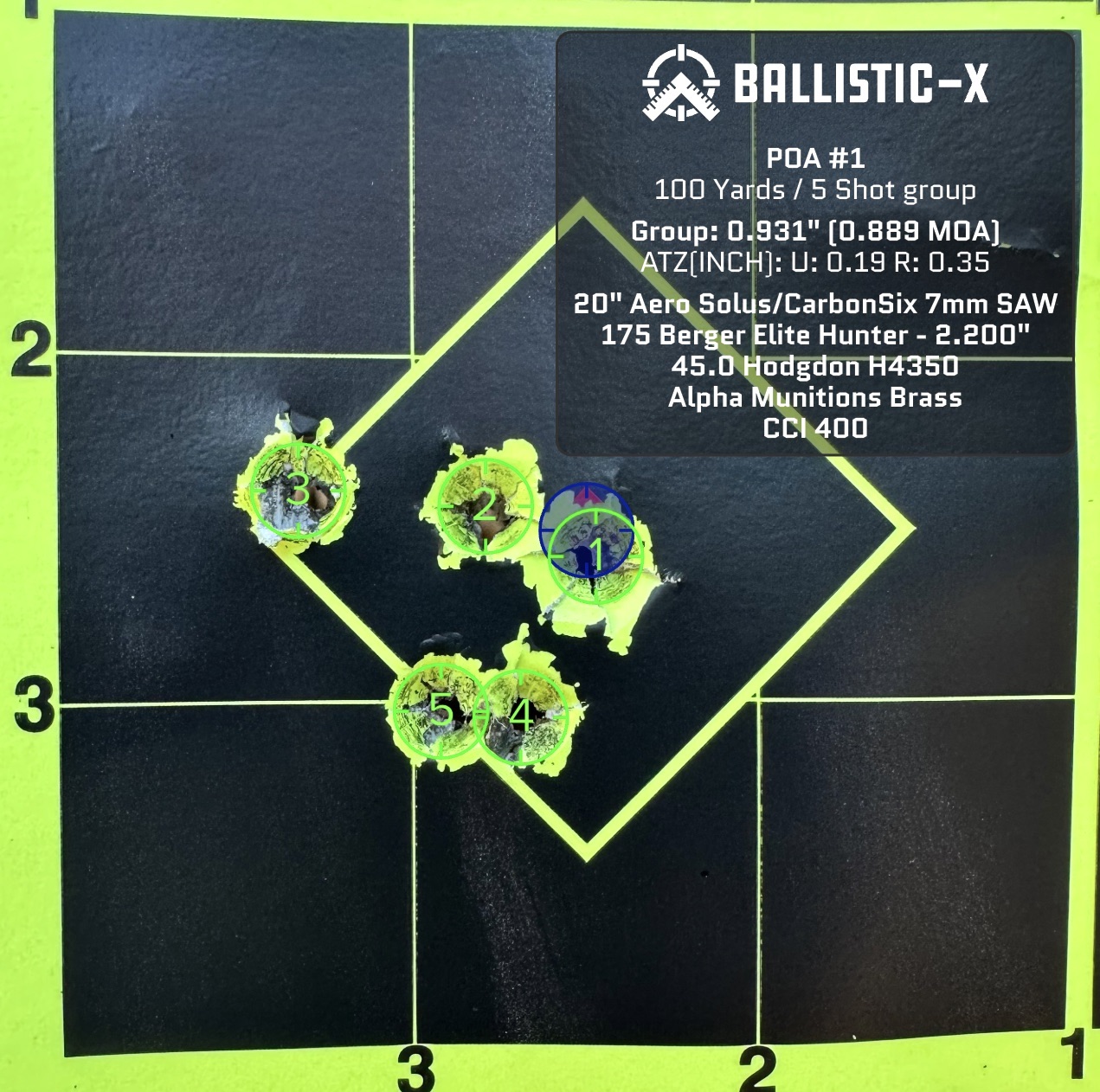

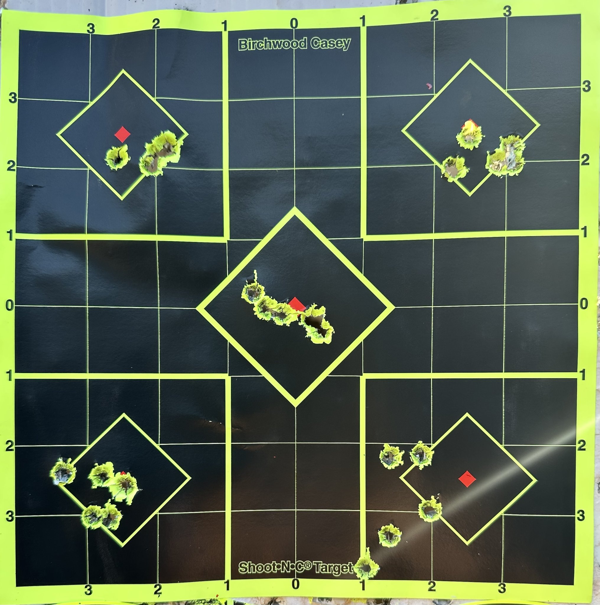

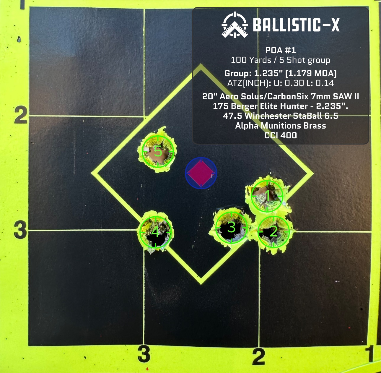

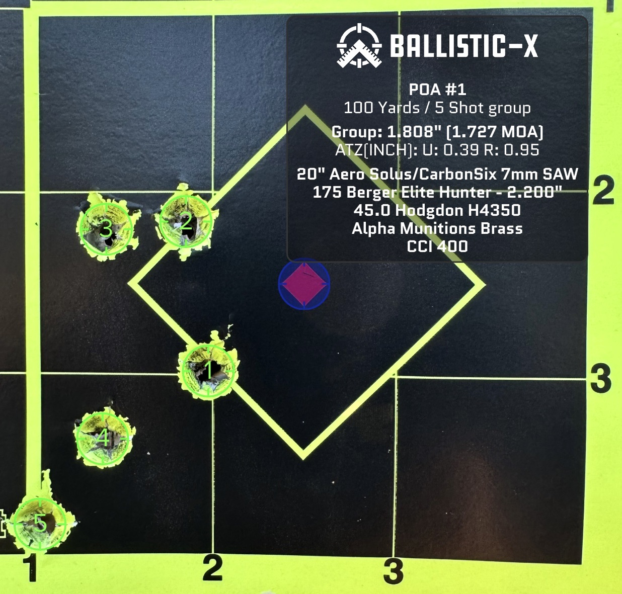

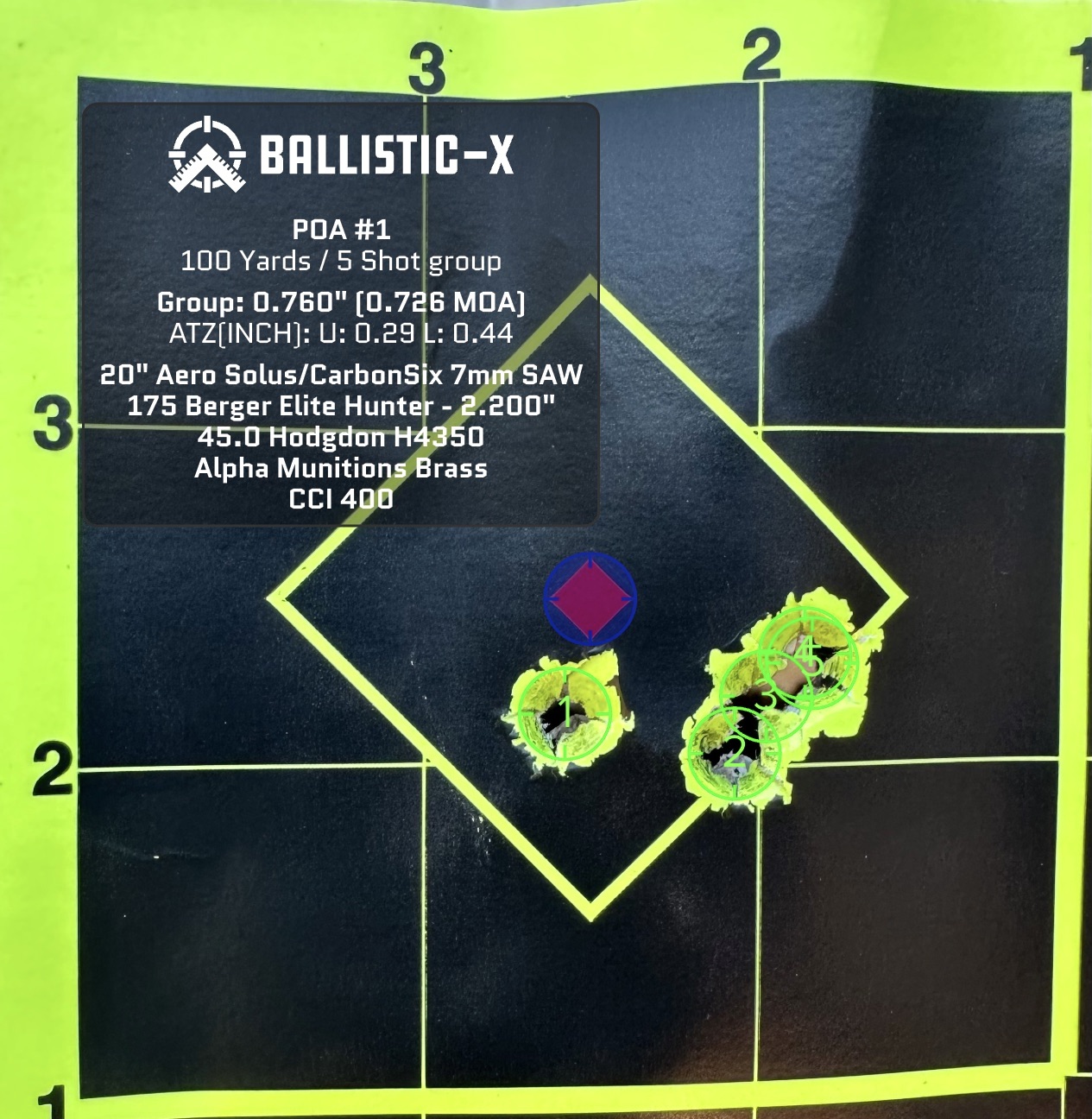

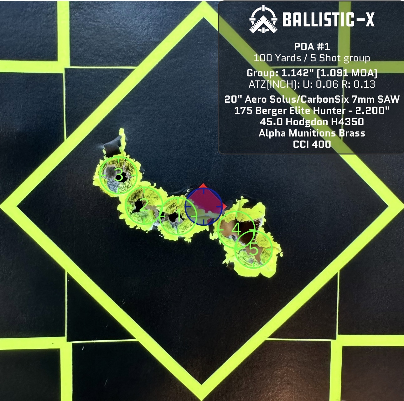

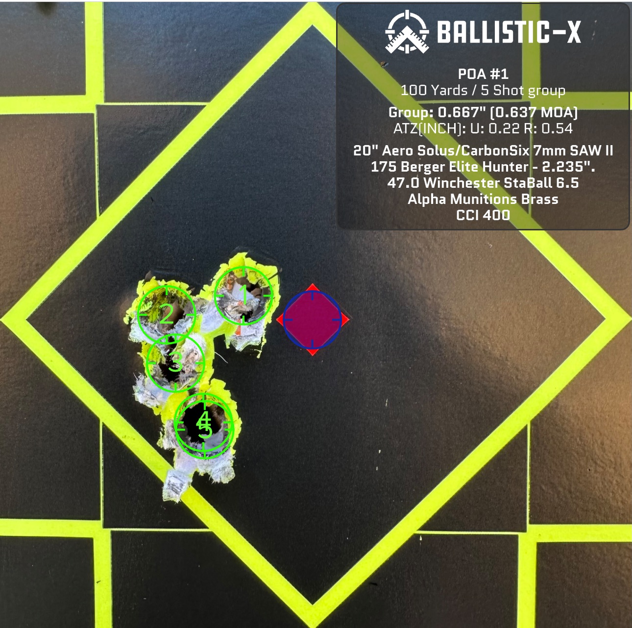

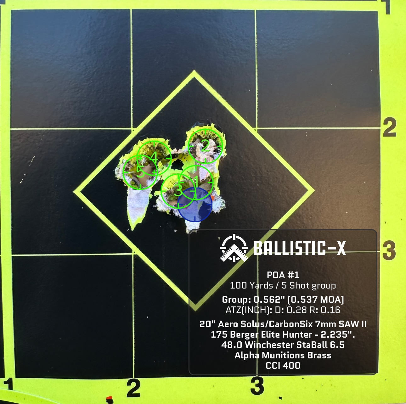

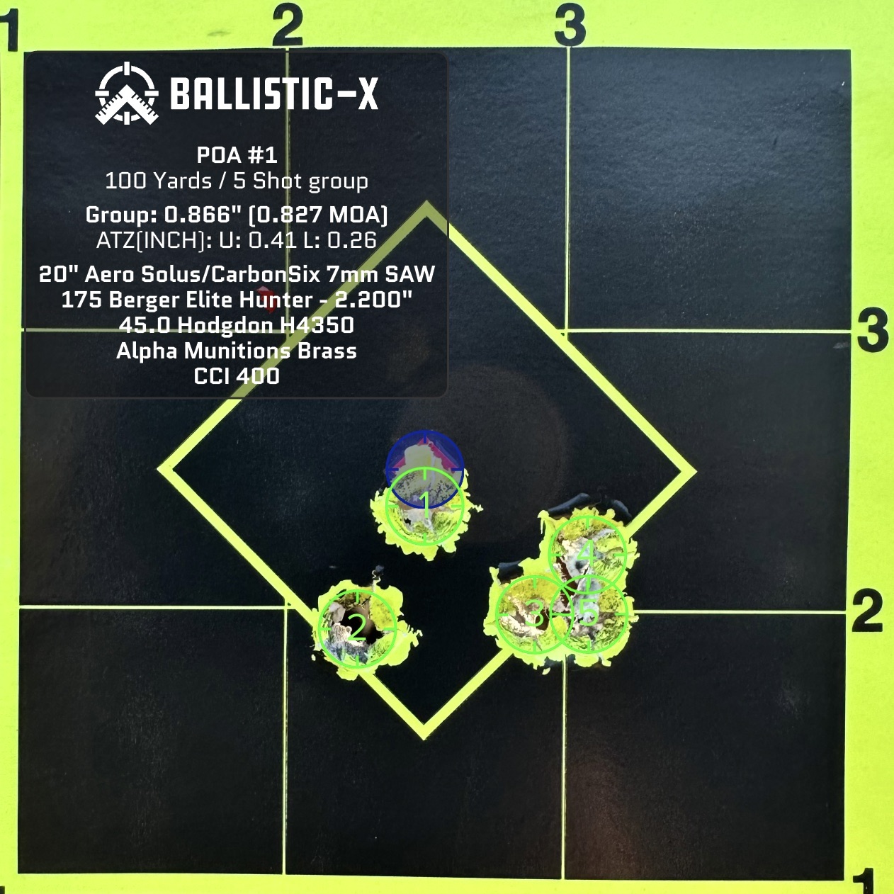

After last weeks shitty grouping continuation with the @CarbonSix 7 SAW, I decided to check concentricity, and the barrel threads are not concentric to the bore. All of my 9" cans leaned far enough with the alignment rod, that at the very end nearly had strikes. So, I decided, to try my 7" cans, and it was much better, but still cockeyed... But it was much more centered in the suppressor bore, than the longer 9" cans were, so I figured it would be less of a chance of causing any interference with the groups.
So, I decided to try my Magnus-S on the end to see if that would help... It actually, did, but still not enough for me to be remotely near happy with this barrel. I will be calling Gene tomorrow about a refund or possible replacement... A $1000+ barrel shouldn't be shooting more than 1/2-MOA at most with handloads.
So, here's today's groups... They were ALL shot with 45.0 grains of H4350, Berger 175 Elites, CCI 400's, 1x Fired/FL Sized Alpha brass, same everything...
IMG_3228.jpegimage_cropper_F1EF4A78-D184-4478-927C-CF0F59714CA7-594-000000A8F7CFECDC.jpegimage_cropper_360E18A7-702E-444A-8168-77FDC35C3105-594-000000A9F20C9609.jpegimage_cropper_4FC54932-2C92-496C-8326-0B9ECA8FCFE5-594-000000AAB8426140.jpegimage_cropper_57400FC5-6A54-4F2B-BC16-246A1DA31F2A-594-000000AB89CB8F96.jpegimage_cropper_37B89FC7-6F86-4E6A-82BA-865279F9A74B-594-000000AC47C9F4D2.jpeg
Reactions: 806guns
Is Gene your gunsmith or someone from carbonSix?
Gene is the main guy who runs CarbonSix. He's not a gunsmith or a barrel builder. He's just the one I've dealt with since the beginning, when the other shitshow about the .25 Creed barrel (that never came to be) got ordered. He has been very helpful, so I'm sure it won't be an issue, it's just frustrating when you drop that kind of coin on a barrel, and a factory Aero Precision (Ballistic Advantage) barrel is smoking it... It should be embarrassing for a company. Not to mention the fact I've burnt through almost $150 worth of Berger bullets, and a half pound of powder (x2 different powders), and 2 trays of primers just to fight a losing battle. It's not about the money, it's about burning through those components just to end up having to do all that shit over again when I get a new tube for it. It was all basically for nothing, and a bunch of wasted time.
And no, I don't use a gunsmith for the Solus rifles, I build them myself at home.
  • Sad
Reactions: xsn10s
Oof, that’s bad.
Isn’t 0.5moa their guarantee?

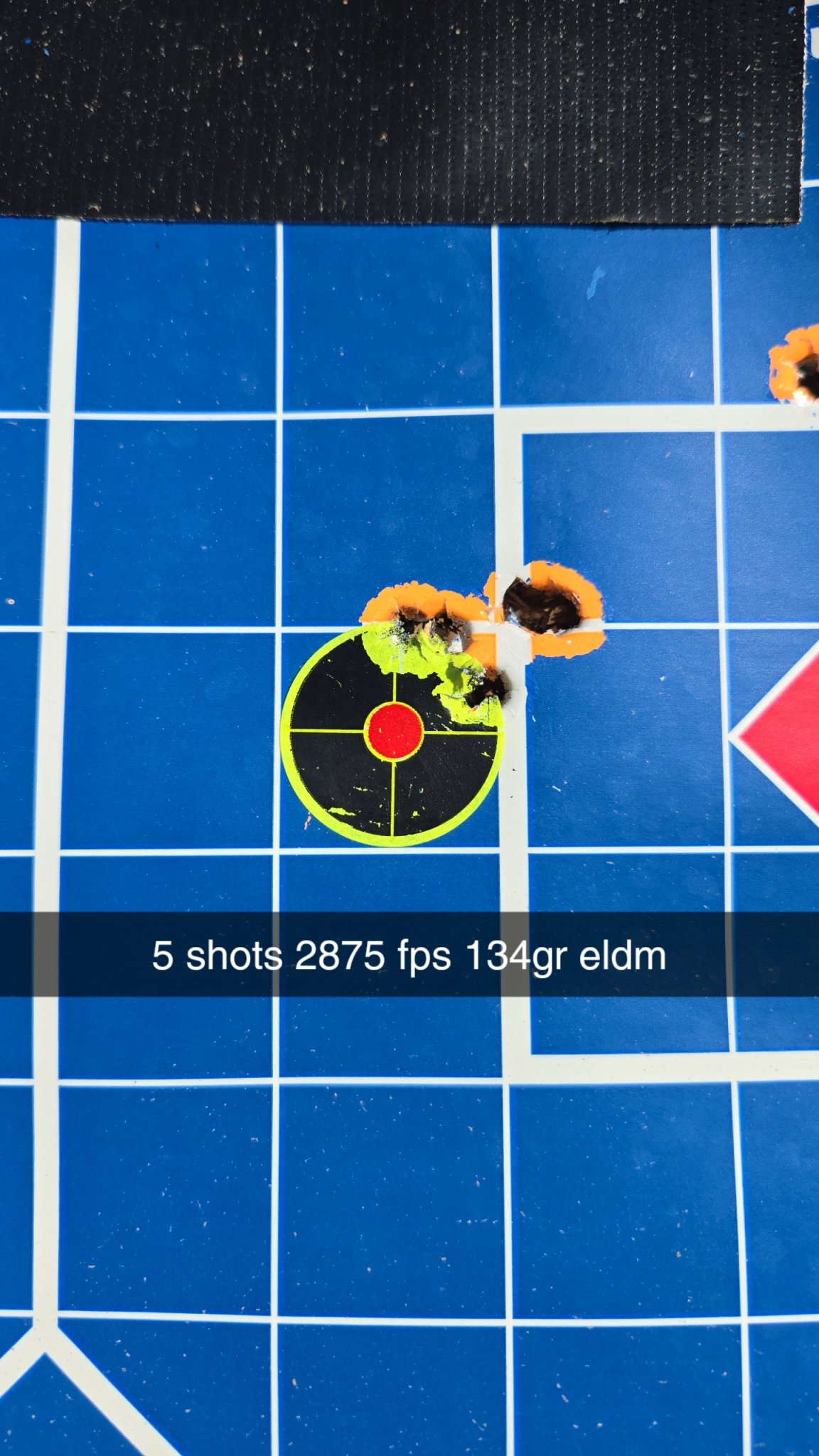

Here is my 25 saw.
26" Preferred Barrels Remage prefit
1:7.5 twist
Long action Remington 700 LH
Ag Composite stock
Using two bushings to neck down brass then through a mandrel. Using EC mandrel die
Running SW Long Rifle and will probably just run it. Shooting good with the 134gr eldm.

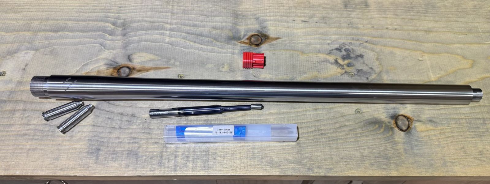

Ended up using Drews Precision. I bought a Alpha Reamer and sending it to him. I will probably have three barrels cut in the next few months for different rifles.

Well, the new barrel is doing better than the old one, but it's still lackluster at-best, and I'm not impressed. Especially for a company with a sub-1/2 MOA guarantee. I haven't seen any sub-1/2 minute groups in 50 rounds thus far. First 25 were all the same load (what my first barrel liked), and my 25 today, I did a load workup just to see if it preferred anything else. It actually preferred the same as the other barrel 47.5 & 48 grains of StaBall 6.5... If you notice, the groups did get incrementally better with each increase in charge weight, so I'm wondering if it still needs more time to fully break-in. Group 4 the 2 fliers to the left, were MY FAULT. The mirage was so terrible today, even at 100 yards, with a cold bore, that it was really hard to get a good image through the scope, and as the can heated up, it only got worse. 3 rounds tops, before it got so blurry you had to wait for a breeze to blow the heat to the side, so you could get a clear enough image to take the next shot, and then repeat with shot 5. I had to do this with every group today. So, the 2 fliers to the left of the bullseye on Group 4, were on me. I felt it when I pulled the trigger.
Here's today's groups...
IMG_6420.jpegimage_cropper_46EED7ED-7E63-4A1A-A394-E22F1D7C72C3-8378-000006A231D68CF3.jpegimage_cropper_2903BBC4-35E9-4FAF-8A68-F08ABA75A73B-8378-000006A315AA98FA.jpegimage_cropper_12060FE5-846A-45CA-81FF-DF11D694BF92-8378-000006A3FA884EB9.jpegimage_cropper_4E358ED2-850C-4D47-86EB-6AD186AF925B-8378-000006A4B583BD54.jpegimage_cropper_44CB1660-007C-419D-8093-B2BDD382E915-8378-000006A5FDF41D2A.jpeg
View attachment 8583845View attachment 8583846View attachment 8583847View attachment 8583848View attachment 8583849View attachment 8583850
I know you've talked about talking to the people over at C6, but if you're having trouble and can't get help let me know. Their marketing director shoots with us at the range all the time. I can get with him and see if it can help at all.
If you're talking about Gene, he's helped out a lot with all this, and has been extremely helpful with getting things squared away. But I've just always hated McGowan barrels, and this is why. They're not consistent...You'll get one that shoots great, then another that won't shoot for shit. I know McGowan is owned by the same people as C6, which is why they use their blanks, but goddamn... I waited almost a whole year for a barrel that NEVER got built, then I changed shit up, ordered ANOTHER $350 set of dies, more $135 a box brass, etc... just to find out after 300 rounds that nothing I could do would make the barrel shoot... Then I got the replacement barrel in, and now I'm just not impressed with it, either. I feel like I'm nagging, and I'm not hating on C6, but christ, this whole 7 SAW fiasco has just been one huge waste of fucking money. I'm almost temped to send it back for a full refund (wish I could get that $500 in components back... 🙄), and just have Eric @ Blue Mountain spin up a 20" 8-twist Proof in 7 SAW II just because I KNOW it will shoot 1/3 MOA when I get it. It's just frustrating man. It's a lot of time, and a whole lot of wasted money I'll never get back, on top of the cost of the barrel.
If you're talking about Gene, he's helped out a lot with all this, and has been extremely helpful with getting things squared away. But I've just always hated McGowan barrels, and this is why. They're not consistent...You'll get one that shoots great, then another that won't shoot for shit. I know McGowan is owned by the same people as C6, which is why they use their blanks, but goddamn... I waited almost a whole year for a barrel that NEVER got built, then I changed shit up, ordered ANOTHER $350 set of dies, more $135 a box brass, etc... just to find out after 300 rounds that nothing I could do would make the barrel shoot... Then I got the replacement barrel in, and now I'm just not impressed with it, either. I feel like I'm nagging, and I'm not having on C6, I promise, but christ, this whole 7 SAW fiasco has just been one huge waste of fucking money. I'm almost temped to send it back for a full refund (wish I could get that $500 in components back... 🙄), and just have Eric @ Blue Mountain spin up a 20" 8-twist Proof in 7 SAW II just because I KNOW it will shoot 1/3 MOA when I get it. It's just frustrating man. It's a lot of time, and a whole lot of wasted money I'll never get back, on top of the cost of the barrel.
I totally get it, there are sunken costs that you will never get back. I don't have any C6 barrels myself, and honestly have steered away due to the McGowan part. I'm not familiar with Gene, the guy that shoots with us is named Chris.
I wont ever do business with McGowan ever again.
Also why not try the old 42.3gr varget over 162 eld-m at 2.935in ? Maybe your barrel doesnt like staball or the 175s
Well, I know there's always risk, but I'm also a bit hard-headed, and I always like to be thorough before calling someone and sending something back or swapping it out. I like to be sure I've tried everything before giving up on it. This often costs me money and time. However, it makes me feel better knowing I did all I could, but in the end, it was just defective. And yeah, I hate McGowan barrels, especially when Dan Wynn worked there. He was the biggest prick on planet earth. Glad he finally retired...And I know I'm not alone in that sentiment. I haven't talked with Chris, so I'm not familiar with him. I've only dealt with Gene and Justin (before he got fired for incompetence).
If you want to talk about it with him, that's cool. I'm going to give it another 25 rounds or so, and see where we're at, if the barrel just needs more time to break-in or not. If it still won't shoot sub-1/2 minute, then it's getting sent back for a refund this time.
I tried H4350, which is what everyone, including WTO, recommends. But I just didn't get the speed I wanted. I'm getting 100+ more FPS from the StaBall. And still getting good ES/SD numbers, as well.
Ouch man. I sold the carbon 6 barrels i had and went proof. (Not 7 saw) after my ordeal with a 6.5 prc I don't think i will give them or Mcgowen a chance.
Yep. I was nice about the first one, because lemons do happen. But two in a row is not looking good. How's that old saying go... "Fool me once, shame on you...Fool me twice, shame on me...There won't be a third time."
Reactions: 806guns
Before you curb stomp it you might try Varget. It will not have the speed of the Staball but will beat the 4350.
The whole reason I went 7 SAW instead of another 7mm-08 or something like that, was for the added speed (and the case design). And H4350 only netted me the same velocities as StaBall 6.5 did in my 20" Christensen Ridgeline 7mm-08, and it shoots 1/4-1/3 MOA.
We'll see. StaBall shoots good in everything else I run it in, but worst case scenario, I'll try Varget and H4350 in the new barrel before shit-canning it.
