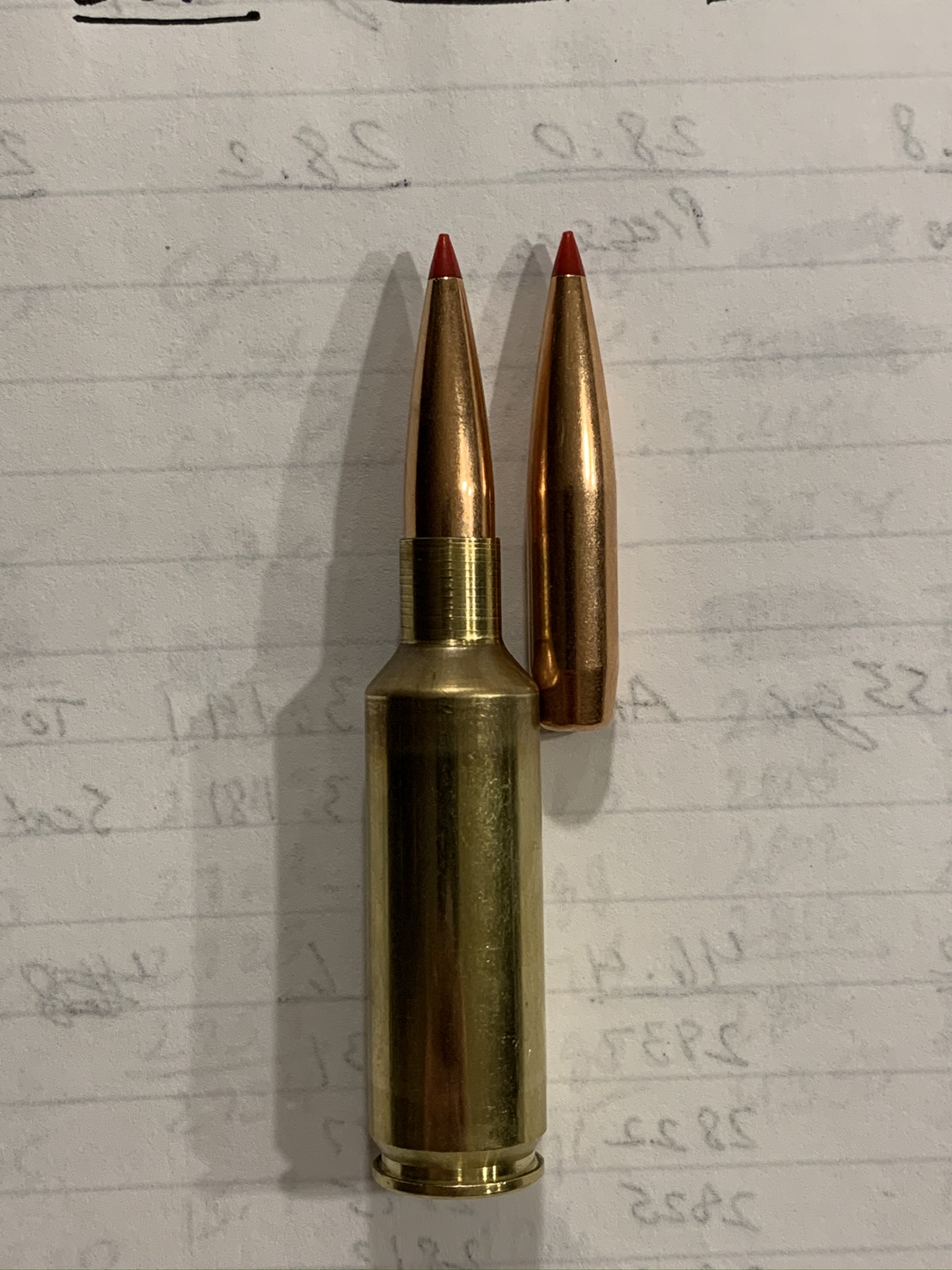

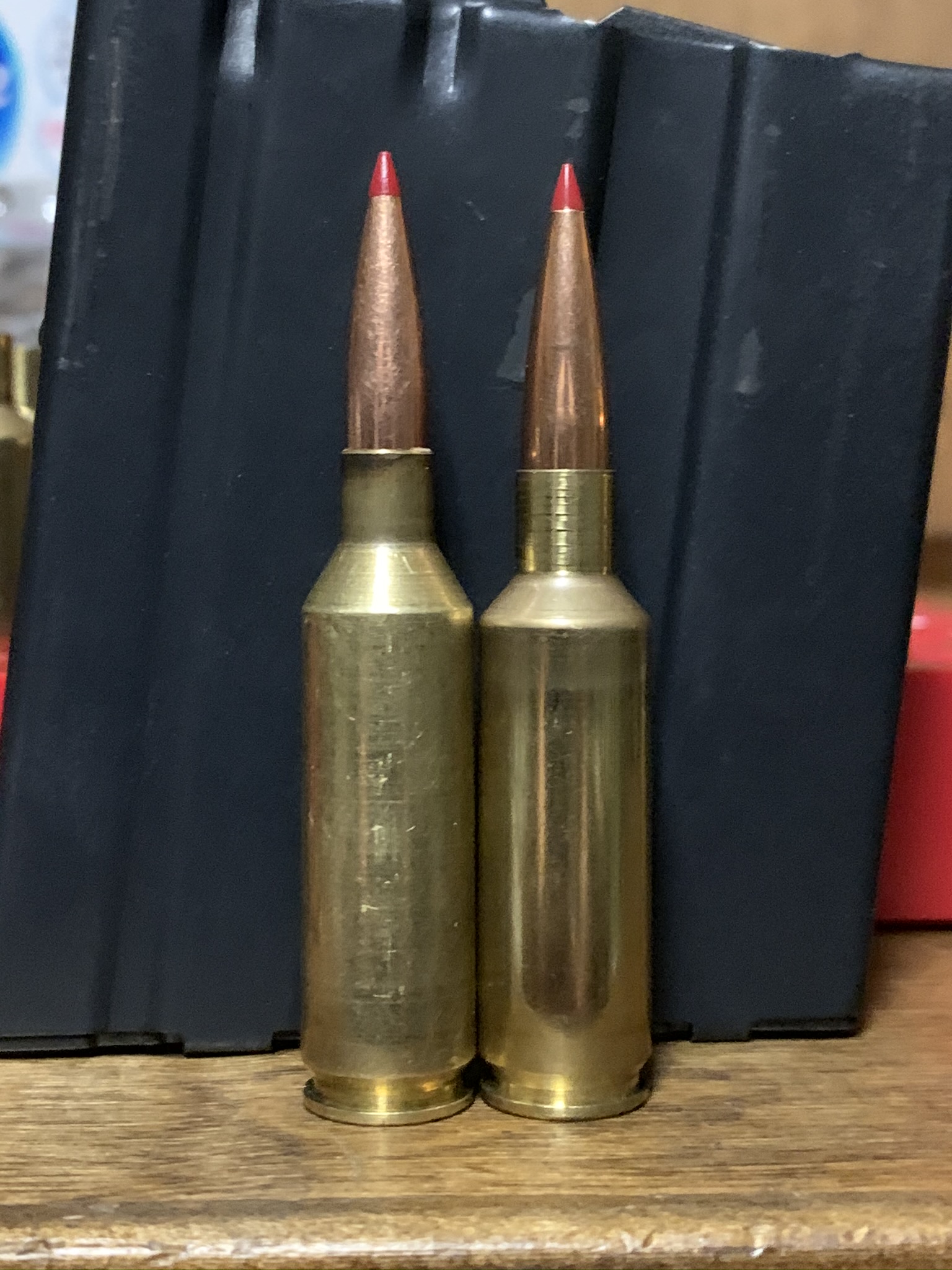

    Depends on the 180 your barrel and environment honestly. I’m running 180gr ELDm at 2900 out of a 24” proof with a max load of RL26. I haven’t run into pressure yet with my good batch of brass. 50 of my pieces rich had to turn and i think are on the thick side. I need to turn them.
    A shorter 180 like the hybrid which the Sherman was basically designed around will be able to hit 2900+ with relative ease with RL26 or N570.
    I still stand that it’s the best true 7mm short mag on the market if you’re willing to fireform.
    Off topic but this was why i was so disappointed in the 7 prc. Cartridge should’ve been at least medium. We have plenty of long action 7 mags.
    Reactions: Hondo1

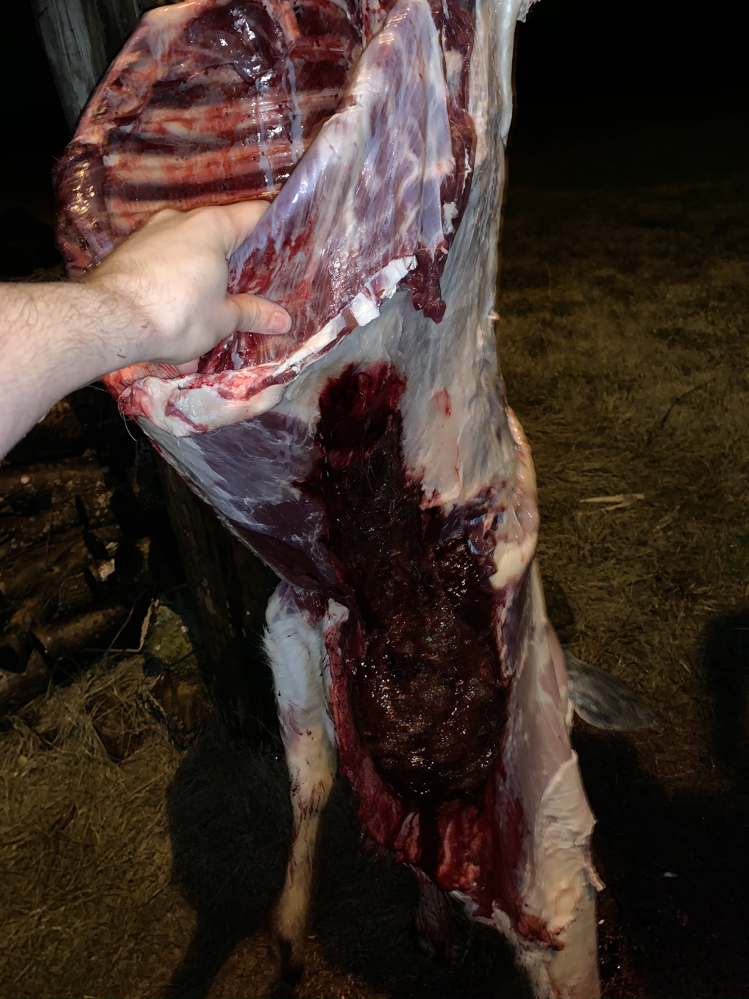

    Forgot to mention my OAL is 2.970. Even if you can’t get 3K out of a 180 it’s an absolute land cannon at 2900. Truthfully there isn’t much that rivals that much performance out of a true short action. I think I’m supersonic to 1900yds or something insane last i checked for my load. The doe in the bottom pic is through and through at 525yds.
