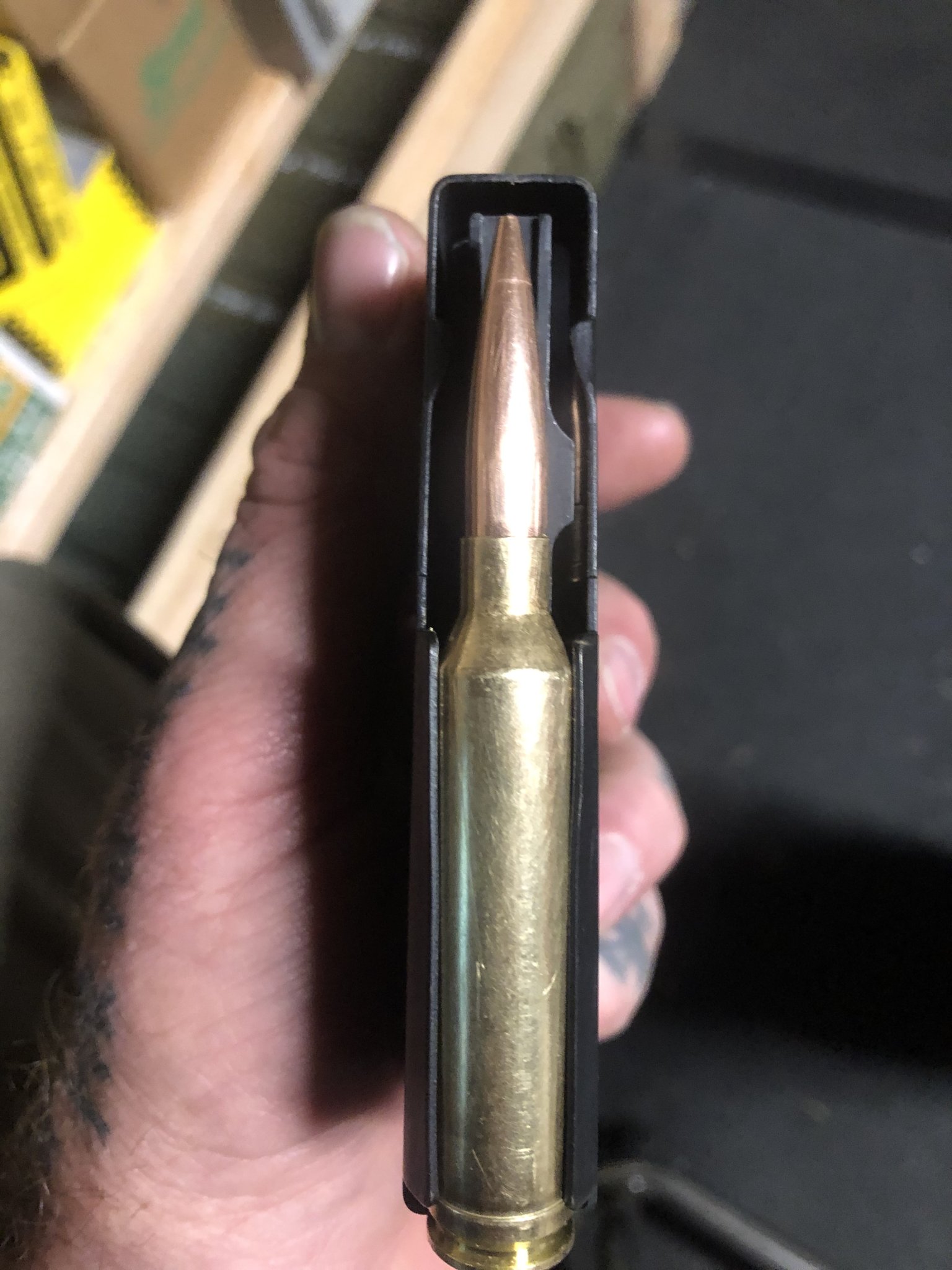

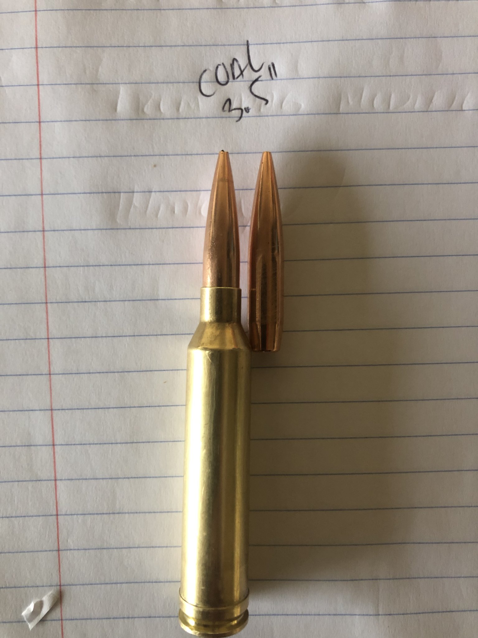

7RM 180gn Berger Hybrid COAL ??
HogsLife
War Machine Leather Works
  • Nov 28, 2018
    1,666
    2,264
    N. Idaho
    Curious what you guys COAL is with the 180’s? I’m getting ready to have a rifle chambered for them, I’m thinking 3.50” COAL touching the lands. Leaves me some room to chase if needed and gets the base of the bullet sitting right at the body shoulder junction. Sitting at SAAMI just sits way to deep in the case. Wanna get all the powder capacity I can
    Thoughts?

    Reactions: Schw15
    I've found that the 180's like a bit of jump. I'm at 3.475 (65 thou off lands). I load the 190's at 3.504 (38 thou off lands). The 190's show the most accuracy potential in my new 27" 1-8 twist PBB barrel.
    Reactions: HogsLife
    Right on. What are your loads / velocities for the 180’s and 190’s?
