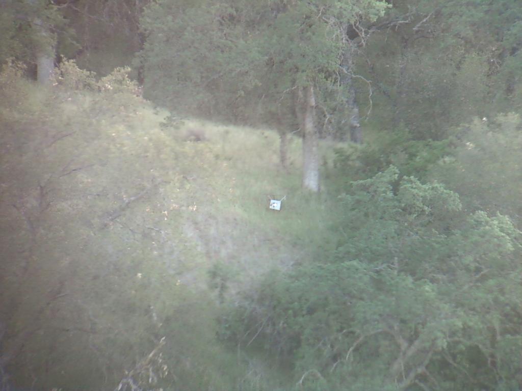

So I got around to shooting my 7SAUM again. The 180 Hybrids and Retumbo still performing great for me. 10" square plate(bullseye is bottom of spray paint 2 1/2"?) at 840 yard, shot prone with bipod and rear bag. First missed the plate by .3 mils, kinda missed judge the wind. Shooting through the canyon is real tricky, gets crazy winds. Wind was blowing to the left 3mph. Made adjustment and hammered the next three rounds. Love this 7saum, and now I found some Retumbo local, its time to shoot it more. Going to find a spot and hopefully get 1200 or so.
Love the "from the field pics"! Makes me wish I was out in the field rather than poking around the house and sitting behind desk... oh well. Nice spot you have there... looks like your group is ~4", so call it 0.5moa, darn nice.
