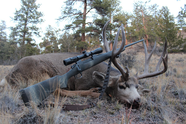

I just built a couple 7x57's on Remingtons with a lightweight theme. One was for me and I was able to take it hunting for Mule Deer here in CO. I rolled a big buck with the 140 Accubond over IMR 4350. I'm impressed by the performance as it seems the velocity is in that range where bullets perform well. Write-up here of the hunt if anybody is interested: http://sawtoothrifles.blogspot.com/2012/10/hunt-report-2012-colorado-mule-deer-w.html
