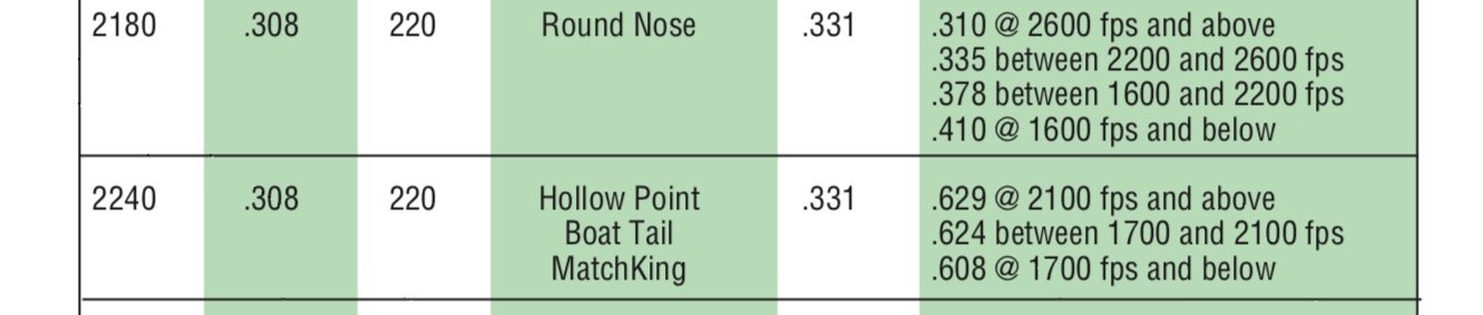

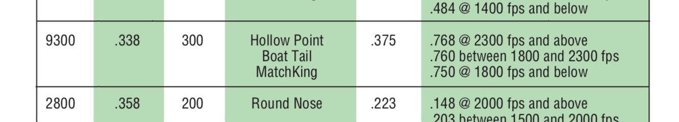

.300BLK pushes a 220gr. @ ~1kfps .338BLK pushes a 300gr. @ 1kfps. So the momentum is 220k vs. 300k. Hardly anything to write home about and considering it takes the biggest and heaviest platform to send it, well, I guess I'll stick with my 8" .300's. They were made to solve a problem.
