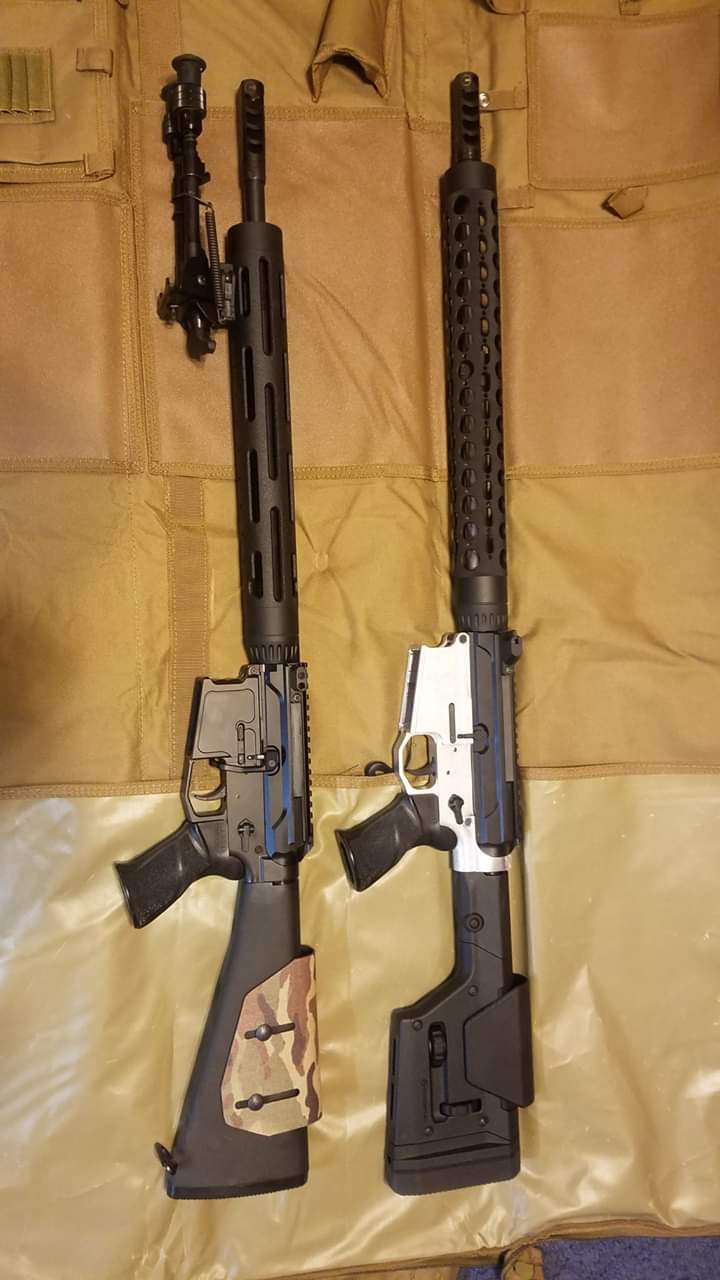

Thanks for the help guys. I bought 2 barrels but settled on the 18" 1/10 after more research and the last comment made me get a fuzzy feeling about it. I wont be reloading yet and by the time I do I'll be going to a 6 ot 6.5 barrel and reload for that. Now I just need a scope for and I'll be able to get out and shoot it.
