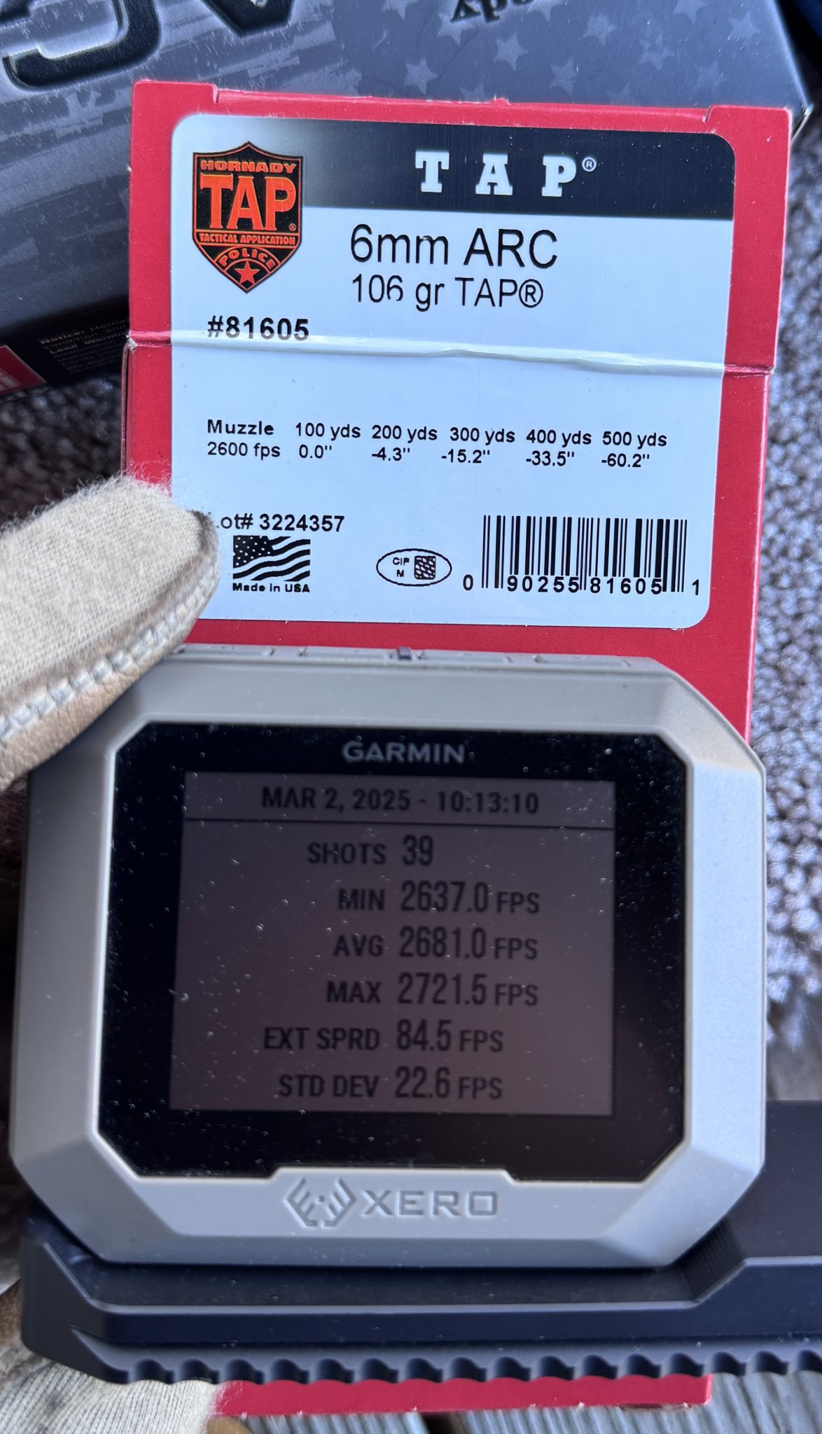

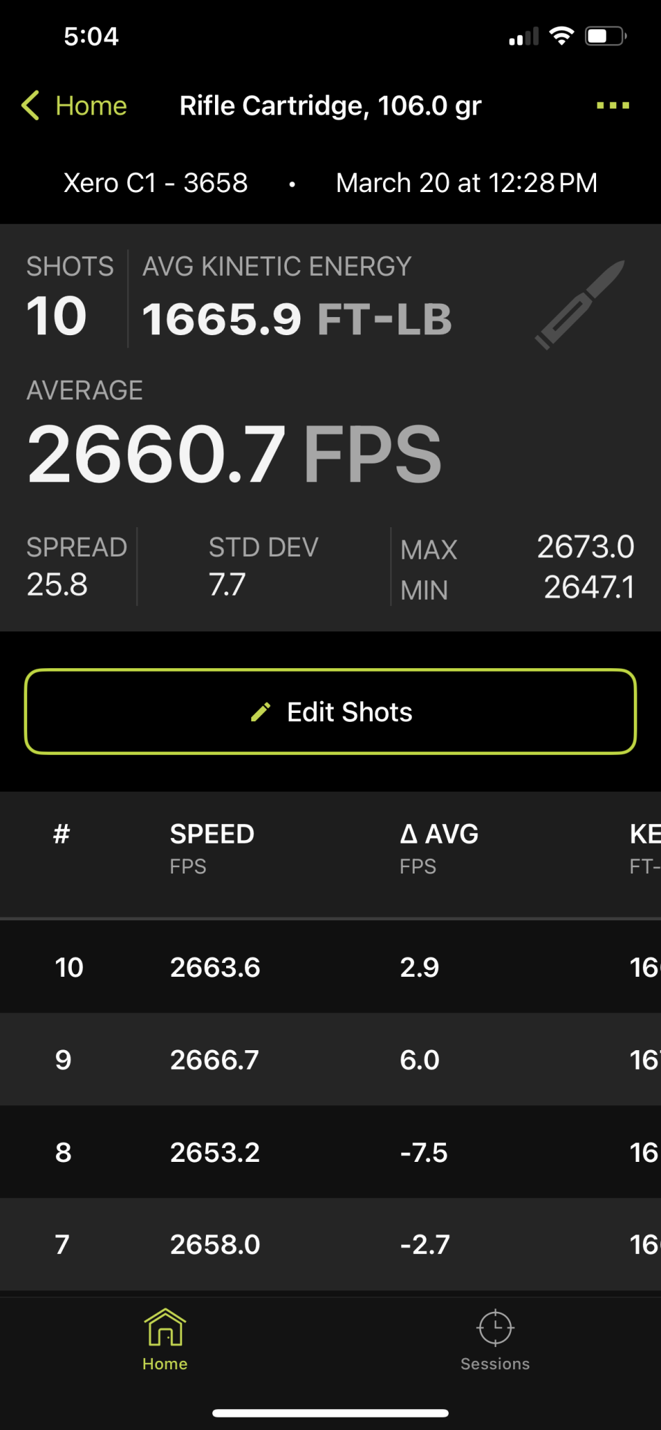

Has anyone worked up a load for 6ARC using the 106gr Hornady A-Tip "factory seconds?"
@padom
I got 2490 fps in an 18" AR with 26.7 gr N140. That's a near max load. I tried Staball Match with no luck, really slow. Didn't want to go CFE or LVR. Not fast, but those bullets are fantastic.
Edit, sorry the 106 TAP, not A-Tips.

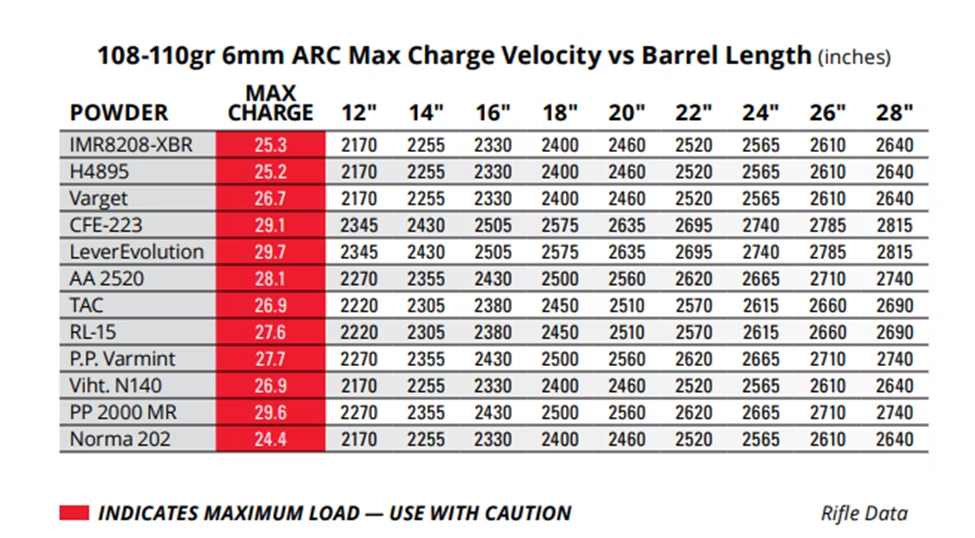

This has probably been posted multiple times so SIAP but the below pic is a good general guide for speed targets with different length barrels:
18" id try for somewhere around the 2500-2600fps in that grain weight. I personally would start with the suppressor on....last thing you want to do is develop a load and stick a can on then induce excess pressure.
This chart really helps - thanks!

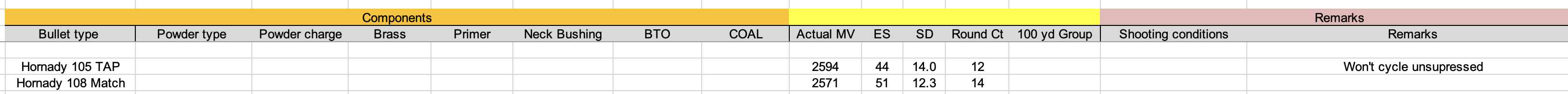

And that explains a lot and creates more questions now. My first test with loading for the 6 ARC, I was getting much higher speeds than I expected, along with early pressure signs that I didn't expect. Npw the trick is to figure out why...

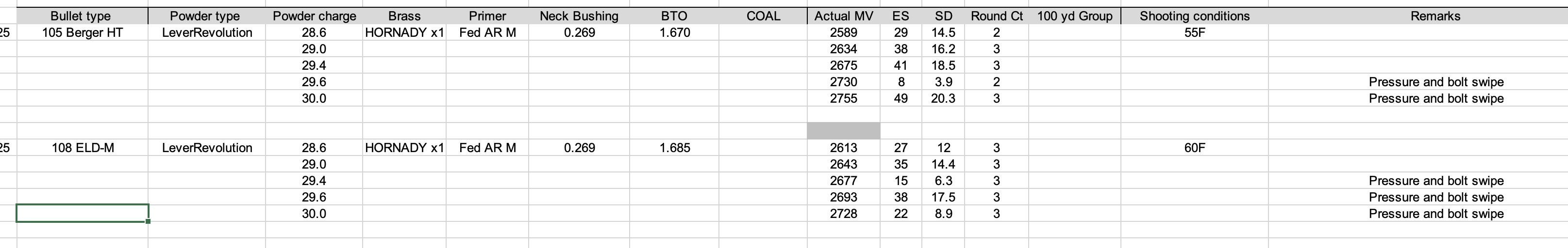

Below are the results from my first test run. I was getting really fast speeds even at low powder charges. So I wonder what is causing that big of a difference in speeds between mine and the chart above.
Chrono is a Garmin X1

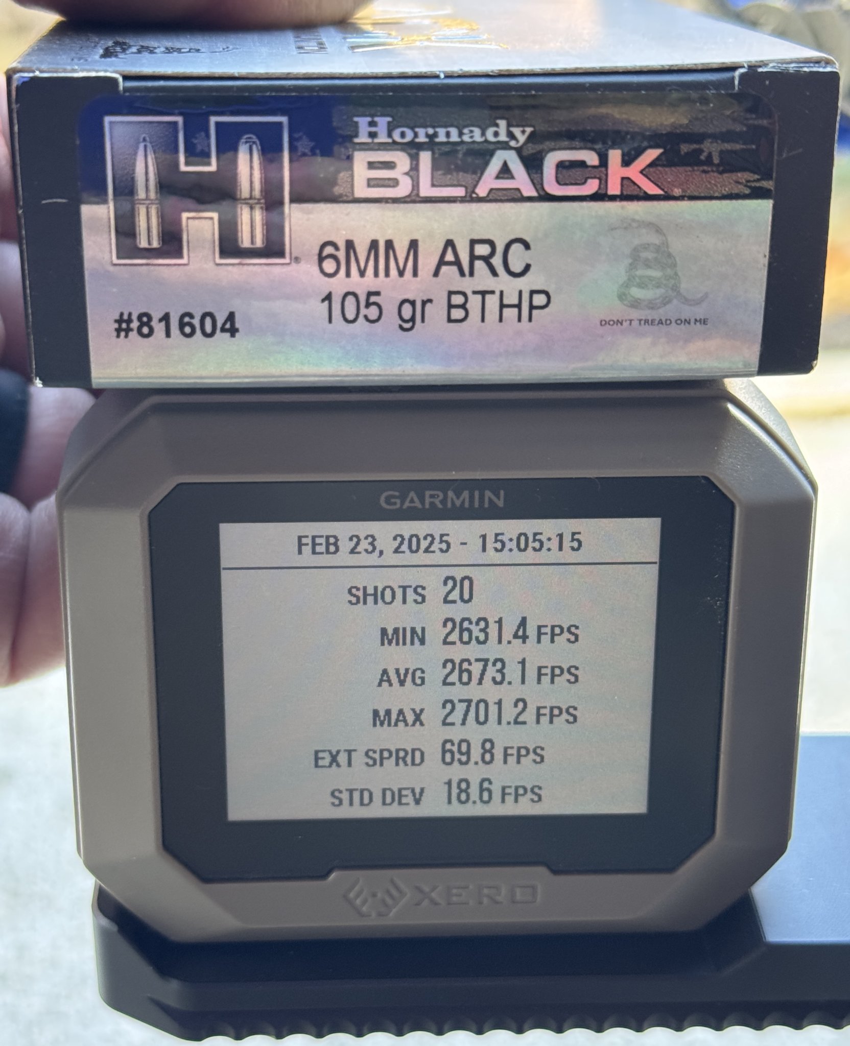

Correct. The Factory loads were Chrono'd and came right into the <2600 fps range.
Edit to add: I had wanted to work up to max load with Lever, since I'd read where numerous people say the SDs are not great until you get close to max case density in the case and then the SDs come right down. But that didn't seem to pan out for me. I might try some Varget and Tac next as well

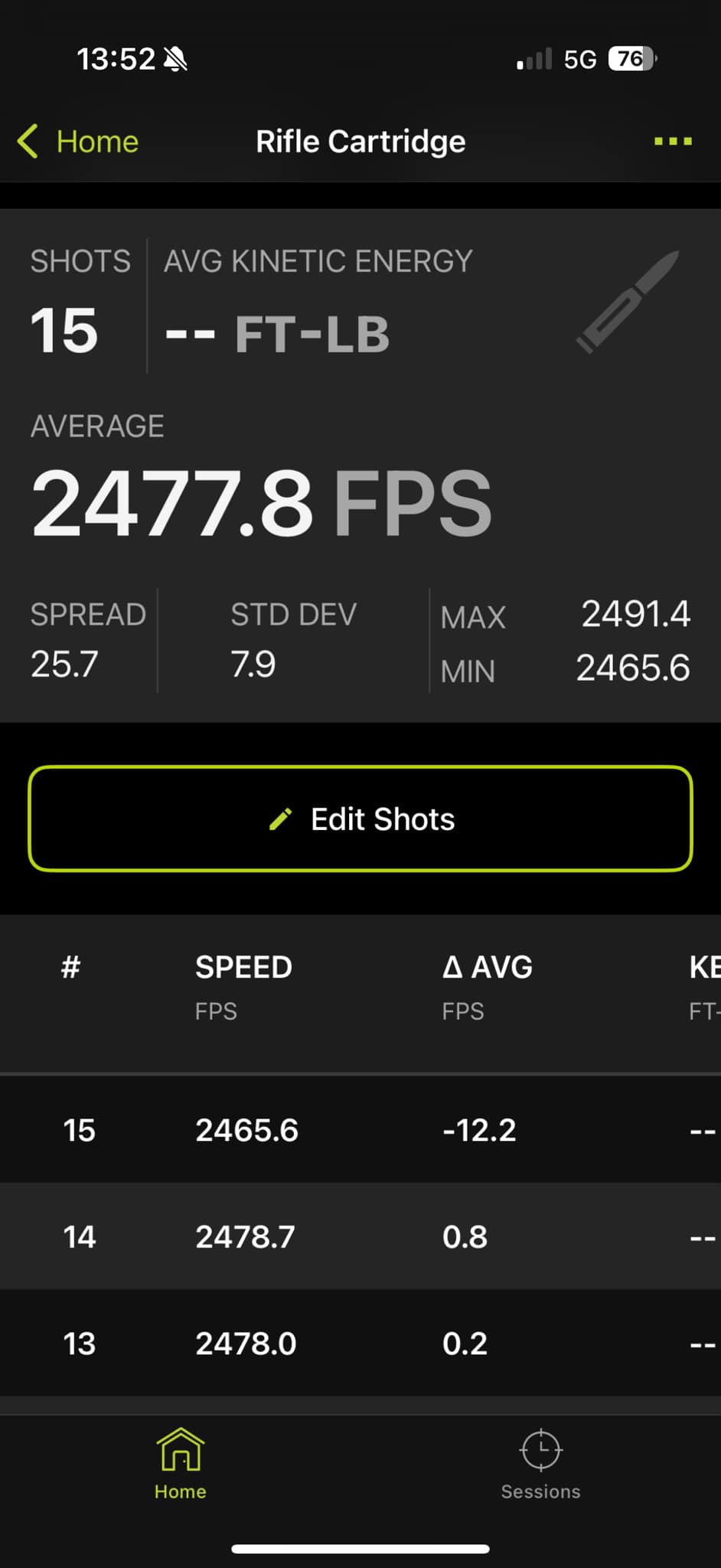

105 Berger Hybrid, 27.0gr N140, converted Starline Grendel case, Ginex primer. 2.255col.
This is my 600yard match load. I just chrono'ed an entire 3x20 match this past weekend and shoot a 597-27X in some pretty tough wind conditions. Typical 5 rounds groups are about 0.75moa from a Satern 20in barrel.
I have found that 27.0gr N140 works extremely well with all the 105-108gr bullets I have available (Bergers, SMKs, ELDMs).

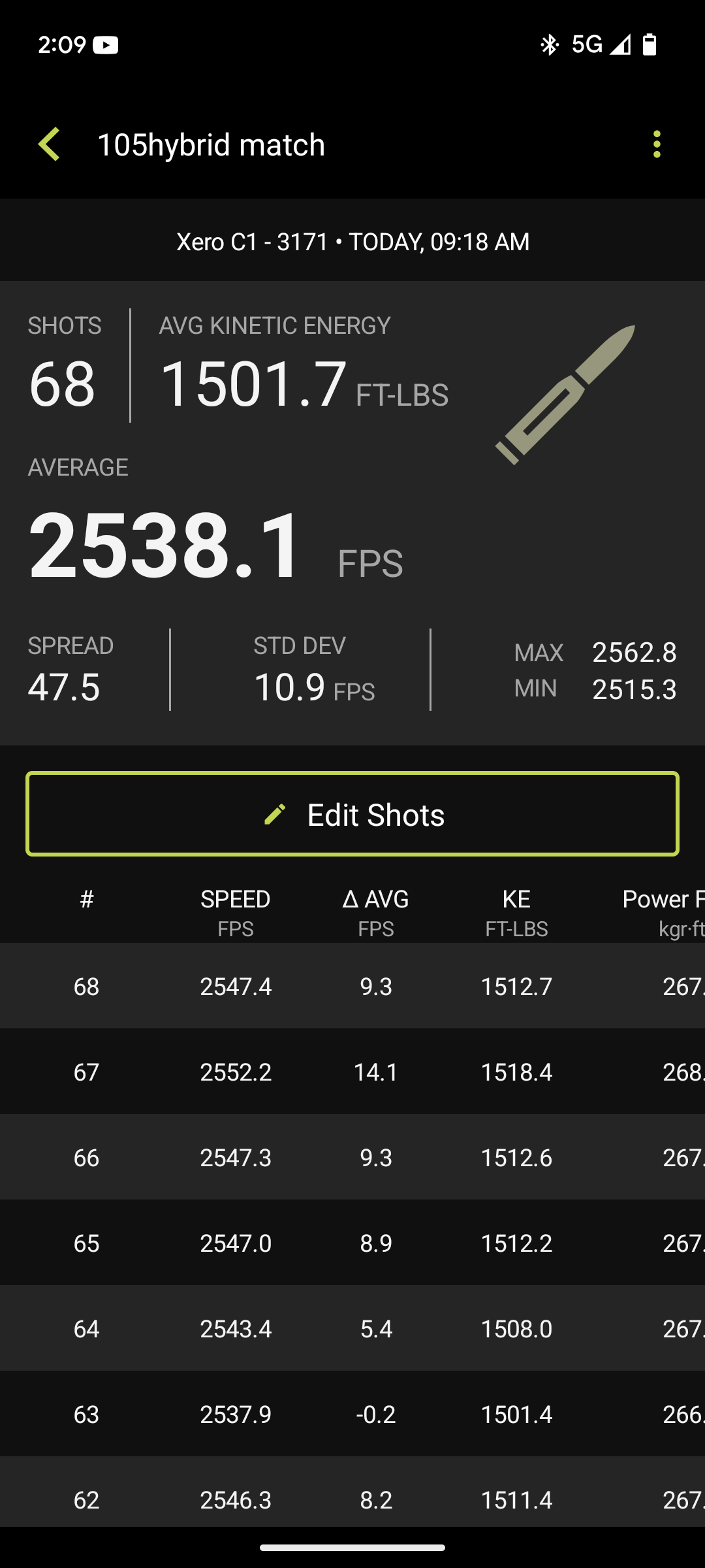

was out doing the first firing with my new Peterson brass. Used a mild of the road load with target and some 108 eld-m pills
never had a double digit before.

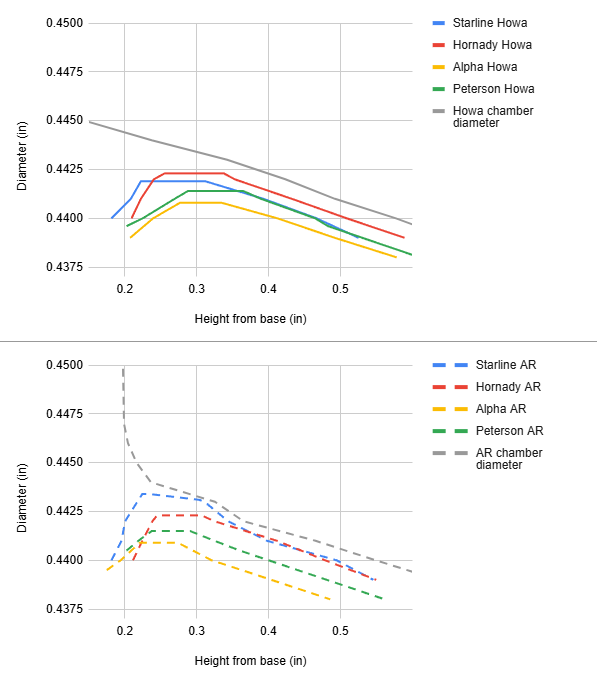

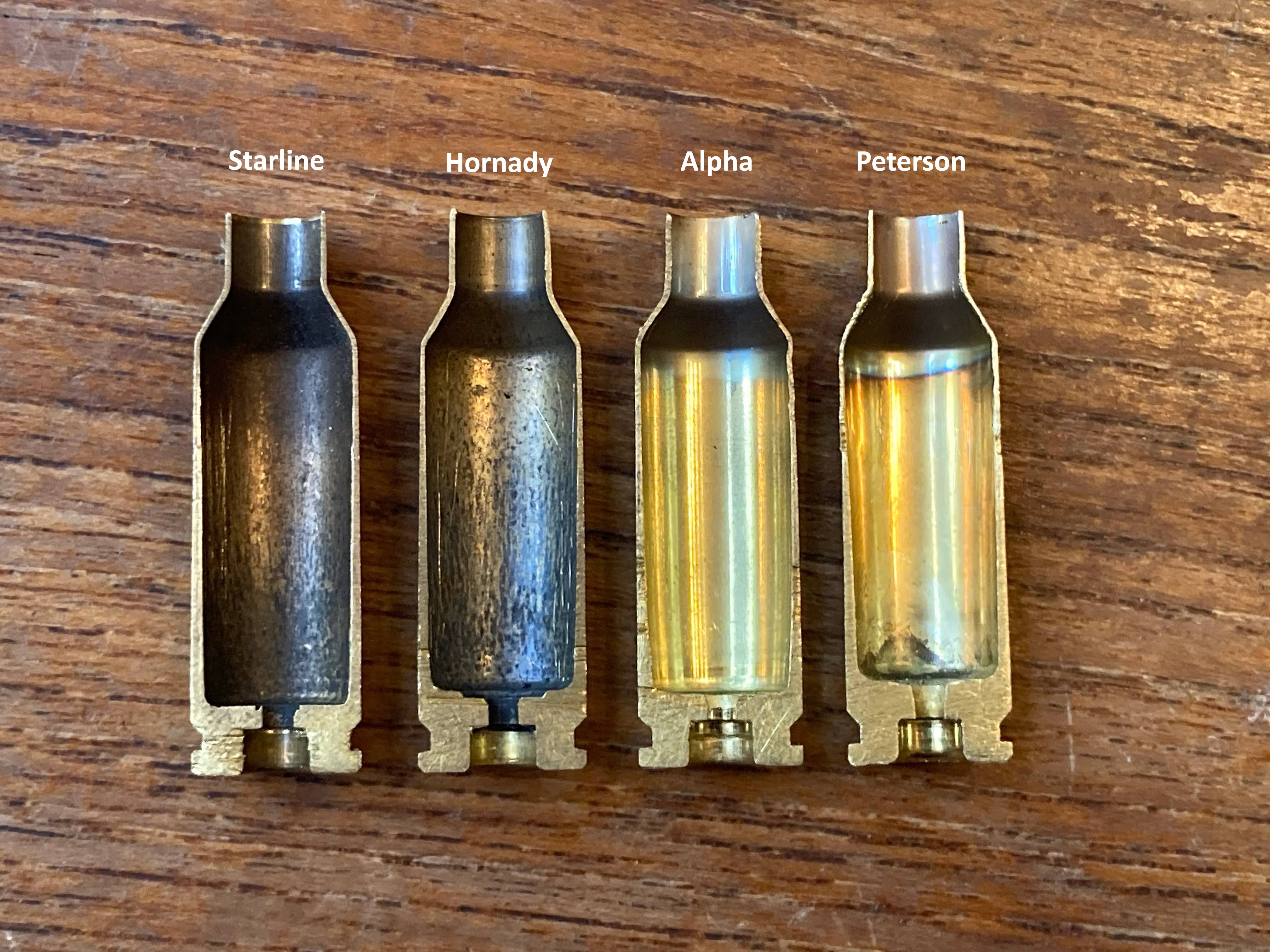

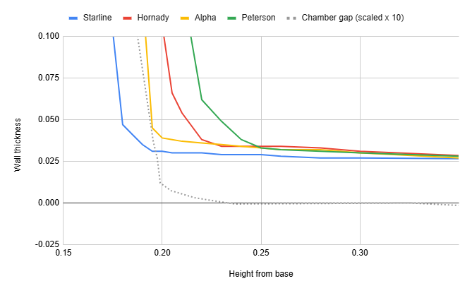

New to the forum, but I've been reloading for 6ARC for a couple years and learned a lot in the course of troubleshooting that I think other folks may find useful. To start off I'll share some of what I've learned about 6ARC brass now that there's a reasonable selection available.
Here's garage-grade cross sections of Starline, Hornady, Alpha, and Peterson brass. Ignore the wiggles near the shoulder on some of the cases, that's just where I got overly aggressive with the hack saw. I was most interested in the shape of the web.
It's plainly obvious that there's significant differences in the internal case design between the manufacturers. To see why it might matter, we need to look at what the case needs to do in that region.

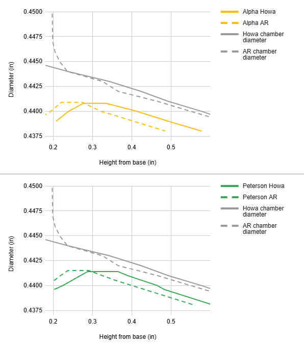

SAAMI chamber specification drawing have the chamber walls running practically to the breech face, but of course that's not how most rifles are constructed. In most modern rifles the "breech face" is recessed in a bolt and there's a gap between the end of the bolt and face of the barrel. Additionally, semi-autos often have a pronounced cone, chamfer, radius, or some mixture of all three blending the barrel face into the chamber to ensure reliable feeding. Having a case web high enough and/or case walls thick enough to resist chamber pressures that far up the case (until chamber wall support begins) is critical. If the case expands where it isn't supported you can end up with anything from a case that's impossible to resize in a normal die to, in an extreme scenario, and case failure and blowout. To make sure we're all on the same page here's an annotated cutaway of a 5.56 AR (original from here: https://www.coltforum.com/threads/windham-weaponry-ar15-cut-away.49104/)
This chart shows case wall thickness of the four above cases as a function of the height from the case base, with the grey dashed line being the difference between the SAAMI maximum chamber diameter and the actual chamber diameter of my loosest 6ARC AR barrel (divided by two to go from diameter to radius and multiplied by 10 to make it visible on the same scale):

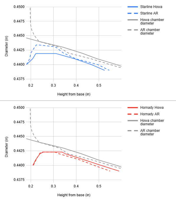

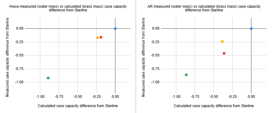

I've called that grey dashed line the "chamber gap" because it's a measure of where and by how much the chamber is oversized relative to the specification. Anywhere that dashed line is greater than zero is an area where the chamber is not providing support and the case needs to resist pressure on its own. Note the 10x scaling: at 0.02" height the chamber is only 0.001" over spec but quickly gets out of control below that.
The region where this chamber is oversized and the region where the wall of the Starline brass has gotten thin have a lot of overlap. Starline brass shot in this barrel expanded to partially fill that gap and would never resize properly with a standard die. Instead a "belt" just above the extractor groove would form on sizing (many Grendel and ARC reloaders know exactly what I'm talking about). The sizing die was squeegee-ing the over-expanded brass down the case instead of squeezing it in radially.
I had much, much less of this issue with Hornady brass. You can see why: the web on Hornady brass starts much higher and has a large radius fillet blending into the case wall, which also starts much thicker. The Peterson brass is another big step beyond even that and should have absolutely no problems. The Alpha brass has a thicker web and wall than Starline, but has still reached it's beginning wall thickness where this chamber is not yet in spec. I haven't shot Alpha brass in this barrel, but I suspect the hardness of an Alpha case head combined with the extra wall thickness and only having an extra 0.001" to expand into would make it a non-issue. That said, the Alpha brass, like the Starline, seems optimized more for bolt actions. In a bolt action the unsupported region will be lower down on the case, below the web height. For instance, my Howa mini has an in-spec chamber down to only 0.145" up the case, ie right at the top of the extractor groove.

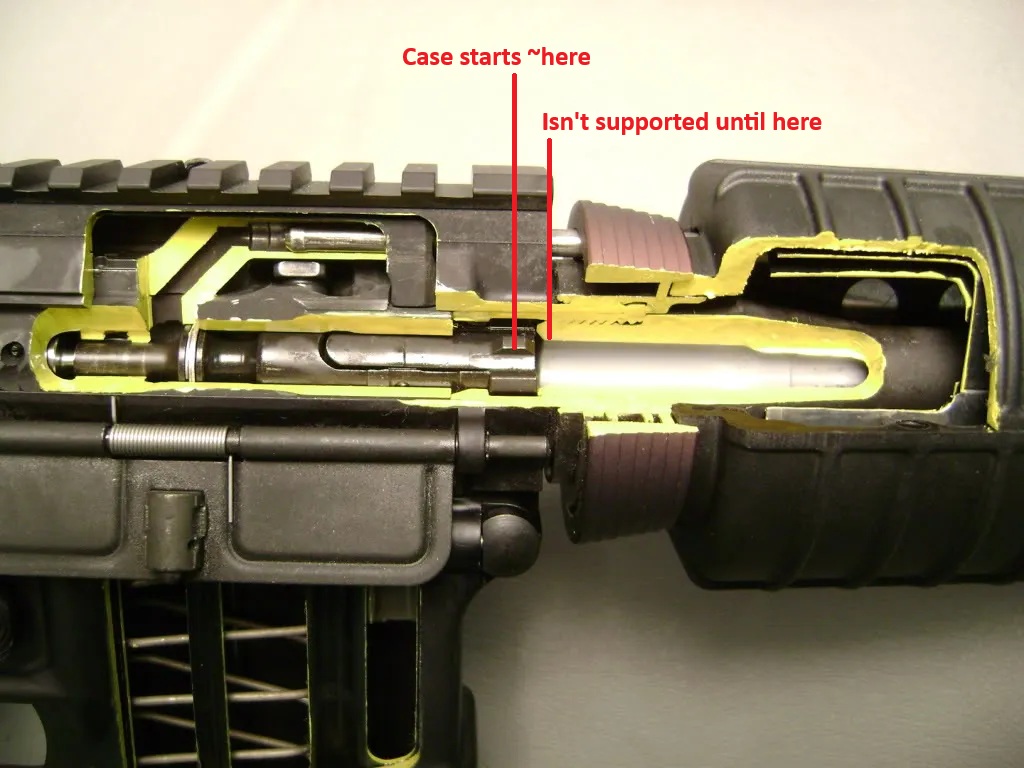

That being said, I have experienced the "belting" issue that you mention using both Starline and Hornady brass when I was using a RCBS Small Base sizing die. After a few hundred rounds, I decided to buy a Lee sizing die and the issue completely disappeared. I have read that many others have had the same experience.
Another brass related issue I have noticed is split necks. My Starline brass started to have splits around the 3rd firing....1 out of 100 cases I estimate. On the 4th firing, it was about 5 per 100.

Going back to brass brands and chamber dimensions, I loaded up some rounds in all brands of brass using the same bullet and charge to see what the dimensions ended up after firing in the two barrels.
100gr Speer hot-cor BTSP
~2.154" COAL (1.700" base-to-ogive using comparator)
28.7gr LeverEvolution
CCI 450
Cases trimmed to 1.475" on a Henderson
First, mass of empty fired cases. These are averages and standard deviations from six fired cases:
It's not a giant sample but clearly all the other brands have a leg up on Hornady for consistency. If all this variation correlates directly to combustion chamber size (ie, the worst case scenario where none of the variation is in the extraction groove), 1gr brass becomes ~0.11 grain H20 capacity, and using GRT this becomes ~4.3 fps of muzzle velocity variation. So, with Hornady brass up to ~4.3 fps of your standard deviation in velocity is coming from brass variation, where with the others it's more like ~1.3 fps.
Statistics note: the standard deviations of independent sources of variation add like in the Pythagorean theorem, ie their squares sum to the square of the new standard deviation. So if you have a pet load with a well-established velocity StDev of 10 in Hornady brass, the reduction in capacity variation from switching to, say, Alpha won't reduce it to 7. The most it can do is reduce it to about 9.
This is an important fact about variation that many people miss: unless your system has a single source of variation that dominates the total variation, no single change is going to make a significant difference. If you can't find a dominating source of variation you'll need to make every minor contributor as optimized as you can to get them add up to a measurable improvement.
------------------Showing my work because that's the kind of nerd I am--------------------
StDev(Hornady brass)^2 + StDev(everything else)^2 = StDev(total, Hornady)^2
4.3^2 + StDev(everything else)^2 = 10^2

That said, switching from Starline to Peterson brass may reduce average chamber size by up to 8.6 gr brass (density ~8.5 gr/cc) which corresponds to ~1gr H2O. GRT says this would increase velocity by ~44 fps. There are certainly other contributors to the velocity generated from a particular case, though. Neck tension, for example, ss determined not just by the dimensions of your reloading process but also the neck thickness, neck thickness uniformity, brass alloy, and state of anneal. So if you change brass brands you really do need to work up and not just because of capacity changes.
I measured the fired case capacity directly by filling with water and although I'm always paranoid that I there are trapped air bubbles in the flash hole with this method, the correlation is pretty good between using the case mass (using ~8.5gr/cc) and the water mass to get the change in capacity between brands. This is data from 8 individual cases, one of each brands fired in each barrel. Color key is same as in previous post.

Here's the external diameters of a case from each brand of brass fired in each barrel, along with the internal diameter of the chamber of each barrel. Note that the Starline brass clearly is getting pushed into the region at 0.20"-0.23" on the AR barrel where the case web has stopped but the chamber hasn't yet come in to support the case. In that region there's just a ~0.035" brass hoop holding in 52kpsi
Charting each brand between the two chambers is also instructive. The extra bulge in the Starline AR brass vs bolt action is particularly notable. The Hornady brass avoids the same effect, clearly the increased web height, wall thickness, and radius between the two is putting in work.
The pricey brass options both appear to do a good job of avoiding getting overly expanded into the AR chamber lead-in chamfer. On the Alpha the web and radius stop at 0.20" height so it's resisting this by wall thickness and brass strength. The Peterson web-to-wall radius goes up to 2.50" so there's a lot more brass mass in the region than on the Alpha.
Overall takeaways for me from this is that the Starline and Alpha brass are really built for bolt guns. The Alpha seems strong enough to deal with the unsupported chamber region on an AR, but it's depending on an extra 0.005"-0.007" of wall thickness and superior material strength vs the Starline to achieve that, whereas the Hornady and Peterson brass have internal geometry (web height and web-to-wall radius) that appears specifically designed to work in an AR chamber.
Next time, sizing dies and sizing results.
