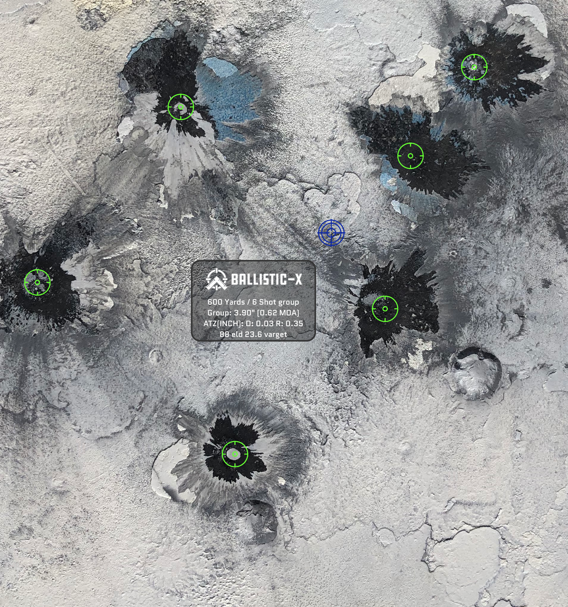

223 wylde chamber with about 1k rds on it. 24” mullerworks 7.5 twist, 23.6 grains of varget, 2806 avg FPS. 620yd group, 3-5 mph wind

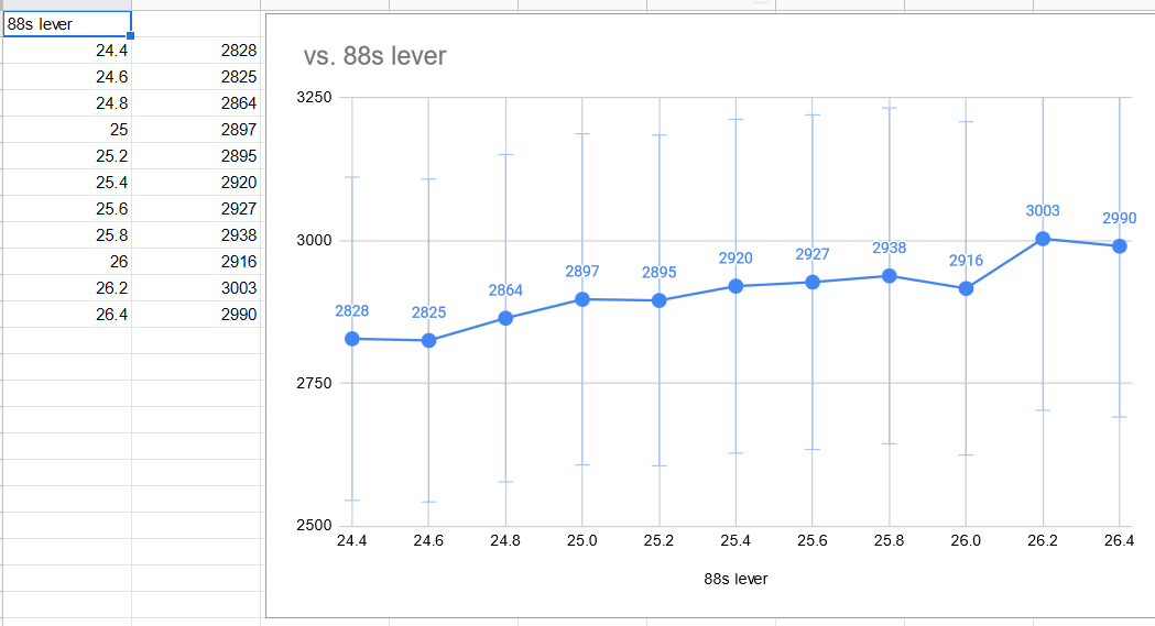

I'm seeing 3000 FPS with Leverevolution and 88s in a 26" long throat 223. I haven't messed with seating depth yet, no time. I imagine I'll settle on a slightly lower charge but I saw no signs of pressure with any of these charges on a pretty warm day. 5000". COAL is around 2.54ish" jumping around .030"
LC brass, CCI 41s

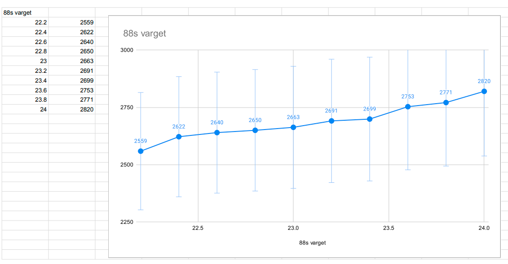

I suppose I should share my results with Varget also. LC brass, CCI41s. I like the 41s for hot loads. They seem to do well. I dont remember seeing any pressure with these loads either but speed is quite as fast as I would like for the 88s. Again 26" 223 7.5tw Bartlien.
