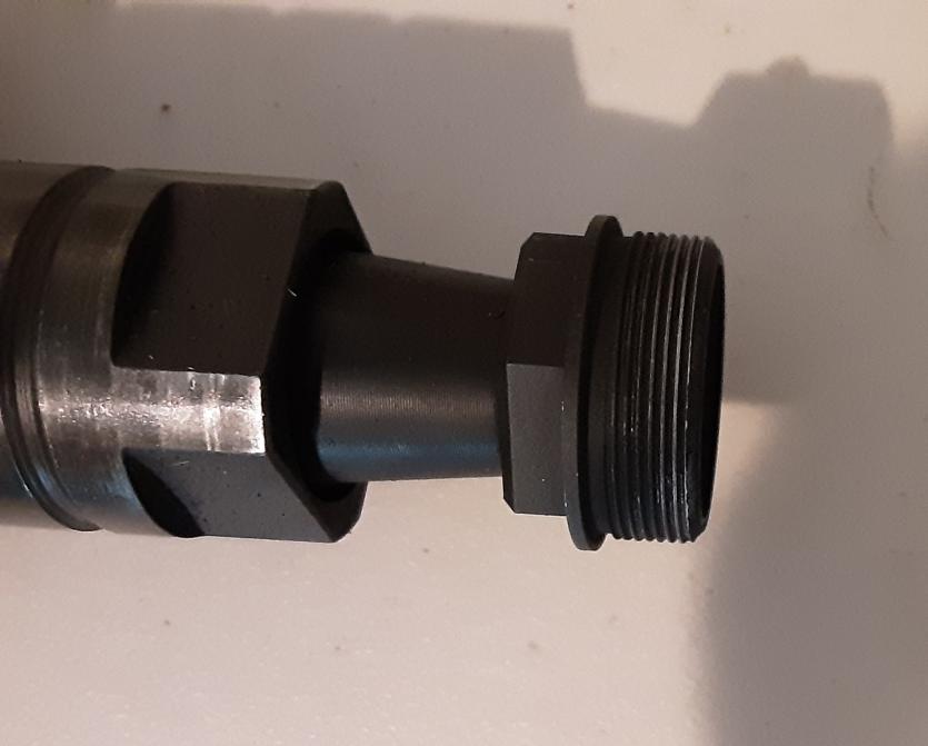

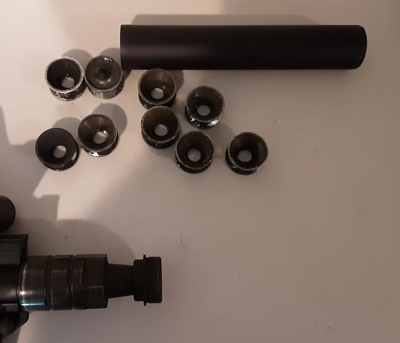

I recently ordered and assembled a Quietbore 9mm solvent trap after receiving an approved Form 1 from the ATF. I drilled the baffles in the prescribed manner with the Quietbore fixture. During test firing the unit was checked for fit and mis-alignment at round 10 with no noticeable issues. On round 17 the body of the unit separated from the rear end cap and ejected itself downrange. Ammunition being used was factory 9mm, a mix of Federal 147gr and Winchester 124 gr. Spent cases exhibited no deformities or other discernable defects.
I took the unit to a machinist who inspected the unit and baffles and found no baffle strikes or other noticeable damage but indicated the rear threading on the tube body was suspected failure point.
I sent Quietbore an email 4 days ago but have yet to hear anything back. Needless to say I'm disappointed as I was planning on purchasing other Quietbore solvent traps with the intention of submitting Eform1s to convert them suppressors as well. Is there anything that can be done to salvage this unit or did $500 just get flushed ?

You will not hear back from QB, is my guess. They are a "solvent trap maker", and anything you do to change their product, is on you. I agree, it sucks; but alas, there is an answer! You can still send your can to a proper SOT, and have them repair the proximal end mounting thread. As long as the tube is not compromised.
Wow, thats crazy. I’d like to see the inner tube threads at the muzzle.
I have the same trap, used all the same stuff. About 400 rounds of 115,124,147, and 157. No issues. This sucks, man! Definitely send it to an SOT. Gonna have to spends some cash to get it resolved, but you won’t be out the $500 already.
