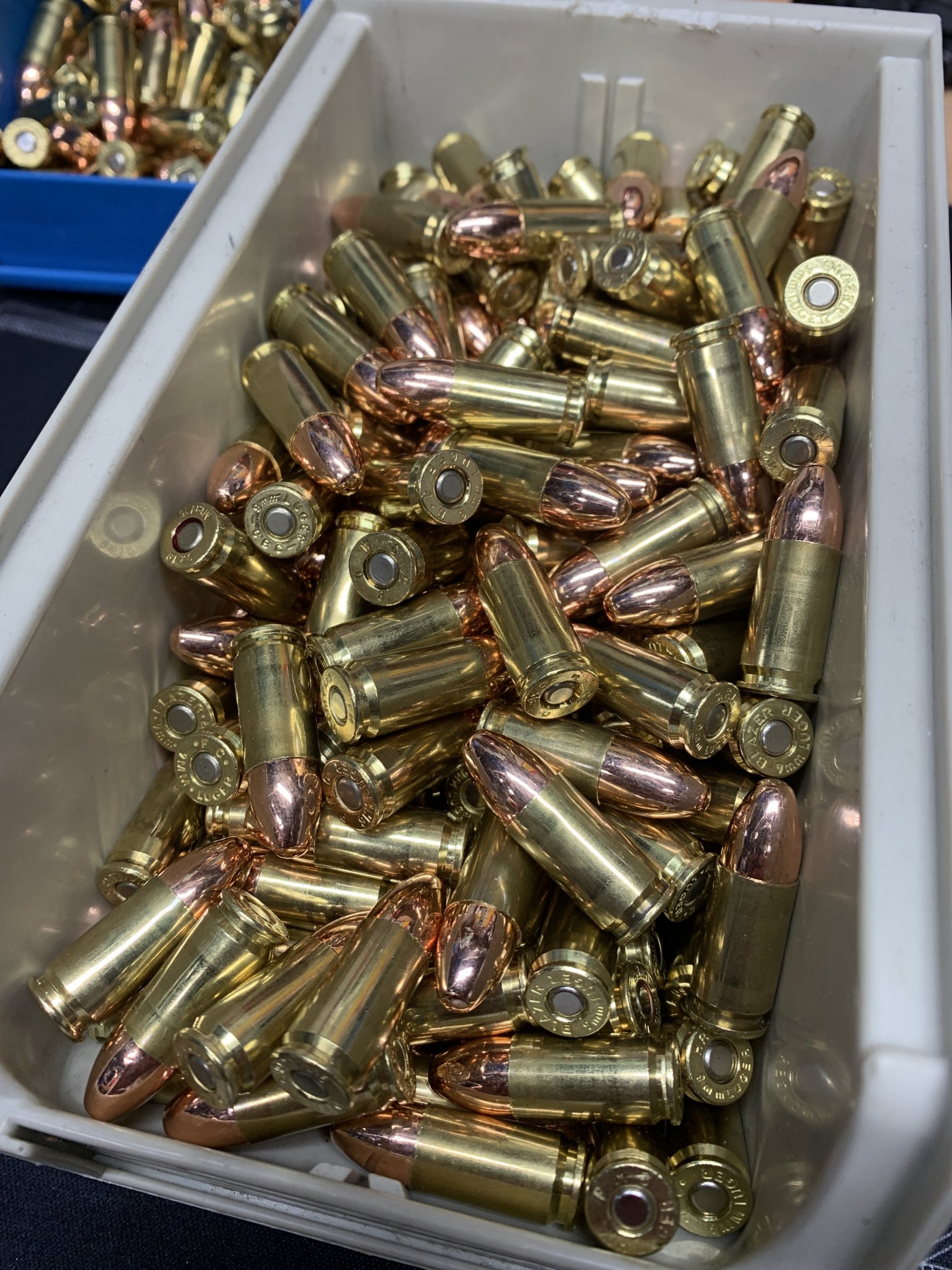

    First - never thought I’d be reloading 9mm, but thanks to the current landscape 9mm is now a part of my routine :)
    load is as follows:
    115gr RN copper plated
    Powder is CFE pistol at 5.0gr
    Primers are a mix of brands
    Brass is range brass fully processed
    Die set is Lee Deluxe
    Press is Dillon 650
    Oal is 1.170
    Weapon is shadow systems m918 elite

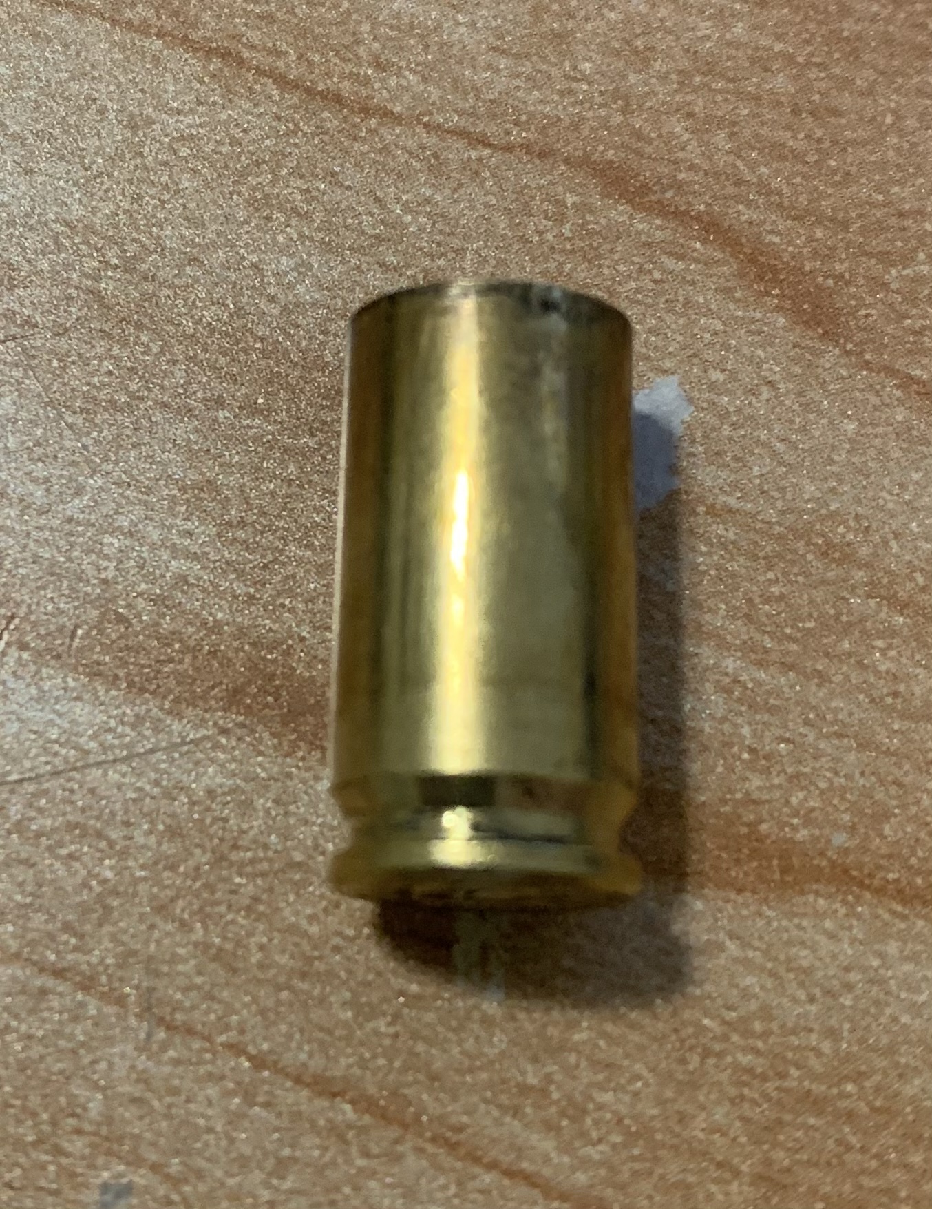

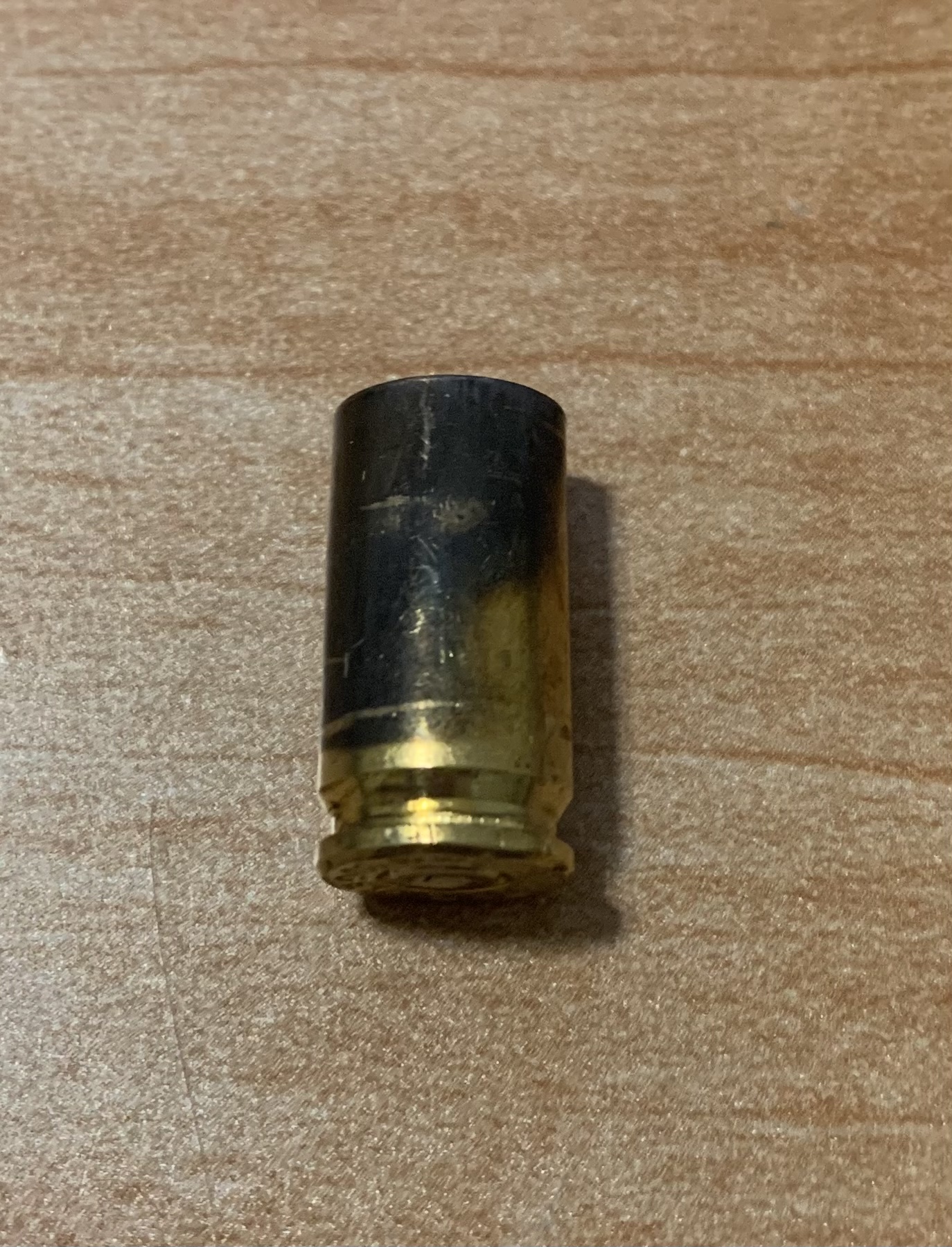

    Situation is that one side of a discharged brass is covered in black from the discharge. The other side of the brass is not. Is this a non-issue or does it tell me that I’m needing to make adjustments?

    Black soot on the outside of the case is an indication of too low pressure - not dangerous, but you're getting brass and the chamber unnecessarily dirty. Easy remedy is to use a bit heavier charge weight or shorten COAL which will bring the chamber pressure up.
    Using mixed brass will cause the COAL, chamber pressure and velocities to vary quite bit, which explains why some of the brass don't have black soot on the outside.

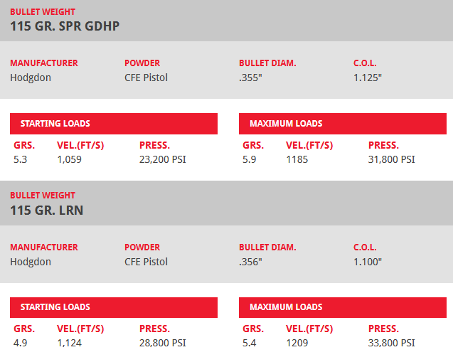

    You're .2gr under minimum charge weight and .070 longer than max COAL. Your brass isn't sealing the chamber because you do not have enough chamber pressure. We've had a few notable threads here discussing overcharges with fast burning powders that resulted in catastrophic failures. When dealing with slow powders the opposite starts to become a issue as you're seeing now.
    Increase charge weight and shorten up the COAL before you damage the locking lugs on the barrel.

    Sort of. Not .070 greater than SAAMI max but .070 longer than the max for the load data. Pretty much all load data, min and max, is for the specified bullet. Copper washed or plated 115gr is normally 1.100. I guess my post was sloppily worded but the max COAL for the data's accuracy is what is specified. Either way, OP is under the minimum safe pressure.

    Thank you! I did pull my original lid data from hodgdon site but maybe I read it wrong? I’ll adjust COL to 1.10 and increase powder to 5.2gr, then test it.

    completely makes sense. I’ve got probably 500 rounds loaded at this point. In the old days of USPSA shoots we’d have rabbit fart loads similar to this concept. Wondering if folks feel the current loads are safe enough to shoot given they may be .07 too long and .02gr too low? I’ve gone through about 200 rounds so far.

    If you wanted to keep the "rabbit fart" load, maybe do a seating depth test with the remaining rounds to see if you can get 5g to work reliably. Do lengths of 1.16, 1.14, 1.12, 1.10 (just for example) and shoot 5 or so rounds at each depth. Might be able to increase the pressure enough to prevent blowback without having to pull a bunch of bullets and re-charge the rounds. Just a thought.

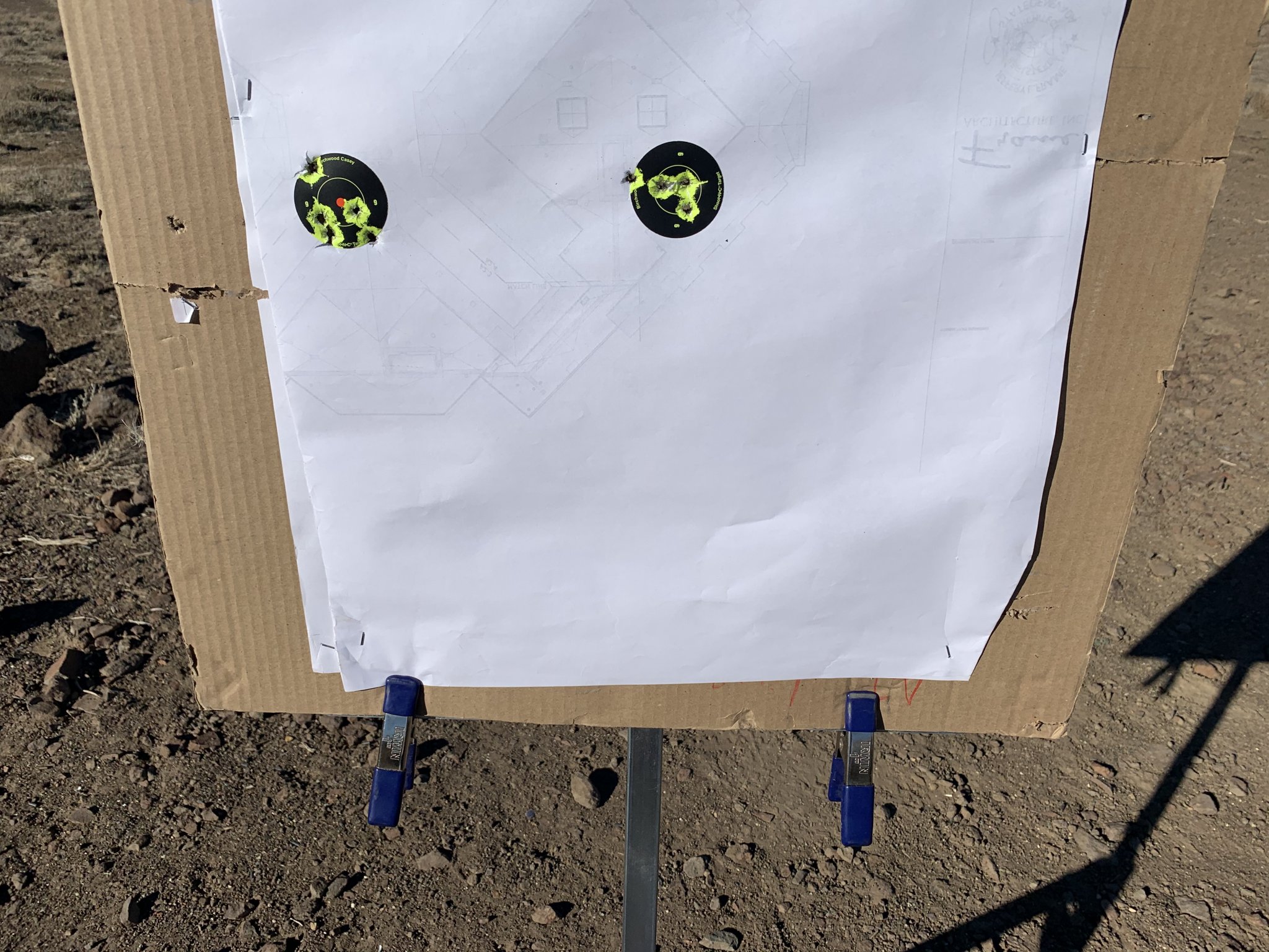

    well this is range pick up brass...same load 2 5 shot groups at 25yds from 2 different guns the dots are 2”...so obviously the variables don’t make much of a difference..the op asked why he was getting so much blow back on his cases not about consistency in brass or variables.
