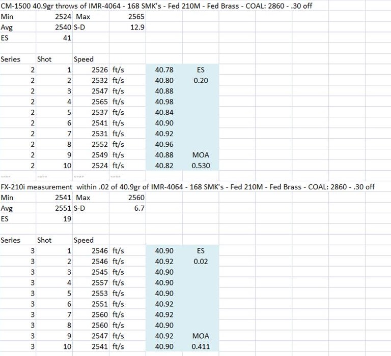

I'm gonna repost something that is already known on here in hopes that some new reloader will find it and avoid my pain.
The A&D FX-120i is far superior to the RCBS Chargemaster 1500....full stop. I'm an engineer that never believes the hype until I learn for myself and I have. I struggled to believe how inaccurate the CM1500 really could be so here is a real life example for my 6CM.

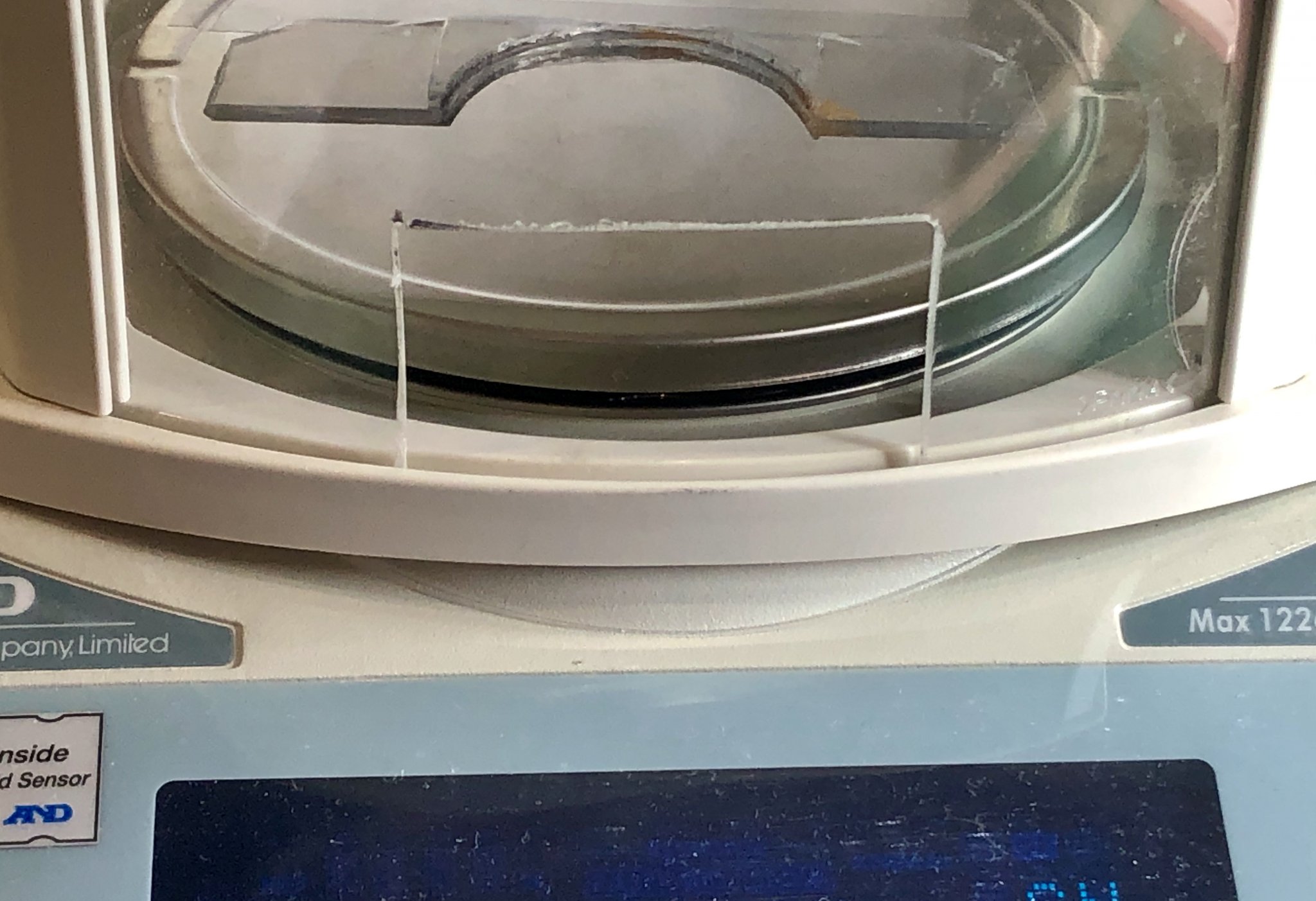

Setup is complicated (read this as painful) because I am waiting for my Autotrickler V3 to arrive....Im 6 more weeks out. My FX-120i arrived yesterday and I have a PRS shoot Saturday. Only option was to charge using the CM1500 then confirm all 120rds on the FX-120i and adjust with tweezers 🤦‍♂️🤦‍♂️ but because of this I got an upload and personal look at how bad it really was.
My load was developed using 0.3gn increments of H4350. What I found was that my CM1500 was off by +/-0.15gn. Stated another way my ES could be 0.30gn between two rounds in a 3 shot group when doing load development....meaning I could be off basically a full 'step' in my load from where I thought I was. Even then I was getting decent numbers over my 10 shots per charge at around a SD=8 and ES = 22.
With the FX-120i my charge ES is now only 0.02gn. That is a HUGE improvement and and I can't wait to see how those numbers will shrink my groups.
If you can find a way to fund it and are serious about getting the best out of handloads, don't 'think you can get by with the CM1500 and just get the brass prep right. The scale is cheaper than most glass or rifles and will make all of them more accurate and consistent.

That’s a great theory but how about actually extrapolating to real world data with shooting sd. Spending all that money for the fx may not lower your actual sd any and the increased resolution on weighing could realistically have nominal effects on shooting. Sd at muzzle effects bullet trajectory so I would be much more interested in that comparison than the .15 grains of resolution from chargemaster considering the price difference
Proof isn't in the puddin', it's in the eating. Don't get me wrong, one day I'll have one of these or a Prometheus but Phillip Crowe won the Leech Cup two years in a row shooting ammo un-weight checked from a chargemaster. Find the right node and .1gr - .3hr doesn't mean shit.
Will be very easy to test. I have 50 rds of Labradar data with SDs and ESs using CM1500. Once I get a chance, I can do the same with FX and compare easily.

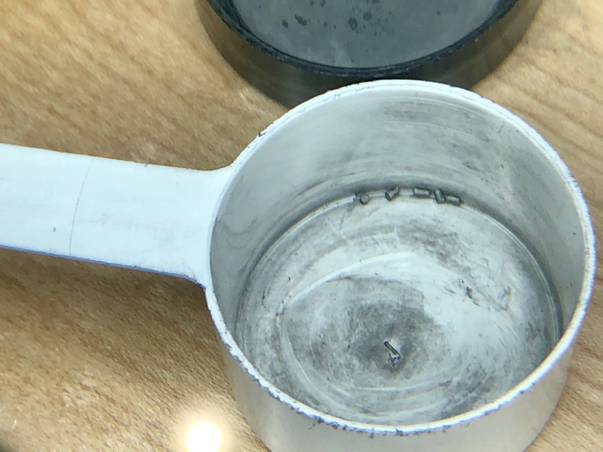

However, don’t use plastic pans like the one below, static electricity will eventually build up and several kernels will stick to it and not drop into the funnel and into the case. Metal or glass pans are far better.
So in this actual test 5 phantom kernels stayed behind in the plastic pan due to static electricity. That is 0.12 gn of error with this powder, which is too much. Now the $1000 plus setup is no better than a standard scale plus manual trickler, or a ChargeMaster. User error for sure, but just saying.

I have, and here is what I saw when comparing the CM1500 and GemPro250 to my FX120i:
Am I missing something? I don't seem to see anything relating to the Fx-120, only the CM1500 and GP250...
And the SD/ES is for both? Or which side of the column? Shouldn't there be SD/ES's for both the CM1500 charges and SD/ES's for the GP250?
ETA: Or is that the SD/ES of the charges themselves (not necessarily ES/SD's as they were recorded shot from a rifle)?
Reactions: MarinePMI
I had exactly the same revelations! That said I have also done some shooting to experiment with rounds loaded to same theoretical standards using the two different devices. Short story is in the picture. Shooting my 338 LM I was never able to achieve groups like the following pucture shows. The flyer at 3 o'clock was a fouler round I let my son send, he surprised me with his impact so I stayed on same target. The group on the 9 side is 5 rounds of 338LM at 100. 300 gn A-Tips on top of 91.6 gns of H1000.
Yes it was a pain to weigh each load and adjust with tweezers but imo the results are very worth it. I cannot wait for the rest of my V3 to come in!
If tiny powder changes effects your groups I’m pretty suspicious of your load development.
:eek: You're right! I rushed and grabbed the wrong file. that was just the comparison between my CM1500 and my GP250 and testing to see how the length of the straw would vary the throws (which works best for better throws).
The SD's and ES's are for the column they reside in (like for the GP250 only).
Nope. It's not anything from shooting. It's just the stats from the throws.
Sorry for the confusion. The following post has the data I meant to post.
Thanks for the numbers, those are useful. I was meaning shooting a set of rounds prepared with CM1500 vs FX-120i, to see the measurable SD and ES for muzzle velocity.
I screwed up that post, so here is the one I meant to have that has the comparative data for the FX120i. What I did here was throw from my CM1500 and then weigh the very same throw on the other scales and that's what you see in the columns to the right of the CM1500 column. The SD's and ES's at the bottom are from the weights shown in the same column. Note the far right set of columns includes my little Frankford Arsenal DS-750, which was remarkably the same as the CM1500 (except for the last one, anyway).
Below, is chrono numbers from throws as measured with my CM1500 (note the more accurate measurement in the blue area taken from the FX120i) and the next set of ten are as they were measured rom the FX210i. Looking at the chrono data (from a MagnetoSpeed) you can see how much the accuracy of powder measure made and I included the group size I got (at the bottom of the blue area). With my FX120i, I typically get single digit SD's and mid teen ES for my .308 tuned cartridges.
PS: Each powder weight shown in blue is next to the corresponding velocity for that cartridge fired.

My FX120 scale runs on a high end power filter/surge suppressor, and is sitting on an anti-static mat which is properly earthed to avoid static buildup, no fluorescent lights anywhere.
A stray kernel can accidentally get onto your scale tray and go unnoticed for a while. You really have to keep an eye on the negative number every time you remove the pan. Train yourself to look at it before you dump the powder into the case. Once or twice in a loading session you will see that “something” has happened.
Have run the experiment where i loaded 50 rounds as best i can, tweezer in hand, then carefully put bullets upside down in each case to prevent spillage, waited a few hours, and then weighed them all a second time, being super careful. ES was 0.06 gn (2-3 kernel accuracy) and SD was 0.016 gn. Good but not perfect. [Btw: This testing method is flawed: Ideally we should use a Sartorius GD503 or equivalent scale that has 0.001 gn resolution. Since i don’t own one me did the best me could.]
Yes - by all means get one, it is superb, just learn how to use it well: It is sensitive to drafts, so turn off the AC and close the door. I cut a small rectangular hole in the bottom of the front screen and made it slightly larger than the pan, and cut a round hole in the side screen for the trickler spout. Note: If you remove one of the screens, your measurement error will double to 0.07 gn or more. If you use it with no screens, accuracy is less than 0.1 gn and you have wasted your money. If you don’t believe me, try it both ways. 😊
Also: It needs to be mounted on a stable flat surface, and no milligram scale likes vibration, like a truck passing in the street, or the user bumping the table. A granite slab helps. Just mark the position of the feet on the mat and mark the position of the mat on the table so you can pick up if anything got bumped or moved, and recalibrate the scale.
