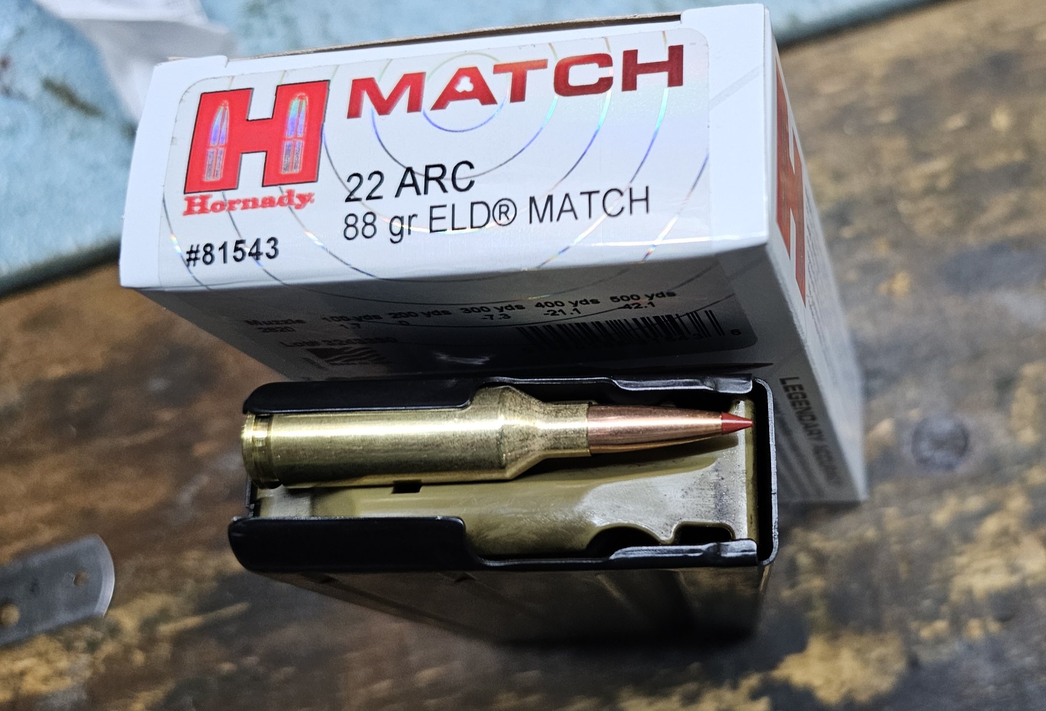

Yeah I've got the Hornady 75, 80 and 88 ELD's
The 88's fit perfect in the Geissele Mags with plenty of room to spare.
Most likely I'll start with the 75's to see how fast i can push them in a Sub 14" barrel.
After testing the Factory ammo I'll start load development with TAC and XBR.
