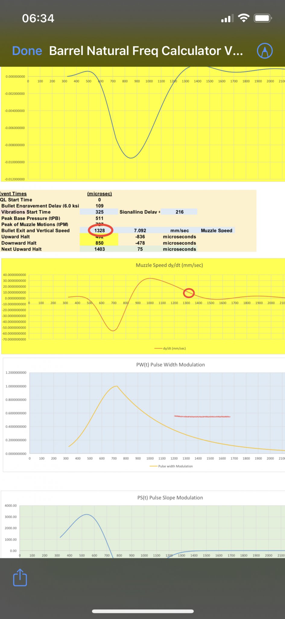

I have developed an Excel workbook of 4 spreadsheets which facilitates the input of the rifle, barrel, and interior ballistics data needed to calculate muzzle position in millimeters as a function of time since 10-percent of P-Max, as is used in QuickLOAD(c). You can enter your data, and the last spreadsheet shows graphically where the muzzle is and calculates how fast it is moving vertically (in millimeters per second) at the QL-calculated time of bullet exit from the muzzle. We are currently beginning to understand the real ballistic benefits of having rifle bullets exit from an inertially stationary muzzle. The worked example is for a known accurate rifle with a cylindrical barrel and no muzzle attachment.
This seems like it will be a useful tool in developing accurate loads for any rifle. It will also help prevent building rifles which are hopelessly incompatible with their intended loads. The formulations for handling of barrel taper and muzzle attachment weight (mass) are somewhat speculative but seems to be working fairly well. The formulations are based on sound physics otherwise.
I would like someone to post this workbook in the Resources section here for all to use who have Excel and QL (or equivalent). I will post an updated paper which goes with this spreadsheet in a few days.

Well, at this level of analysis, the expected motion of the muzzle in the horizontal plane is ZERO. An asymmetrical receiver will cause some skewing of the plane of transverse barrel excitation. For a typical right-handed ejection port receiver, the shot scatter for different muzzle exit times will be slightly upper right to lower left. Benchrest bolt-actions are often machined symmetrically, left to right, for this reason.
I guess that's the point I'm trying to make. To correctly predict vertical motion you also need to know things like receiver asymmetry and the distance from bore axis to rifle center of mass. It's not insignificant either, for a RPR the measured horizontal vibrations are roughly 50% of the amplitude of the vertical vibrations, and they aren't perfectly in phase.
I'm looking forward to seeing your spreadsheets, but I think it might be a bit of a stretch to say that you can predict when the muzzle will be stationary without accounting for those kinds of effects.
Hopefully this isn't coming across as too confrontational, I just know that I've constantly had to change my assessment of what factors actually matter in terms of barrel movement over the past few years of research.
Not at all, Macht. It's just that nobody has ever formulated the vertical-plane shear-wave vibrations before to my knowledge. I do request input of the distance of the rifle CG below the bore line in formulating the amplitudes of the vertical-plane vibrations at the muzzle. Email me and I will send you the Excel workbook as an attachment to my reply. <[email protected]>

Here are pdf files of the paper which goes with a re-done workbook. There are many fewer simplifying assumptions made with this approach. It shows how the driving function and the resonant frequency responses occur at the muzzle.
PDF images of the 4 spreadsheets referenced are also attached. They contain data for the worked example. Due to its table sizes, the fourth sheet is 18 pages, but only the first is of concern.

  • Barrel Natural Freq Calculator V04 Sheet 4.pdf
The kind of take away I’m seeing from your example is that if all else being equal, the barrel would benefit from being a tad longer. But since length and weight changes the calculations, it would be uncertain. But what is certain is that the barrel is releasing the bullet in a downward motion which pitches the bullet up(??)
Reactions: Jim Boatright
