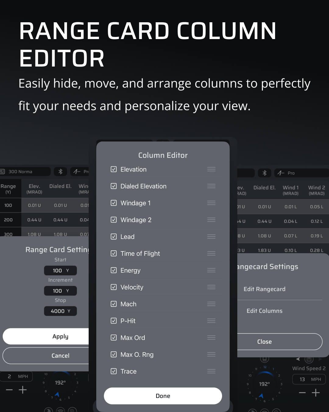

  • Range Card Column Customization
    • Pro Users Only
    • Rearrange Columns.
    • Turn Columns on/off.

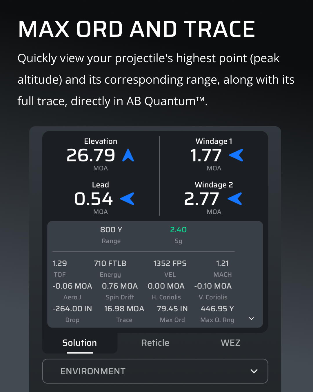

  • Maximum Ordinate Added (HUD, Target Card, & Range Card)
  • Maximum Ordinate Range Added (HUD, Target Card, & Range Card)
  • Trace Added (HUD, Target Card, & Range Card)
  • Drop Added (HUD, Target Card, & Range Card)

My quantum app version is 3.4.5, subscribed to Pro, and I don't see max ord or trace in the manage columns menu. Last update was June 26th. How do I get the app to update?
I just looked, you have to scroll down to find them, but mine shows on both. If that doesn't work, you can try deleting the app, restarting the phone, and reinstalling the app.
