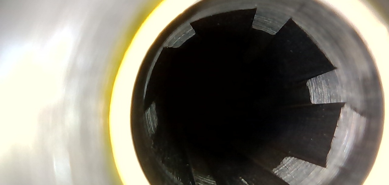

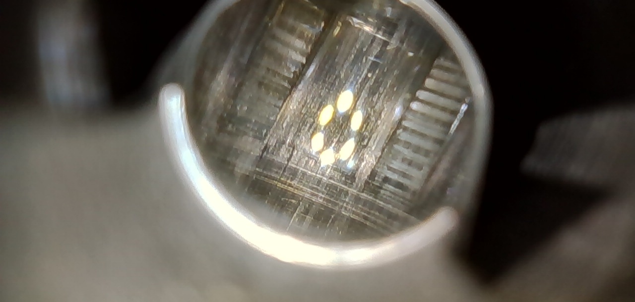

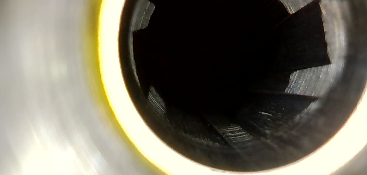

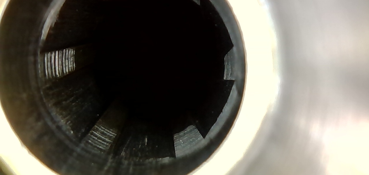

Acceptable work or not?
SB545
Nov 3, 2019
178
42
I've gone the rounds on this barrel and tired of dealing with it. This is the current state after the mfg addressed a headspace issues and evidently reamed the throat.
Would you let it be and shoot it or send it off to get fixed by a competent smith?
The number one question everyone will ask you in 3-2-1 is ..."does it shoot...?"
That's the next step. I've only put one shot thru it prior to getting it back. That was a starting load and it was too hot in that chamber to try for a group. Hopefully I'll get some rounds thru it this Friday.
Have a competent smith throat it our a lil bit, should clean up the hacksaw throat, unless the chamber has enough runout that it's oversized to the point a good dial in won't clean it all up. Who the F sends something like that out the door?
6 groove barrel? Cut or button rifled?
Not sure what a smith can do to "fix" anything...... if you're worried about the cut marks remember they are magnified by your bore scope...... best way to smooth them out is to just shoot it, they'll be gone in a couple hundred rounds.
This one is button. The tooling doesn't look great but I'm more concerned about the concentricity. Either the chamber wasn't cut straight or the throat wasn't. I'm thinking it could have been straighter if reamed by hand. Out of the 4 samples I've seen from this mfg, only one was concentric and that was after a lot of calls and emails.
They're probably using a "standard" size (i.e. undersized) pilot on their reamer. That's why your throat looks off center.
I'd still be more interested in how it shoots than how it looks. Borescopes cause way too much stress for most owners, it seems.
Looks like they threaded it for the new replaceable throat system. Just screw in a new throat insert and go!
Seriously though, I'd want my money back. That's absolutely dog shit, it looks like they threaded the fucking lands theres so much tool runout.
3 out of 4 were fucked up and you're still trying to deal with this vendor?
Sorry you are going thru this....but me, I would have moved on to a different barrel vendor.
Send that photo to the repair shop that did it. See if they will just replace it.

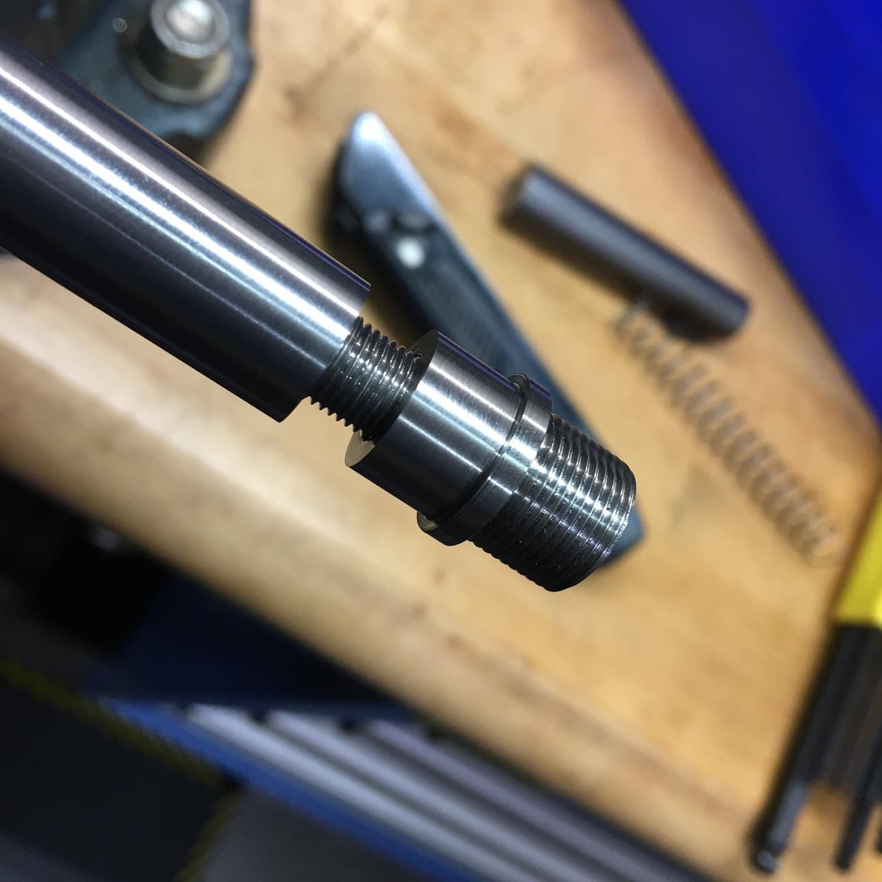

If I correctly understand what you are describing, another way I’ve heard of doing this is to counterbore the muzzle, make interior threads, and then thread in an adapter.
The bore length decreases about 1/2”, but there is not a section without the full thickness of the barrel around the bore.
Tornado Technologies is known for this type of work but I just read some reviews and they seem to be having issues as they had to move shop. I wouldn’t use them until that’s resolved.
Here is an example (not entirely sure if this is an actual example as it almost looks like this particular adapter is threading onto barrel threads vs threading into the barrel, but hopefully you understand. Got it from TT’s Facebook page)
From what I understand they use this approach on barrels that, say, have a sight post right on the end, or if the barrel terminates right at the end of the stock (Mannlicher) or slide (pistol).
And note that this is what I understand how they approach this problem, as I have never used them. I could be off base.
Or you could hit those reamer marks with a few short strokes with JB, Iosso, or 0.25 micron diamond, as it will likely copper-foul until firing lays that down
