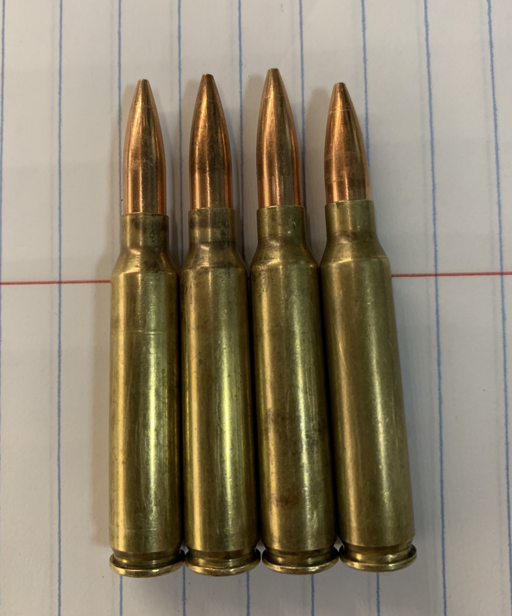

    update & question
    So when I was running Dasher & BRA in my AX having a shorter freebore caused some feeding issues. While these are not exactly the same where the round would hit on the tenon like in the BRA feeding from HRD mags, I’m still thinking having a longer freebore in 223 would help alleviate some of the snags. Tomorrow picking up the bolt heads from heat treater, hope to test.
    Question:
    If having longer rounds were necessary to the perfect function of this conversion would that be a negative ? It’ll still feed factory, but as seen in worst case scenario video it has a snag. Longer throated handloads might be the best solution. From factory Wylde chamber I’m guessing it’ll need to be .080” longer bringing it to .140”FB, left 3 are longer. Right bullet is max OAL with standard reamer, still around .020” longer then factory 77

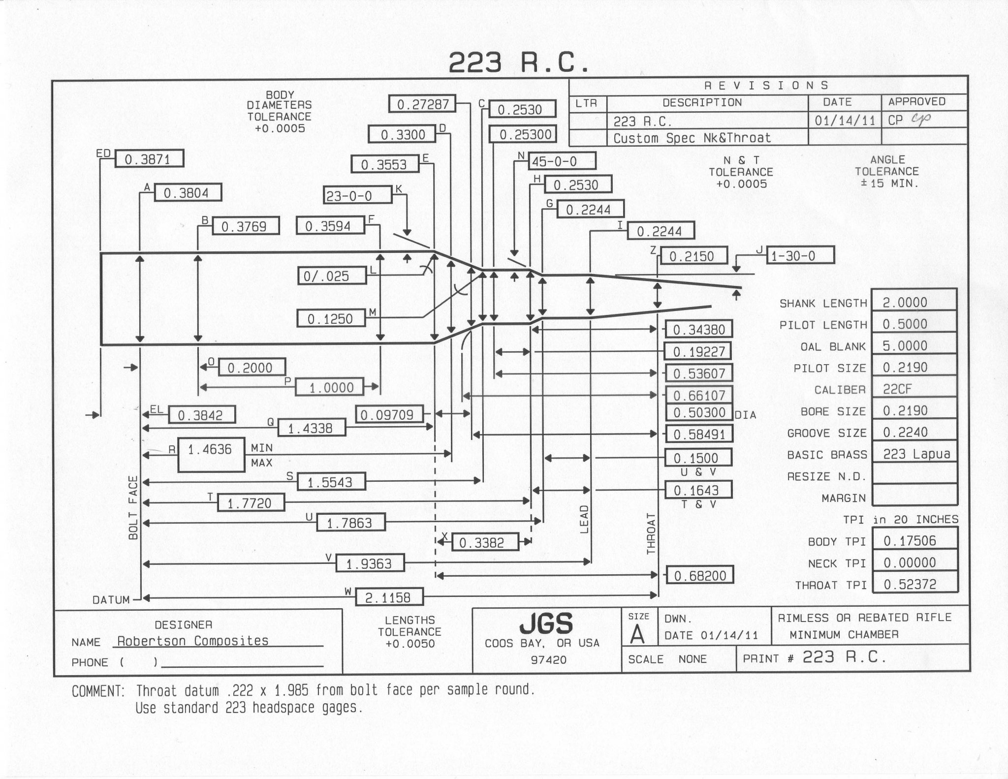

    Longer freebore certainly isn't a bad thing as bulk ammo will still shoot with the accuracy of... well bulk ammo with a longer freebore, but longer bullets can't be made to work without enough freebore.
    In fact I would want mine setup with enough freebore(ultra long) for the high BC for caliber bullets like the ELD 88's and Berger 90's.
    Something along the lines of the below reamer specs... not that I've given it much thought :rolleyes:
    That looks real close to what this will be throated, right at .162”. This is a standard 223 Wylde reamer, just gonna extend the throat. Factory ammo shoots good, maybe 1/2-3/4” with most closer to 3/4” consistently. If I use bulk 55gr it’s closer to the 1.5-2” but it goes bang. I asked the guys what’s good factory ammo and most stated FGMM, with a few using fiocchi.
    I want this kit to work with factory as an easy cheap trainer, but if it takes long handloads to feed flawlessly then it might be geared that direction. Although it would take handloading to get it optimal, it seems thats where all competitive ammo shines best, when it’s optimized for the barrel. I guess I’m bias cause I haven’t shot a factory loaded round in over 7yrs. We’ll see, got everything from the heat treater, tomorrow I assembly and gonna throat the barrel, then run a few longer rounds to see if it’ll feed how I’d like. Luckily with a Dillon & Mark7 i can pump out about 400rds rather quickly ?.

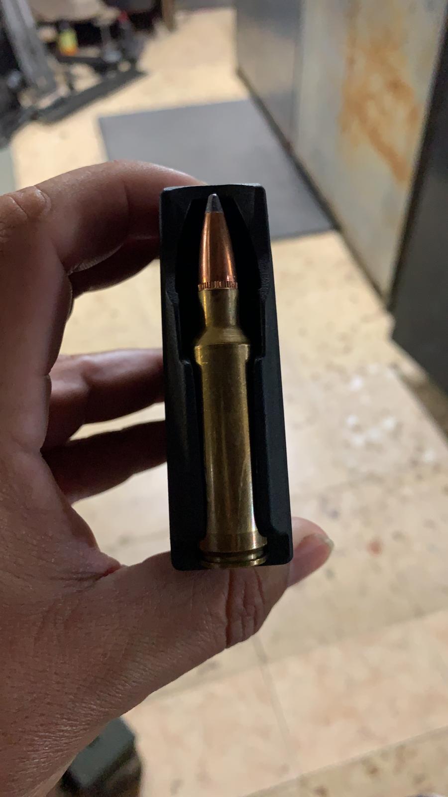

    Finally had a chance to run some rounds through a few different mags to see where an issue was. Any misfeeding is 100% mag related. On one AccurateMag that I modded it ran flawlessly over 40rds under any condition. With a buddies MDT mag it would feed great rds 1-9, then on the last round it would nose dive into the mag, it did that 3times over 4 10rd strings. Then on another AccurateMag it would feed great rds 1-8 and round #9 would snag going up the feedramp. I ran 4 10rd strings and it did it only on #9, #10 would feed great. I pulled the spring and stretched the shit out of it and ran another 4 10rd strings and not one single hiccup. So all mag related issues. I have 3 mags that feed great that I plan on running this Sunday in our Sotex club match.
    One thing I will add is shooting 120rds of crap factory ammo is labor intensive. On a 110* day that barrel got hot, i had to let it cool every 10-20rds or i just felt bad for my barrel.
